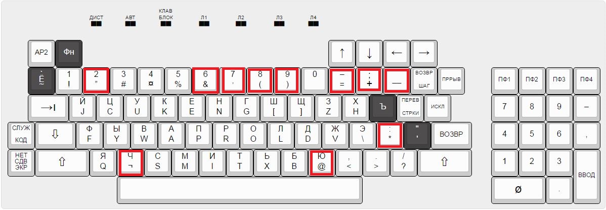

Hello friends,
I'm working on a project to PCize the keyboard of my childhood — the old Soviet Izot Magnetic Reed Switch terminal monster. The one I was luckily found is not exactly the same, but the switches are the good old ones though. It was always been my dream, and several years ago I've joined the keyboard community because I couldn't forget that heavy thucking beasts which was capable of bearing the mobs of students without a single failure.
For some reasons, I've decided to create the new Teensy-based PCB for this keyboard.
I've accurately measured the switches and the case, created the KiCad PCB drawings, sent them to the manufacturer and ordered other needable parts. And now it's about time to create the firmware.
Thanks to Matt3o's neat lessons, I mostly understand the path I should follow, but one thing still holds me. I've got a bunch of the extremely old-fashioned key legend combinations. And following symbol pairs are sharing the same keys: 2 and ", 6 and &, 7 and ', 8 and (, 9 and ), ; and +, : and *. Also, there are @ and ^ at non-shifted positions. The problem is that guys just don't fit the USB keyboard standard, but maybe there IS any way to implement this layout using TMK?
As far as I've got, I could use Fn keys. But what I don't understand is how to assign the different meanings for these keys at the normal and shifted positions? Is it possible after all? If TMK can't, then maybe another firmware exists to help me to realise this task?
Thank you in advance for the answers!
And here is the layout itself, the troublesome keys are marked with red outlines:
Halvar
19 May 2016, 19:26
By the logic of how PC keyboards work, the proper way to do this would be to make a fitting keymap for your PC operating system. In a keymap you can freely define what every key does, alone or when pressed in conjunction with modifiers. There are free keyboard layouting tools for all major OSs. I'd recommend this unless you are a sysadmin who works on a huge number of machines every day...
The keyboard only sends scancodes to the PC, and there's a scancode for every key that standard PC keyboards have.
If you insist you want to do it in the keyboard, there are macros as workarounds supported by TMK. This means that if the user for example presses shift and then 6, the keyboard would instead send the combination of keypresses that are needed to reach the ampersand & on the keyboard layout that the user's OS is set to. On first sight, this may not sound too bad, but it has some annoying disadvantages. First of all, the macros in the keyboard would be dependent on the keymap that is set in the OS, which is basically the other way around of how it should work. Then there's the problem with modifiers when more than one key is pressed at the same time. Say you press down the @ key on your board, the macro changes this into sending Shift + 2 because that's how you'd get @ on the keymap in your OS. Then, while still having @ pressed, you press another key, say "s". The OS will interpret that as "S" becaus without you really doing it, the shift key is still pressed from the @ macro.
You can do it in TMK, but it's always a bad hack.

@Halvar, you mentioned two disadvantages of using TMK to serve solkoseryl's intentions:
First of all, the macros in the keyboard would be dependent on the keymap that is set in the OS ... Then there's the problem with modifiers when more than one key is pressed at the same time. Say you press down the @ key on your board, the macro changes this into sending Shift + 2 because that's how you'd get @ on the keymap in your OS.
I'm not sure, but using TMK-macros with pasting Unicode-letters would avoid both disadvantages, isn't it?

Eszett wrote: I'm not sure, but using TMK-macros with pasting Unicode-letters would avoid both disadvantages, isn't it?
Is there an OS independent way of pasting unicode-letters?
