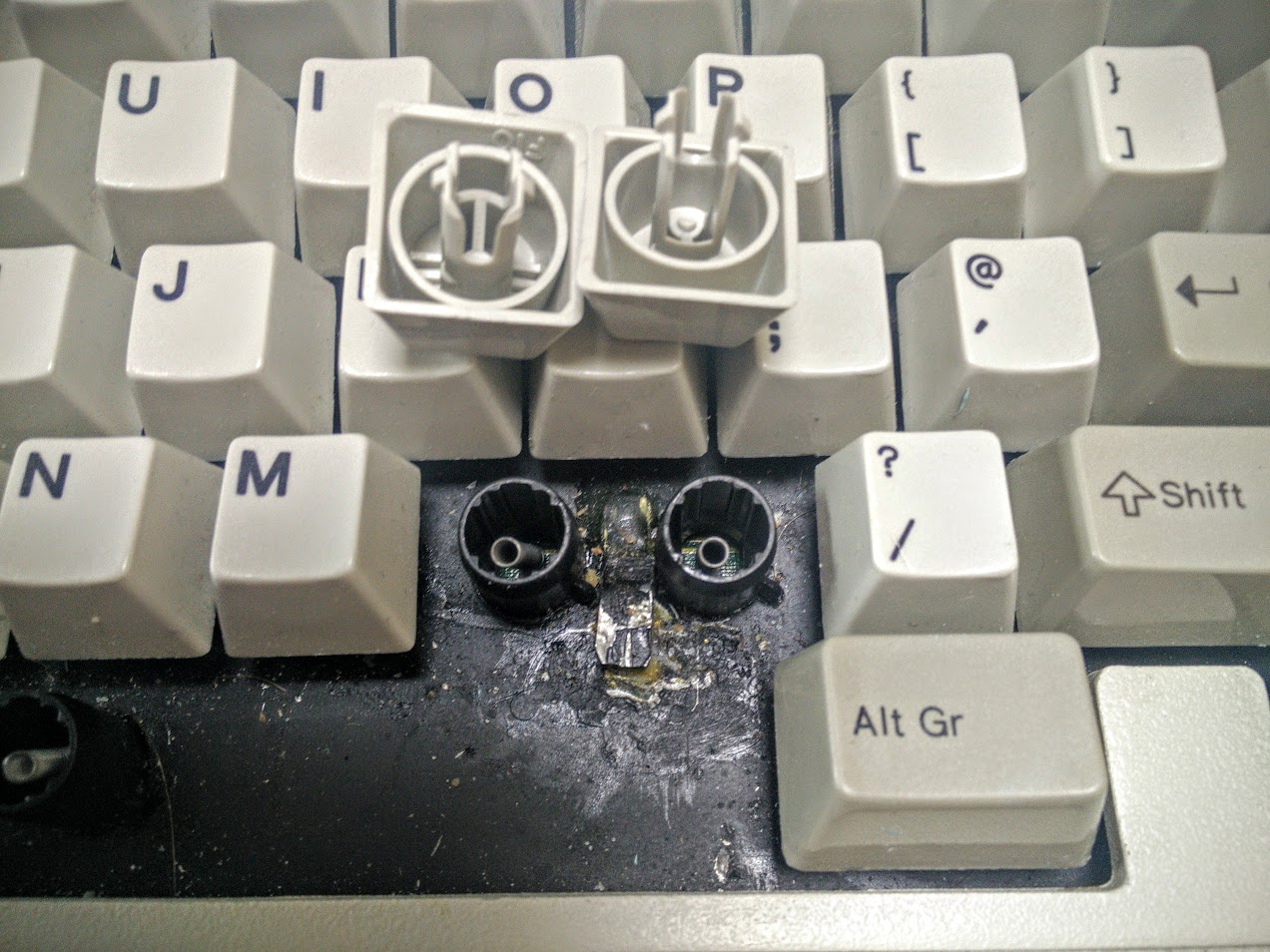

You have it sorted , but for future reference for anyone else you can just glue a strip of metal ( bent to shape ) onto the plate.
(Yes i know my plate is dirty
its a work keyboard , don't get much chance to clean her up.)

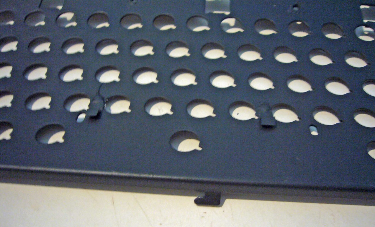

It can be done a bit more neatly.
Also, the sheet metal can be bent up or down to adjust movement and chatter.
And, one of the neo-F projects has a barrel with built-in spacebar tab that will be brilliant if it ever comes to fruition.
- IBM-F-122-minimal-wiki-2013-spacebar-tabs.JPG (236.04 KiB) Viewed 3064 times
