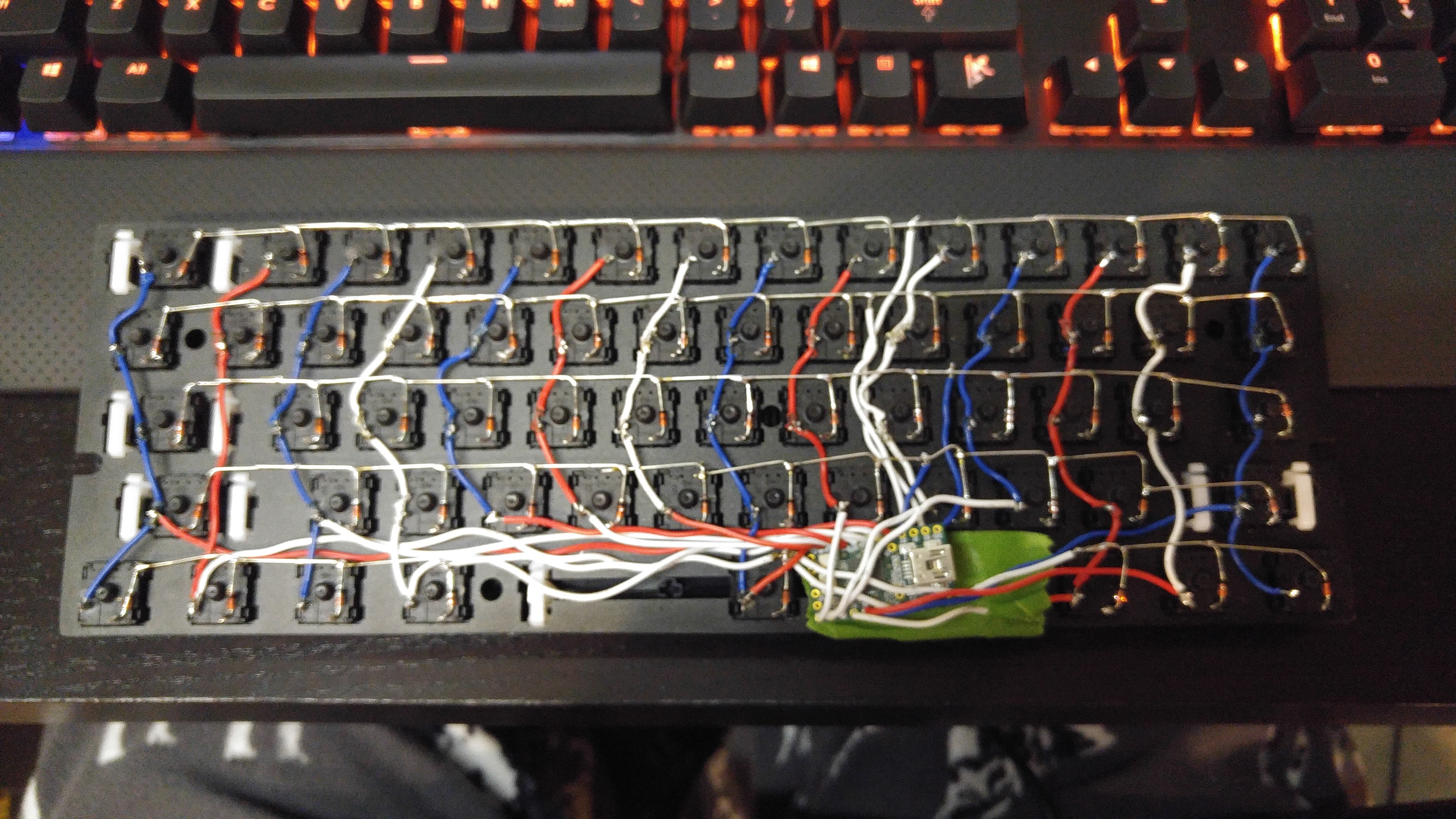

campo123456789 wrote: and when a key is pressed it is inputing all the keys in that column rather then just the one.
Can you show your wiring? Is outer part of diodes black when you solder it?

i don't think so i have checked over them again but here is what they look like (please excuse the large blobs ) do you think that code it ok? i don't have an led either for the caps if that changes anything?
https://lh3.googleusercontent.com/5Lmz1 ... 53-h927-no

I think I had this problem once. In my case, what was supposed to be columns were my rows and vice versa.

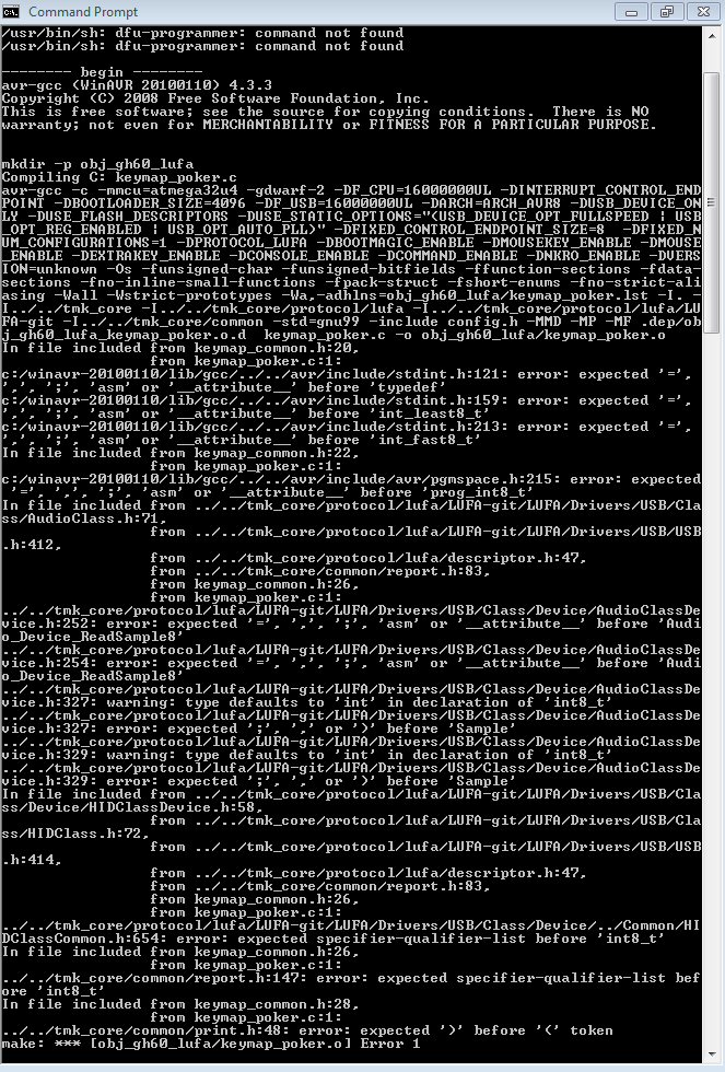

Amazing guide. I'm nearly at the end but I am having massive issues.
I'm getting a plethora of error messages... this one is the current one (I'm a noob at code so If it is a simple mistake, I am sorry)
Compiling C: keymap_poker.c
avr-gcc -c -mmcu=atmega32u4 -gdwarf-2 -DF_CPU=16000000UL -DINTERRUPT_CONTROL_ENDPOINT -DBOOTLOADER_SIZE=4096 -DF_USB=16000000UL -DARCH=ARCH_AVR8 -DUSB_DEVICE_ONLY -DUSE_FLASH_DESCRIPTORS -DUSE_STATIC_OPTIONS="(USB_DEVICE_OPT_FULLSPEED | USB_OPT_REG_ENABLED | USB_OPT_AUTO_PLL)" -DFIXED_CONTROL_ENDPOINT_SIZE=8  -DFIXED_NUM_CONFIGURATIONS=1 -DPROTOCOL_LUFA -DBOOTMAGIC_ENABLE -DMOUSEKEY_ENABLE -DMOUSE_ENABLE -DEXTRAKEY_ENABLE -DCONSOLE_ENABLE -DCOMMAND_ENABLE -DNKRO_ENABLE -DVERSION=unknown -Os -funsigned-char -funsigned-bitfields -ffunction-sections -fdata-sections -fno-inline-small-functions -fpack-struct -fshort-enums -fno-strict-aliasing -Wall -Wstrict-prototypes -Wa,-adhlns=obj_gh60_lufa/keymap_poker.lst -I. -I../../tmk_core -I../../tmk_core/protocol/lufa -I../../tmk_core/protocol/lufa/LUFA-git -I../../tmk_core/common -std=gnu99 -include config.h -MMD -MP -MF .dep/obj_gh60_lufa_keymap_poker.o.d  keymap_poker.c -o obj_gh60_lufa/keymap_poker.o
keymap_poker.c:9:85: error: macro "KEYMAP" requires 62 arguments, but only 61 given
keymap_poker.c:5: error: 'KEYMAP' undeclared here (not in a function)
keymap_poker.c:16:76: error: macro "KEYMAP" requires 62 arguments, but only 60 given
keymap_poker.c:18: error: conflicting types for 'fn_actions'
keymap_common.h:34: error: previous declaration of 'fn_actions' was here
keymap_poker.c:19: error: 'layer' undeclared here (not in a function)
keymap_poker.c:19: error: invalid operands to binary / (have 'const uint8_t (*)[5][14]' and 'int')
keymap_poker.c:19: error: invalid operands to binary << (have 'const uint8_t (*)[5][14]' and 'int')
keymap_poker.c:19: error: invalid operands to binary | (have 'int' and 'const uint8_t (*)[5][14]')
keymap_poker.c:19: error: invalid operands to binary % (have 'const uint8_t (*)[5][14]' and 'int')
keymap_poker.c:19: error: invalid operands to binary << (have 'int' and 'const uint8_t (*)[5][14]')
keymap_poker.c:19: error: invalid operands to binary & (have 'const uint8_t (*)[5][14]' and 'int')
keymap_poker.c:19: error: invalid operands to binary | (have 'const uint8_t (*)[5][14]' and 'const uint8_t (*)[5][14]')
keymap_poker.c:20: error: initializer element is not constant
keymap_poker.c:20: error: (near initialization for 'fn_actions[1]')
make: *** [obj_gh60_lufa/keymap_poker.o] Error 1

Re-compiled and I'm still getting a gnarly error message...
mkdir -p obj_gh60_lufa
keymap_poker.c:9: error: 'KC_ALT' undeclared here (not in a function)
keymap_poker.c:16:87: error: macro "KEYMAP" requires 62 arguments, but only 60 given
keymap_poker.c:12: error: expected '}' before 'KEYMAP'
keymap_poker.c:12: error: expected '}' before '{' token
Which to me is saying that there should be a '}' before '{' on line 12. But that makes no sense what so ever

Pinout
Col : 0 1 2 3 4 5 6 7 8 9 10 11 12 13
pin : b3 b7 b2 d0 d1 d2 d3 c6 c7 f7 b6 b5 b4 d7
Row : 0 1 2 3 4
pin : f6 f5 f4 f1 f0
Here are some photos of the underside and topside...
http://imgur.com/a/Ulcbh
And the code...
Keymap_poker.c
http://pastebin.com/T4kLEcM4
Keymap_common.h
http://pastebin.com/dfBZZMjW
matrix.c
http://pastebin.com/P7Z0dmc4
UPDATE
tinkered with the code and it "works" It doesn't comply with my desktop pc running windows, but I plugged it into my macbook and "most" of the keys work. Some feel a bit funny but i assume the contacts need to be cleaned as these were salvaged keys. The ones that dont work have poor connections from where ive broken the contact from the column wire (I ran out of flux for a decent solder)
That aside, what could be causing it to play up on my pc but not my mac?

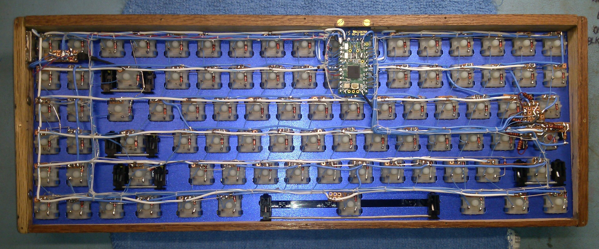

richfiles
19 Jul 2016, 22:28
So, I'm pretty new to C programming. The last time I touched programming was TI-BASIC in the 90s, and TRS-80/Commodore BASIC in the 80s. C is not proving to flow all that intuitively through my tangled jumble of neurons. :roll: No, my profession and life long hobby has always been hardware. I've built walking robots with no CPUs, no software at all. Just hardware. It's what I do, so it comes as no surprise that I'd go all out on the hardware aspect of my keyboard... and run into a brick wall at the software side of things. :?:
So, belive I've successfully defined the rows and columns (first section). I'm now on to the second section, where I need to define the matrix and the key map. I have a question regarding this stage. The following image is my matrix layout, as viewed from above the keyboard.
/* Column pin configuration
 * col: 0   1   2   3   4   5   6   7   8   9   10  11  12
 * pin: F0  F1  F4  F5  F6  D4  D5  D2  B7  B3  B2  B1  B0
/* Row pin configuration
 * row: 0   1   2   3   4   5   6
 * pin: F7  B6  B5  B4  C7  C6  D3
I have a VERY dense matrix of 13x7. It was necessary to keep enough I/O pins open for the Caps Lock LED, Backlight LED, pair of I2C pins, and a sense pin. The sense pin and I2C is so it can detect if a yet to be built, magnetically attachable number pad is attached, and whether or not it should poll a port expander over I2C. I figure, software is changeable, so i can re-do code later, once I actually have the number pad built, and have half a clue what the heck I'm actually doing.
Anyway, in order to keep the matrix small, I have a super dense layout with almost no gaps, and row 6 is actually a tight cluster of keys in the top right corner. Only three intersections in the entire matrix go unused (c0-r6, c1-r6, and c12-r4). This means my matrix does not directly conform to the physical key layout in some areas (all of Row 6 is in the top right corner, and the bottom row is "electrically" compressed to one side, and then includes the bottom right corner keys as well).
What I want to know, is where the matrix definitions need to be ordered by electrical sequence, or if the values are arbitrary, and allow for physical sequence (as long as the values are correctly defined). The obviously functional way is to lay the matrix out electrically. This seems to be what's assumed.
My question then is which (if either, or both, or neither, or 42 :mrgreen: ) would be correct?
Electrically based layout:

Hi guys, first time here. I've been working on my own custom CAD-usage keyboard, and so far i've been able to get everything working except for the 15th Column. The layout of the keyboard is near fullsize (101keys), and so i've had to do a lot of weird wiring of traces in order to meet the I/O pin count of the teensy, thus confusing myself.. haha..
Pics for a general idea of layout first:
Those are the columns of the PCB, flipped. it is a custom PCB, and the numpad is on the left for easy CAD value inputs.
Previously, Column 16 as a whole would not work, and would only be activated by keypressing column 15, and so I added the 1UL<<16 to my matrix.c, fixing column 16, but the issue with column 15 did not go away.
heres my config.h
/* key matrix size */
#define MATRIX_ROWS 6
#define MATRIX_COLS 17
my matrix.c
 * col: 0   1   2   3   4   5   6   7   8   9   10  11  12  13  14  15  16
 * pin: F0  F1  F5  B5  D7  D4  F4  F6  F7  B6  B2  B4  D5  C7  D3  D2  D0
static void  init_cols(void)
    // Input with pull-up(DDR:0, PORT:1)
    DDRF  &= ~(1<<0 | 1<<1 | 1<<4 | 1<<5 | 1<<6 | 1<<7);
    PORTF |=  (1<<0 | 1<<1 | 1<<4 | 1<<5 | 1<<6 | 1<<7);
    DDRD  &= ~(1<<0 | 1<<2 | 1<<3 | 1<<4 | 1<<5 | 1<<7);
    PORTD |=  (1<<0 | 1<<2 | 1<<3 | 1<<4 | 1<<5 | 1<<7);
    DDRC  &= ~(1<<7);
    PORTC |=  (1<<7);
    DDRB  &= ~(1<<2 | 1<<4 | 1<<5 | 1<<6);
    PORTB |=  (1<<2 | 1<<4 | 1<<5 | 1<<6);
static matrix_row_t read_cols(void)
    return (PINF&(1<<0) ? 0 : (1<<0)) |
           (PINF&(1<<1) ? 0 : (1<<1)) |
           (PINF&(1<<4) ? 0 : (1<<6)) |
           (PINF&(1<<5) ? 0 : (1<<2)) |
           (PINF&(1<<6) ? 0 : (1<<7)) |
           (PINF&(1<<7) ? 0 : (1<<8)) |
           (PINC&(1<<7) ? 0 : (1<<13)) |
           (PINB&(1<<2) ? 0 : (1<<10)) |
           (PINB&(1<<4) ? 0 : (1<<11)) |
           (PINB&(1<<5) ? 0 : (1<<3)) |
           (PINB&(1<<6) ? 0 : (1<<9)) |
           (PIND&(1<<0) ? 0 : (1UL<<16)) |
           (PIND&(1<<2) ? 0 : (1<<15)) |
           (PIND&(1<<3) ? 0 : (1<<14)) |
           (PIND&(1<<4) ? 0 : (1<<5)) |
           (PIND&(1<<5) ? 0 : (1<<12)) |
           (PIND&(1<<7) ? 0 : (1<<4)) ;
 * row: 0   1   2   3   4   5
 * pin: B1  B3  B7  R4  R5  R6
static void unselect_rows(void)
    // Hi-Z(DDR:0, PORT:0) to unselect
    DDRD  &= ~0b00000010;
    PORTD &= ~0b00000010;
    DDRB  &= ~0b10001011;
    PORTB &= ~0b10001011;
    DDRC  &= ~0b01000000;
    PORTC &= ~0b01000000;
static void select_row(uint8_t row)
    // Output low(DDR:1, PORT:0) to select
    switch (row) {
        case 0:
            DDRB  |= (1<<1);
            PORTB &= ~(1<<1);
            break;
        case 1:
            DDRB  |= (1<<3);
            PORTB &= ~(1<<3);
            break;
        case 2:
            DDRB  |= (1<<7);
            PORTB &= ~(1<<7);
            break;
        case 3:
            DDRB  |= (1<<0);
            PORTB &= ~(1<<0);
            break;
        case 4:
            DDRD  |= (1<<1);
            PORTD &= ~(1<<1);
            break;
        case 5:
            DDRC  |= (1<<6);
            PORTC &= ~(1<<6);
            break;
and my keymap_common.h
#define KEYMAP( \
         K01, K02, K03, K04, K05, K06, K07, K08, K09, K0A, K0B, K0C, K0D, K0E, K0F, K0G, \
    K10, K11, K12, K13, K14, K15, K16, K17, K18, K19, K1A, K1B, K1C, K1D, K1E, K1F, K1G, \
    K20, K21, K22, K23, K24, K25, K26, K27, K28, K29, K2A, K2B, K2C, K2D, K2E, K2F, K2G, \
    K30, K31, K32, K33, K34, K35, K36, K37, K38, K39, K3A, K3B, K3C, K3D, K3E, K3F, K3G, \
    K40, K41, K42, K43, K44, K45, K46, K47, K48, K49, K4A, K4B, K4C, K4D, K4E, K4F, K4G, \
    K50, K51, K52, K53, K54, K55, K56, K57, K58, K59, K5A, K5B, K5C, K5D, K5E, K5F, K5G  \
    { KC_NO,    KC_##K01, KC_##K02, KC_##K03, KC_##K04, KC_##K05, KC_##K06, KC_##K07, KC_##K08, KC_##K09, KC_##K0A, KC_##K0B, KC_##K0C, KC_##K0D, KC_##K0E, KC_##K0F, KC_##K0G }, \
    { KC_##K10, KC_##K11, KC_##K12, KC_##K13, KC_##K14, KC_##K15, KC_##K16, KC_##K17, KC_##K18, KC_##K19, KC_##K1A, KC_##K1B, KC_##K1C, KC_##K1D, KC_##K1E, KC_##K1F, KC_##K1G }, \
    { KC_##K20, KC_##K21, KC_##K22, KC_##K23, KC_##K24, KC_##K25, KC_##K26, KC_##K27, KC_##K28, KC_##K29, KC_##K2A, KC_##K2B, KC_##K2C, KC_##K2D, KC_##K2E, KC_##K2F, KC_##K2G }, \
    { KC_##K30, KC_##K31, KC_##K32, KC_##K33, KC_##K34, KC_##K35, KC_##K36, KC_##K37, KC_##K38, KC_##K39, KC_##K3A, KC_##K3B, KC_##K3C, KC_##K3D, KC_##K3E, KC_##K3F, KC_##K3G }, \
    { KC_##K40, KC_##K41, KC_##K42, KC_##K43, KC_##K44, KC_##K45, KC_##K46, KC_##K47, KC_##K48, KC_##K49, KC_##K4A, KC_##K4B, KC_##K4C, KC_##K4D, KC_##K4E, KC_##K4F, KC_##K4G }, \
    { KC_##K50, KC_##K51, KC_##K52, KC_##K53, KC_##K54, KC_##K55, KC_##K56, KC_##K57, KC_##K58, KC_##K59, KC_##K5A, KC_##K5B, KC_##K5C, KC_##K5D, KC_##K5E, KC_##K5F, KC_##K5G }  \
and finally my keymap_poker.c
#include "keymap_common.h"
const uint8_t PROGMEM keymaps[][MATRIX_ROWS][MATRIX_COLS] = {
    /* 0: qwerty */
    KEYMAP(RGHT, DOWN, LEFT, RCTL, APP, RGUI, RALT, SPC, PPLS, PMNS, LALT, LGUI, LCTL, P0, PDOT, PENT, \
           END, UP, RSFT, SLSH, DOT, COMM, M, N, B, V, C, X, Z, LSFT, P3, P2, KP_1, \
           DEL, ENT, QUOT, SCLN, L, K, J, H, G, F, D, S, A, CAPS, P6, P5, P4, \
           BSLS, RBRC, LBRC, P, O, I, U, Y, T, R, E, W, Q, TAB, P9, P8, P7, \
           BSPC, EQL, MINS, 0, 9, 8, 7, 6, 5, 4, 3, 2, 1, GRV, NLCK, SLSH, PAST, \
           PGDOWN, F12, F11, F10, F9, F8, F7, F6, F5, F4, F3, F2, F1, ESC, INS, HOME, PGUP),
const uint16_t PROGMEM fn_actions[] = {
I have used a multimeter to check all connections, and there seems to be no short between col 15 and 16 so please tell me if you see anything wrong with the code. I can post more pics if needed, I don't have a schematic, but basically the schematic is: rows connected so that each row contains 17 keys (with exception of bottom row having 16), and 17 columns, making sure that each column touches each row only once. Thanks!
