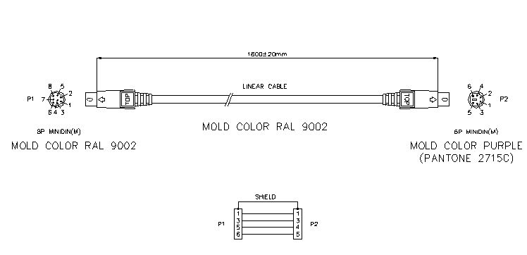

28 Jan 2012, 06:56
kbdfr wrote:(stolen picture)
Make your own Tipro cable using a male/male PS/2 cable: carefully and completely remove the small plastic tongue between the pins on one end of the cable. The plug will now fit into the 8-pin socket of the keyboard (right side of the above picture, left side of course when sitting in front of the keyboard), connect the other end of the cable with the PS/2 socket of your computer, that's it.
The other socket of the Tipro keyboard is where you plug your "normal" keyboard into.
Icarium
28 Jan 2012, 10:23
That's what I did, with the little caveat that I did not have a male/male PS/2 cable and just took two keyboard cables and put them together. Does this actually need 6 pins or something?
I checked my wiring using this (from http://geekhack.org/showthread.php?1738 ... ight=tipro)
