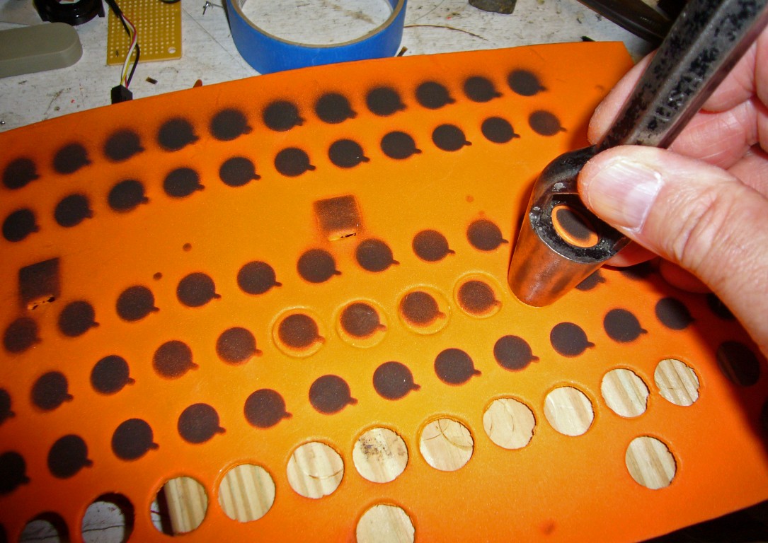

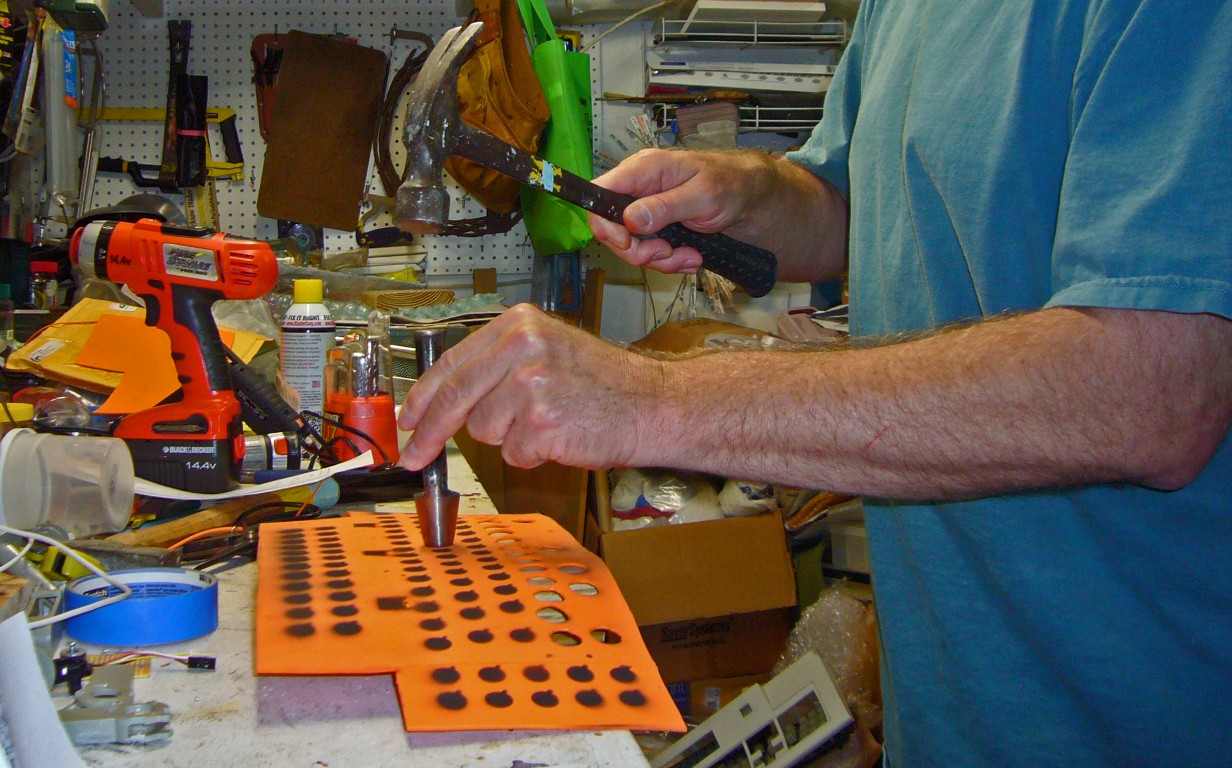

I have used 1/16" (1.5mm) "art foam" from the art supply store several times, and cut it by hand with a punch.
This foam is recommended for scrapbooking as "archival" and acid-free, so I feel pretty good about its longevity. It is very lightweight and fairly firm, but it will compress and bed down easily under pressure. I have never felt any need for glue, the assembly is very tight when you are finished and it will not be moving.
