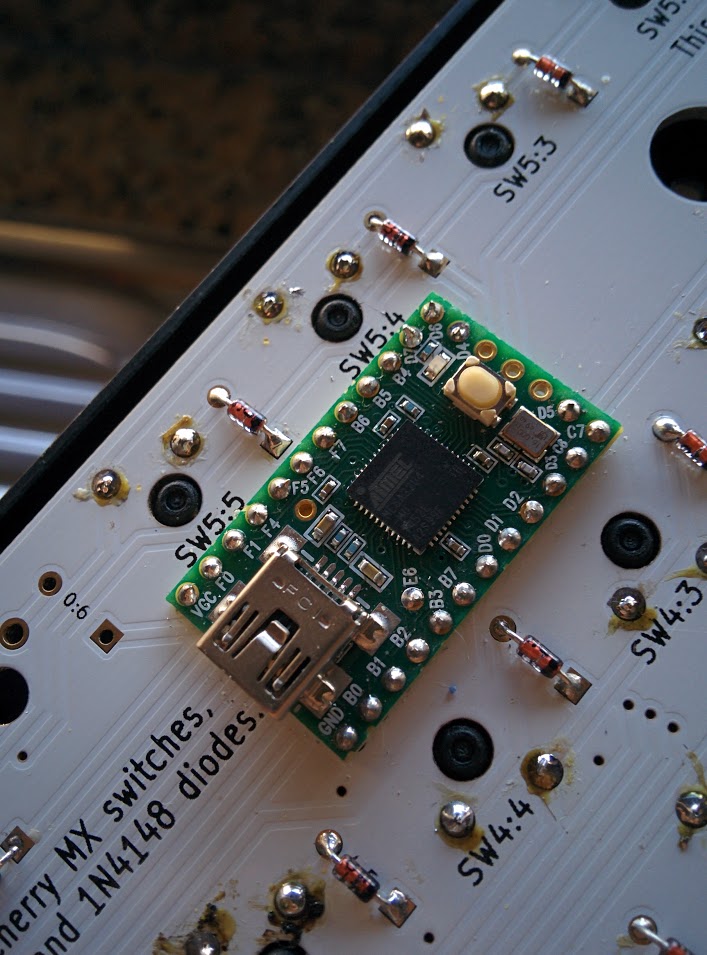

I have purchased a Phantom PCB a long time ago and finally decided to put it on my Filco. The previous owner had it ready for an ANSI layout but I'm using ISO. I already soldered some diodes but the ISO keys (left of z and left of enter) don't even trigger in Switch Hitter. I'm assuming it's a layout issue and I'm wondering how do I solve my problem.
I'm not sure which version of teensy this is since it has been a while since I bought it but I have attached a picture of the thing.
If anyone could point me to a tutorial or something I'd appreciate it

Have a look at Easy AVR, it's one of the firmwares Phantom can use, and it's quite powerful and easy to use.

Thanks for sharing, it was very easy to get it to work!
