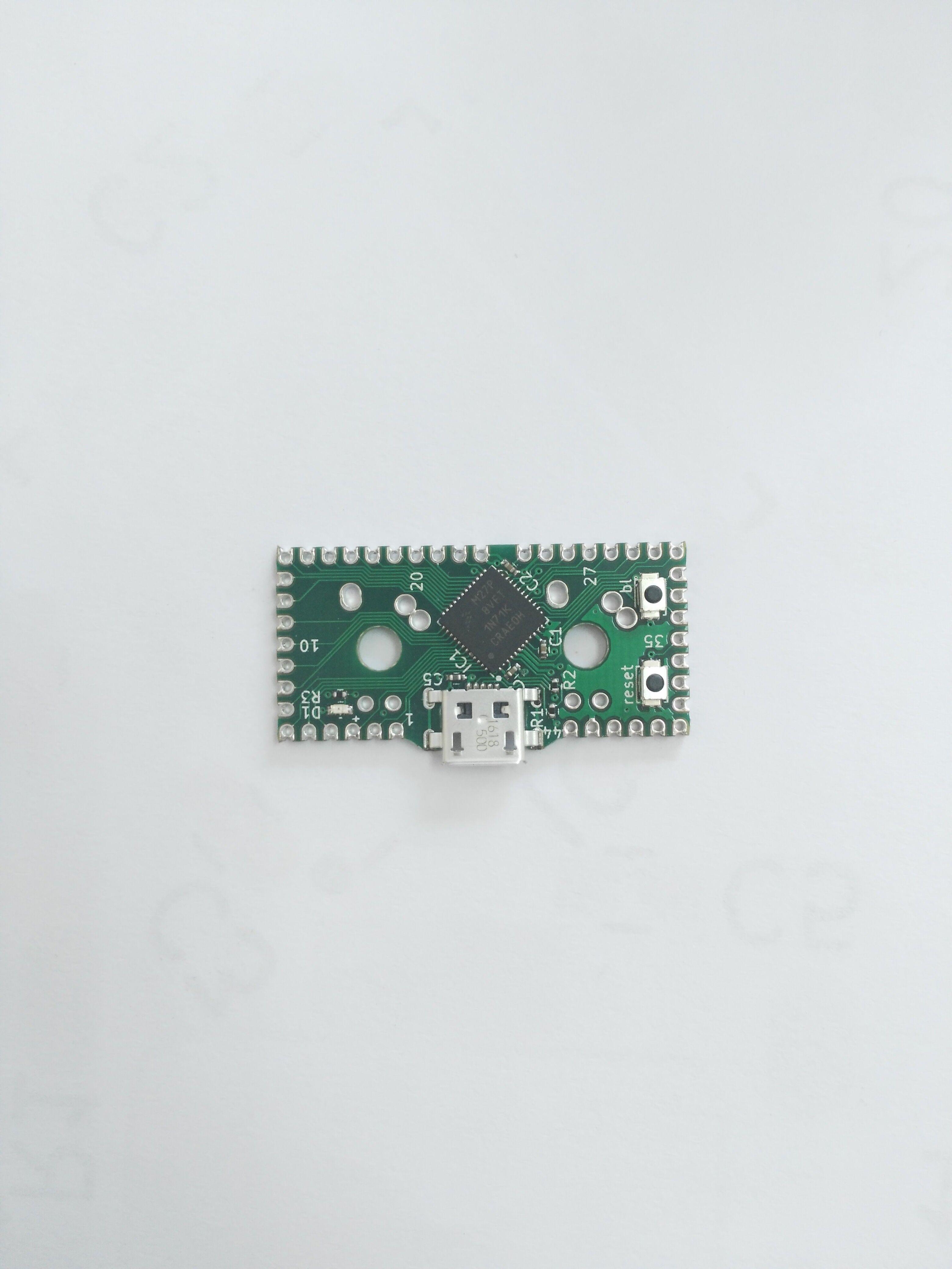

15 Nov 2016, 08:11
Does everything look fine to you?
final assembling pic to confirm.jpg (487.16 KiB) Viewed 6942 times
pandp
15 Nov 2016, 08:47
+1
Waiting for GB :)
pomk
15 Nov 2016, 08:59
There could be a bit more solder on the connectors legs, but that is pretty minor and quite possibly just a cosmetic thing. Nothing else I can see at the moment.

They are finally here. I had no time yet to play with it but I get a weird output by dmesg
[34422.565667] usb 1-2: new full-speed USB device number 14 using xhci_hcd
[34422.700298] hid-generic 0003:15A2:0073.000E: hiddev0,hidraw7: USB HID v1.00 Device [Freescale Semiconductor Inc. Kinetis Bootloader] on usb-0000:00:14.0-2/input0
[34424.411211] usb 1-2: USB disconnect, device number 14
it basically connects and immediately disconnects, but like I said, I just unboxed them. I'll verify that everything is working and then ship to interested parties!
pomk
17 Nov 2016, 15:09
I think that is already a pretty good sign that the board itself at least functions, on some level, as it stays active for a pretty long time considering that it manages to do a handshake with the computer. Have you tried pressing the bl and reset buttons simultaneously when the board is plugged in? First push bl, then reset, then raise reset and last raise bl.
-[°_°]-
17 Nov 2016, 15:28
I tried to reset but it just disconnects after few moments, but I have a feeling this is normal for a firmware free board. we have an LED, right? On which pin is it again? I can try to burn a very simple blinking program.
pomk
17 Nov 2016, 15:59
the led should be lit if PTD7 is high.
