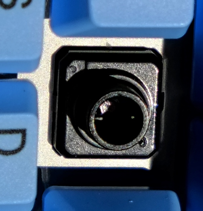

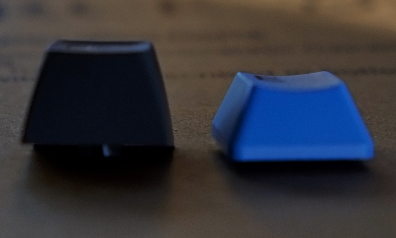

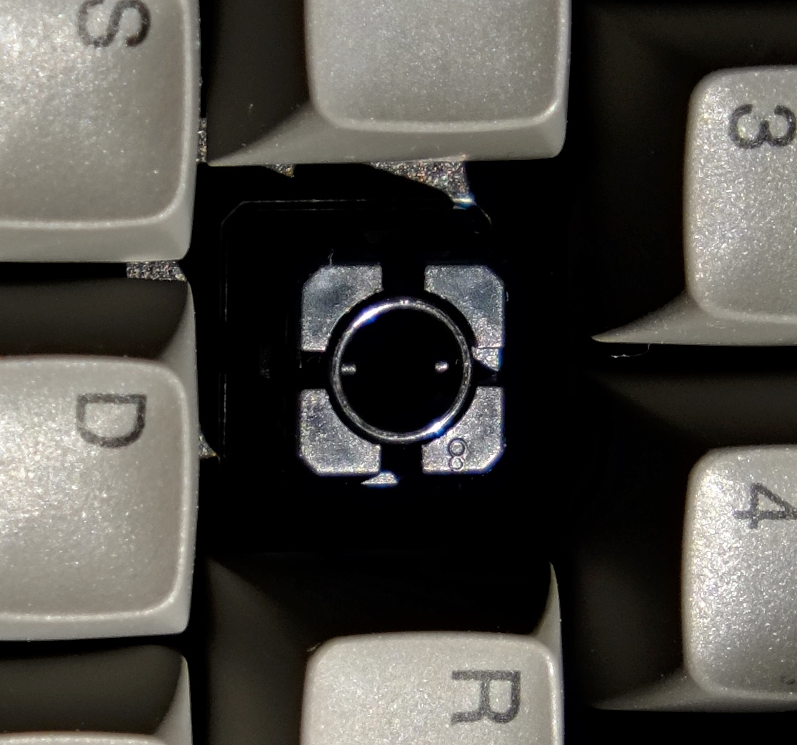

002 wrote: Actually what I meant was you would swap the Hi-pro housings/sliders over. You're right though, you can put Hi-pro caps on a standard Topre switch, but there must be some reason why the Hi-pro housing exists, and if I were doing the mod myself I'd be moving the housings over too. Either way, it's still two Topre keyboards :)
I think the Hi-pro housing probably reduces keycap twist and/or wobble, but have not actually investigated what benefits the taller design has.
yes, it'd seem that you'd need to move the housing/sliders with keys. Without the *reinforced* housing I'd be afraid to break something in prolonged use. Also, while HiPro caps snap right into the *standard* housing, putting standard height keys into HiPro housing is a bit of a challenge.
standard height
standard height
hipro reinforced housing

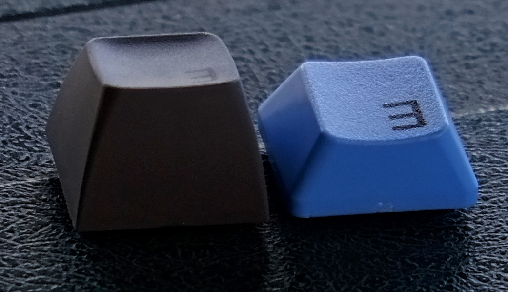

27 Feb 2015, 03:34
Muirium wrote: ... my only traditional Topre board is my HHKB, whose housings aren't removable. So no experiment for me.
:shock: that needs to be remedied. You need more Topre goodness :!: Here's the approximate height dif:
