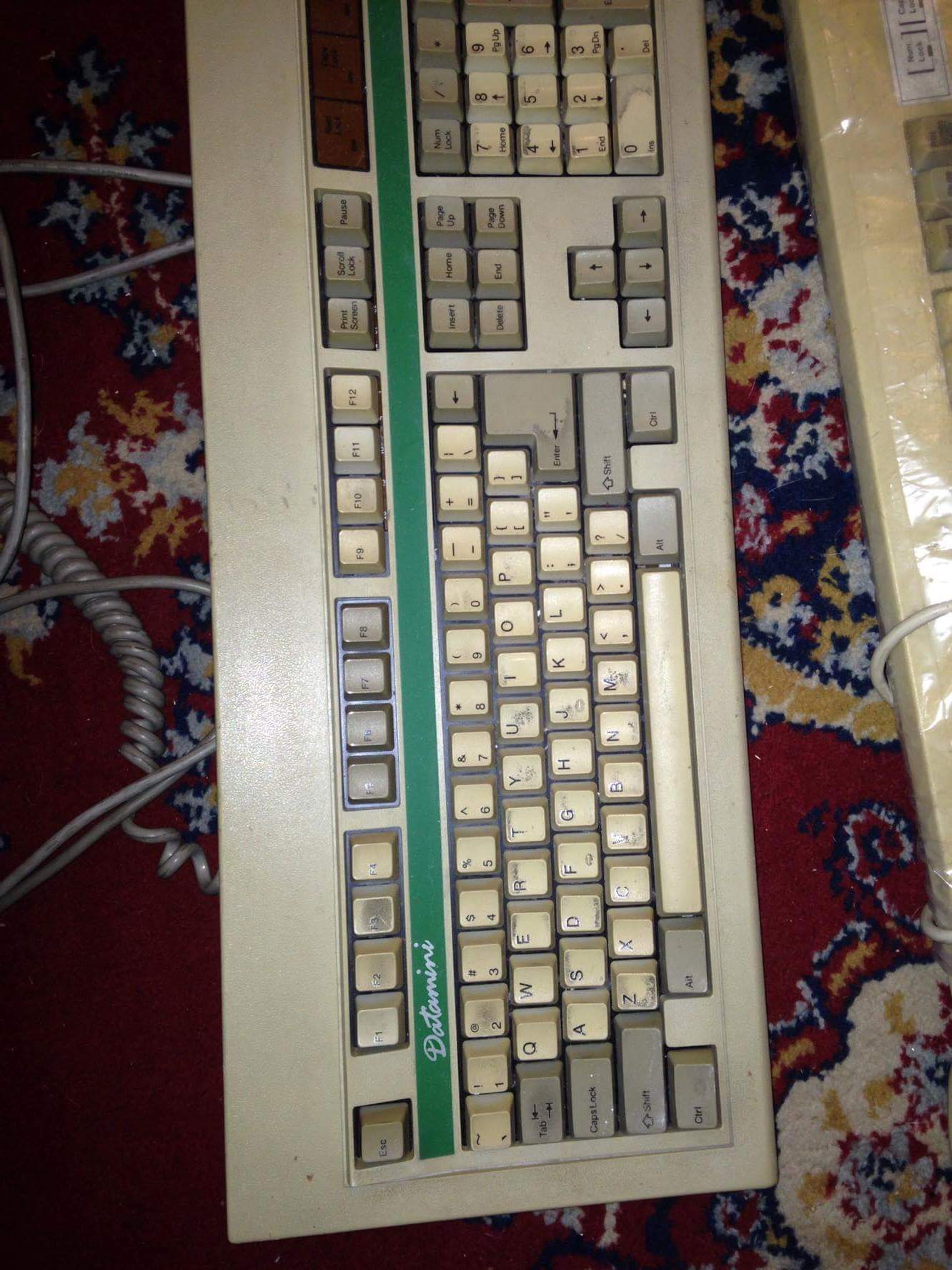

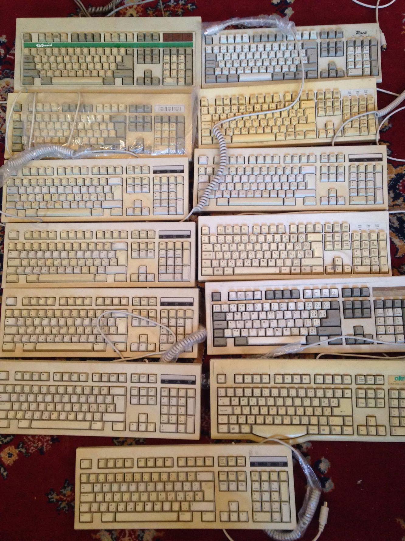

Hi guys. I've just sent the money for theese keyboards. WUTARDOOZ???
I've successfully identified the 6 FREAKING Poor men's topre (BTC D W/ S, big Échap key, with the brown-black very distinct num-scroll-caps badge thingy) (temll me if you want one
), and the Altrix (which is ofc a cheap rbr dome, I have one already. But the others... Can't seem to be able to identify them. But the most interesting one being the top left Model M lookalike.

- Daniel Beardsmore
- Main mouse: MS IMO 1.1
Second from the top on the left is a Chicony, something like a KB-5916 (the [ ] bracket-style LED labels are a give-away, although it took a while for me to remember where I'd seen them).
Top left is not a Mitsumi, but it's very close to a Chicony KB-5181. It's not quite that, nor a 1KB101ATUS, nor a Monterey K101 — it's a common design, and there's a reasonable chance of it being mechanical. Hopefully it's interesting enough to justify whatever you paid for way too many BTCs :P

10$+shipDaniel Beardsmore wrote: Second from the top on the left is a Chicony, something like a KB-5916 (the [ ] bracket-style LED labels are a give-away, although it took a while for me to remember where I'd seen them).

The guy sent me some more pictures. I've searched for the magic keywords and found this: http://img3.picload.org/image/lopagri/w1ssv1j.jpg
Seems like MX Blues, and guess what, mine also looks like PCB mount, confirming futaba Clicly or mx something.

- Daniel Beardsmore
Doh, pad printing with selective image coating.
Seeing it more closely, I'm now pretty certain actually it is a Chicony KB-5181.

- Daniel Beardsmore
Not sure. The 5191 was often PCB mounted, but that to me looks like a black painted plate, and 5181 with MX Blue is confirmed to exist in plate mount. It's the case that gets a bad rap, though.
