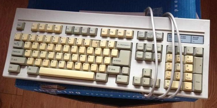

Cool, thanks for confirmingIKSLM wrote:So i bought this keyboard and you were completely right Chyros. It is a Datacomp with plate mounted clicky Futabas. It was terribly dirty and is now being cleaned, still the switches are smooth as Futabas should be. Also, the caps are lovely low profile doubleshots and there's a lot of metal in there.Chyros wrote: Datacomp. That model comes with Futaba clickies, maybe other switches too but none that I know of.

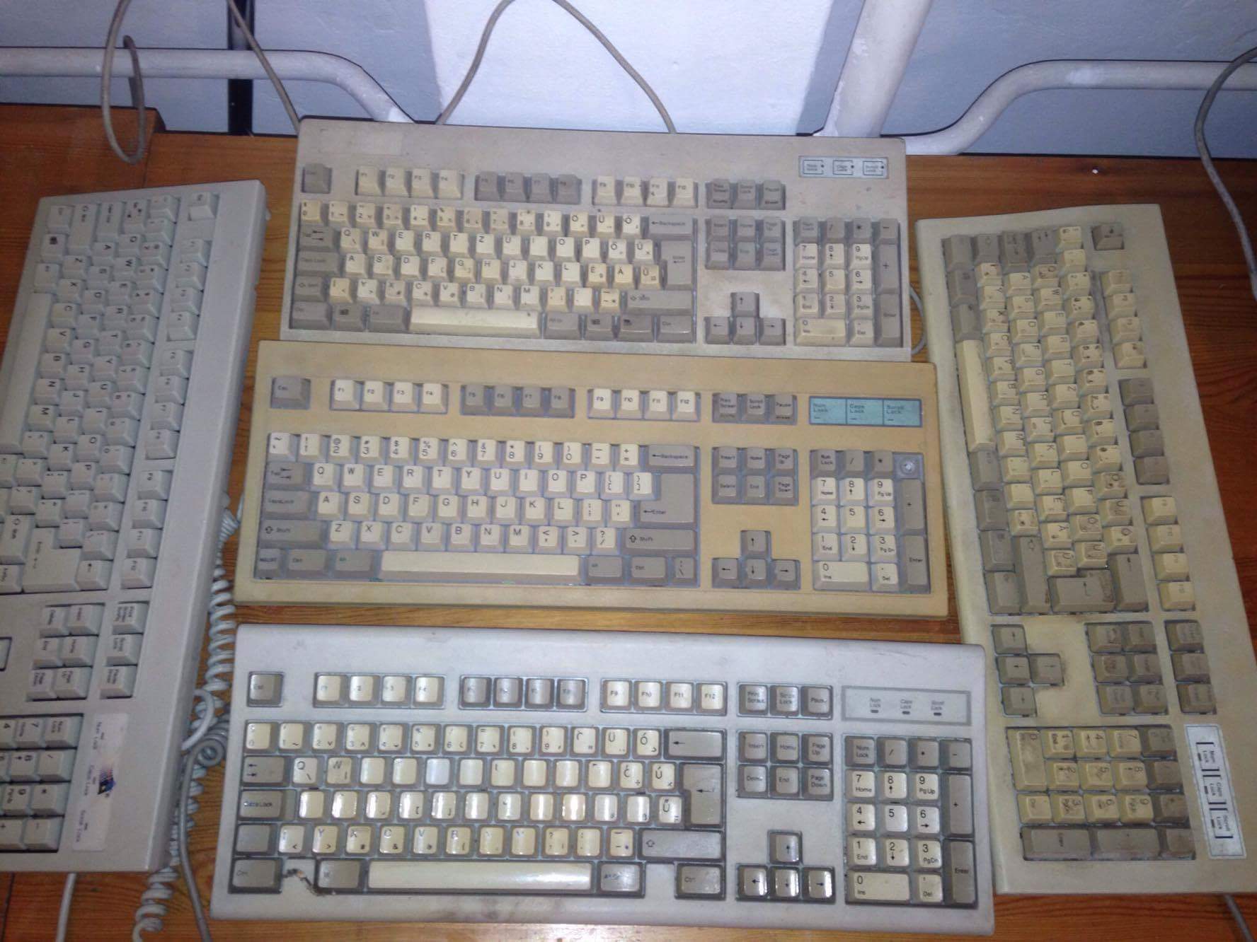

Pretty sure those are all domes, with a couple of the older ones being dome with slider. That one on the bottom with the missing F4 key should be a BTC dome with slider - pretty good as far as domes go from what I hear. They all look like they were pulled straight out of the landfill though...I wouldn't bother with any of em. LOL at the one with nailpolish for key legends.thebluefox wrote: Do you recognize any of the older keyboards?
https://postimg.org/gallery/odle4ftw/

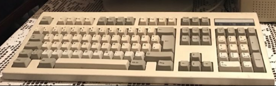

I know what it is , but lets play guess the exact model number and see who wins

OK, I'll be cannon-fodder, but just once. G80-11914?
(edit: and if it is an 11914 I'll go for LUMEU-2 since that's the only code I've seen it with!

Bottom/left looks like a Cherry G83-6000, winkeyless. Rubber dome. Keys are the same as for Cherry G80-series on the top but with different stem so NOT compatible. Get it only if you need a special key and can do a stem-transplant.thebluefox wrote: Do you recognize any of the older keyboards?
The BTC rubber dome is a BTC 5139 where the un-stabilised keys are compatible and in same as DCS profile. Stabilised keys are probably not though.

The BTC is woth saving. Pretty nice board. I actually really like it, and use it regularly. And my father also likes it, It actually has hungarian legends (he can't touch type, and can't use an ANSI keyboard with hungarian layout, the 102nd key, í and Í being Alt+J and Alt+I for capital)thebluefox wrote: Do you recognize any of the older keyboards?

Old Fujitsu — you can see the Fujitsu logo on the back. Probably Fujitsu leaf spring of some variant (maybe third generation from the cylindrical keycaps).

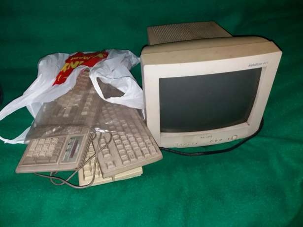

Hi, besides the 53, are these worth anything?
What are these?
What are these?
- received_1430319207038671.jpeg (193.37 KiB) Viewed 10478 times

The one on the left is curious in that the spaces between the keys are black instead of grey. That suggests that there is some sort of plate below the keys. Still a gamble though — if it is mechanical, it's most likely to be the cheap Alps clones (such as [wiki]alps.tw Type T5[/wiki]).

perfect. A keyboard that I can put my generic Tactile Alsp-mount green stuff in. Thanks!Daniel Beardsmore wrote: The one on the left is curious in that the spaces between the keys are black instead of grey. That suggests that there is some sort of plate below the keys. Still a gamble though — if it is mechanical, it's most likely to be the cheap Alps clones (such as [wiki]alps.tw Type T5[/wiki]).

The plate is quite likely to be plastic by that age, which just doesn't sound the same — it's a gamble. You could always ask to see a photo of the switch to see if it's mechanical at all.
The BTC is another gamble, this time on the foam condition.
What's your generic tactile Alps-mount stuff?
