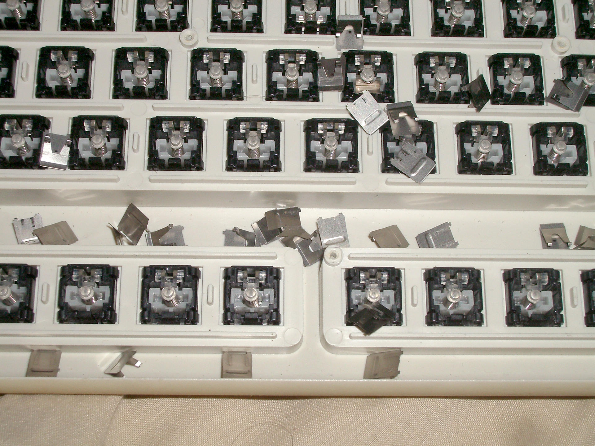

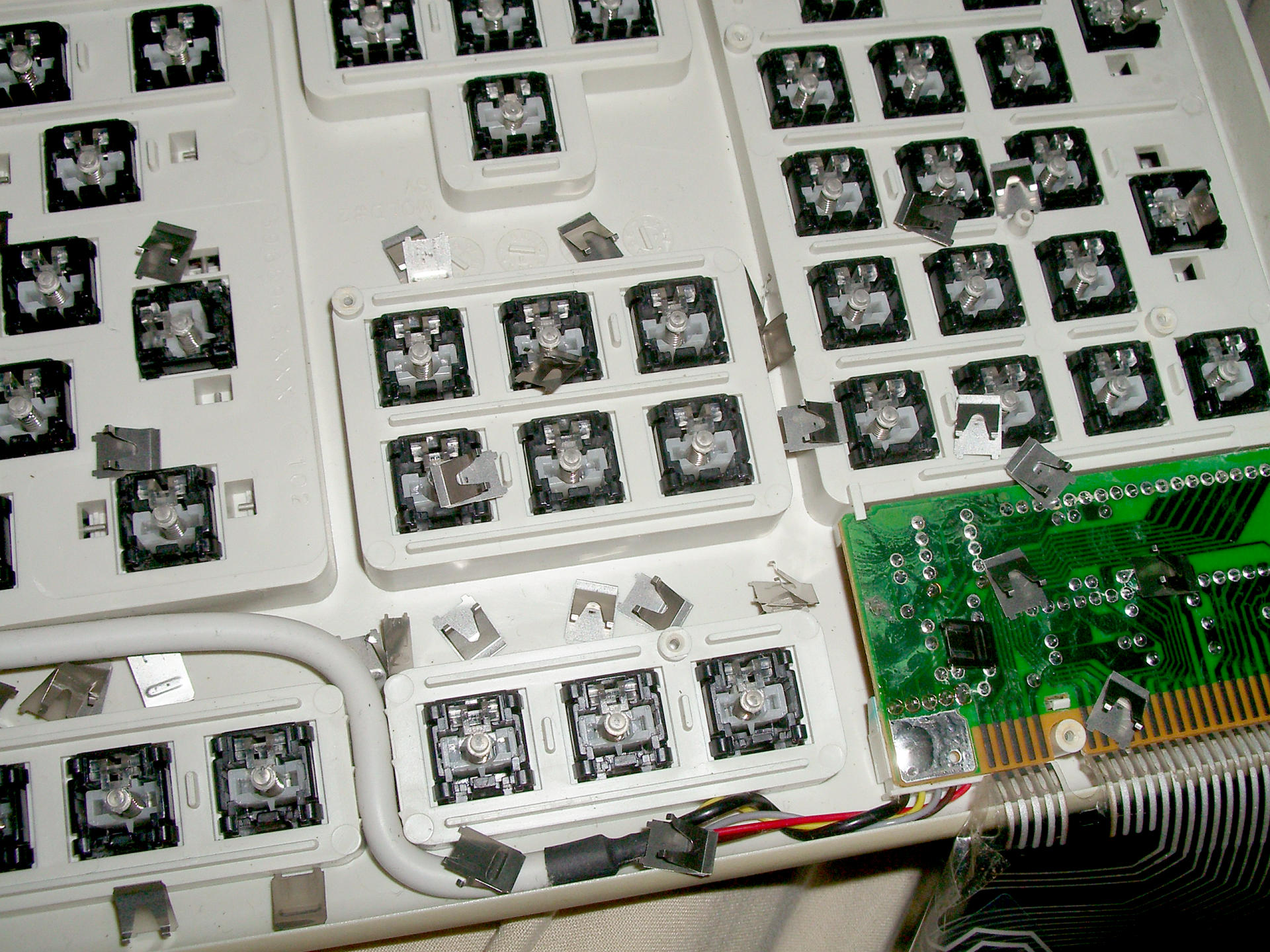

Looking at the Acer switch patent, there's a suggestion that it could potentially be tactile without the click leaf. As such, I decided to de-click mine. The leaf springs are retained a long, pointed peg on the slider, but they're actually fairly easy to remove. Just insert a thin object (e.g. closed pair of tweezers) under one of the slider engaging hooks, pull the hook away from the slider, and then slider the thin object into the middle and push out the click leaf. The whole process should take ten minutes or so.

The end result is curious. The switches are not as light as you'd expect them to be, and they're still a bit balky. The cam mechanism for the actuator isn't snappy, but nor is it smooth. It just feels a bit odd, and it's inconsistent between switches. Some feel almost tactile without the click leaf, and others feel linear. It doesn't give me much faith in the design itself. Even without the click leaf it still feels a bit ropey.
