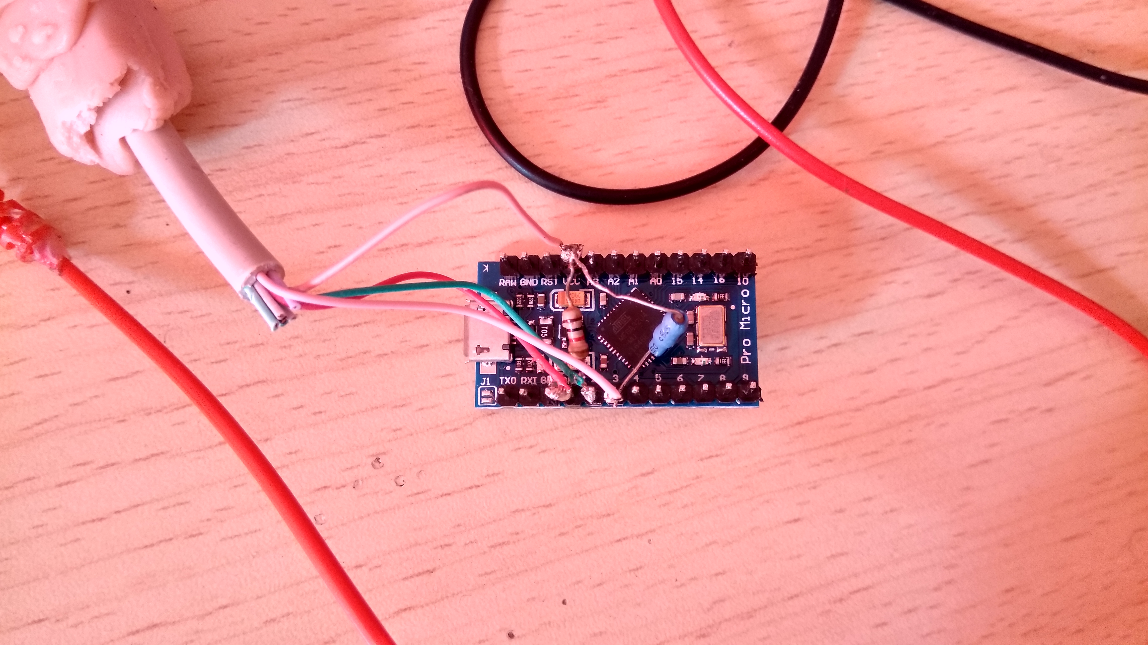

03 Sep 2017, 18:22
OldIsNew wrote: Image
I'll start out by admitting that when it comes to hardware I am useless; to make things worse, I seem to lack the basic knowledge that would let me gather the information I need just from reading threads like this one. I'm straight up confused and need a bit of baby guidance, so to speak (the programming aspect, on the other hand, isn't looking difficult and I'll probably get by nicely once I get to it).
I bought a few Pingmasters, and I want to actually use 'em; I do not want to open them up (see above) or even cut their cord (see above), so I prefer to have an external solution, such as the one in the quoted picture, that would not modify the keeb itself in any way, and I want to learn how to do it myself.
But... I don't fully understand what I am looking at in the picture. Please fill in the blanks and correct the mistakes I've made here:
- The keyboard's plug is plugged to a _________ (DB-9 adapter to ???), of which the green bit IS an integral part.
- The green bit connects to the wires with NO soldering required on this part.
- The four wires connect on their other ends to a pro micro; they ARE soldered here.
I've seen "ProMicro", "pro micro", "pro micro controller", "teensy" and other terms used interchangeably. What is the exact name of this part? Searching for "promicro controller", I've found 5V and 3.3V models. Which one is this?
WHERE do I buy those?
Thanks.

03 Sep 2017, 18:54
I used a DB-9 breakout board from Amazon, can solder to it, but I used the screw terminals (no soldering) and they seem to work fine.
https://www.amazon.com/gp/product/B00WW ... UTF8&psc=1
The microcontroller board I used is a Teensy 2.0, which can also get from Amazon (or PJRC directly), and yes the wires are soldered to the Teensy (the Teensy 2.0 is 5V). :
https://www.amazon.com/gp/product/B00NC ... UTF8&psc=1
This is some wiring info from TMK documentaton:
Keyboard Plug from front:
DSUB-9
\ N 2 3 4 5 /
\ N N N N /
2 GND
3 VCC 5V
4 DATA
5 CLOCK
N No connection/No pin.
Connection
In case of using ATMega32U4/U2 (EDIT: The Teensy 2.0 uses the ATMega32U4)
1. Supply power with VCC and GND.
2. Connect CLOCK to PD1 and DATA to PD0. You can change pin with config.h.
3. Optionally you may need pull-up resistor. 1KOhm probably work.
A couple helpful links, github for the firmware hex file to load on the Teensy and tmk-kbd has firmware file and editor for the keyboard layout:
https://github.com/tmk/tmk_keyboard/tre ... usb/binary
http://www.tmk-kbd.com/tmk_keyboard/edi ... 4_usb_alps
