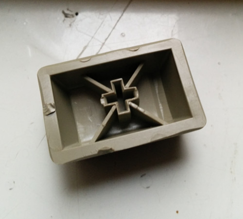

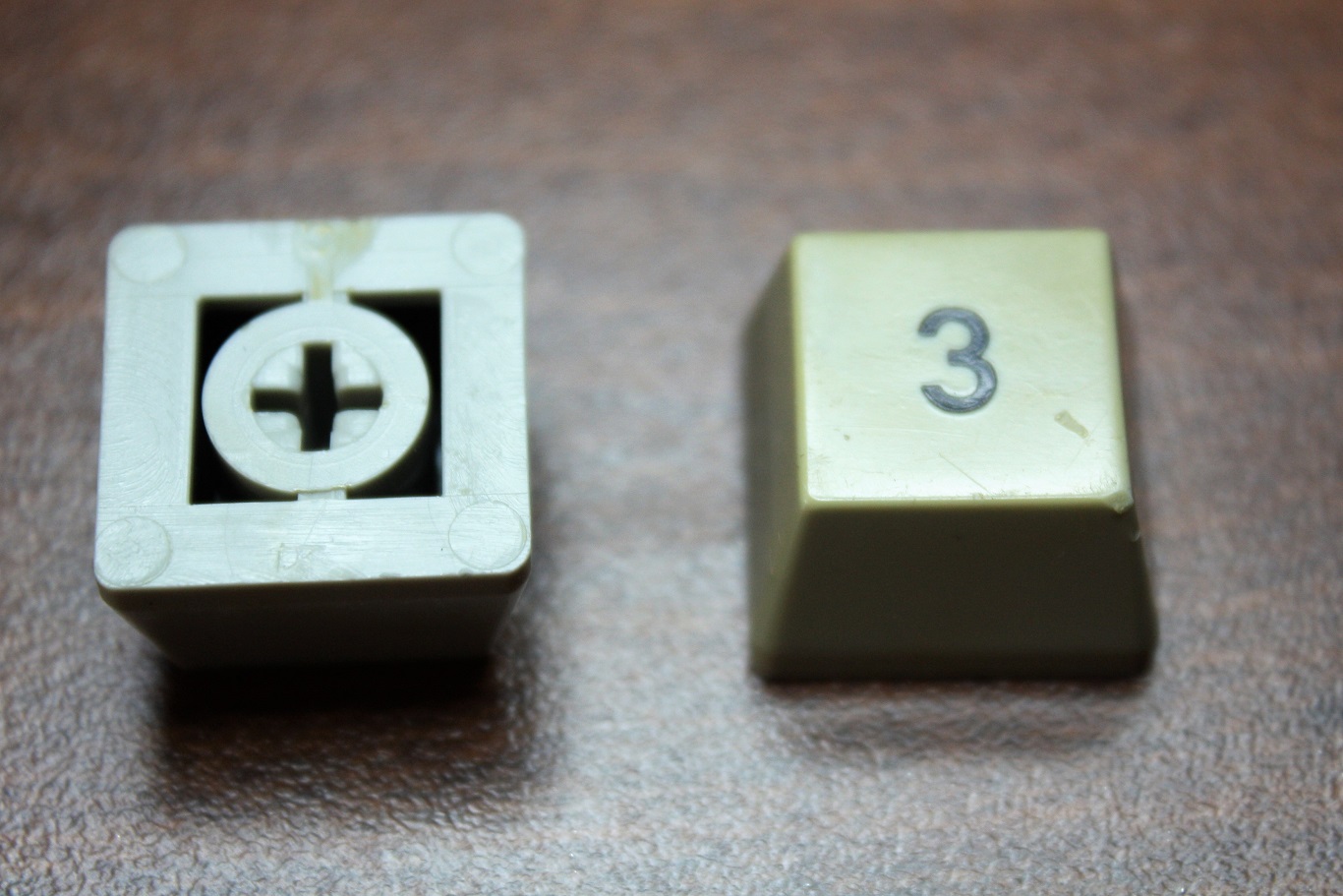

I recently acquired a numeric keypad just to see what it was made of because it looked old. Well, I just removed the key caps and I think I've found the thickest doubleshots ever. They are definitely double shots because I can see the black plastic inside. Thought you guys might like to see them.

Now those are some chunky key caps. Any pictures of the switches?

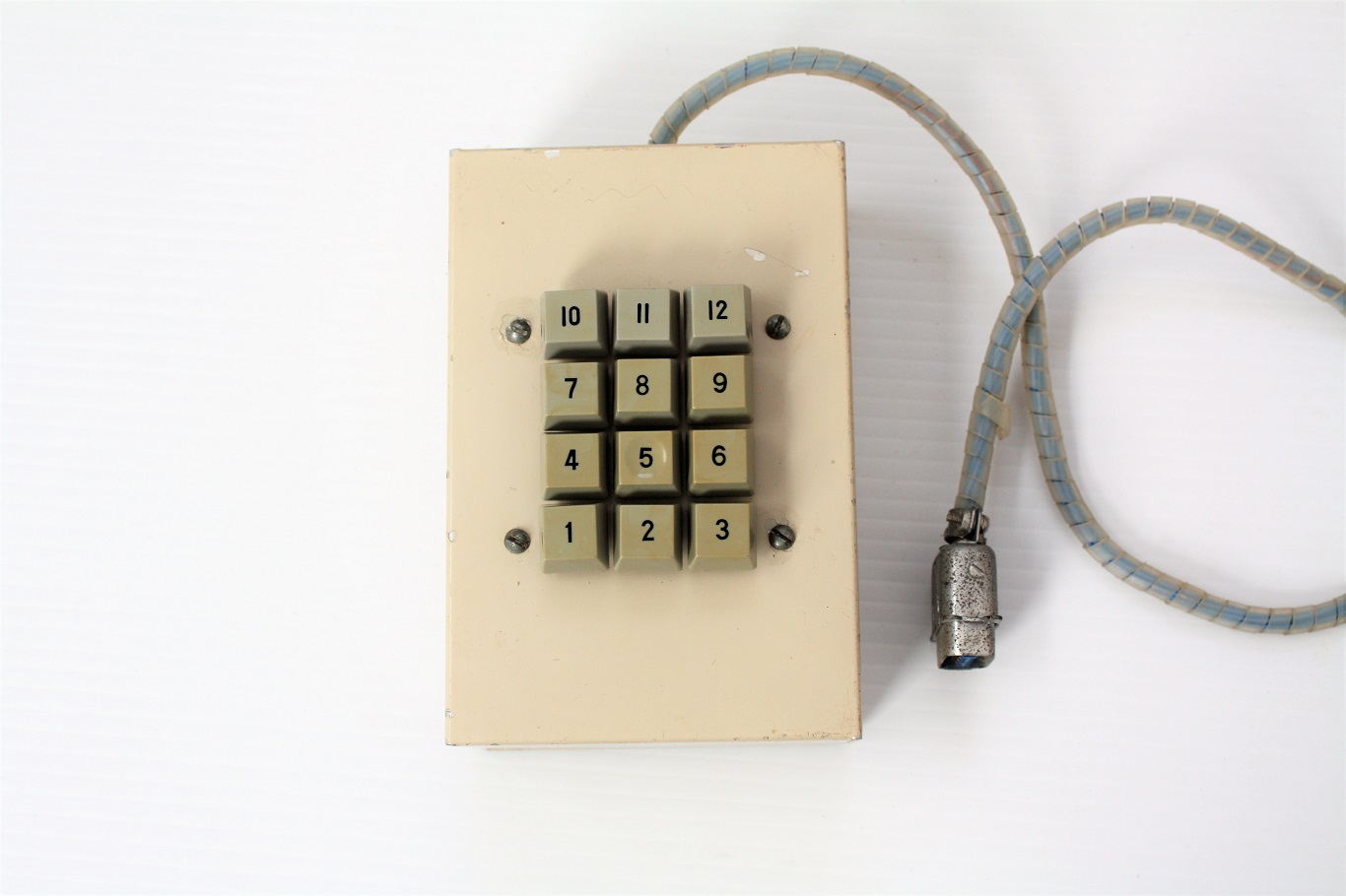

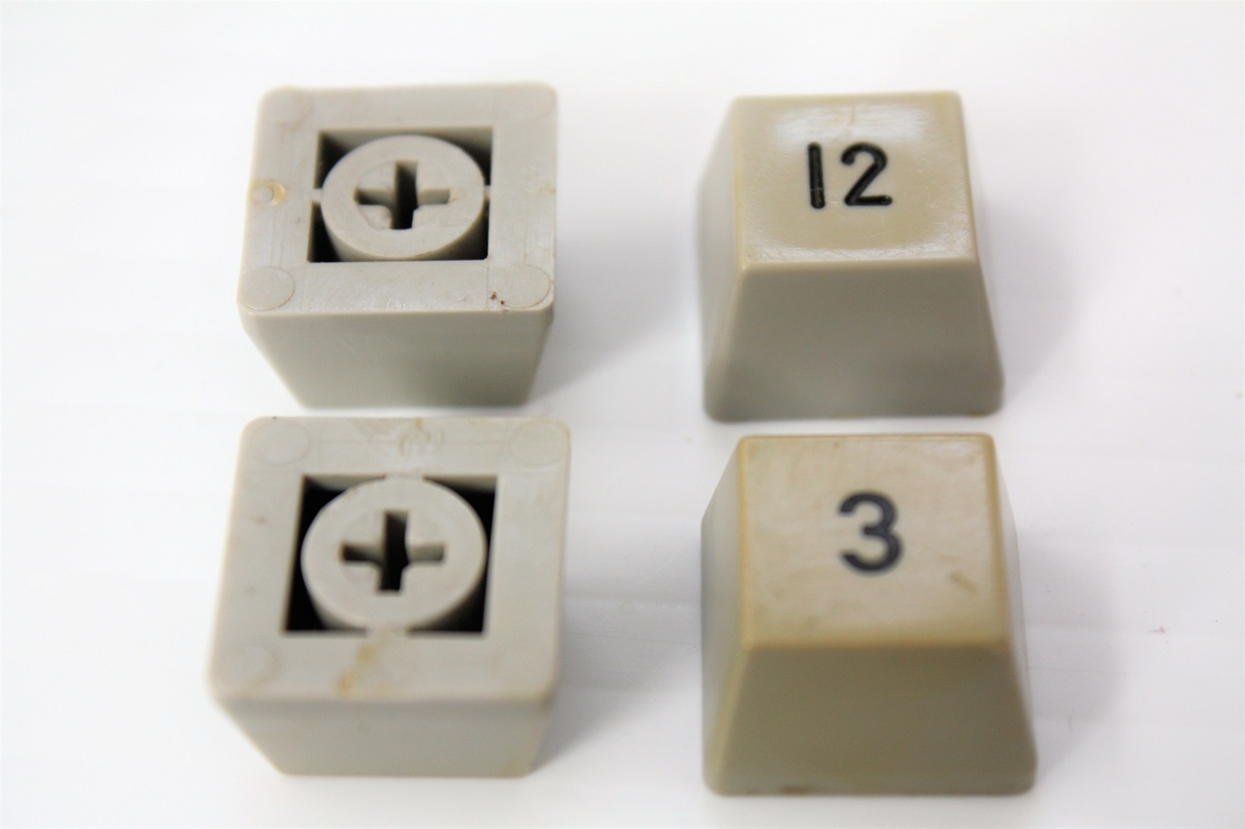

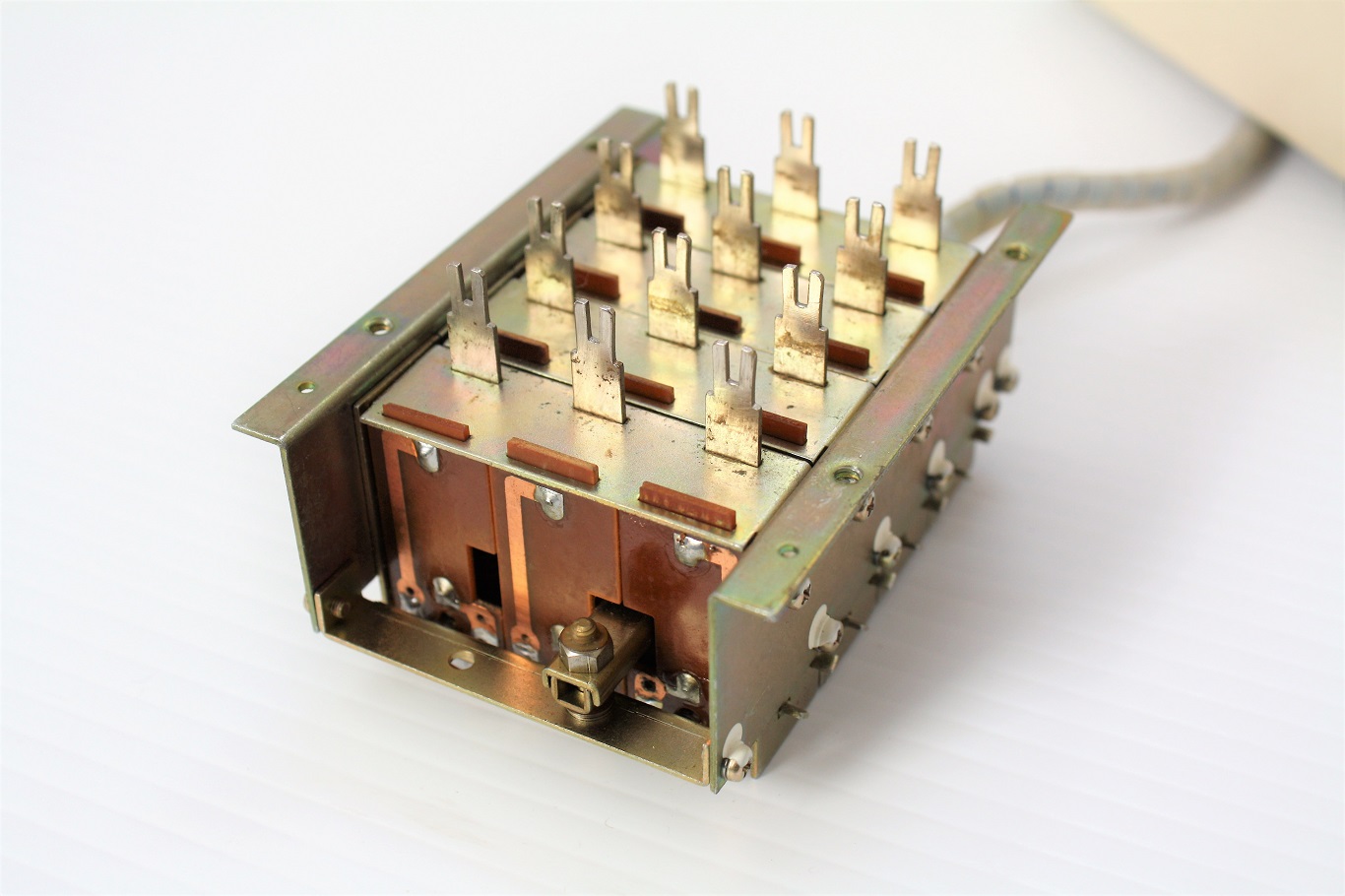

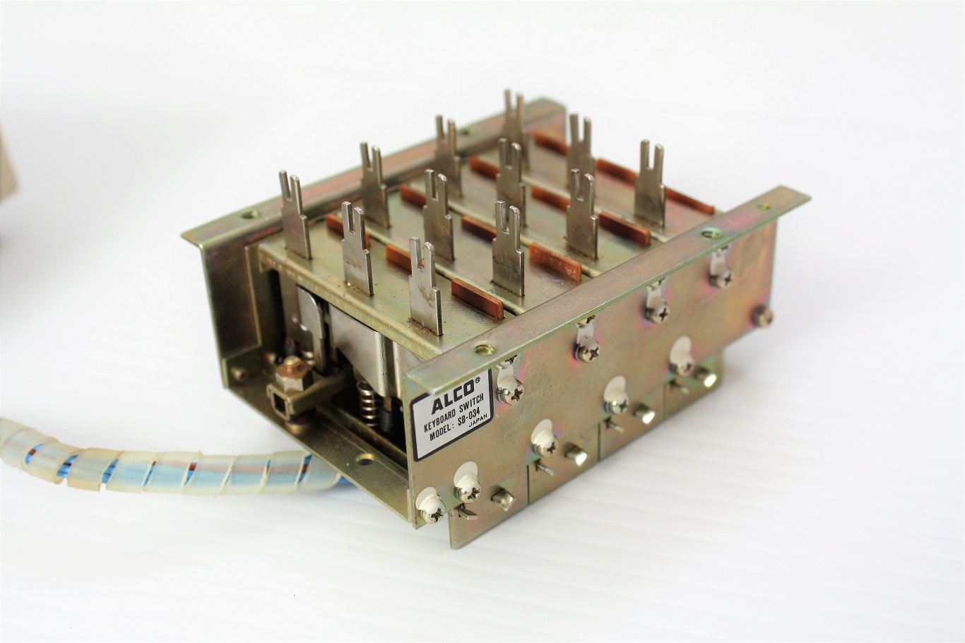

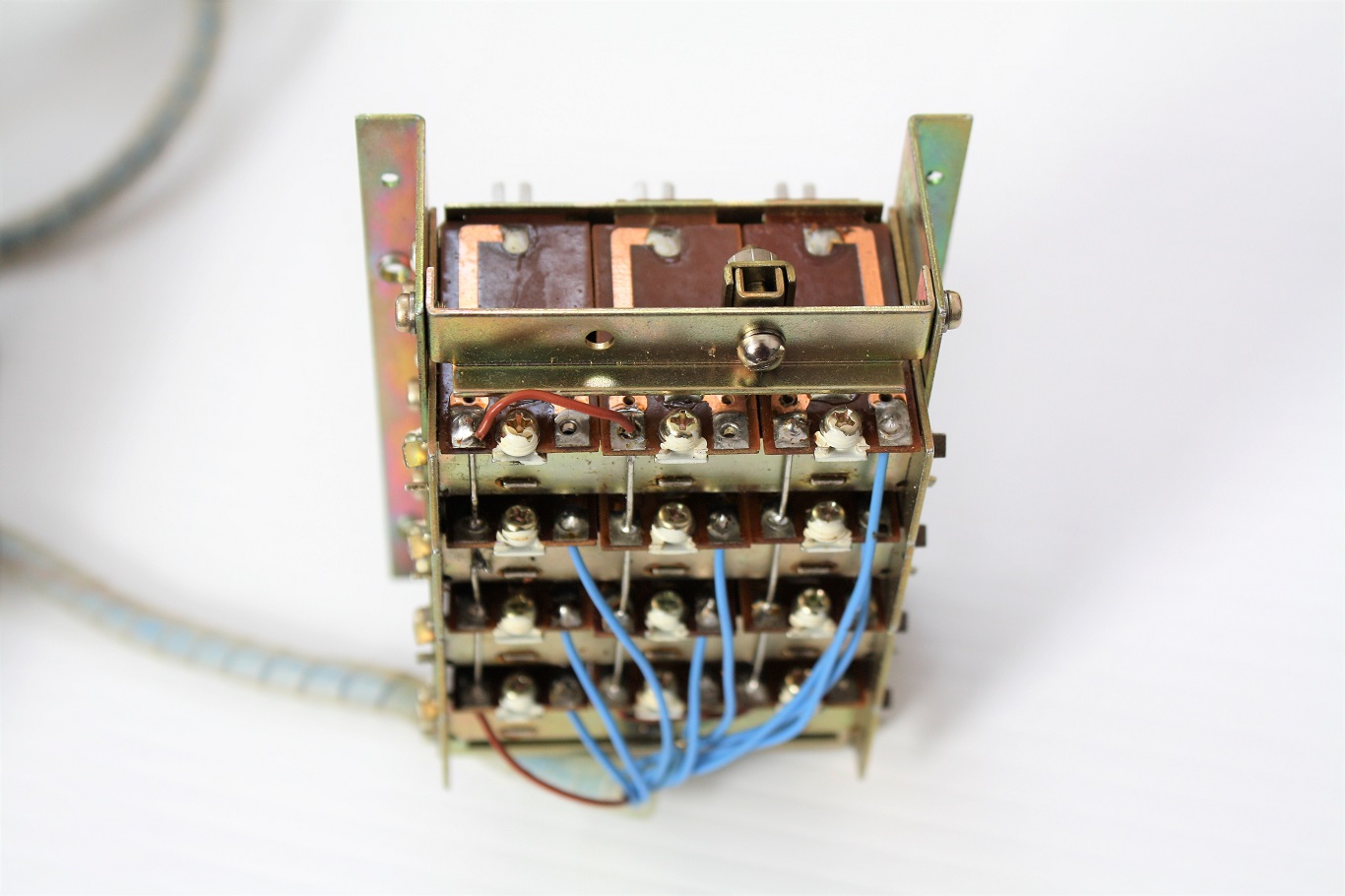

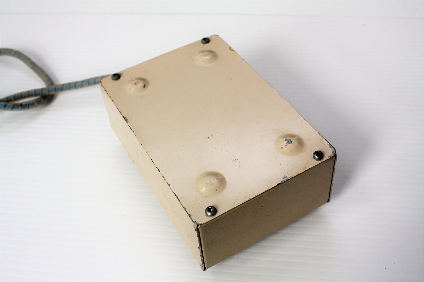

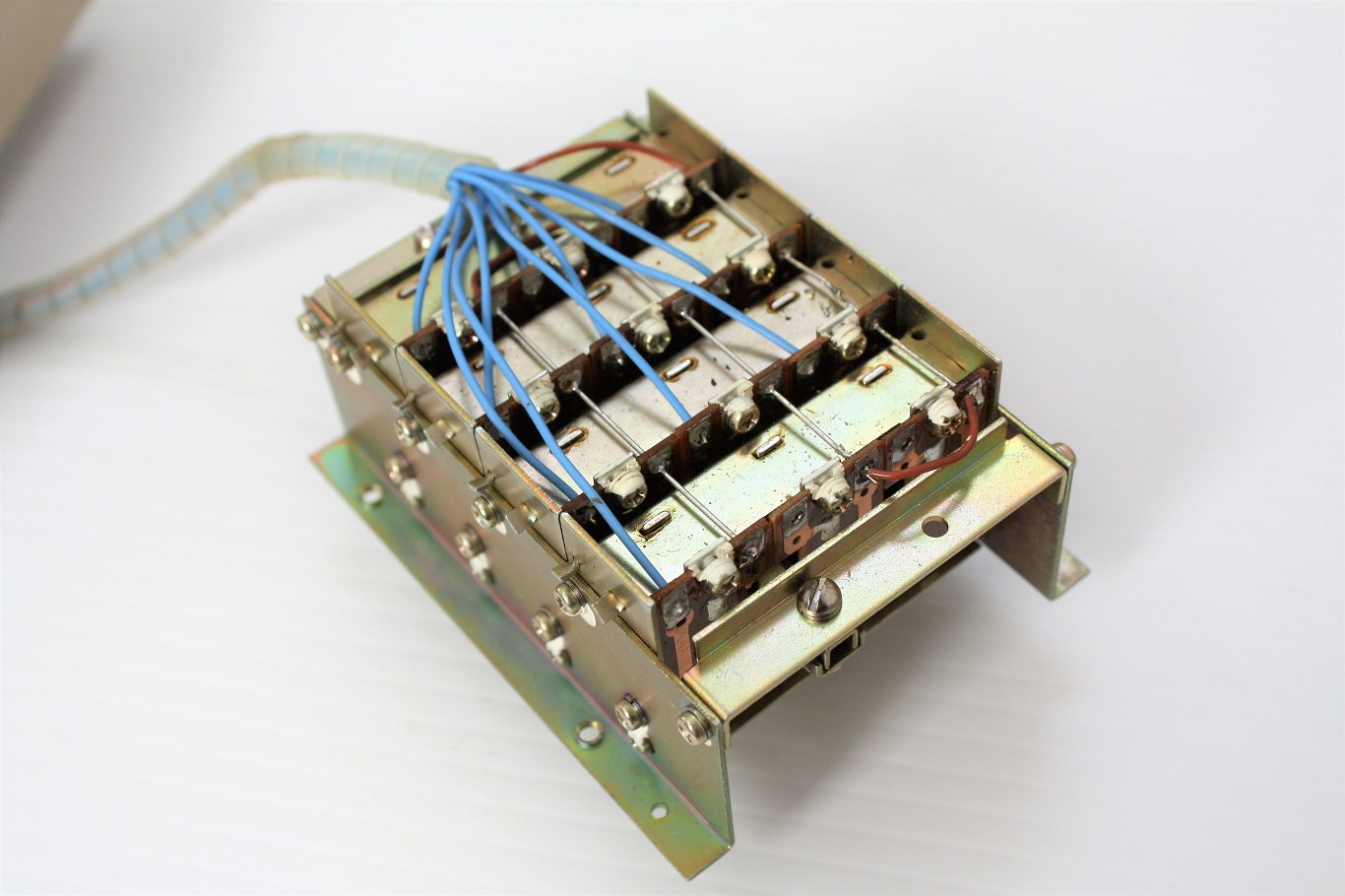

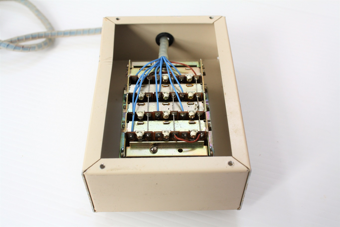

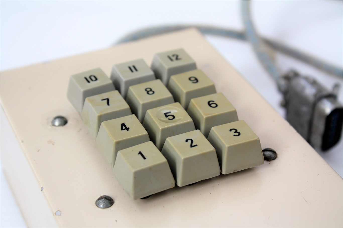

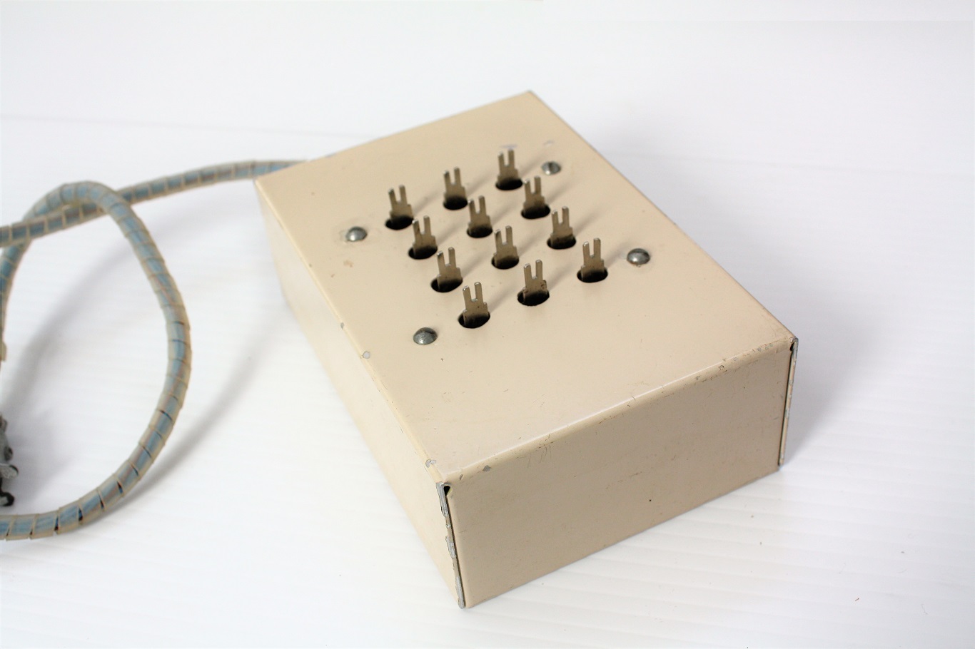

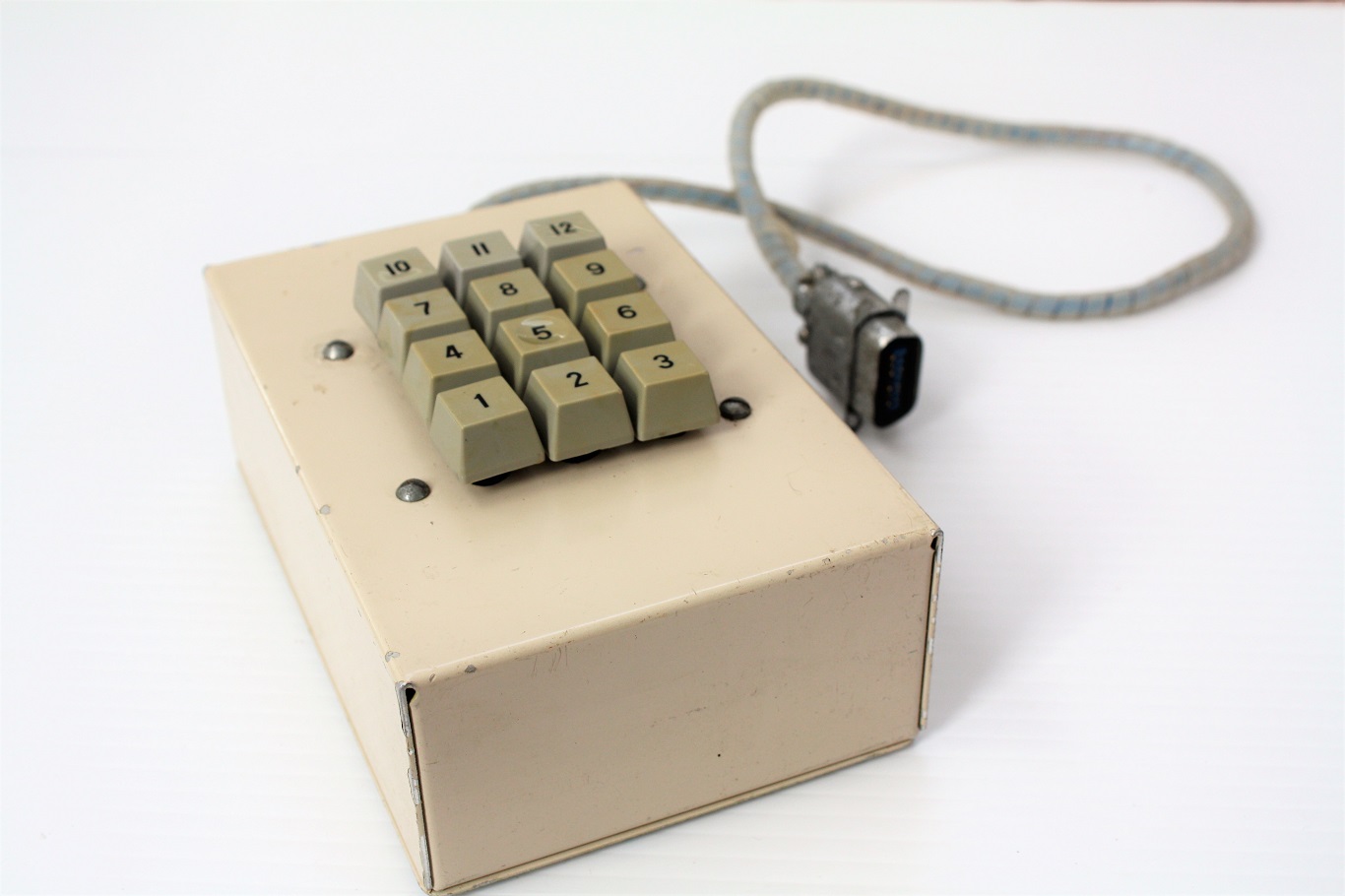

Below are pictures of the Alco Keyboard Switch model SB-034. Other than the super thick doubleshots, there are two things to note. First, the mechanics only allow you to press one key at a time so if you press one key, all other keys are mechanically "stuck". The second item to note is the "10" "11" and "12" keys are not doubleshots but engraved. My assumption is that 0-9 keys were easy to get but 10 - 12 are custom because double digit keys are usually not found on key pads.
I don't know the age or the use for this but they are still electronic key switches. This is definitely industrial in nature.

chery compatible hahahaha...first thing i thought was "how would they feel on a regular keyboard typing. and how would they sound ahhaha....build to last in a big way and then sum ..cool thx for sharing.

Wow, they may as well have just made it completely solid.
The Mitsumi switch used for shift lock in the Commodore 64 also has a projected PCB for hand wiring, and someone's got an Alps calculator (?) with all projected PCB switches that I guess was also hand wired (I don't know where the page is now).
Curiously, the 8032-SX used a Futaba switch for shift lock, suggesting that even the hand-wired switches were not introduced until 1982, when the C64 introduced them. The PCB-soldered switches came afterwards, by the time of the Mitsumi-made M0110A and whatever Apple II machines used it (IIe Enhanced is the only one listed on the wiki, from 1985).
It's a pity there's no year on that Alco, as that's insanely overcomplicated for a keypad!
03 Jun 2017, 01:42
Hehe.. Mechanical anti-ghosting...

Now that you have it apart I recognize the switch cluster I saw one without caps or a case in a rubbish pile at a thrift store a couple of years ago. It was really grungy and I almost bought it thinking it was part of an old radio of some sort. Now I wish I had picked it.

Wow, she thick. But are they engraved? gross

This has got to be the most solid numeric keypad I have ever seen, complete metal construction not to mention those keycaps. Impressive.

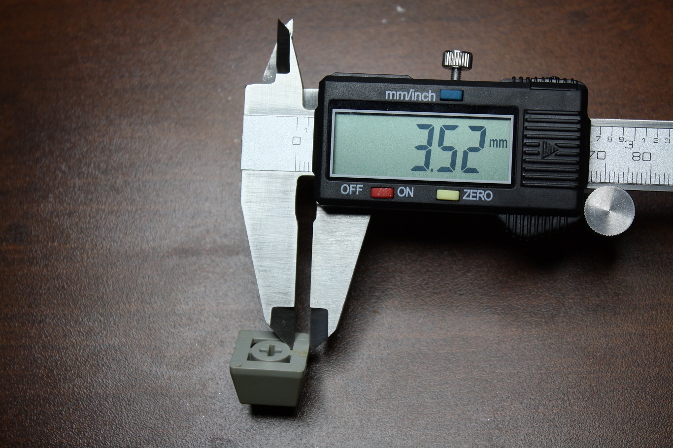

Wow, just... wow. I'm guessing that this breaks Fujitsu's 3 mm record? XD
snuci
Vintage computer guy
03 Jun 2017, 13:32
Chyros wrote: Wow, just... wow. I'm guessing that this breaks Fujitsu's 3 mm record? XD
I believe so...

Ding ding ding ding ding, we have a new record!

Absolutely, even the thicker M0110 keycaps are "thin" comapred to this.
