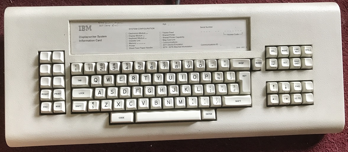

This white whale of a keyboard arrived on my doorstep this morning

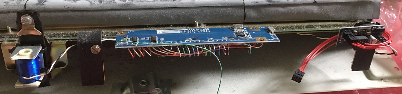

Lucky for me I had already ordered a Model F Xwhatsit which was customized by Orihalcon to work with the DisplayWriter. Being somewhat new to the Xwhatsit I had a little bit of trouble as I was using an incorrect current threshold value. I found that a value of 120 was the sweet spot for this particular keyboard. I just need to solder the pins for the expansion header so I can hook up the solenoid driver. Also I am still working on the layout for some of the keys. Overall it is in very good shape, no rust but lots of dust bunnies. It was well used as some of the keys have some shine to them. Eventually I will clean the case and wash the keys.
- 001.JPG (264.33 KiB) Viewed 30611 times
Born in 1983

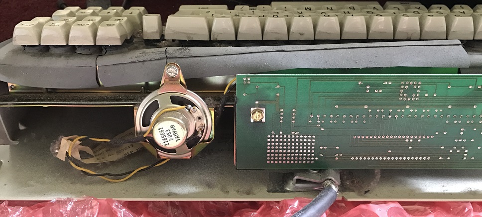

Original speaker, controller, and cable.

Installed solenoid, Xwhatsit, and solenoid driver

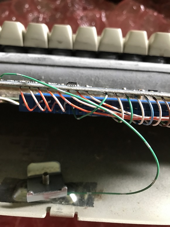

Here I have the ground wire attached to the case.
