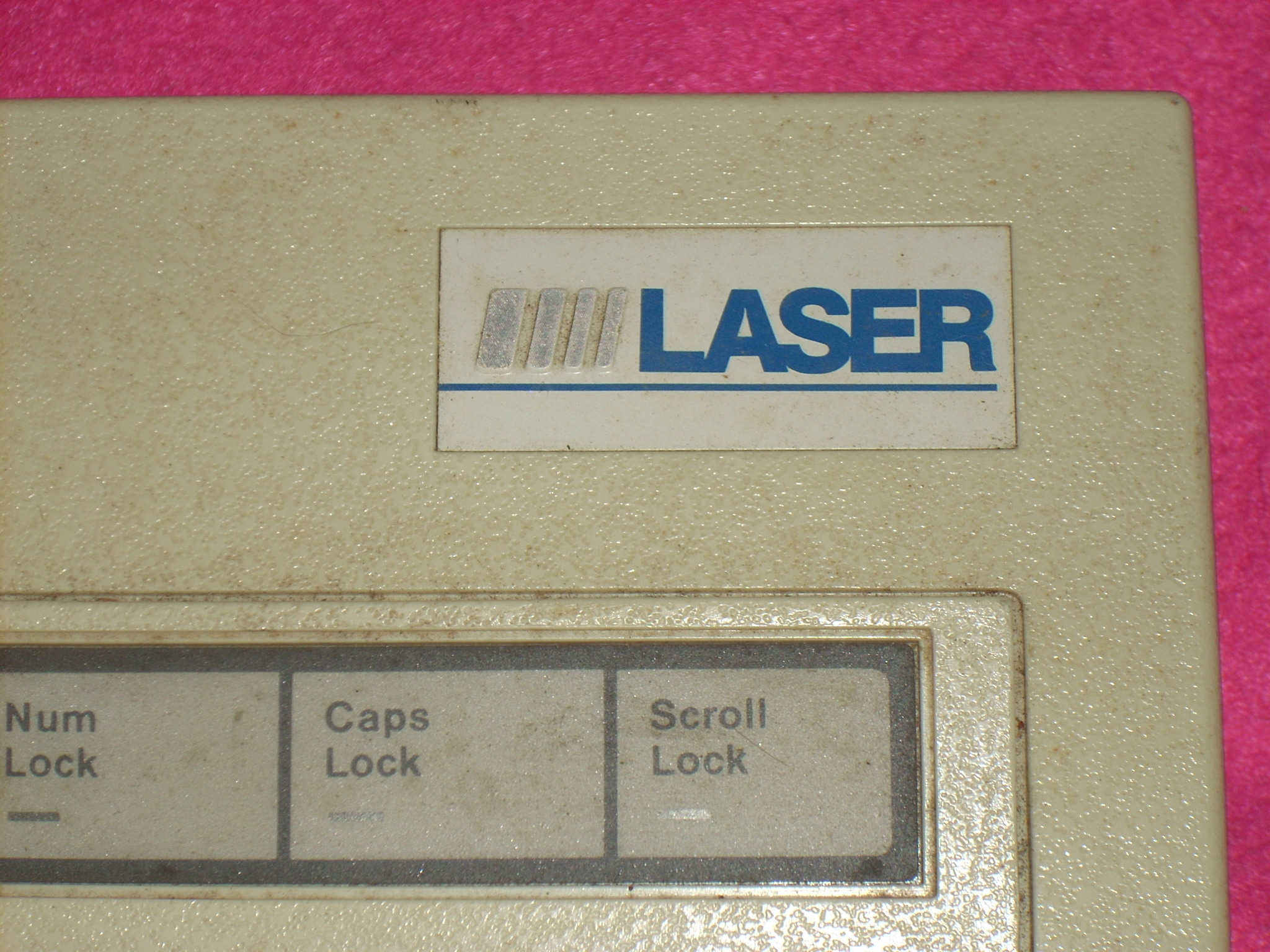

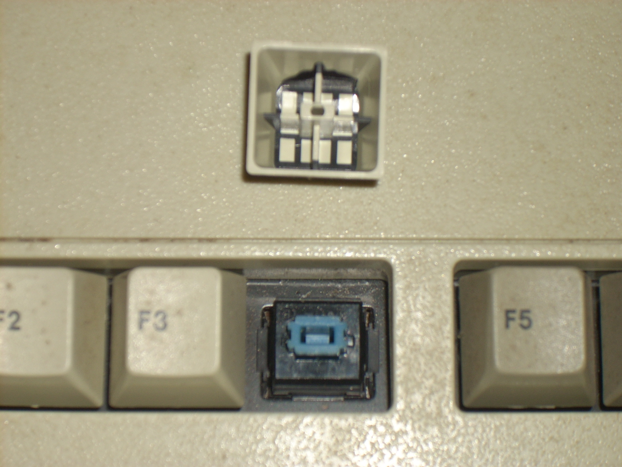

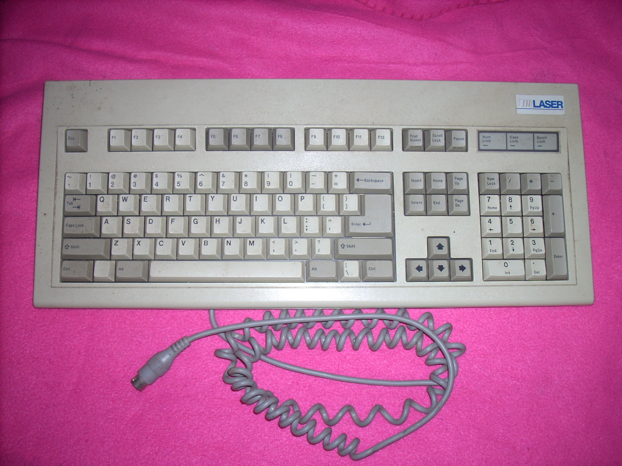

Digging through the closet to find a switch and keycap donor for the ebay Avant and stumbled on one branded "Laser". Blue Alps, double shot keycaps, low miles and barely yellowed if at all. FCC ID is FKF456K-102. I thought this was something later and generic until I popped off a couple keycaps and found the blue Alps switches. Is this a known keyboard? Keeper? Pretty sure I still have a Leading Edge or two to borrow switches from, but I haven't found them yet.
ohaimark
Kingpin
16 Aug 2017, 06:10
You mean Alps Mount SMK Blue Switches? AKA Monterey Blues?
I haven't seen it in Laser branding before, so photos would be welcome.
Polecat
16 Aug 2017, 07:16
Happily, but what is it? No logo on the top of the switches, but they've got to be early blue Alps, yes? New here, so I have a lot of reading and learning to do.
It needs a good cleaning, but other than an old ID etched on the back side it's near mint. Inside is almost spotless. Don't think I can part this one out, but I found the insides from an old Datacomp with most of the switches still there and I have enough loose ones to fill in the rest. Glad I saved this stuff when the getting was good. Sorry for the bad photos; and yes, this *is* the good camera.

Wow! That is a weird one. I mixed up the keyboard model (oops, K102s come with Alps and not SMK), but that's because I didn't expect it to come with Blues.
I'd say it's a keeper. Clean it up and cherish it. The layout is even usable.
Edit: those are Blue Alps.

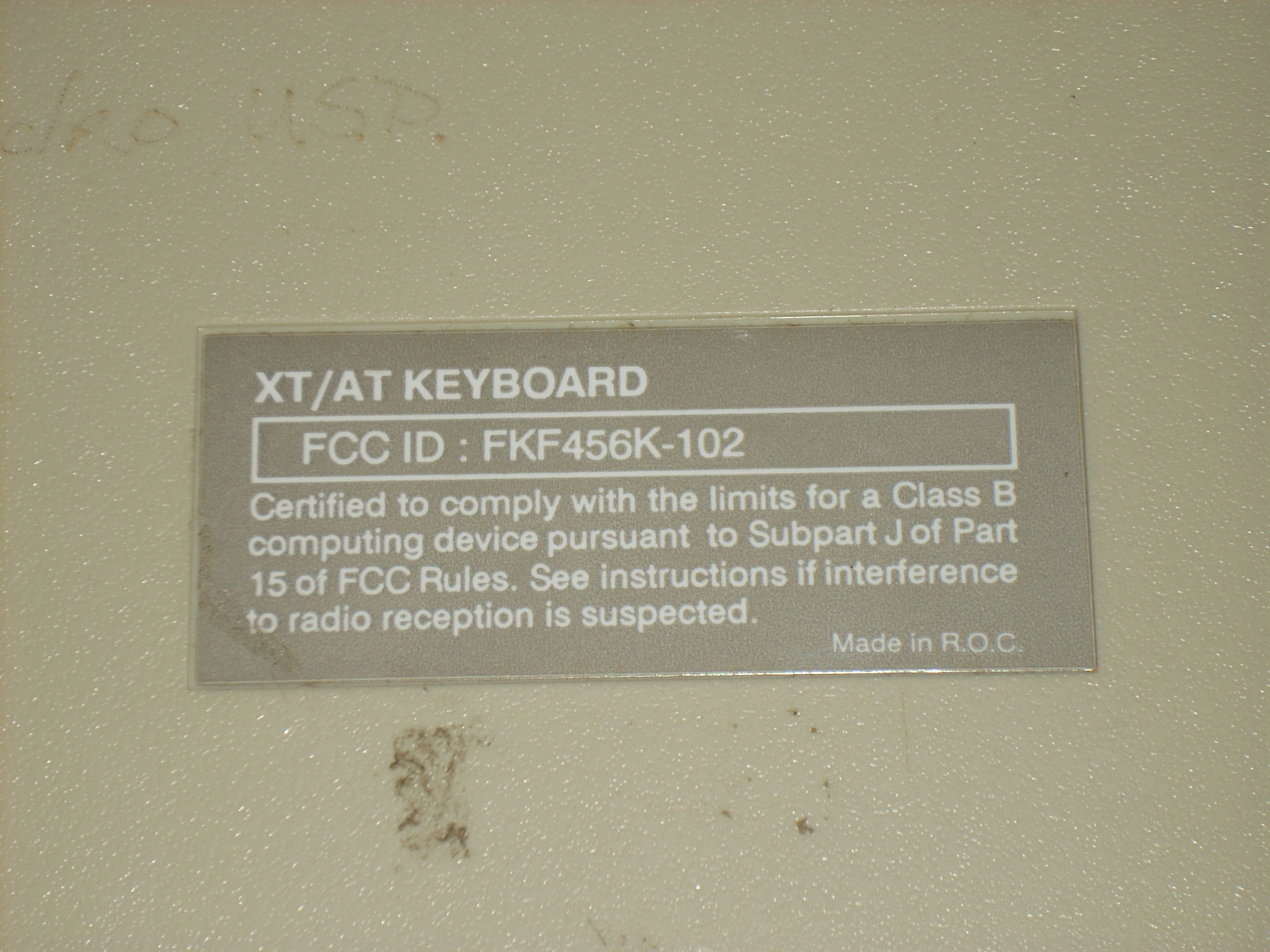

Thanks, I didn't expect to see the blue Alps either. Doing some reading, and the Wiki says this is an MTek/Monterey. I may be slow, but, uh, how does the rest of that go? I'm rebuilding the Avant to replace a perfectly functioning Monterey K-104 that I've worn the tops of the caps off of over the last ten years, and here sitting in my closet I have a like-new K-102 with the identical layout, and what's probably the same PC board inside, with blue Alps and double shot caps. D'Oh!

While we're being facetious, a bit more info on the MTeks. I opened up the K-104 (labeled MTek K-104 on the back) and the Laser, and the PC boards are nearly identical. K-104 says 31-42400-024, then K102A-H3, then Sung Wei 02HB. Laser says 38-42400-022, then K102A-H3, but no third line. Physically the boards will interchange, with identical layouts. The K-104 has a 3 position switch - A-X-S (whatever that "S" may be...) with three wires connected. The Laser has the same 3 position switch, but the case has a shorter slot which limits it to the A-X positions (thus labeled) and only two wires are connected. So...I can drop the Laser PC board into the dark gray MTek case, and use those blue Alps and sweet double shot caps until I wear clean through the plastic. I'll redo the Avant anyhow, just in case I like it.
17 Aug 2017, 00:59
More stuff for you to add to the wiki.
Sung Wei is a major PCB manufacturer. Datacomp subcontracted their PCBs to Sung Wei. I don't recall seeing their name on another keyboard brand before, but I could have forgotten.
Polecat
17 Aug 2017, 02:04
Thanks, the two boards on the K-104 Wiki don't show the Sung Wei legend, but they're clearly from the same manufacturer. I can't actually confirm that the Laser board is an MTek or a K-101 (or K-102), since there's no model number other than in the FCC ID. There's no photo on the K-101 Wiki, so I can't match it up by the case, although the physical description does match the Laser. As I said I'm new here; not sure who does the Wikis or how to do one myself, even if I could confirm the K-101 ID on the Laser to be sure it belongs there. Help!
