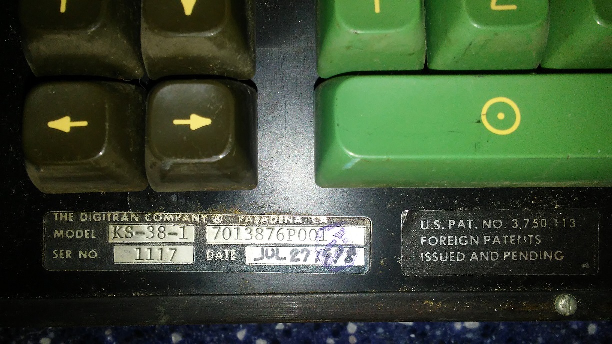

This one is dated July 27, 1978.

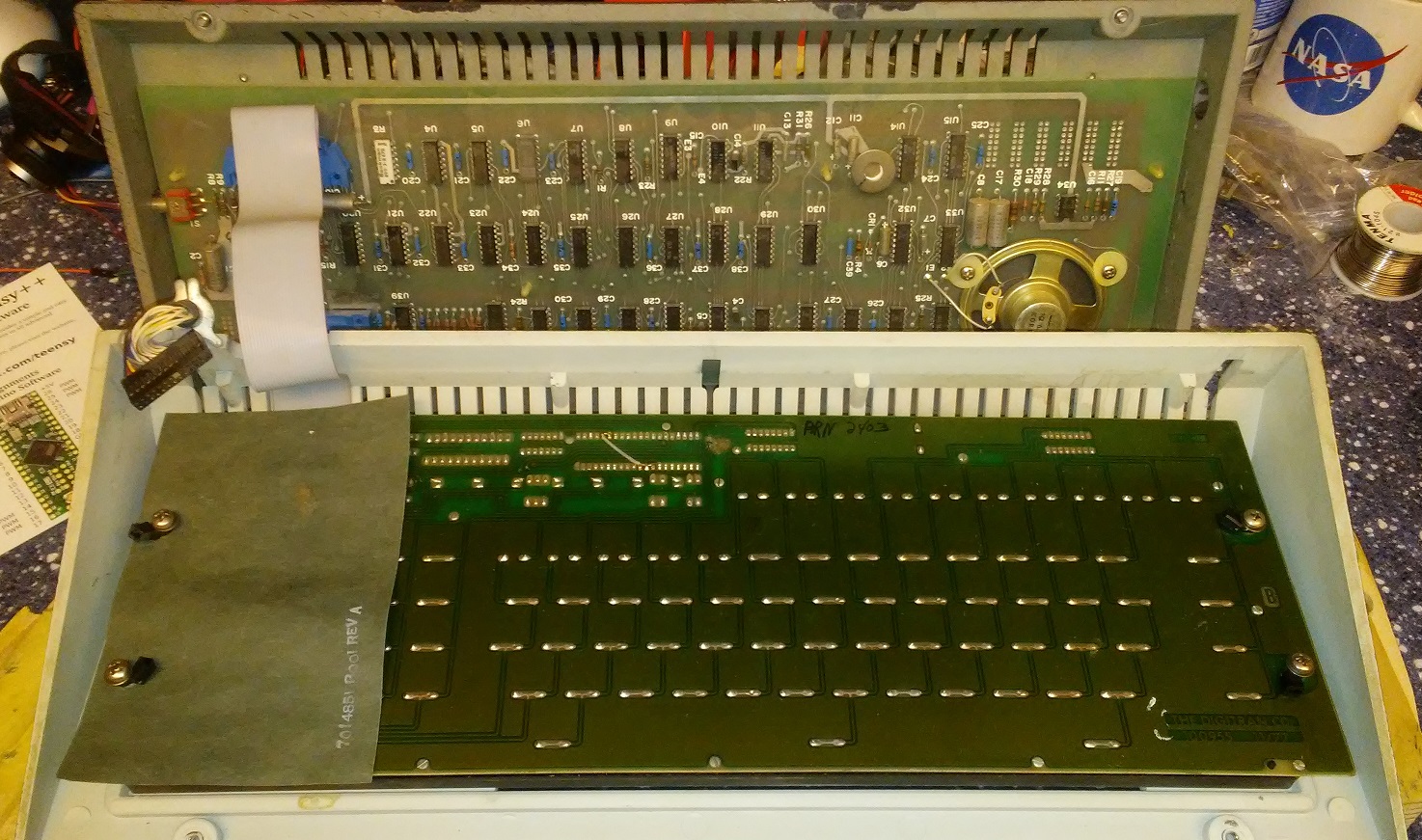

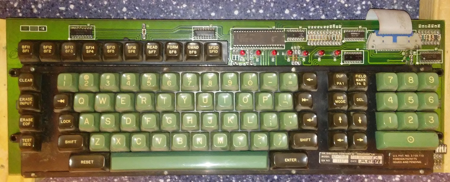

Sangdrax did a great job documenting the board - I thought I'd have a go at converting it and add a few more pics too.

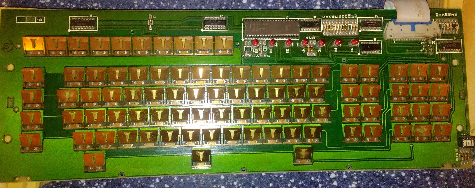

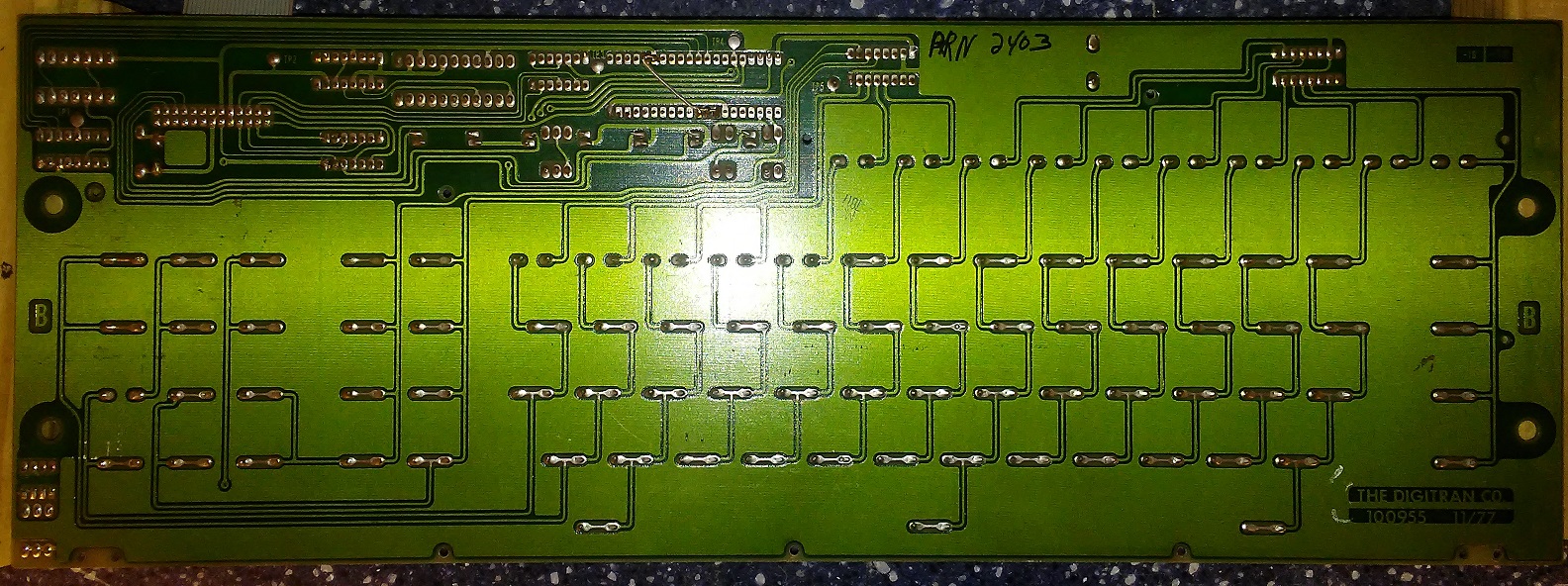

I's an interesting capacitive board:

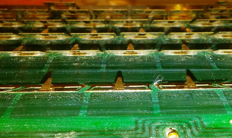

The rows are wired to pads under soldermask in the PCB and the columns to the copper leafs :

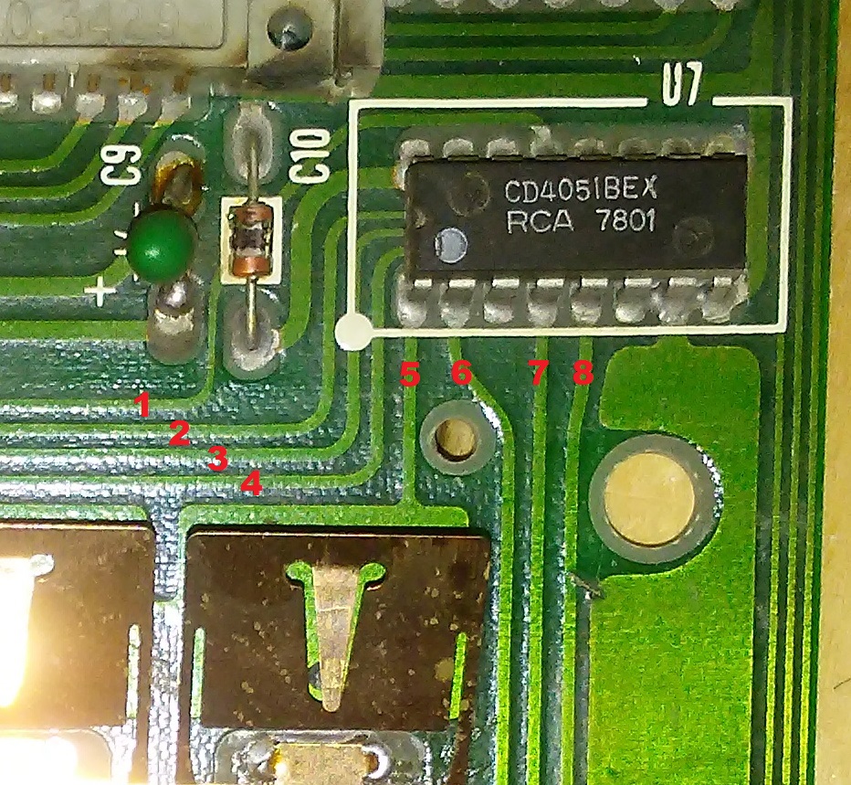

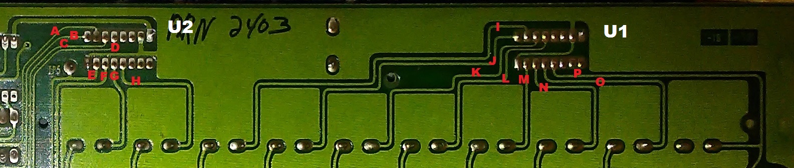

Sangdrax figured out the board was 8 row by 16 columns and I thought I'd put a few more pics of the IC connections (labeled with arbitrary numbers and letters):
Rows
Rows
Columns
Columns

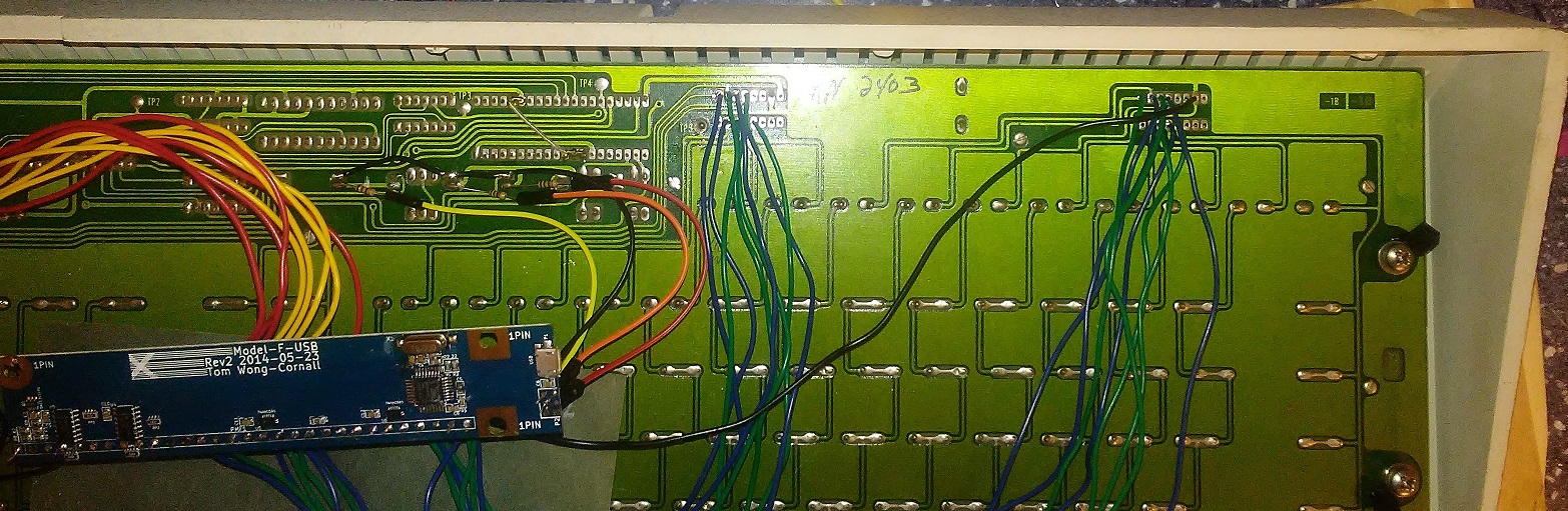

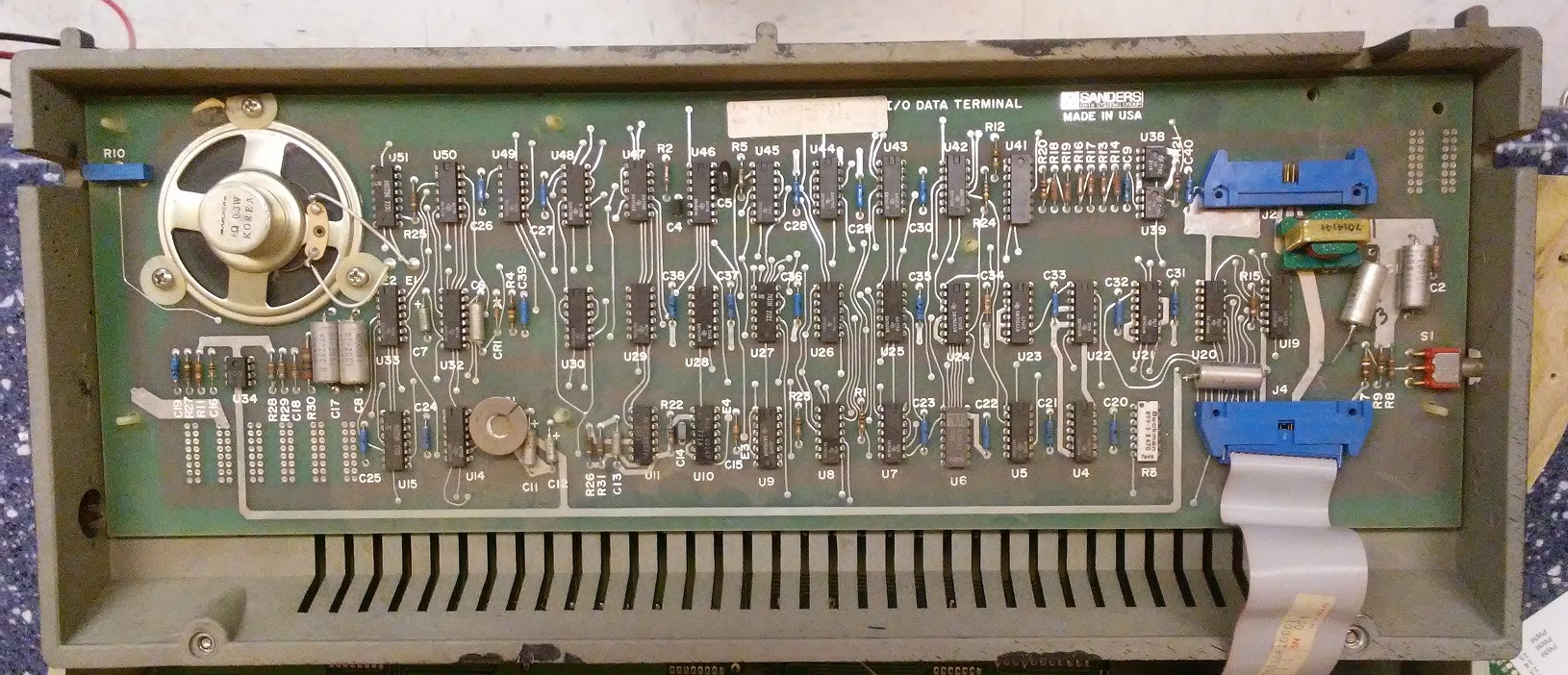

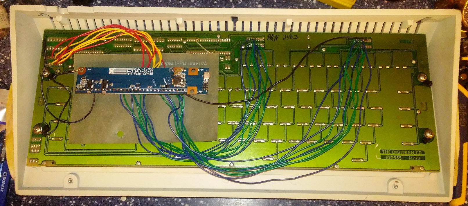

Then desoldered the ICs and wired up the xwhatsit:

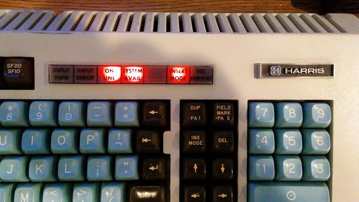

And much to my relief, it worked! Voltage threshold seems good between 150 - 160 and I went ahead at set it at 158 like Sangdrax. Once I was sure everything was good, I went ahead and hooked up the lock lights to three of the onboard LEDs.

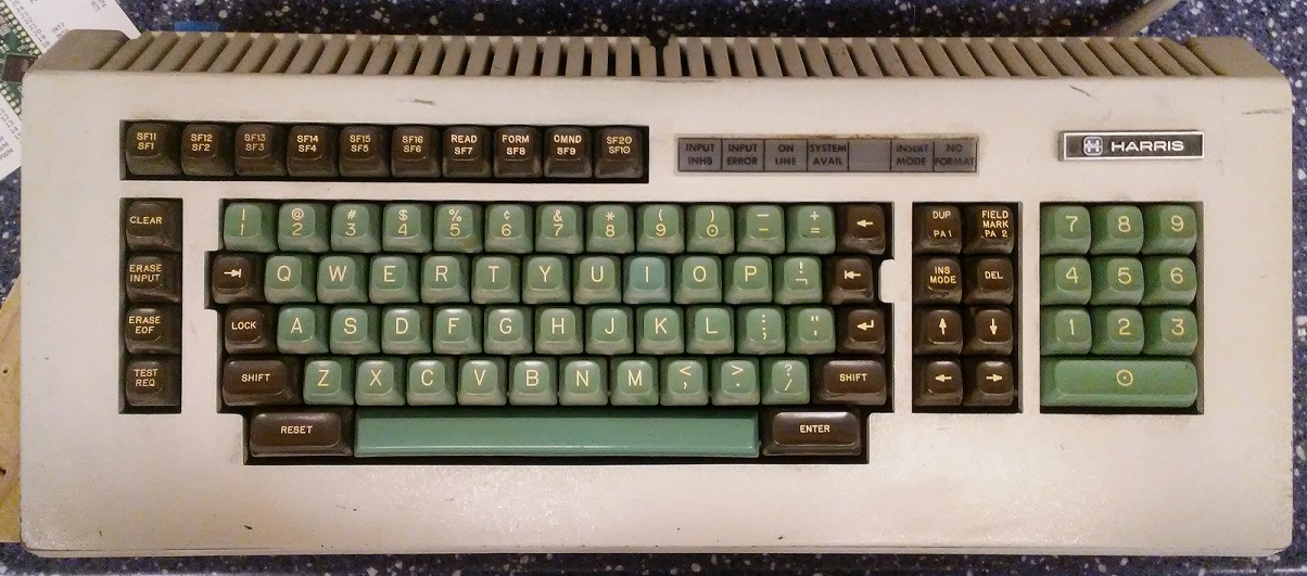

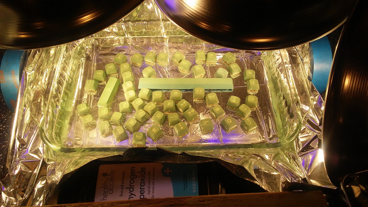

And retrobrighted the blue keys

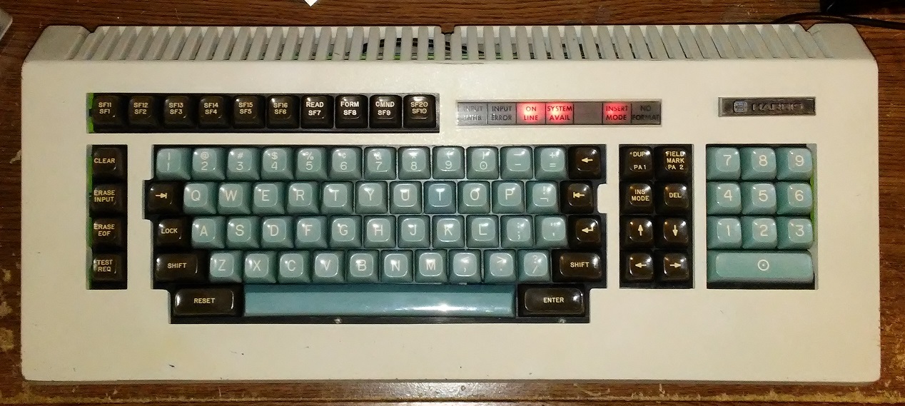

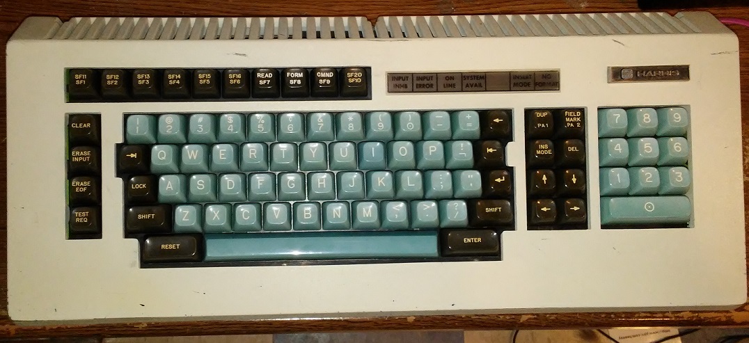

I need to touch up the case but I'm really pleased with this board and am going to be using it a lot.

Definitely take the time to lube the plungers on the board if you get a chance. It makes everything so smooth. The dried gunk on mine sure made it look like it was that way originally too. Best way to do it is press the plunger down and apply to the cross stem underneath instead of trying to work around the springs up top.

I can't tell what the color the keycaps are due to the inconsistent lighting. But those sphericals are amazing!

zslane wrote: I can't tell what the color the keycaps are due to the inconsistent lighting. But those sphericals are amazing!
I'd say light blue/teal is best description of color. I've just got a cheapo cell phone camera.

Yeah, they're definitely teal. A photo in natural light will show it the best.

Dat blue! So beautiful!
