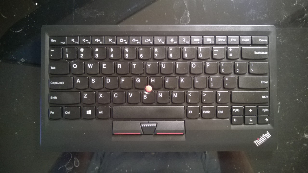

And here's what it looks like:
ThinkPad Compact Bluetooth Keyboard with TrackPoint

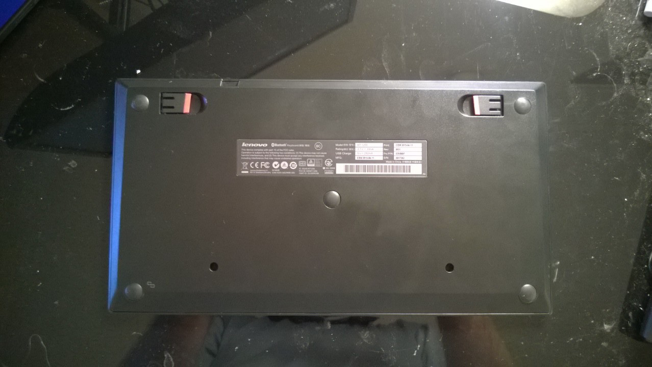

And the back for good measure:
Rear of ThinkPad Bluetooth Keyboard

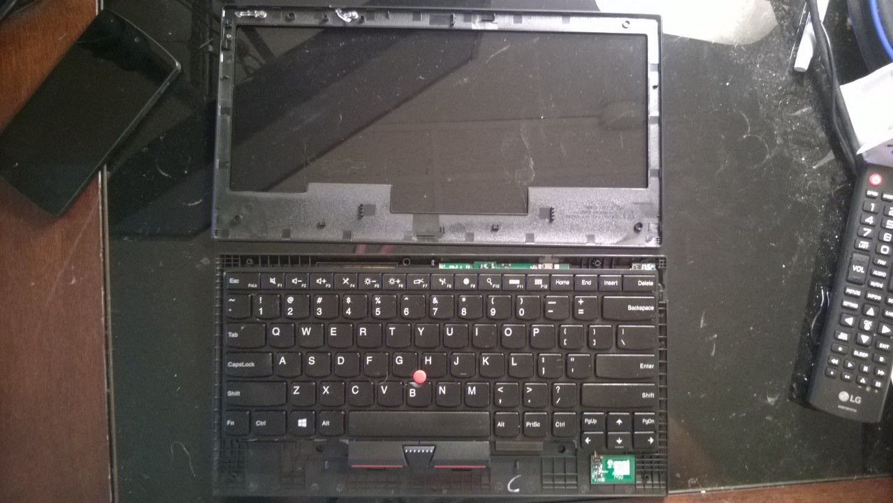

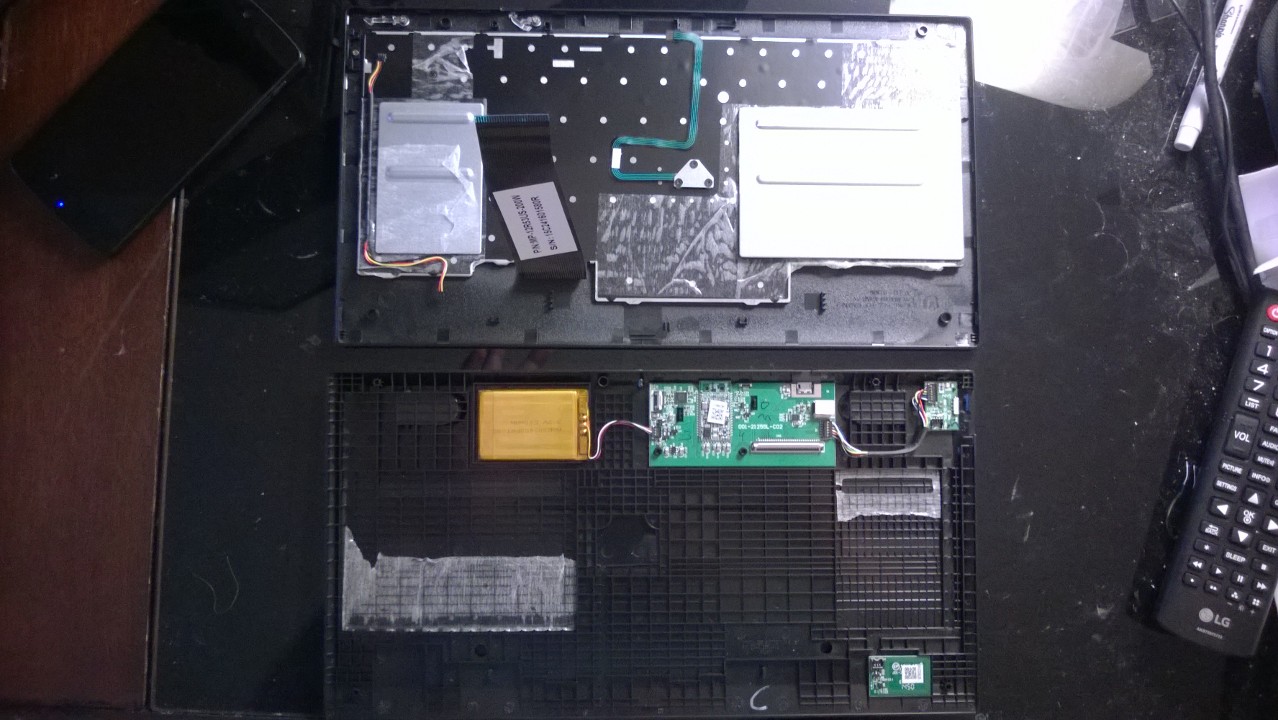

Top case removed
Top case removed
Fully plastic case, of course. There's a top part that snaps on (screwless construction), the internal keyboard part is then taped to the bottom part (with, funnily enough, a couple thick steel plates glued/taped to the bottom - they don't appear to be structural or containing anything, it's just to make it feel heavier I believe), and all the PCBs and battery mounted to the bottom.
Keyboard module unplugged and flipped out of the bottom

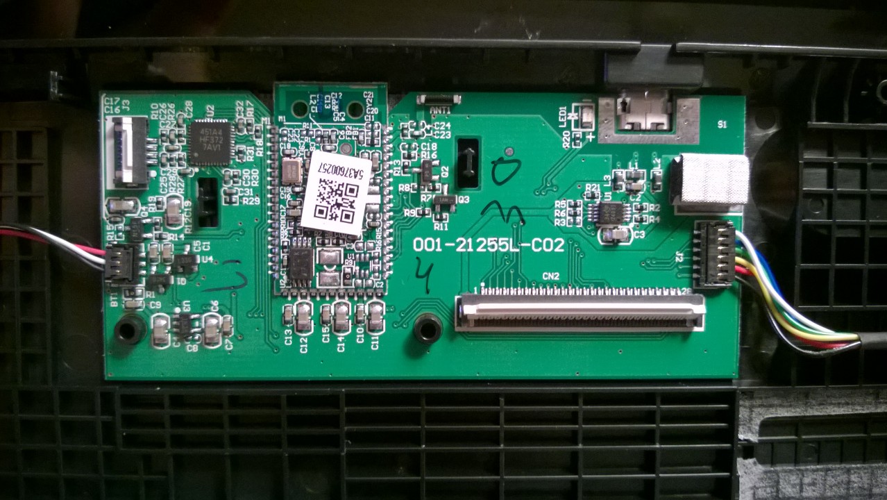

Main PCB holds the Bluetooth controller, the TrackPoint microcontroller, and the power circuitry (including USB charging). Interestingly, that's a departure from how ThinkPads have worked since, oh, 1998 or so - typically, the TrackPoint would have its microcontroller mounted up against the stick, and then it'd speak PS/2 directly to the motherboard. This is reverting to the old way of doing things, with a dedicated analog cable to the controller.
Main PCB
Main PCB

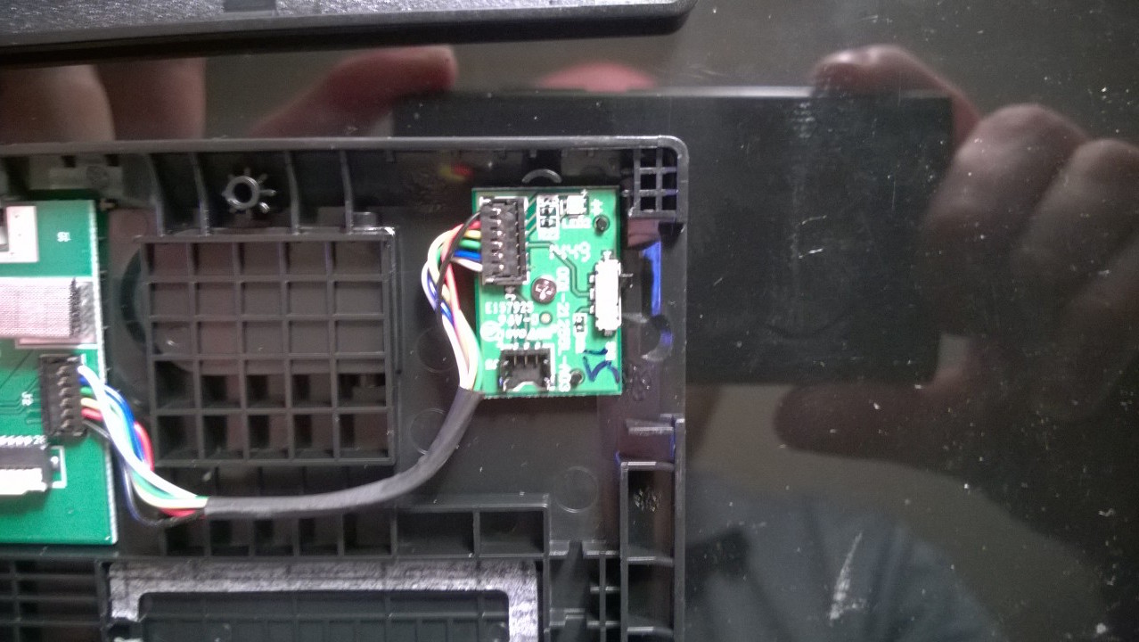

Daughterboard right next to the main PCB has the power switch and LED.
Power switch daughterboard

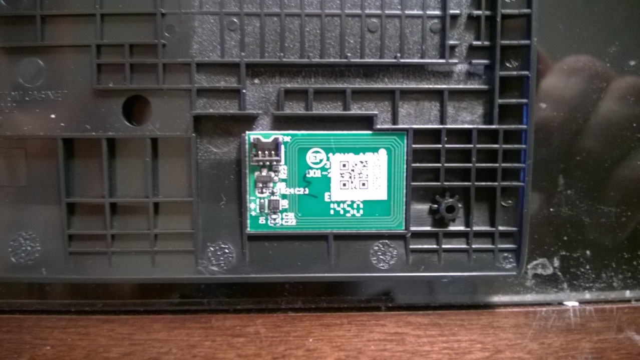

There's a third board in the lower right corner that has the NFC hardware.
NFC daughterboard
NFC daughterboard

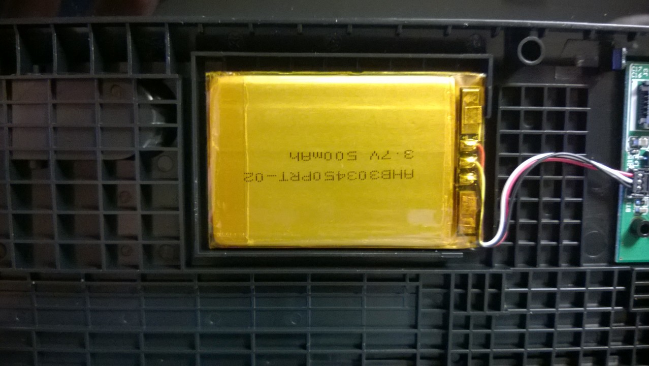

Finally, the little battery, that the weight makes you think is much bigger.
Battery
Battery
It doesn't feel that sturdy, and occasionally you can hear the adhesive on the tape that holds the main keyboard separating when you push on the case in certain places and release. Not the most impressive build quality. Don't get me wrong, it doesn't look like crap like a Unicomp or something, but it's certainly not great quality.
