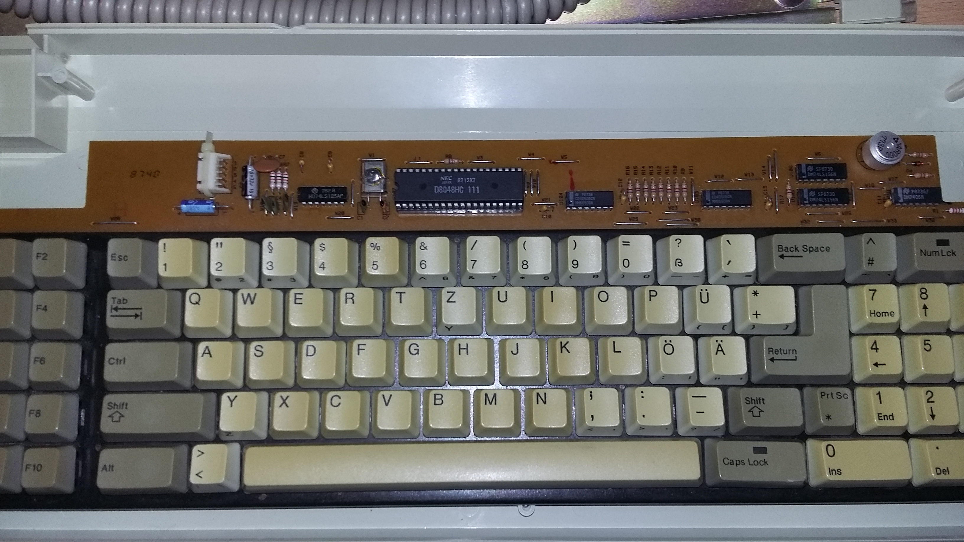

These cables do not work with any of my Z150. Ask orihalcon, be prepared with a picture of the pcb, he might be able to help you. He is a use here, maybe you can get a discount.

Here it is
2018-02-21 21.42.08.jpg (1.72 MiB) Viewed 7407 times

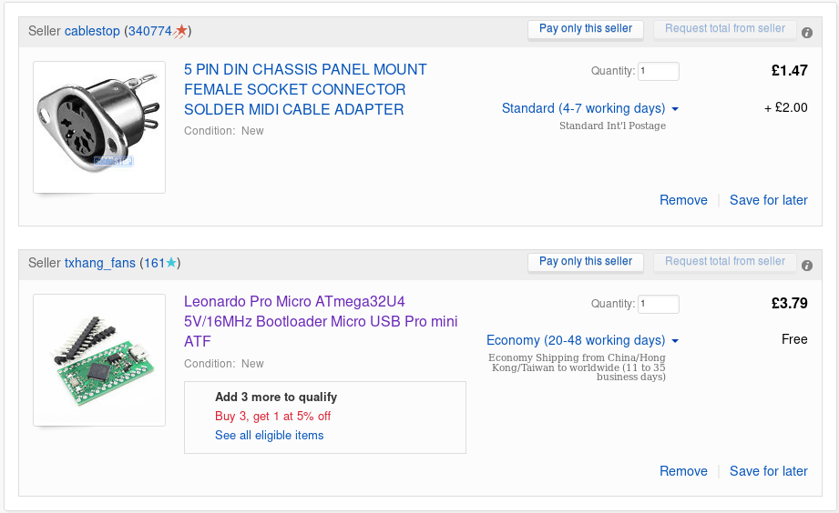

Check out this legend though! He said he converted it! Looks easy, but is the flashing easy? And could I do it without tuining one of my AT motherboards for a female AT socket??

Like I said it really comes down to how well you know electrical concepts. You can buy an AT socket for a few dollars on eBay, though I dont know which part number you would need to look for.

But is there a soarer firmware you can flash on that microcontroller with a couple of clicks?
green-squid
22 Feb 2018, 17:57
looked into it and it looks easy as 1 2 3. There is a significant chance I am going to do it. ;)
Will these parts work, ohaimark?
