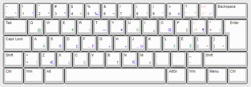

With that in mind, this is what I've come up with:
Nouveau Français layout.
Note that on the AltGr layer, the symbols in green already exist in AZERTY, while the symbols in blue are newly added in this layout.
The main features are:
  • The basic alphabet and the numbers follow the QWERTY standard. The only accented letter in the base layer is É, which is to the right of L (like Ñ is in the Spanish layouts and Ö in the German one).
  • The vowels with grave accents and the C with cedilla are in the AltGr layer, under their respective letters. I have to point out here that this was Myoth's idea, and it's a quite inspired one (in my original draft, I was going for only a dead key for the grave accent).
  • The dead keys for the circumflex accent and the diaeresis keep their position to the right of P.
  • The grave accent has a dead key in the base layer, which allows easy typing of the À, È and Ù characters if for some reason the user doesn't like the AltGr- combinations... plus Ì, Ò and other letters with grave accents.
  • The same key as above also contains the tilde dead key on the Shift layer, AND the acute accent dead key on the AltGr layer (an inexplicable omission in the AZERTY layout).
  • Æ and Œ are added on the AltGr layer under Z and O (A isn't availble, and Z is close enough to be a comfortable assignment).
  • Many typographical symbols (< > , . ; : ! " # $ % & / ( ) = + *) are located in places that are common to many national layouts, especially the neighboring ones.
  • The rest of the typographical symbols, especially the "new" ones, are located in the AltGr layer, in places that are easy to figure out, based on their names: tiret long under AltGr-T, paragraphe under AltGr-P, (opening) guillemet under AltGr-G (and the closing one right next to it), livre under AltGr-L, etcetera.
  • A few extra, non-French characters allow proper typing in neighboring languages (Ñ, ¿ and ¡ for Spanish, · for Catalan, ẞ and „ for German, IJ for Dutch). Portuguese and Italian, by the way, are also covered without the need for extra symbols.
  • This is an ISO layout, but a provision is made for ANSI keyboards, by having a secondary assignment for the characters <, > and \.
As you can see, this layout looks VERY different from the extant AZERTY layout, but looks similar to the Spanish, German and some other western/central European layouts... and in my opinion is quite elegant. Making an AZERTY variant is quite straightforward as well:

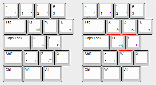

That said, assuming à DOES need its own base key, where would YOU put it in the layout I propose?
(let's also note that this way, æ can now be located in AltGr-A)

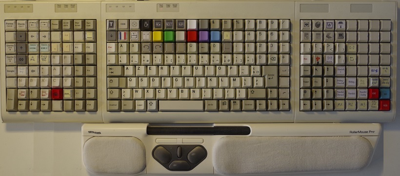

I simply wouldn’t want to use your numpadless layout which makes lowercase numbers on the number row necessary.
If you want to extend functionality, a good start would be to not reduce the layout.
This, by the way, is my keyboard (layout slightly modified since pic was taken):
my keyboard 15-06-04.jpg (162.8 KiB) Viewed 6816 times

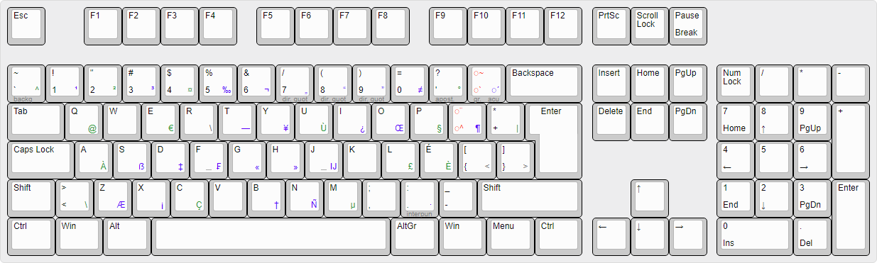

I posted the alphanum block only for clarity purposes — it wasn't like, say, the nav cluster would have any influence. THIS is the full image of the layout:
The full image of the proposed layout, including the irrelevant stuff that I cut for clarity.
