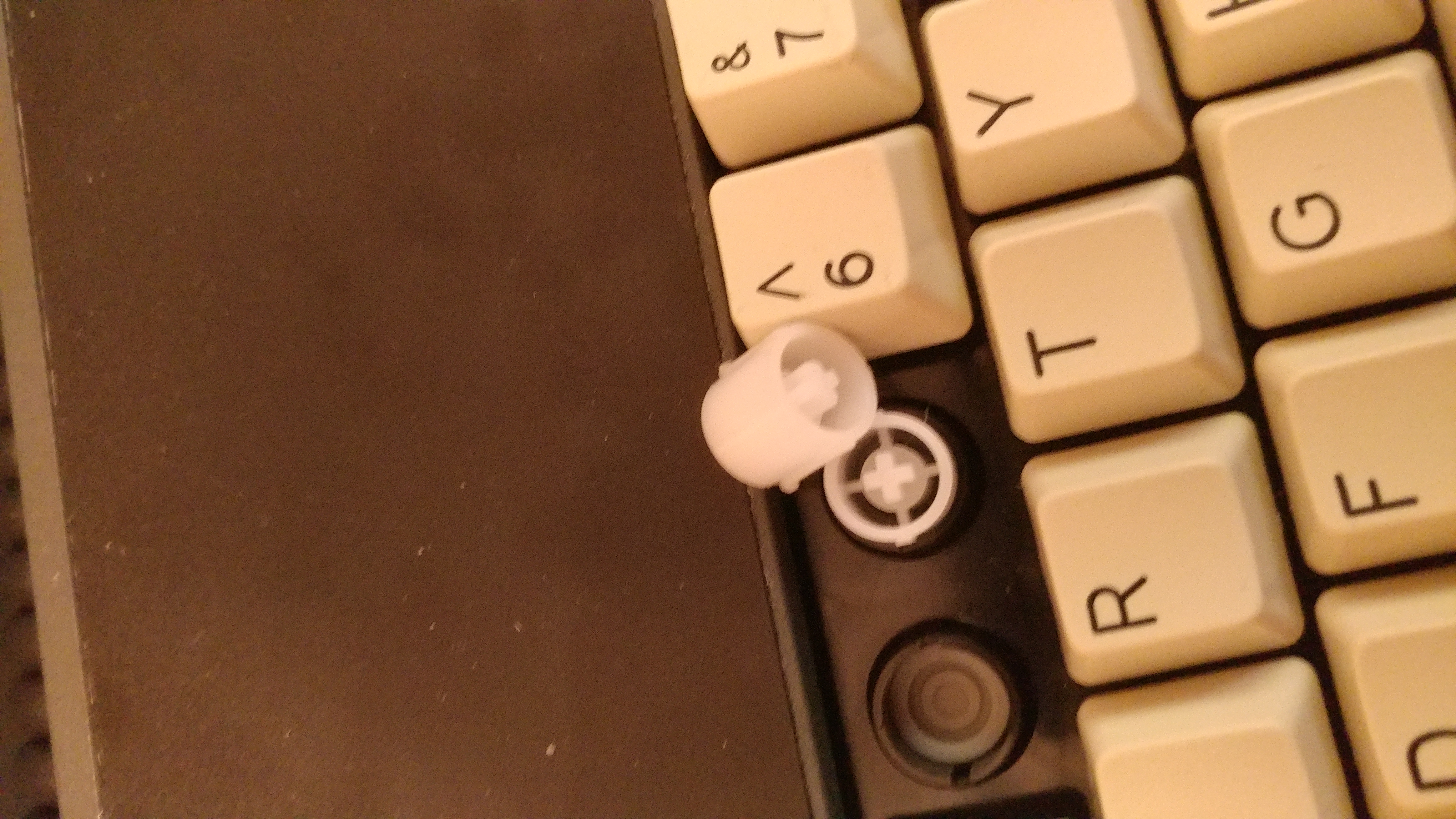

The keyboard looks similar to a IBM model f at but I am not one hundred percent convinced that this is even made by IBM, may I get some help confirming this keyboard manufacturer and if possible the switches?
Here is a photo

Definitely not IBM, looks like it is probably foam and foil based on LED placement.
Nuum
28 Mar 2018, 20:23
The keycaps look like Signature Plastic's DCS profile, so maybe MX type switches or switches with MX crossmount?

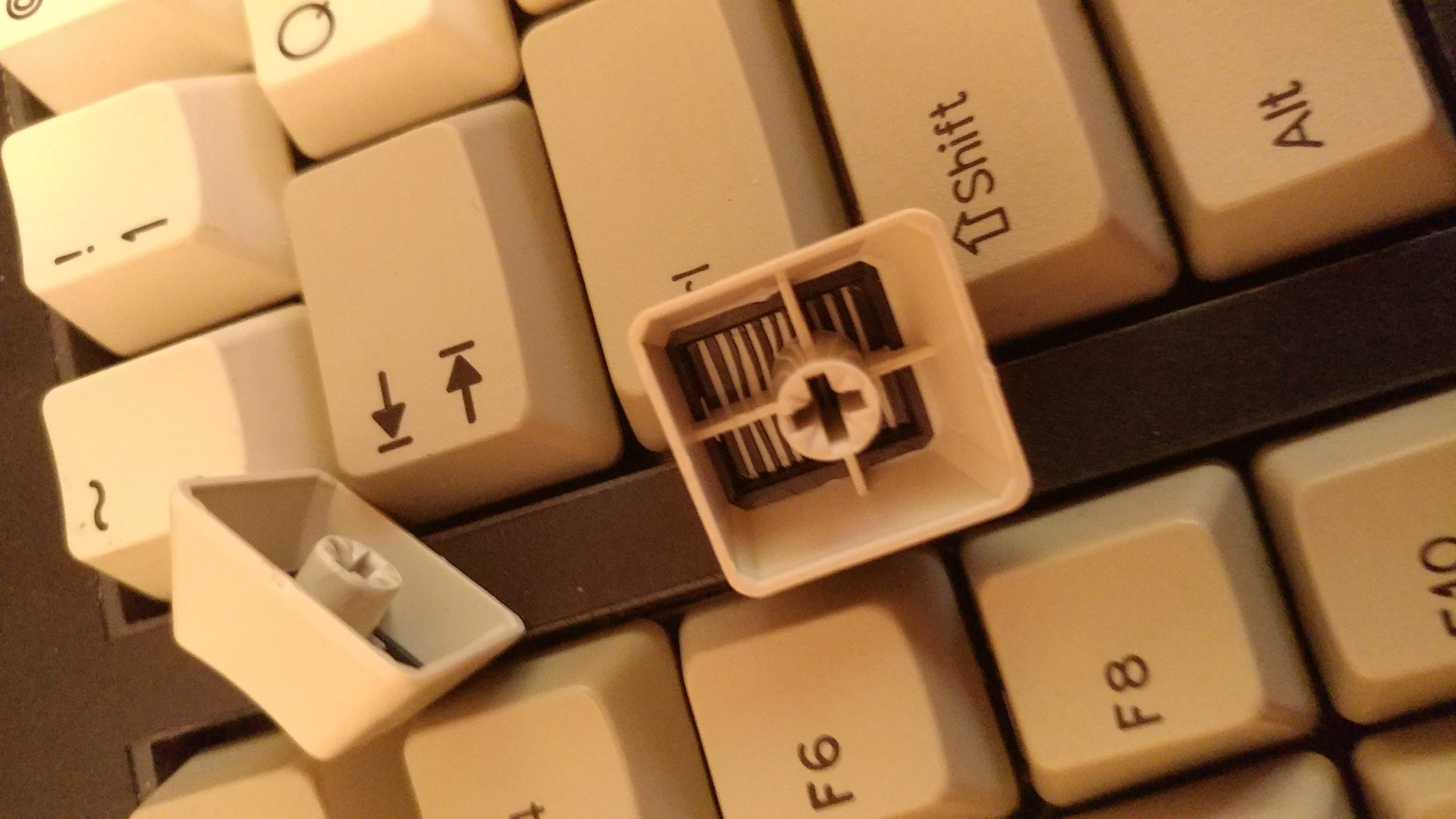

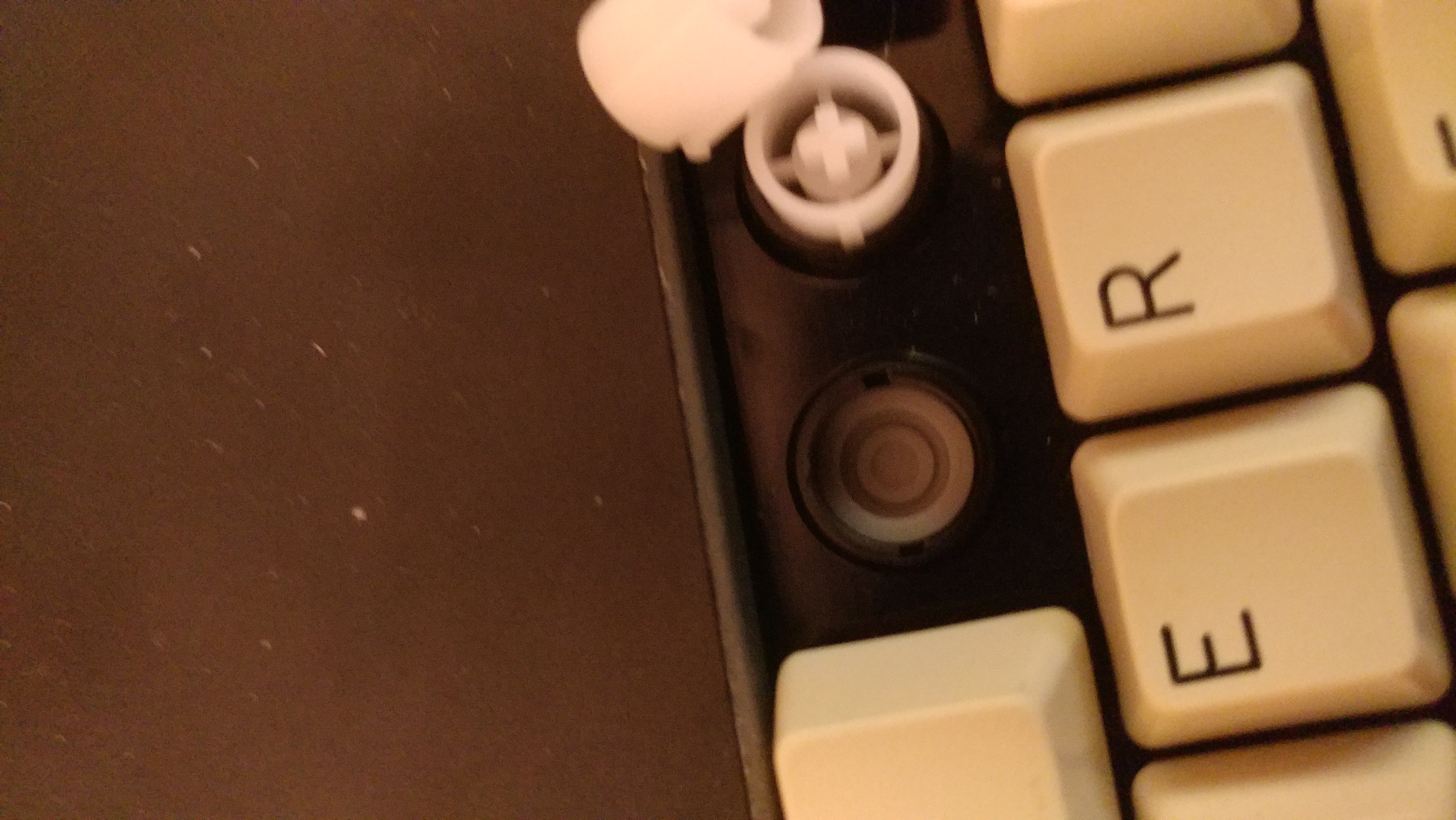

07 Apr 2018, 09:50
Its a rubber dome, tactile with removable sliders that are cherry mx compatible.
07 Apr 2018, 12:42
That looks to be [wiki]Maxi Switch dome with slider[/wiki] then. Keycaps … Comptec I suppose.

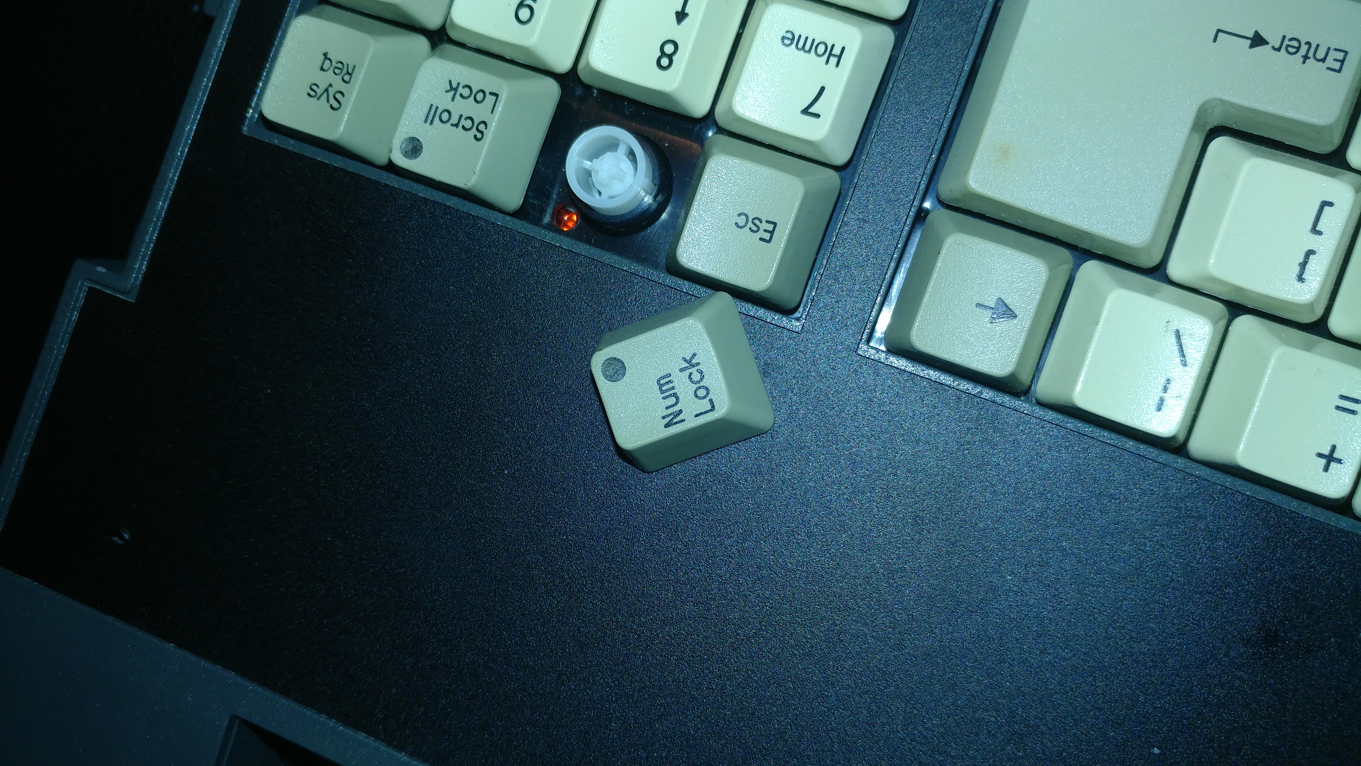

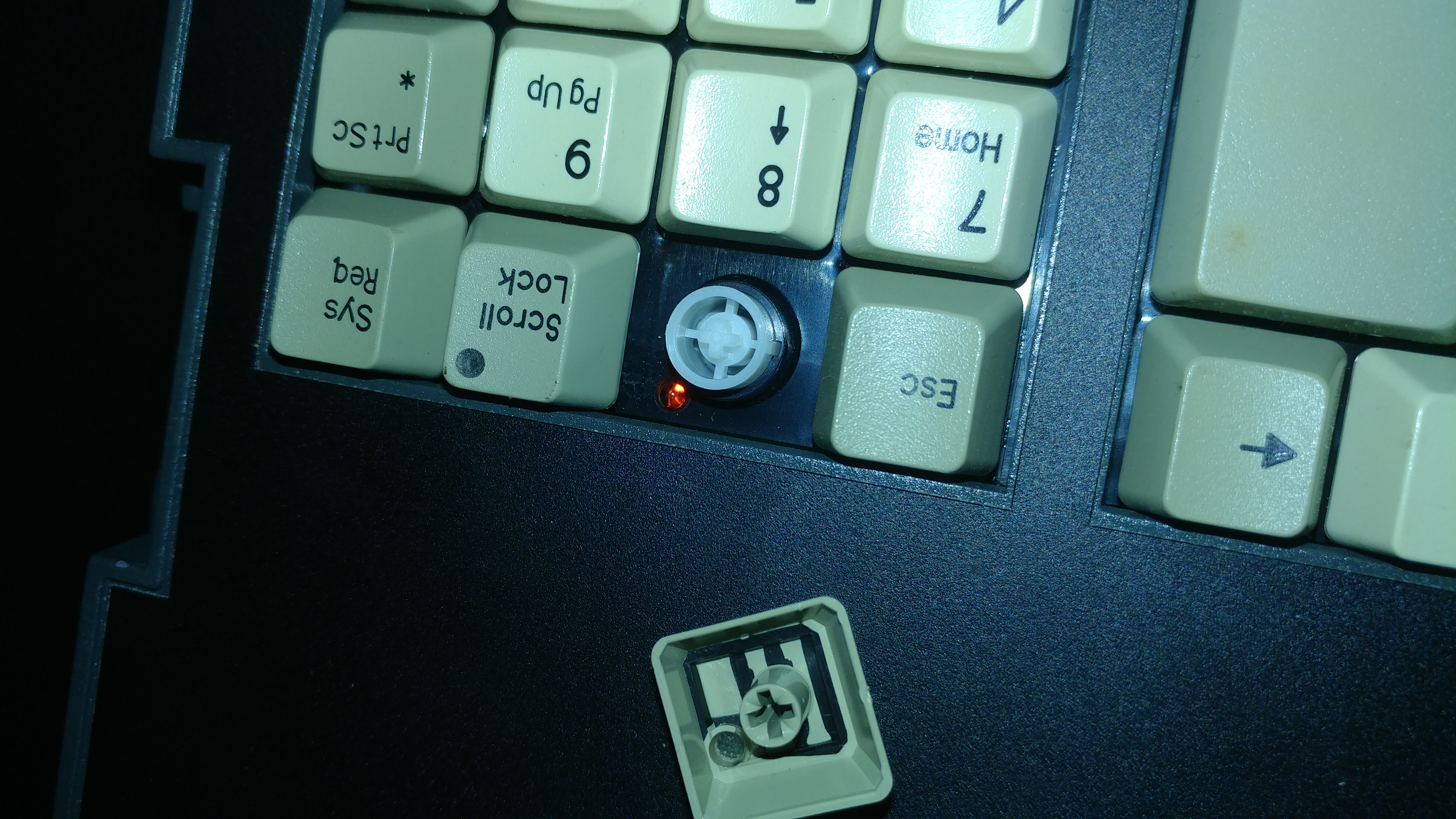

What do the 1-unit LED switches look like?

Here are the led switches
08 Apr 2018, 02:50
Thanks for sharing, I always wondered what switches these had. I almost picked one up but didn't want to make the gamble.

The switches are very tactile but the bump is longer similar to other switches like topre, its a lot quieter than cherry mx browns, its weighting feels similar to mx brown, a bit heavier. Overall a good tactile rubber dome switch. I like these switches better than the model m with buckling springs over membrane that I tried recently.
08 Apr 2018, 20:07
Oh, of course, this probably uses a PCB inside, so having LEDs within keys isn't difficult. Fujitsu had special LEDs that connected to the matrix for the FKB4700, to allow in-key LEDs to operate from a membrane.
