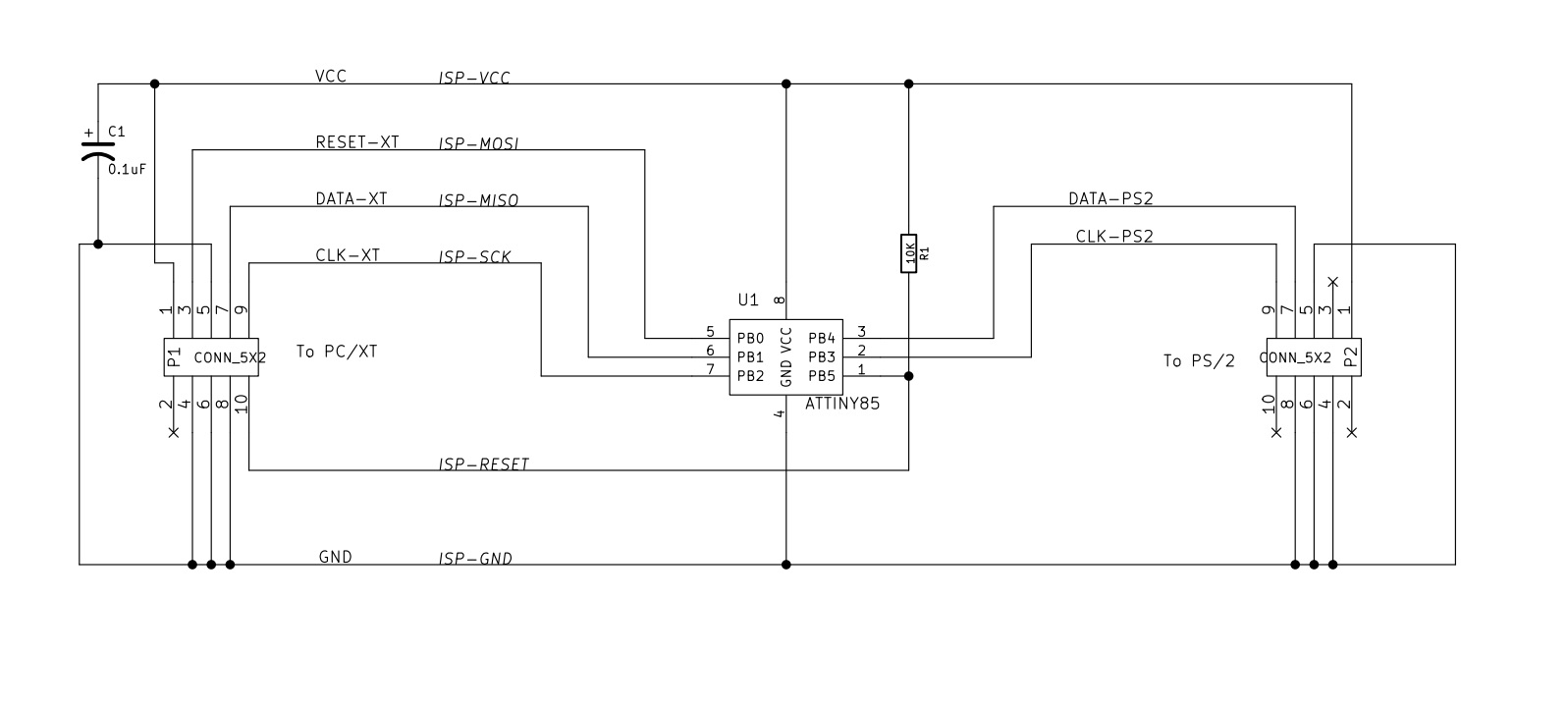

I am also very interested in one of these for my 5155. Anyone know where the schematic can be found or gerber file or a board that I can copy? It seems the OP is no longer responding to this thread but there is still interest from at least a few of us.
@soviet9922; I recognize your username from VCFED Vintage Computer Forums. Have you received any info about this converter?
ibmapc
16 May 2018, 04:51
Anyone Want to help me here? I'm going to attempt to wire this together on a small breadboard. At least tell me the value of the resistors. I think I can see 99 percent of the traces on those great pictures from the first post. So, I should be able to figure out the wiring from that, but I'm having trouble seeing the colors on the bands of the resistors on the left side. I think the one lone resistor near the top edge is 10K? What are the other 2?

ibmapc wrote: Anyone Want to help me here? I'm going to attempt to wire this together on a small breadboard. At least tell me the value of the resistors. I think I can see 99 percent of the traces on those great pictures from the first post. So, I should be able to figure out the wiring from that, but I'm having trouble seeing the colors on the bands of the resistors on the left side. I think the one lone resistor near the top edge is 10K? What are the other 2?
Greg
It seems those resistors are connected to LEDs so it depends on what ones you are using and its value doesn't matter anyway.
Did you find firmware for this converter somewhere?
Engicoder
16 May 2018, 05:57
Here is the simplified schematic for the converter (no status leds)
I need to build the firmware and test it again to be sure the version I have is valid. I will do that tomorrow and then post it here.

ibmapc
16 May 2018, 06:04
hasu wrote: Did you find firmware for this converter somewhere?
Yup, Firmware here https://github.com/engicoder/XT2PS2
EDIT;
It seems the firmware file is not there? Is this just an empty repository? I could have sworn it was there before. Anyhow, looks like Engicoder provided the file in a later post here. keyboards-f2/xt-to-ps-2-converter-for-m ... ml#p413193
ibmapc
16 May 2018, 06:20
Thank You Engicoder for that Schematic. That should make it really easy to wire up on a breadboard. Will one of these work for programming the Attiny85? https://www.sparkfun.com/products/11801
Engicoder
16 May 2018, 06:21
Yes, that should be fine.
