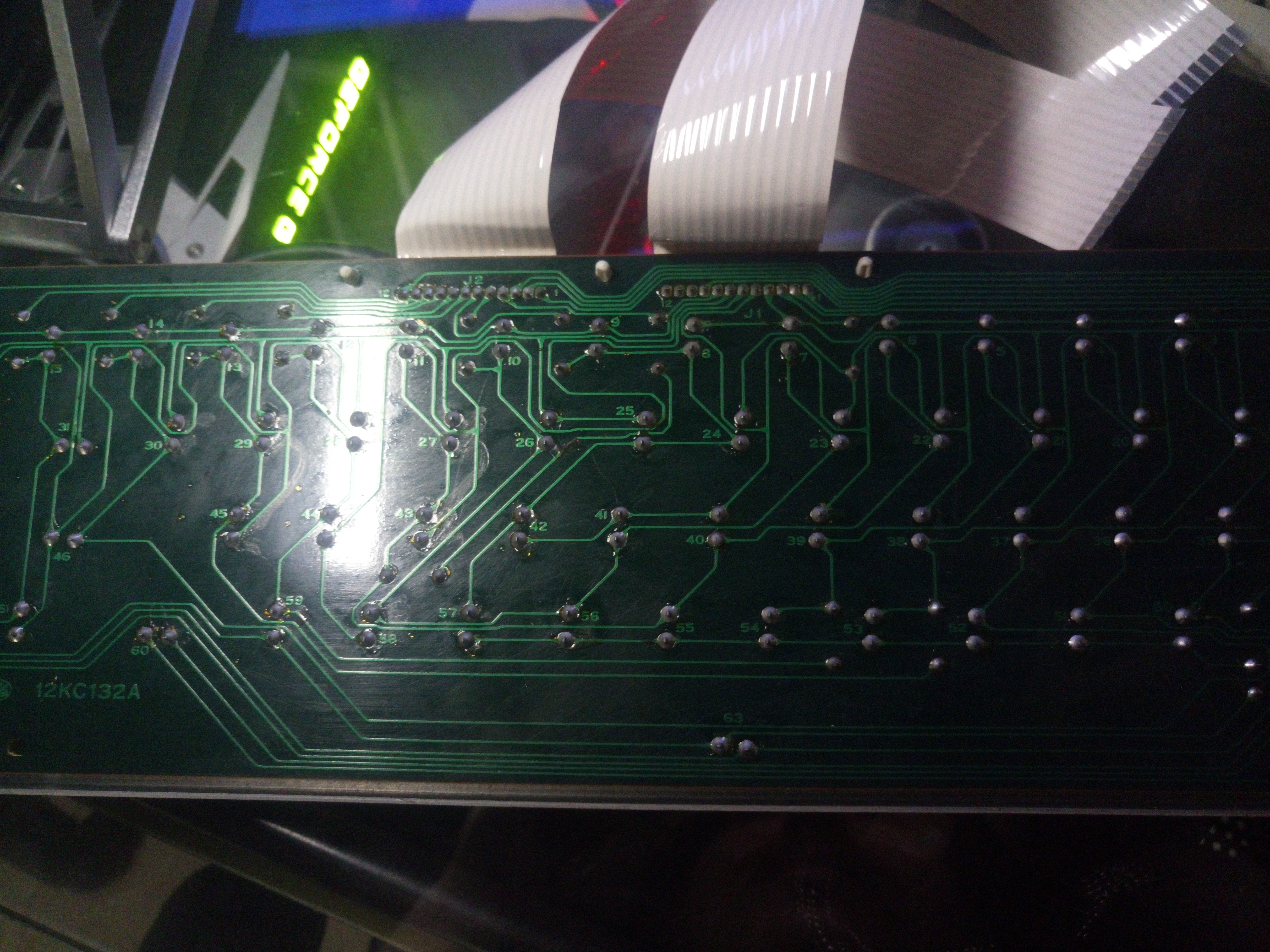

Okay, so courtesy of Macboarder I ended up getting my hands on an NOS SKCC green PCB and plate combo, but I need help adapting it to usb. I know, I am a complete newbie to adapting projects like this, but I felt that it was a thousand times better than desoldering these switches from their steel plate and perfectly good PCB. Anyway, I hope to include a solenoid, as the I think the wooden case that will inevitably house this thing would make it sounds something special.
Anyhow, would anyone have an idea on how to adapt this guy? Should I just get an Arduino and solder the matrix onto the corresponding pins? If so, how can I tell which is which? Just follow the traces until I've found the row? in this case? To be perfecly honest, I'm somewhat stupefied at this task here which might not even be that hard to pull off. Anyhow, any help would be apprectiated.

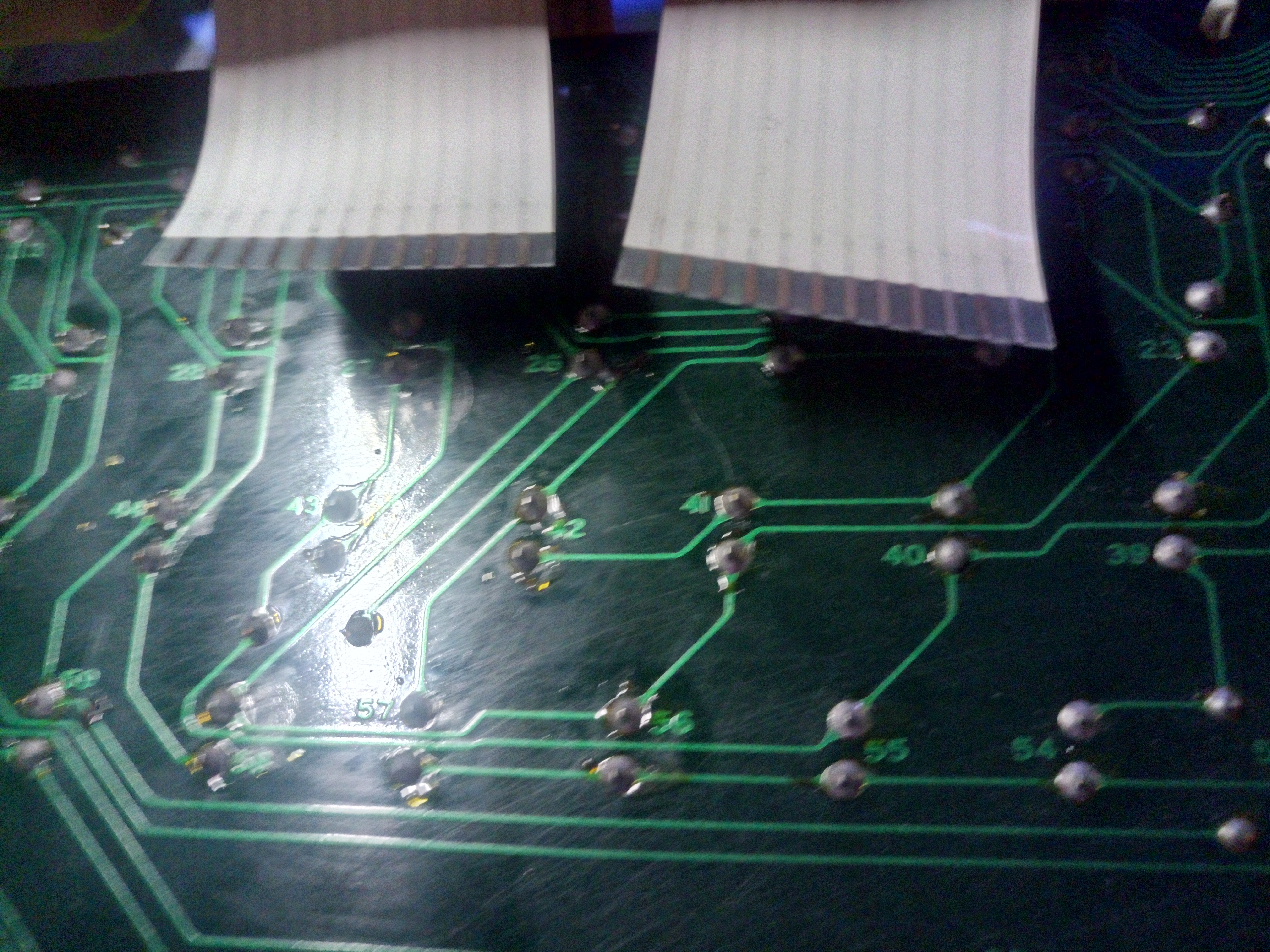

- Ribbon cables soldered onto where the matrix/traces end. Not sure if I can use this, let me know!
- IMG_20180526_125340.jpg (8.28 MiB) Viewed 2090 times

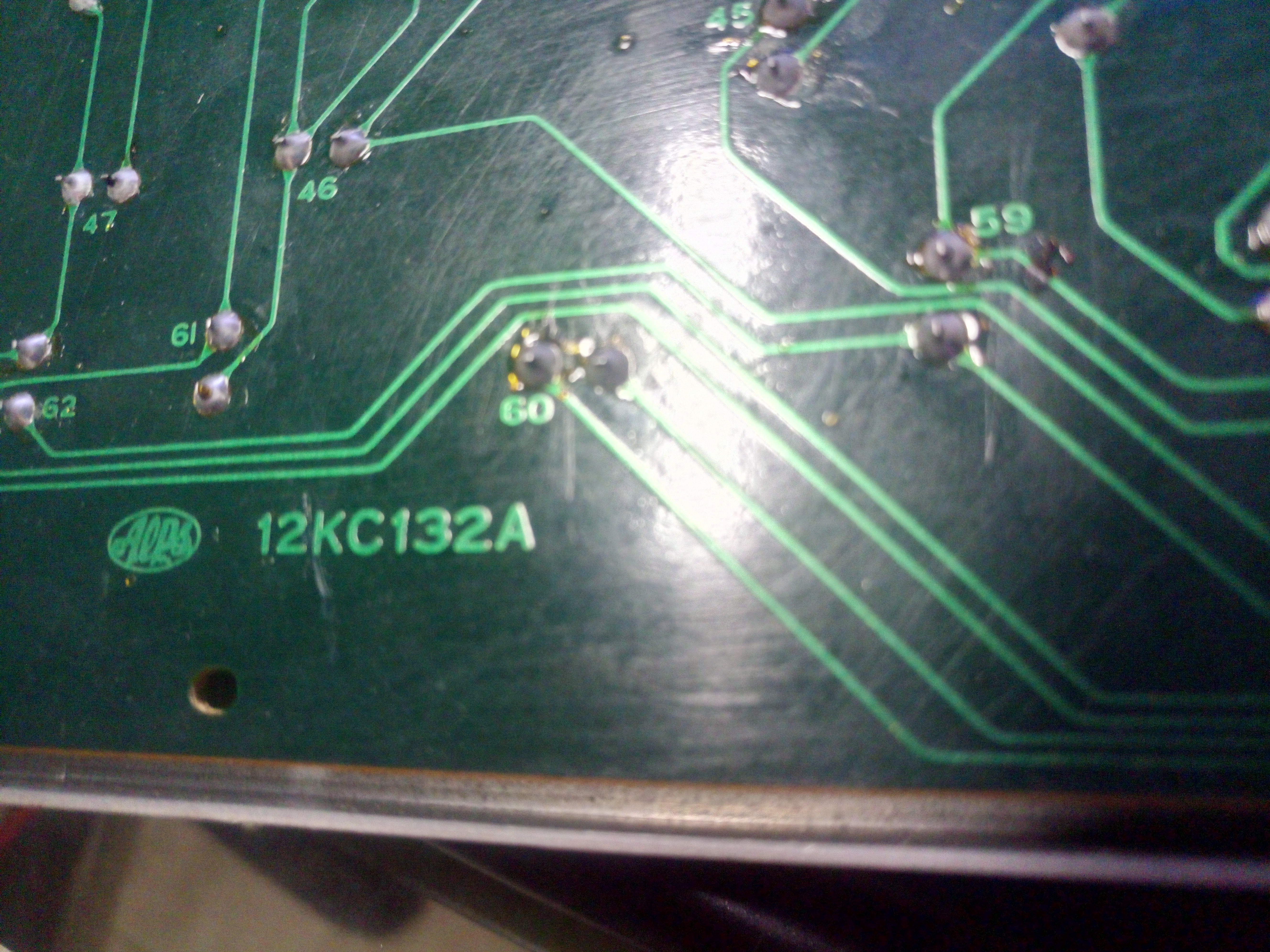

- PCB Model number if that helps anybody.
- IMG_20180526_125309.jpg (8.35 MiB) Viewed 2090 times
- PCB in its entirety. I'm not sure if it's visible here, but the trace leading to switch 59 seems a little damaged. Or is that just flux covering it? It isn't a scratch. It's moreso like a piece of gunk sitting on the pcb, that happens to be very, very solid. Odd.

You have to figure out the matrix first. Every button has two soldier joints that connect to top row "pins" lets say. On that board there's 12 on the left and 12 on the right, which may as well be rows and columns respectively.consideringquiet wrote: Anyhow, would anyone have an idea on how to adapt this guy? Should I just get an Arduino and solder the matrix onto the corresponding pins? If so, how can I tell which is which? Just follow the traces until I've found the row? in this case? To be perfecly honest, I'm somewhat stupefied at this task here which might not even be that hard to pull off. Anyhow, any help would be apprectiated.
So just number those pins from left to right and make a table, checking each button with multimeter.
For example "b" could be pin 3 and pin 16, "c" could be pin 4 and pin 13. Each button will have different combination. Modifier keys could be an exception with older boards.
If you do have the matrix than it's just a matter of connecting arduino board, and editing the firmware of choice to reflect said matrix.
Good luck with the project.
