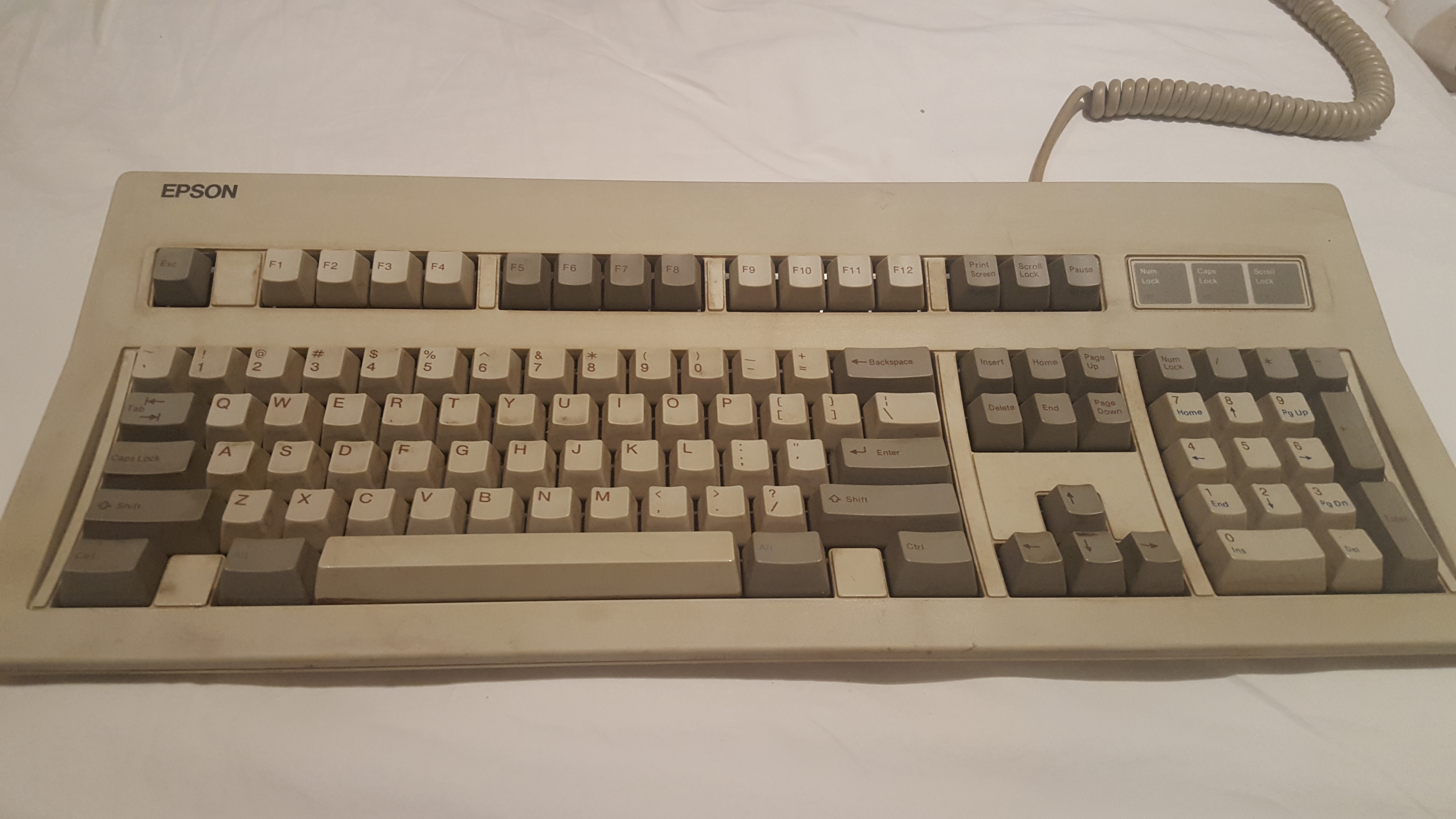

I have a Epson Q203A with Fujitsu Peerless switches that I have been trying to restore/improve. The board has a lot of personal significance to me (my first keyboard, was my Grandfather's), so I would prefer to do my best on it.
The Q, in its grimy, uncleaned glory

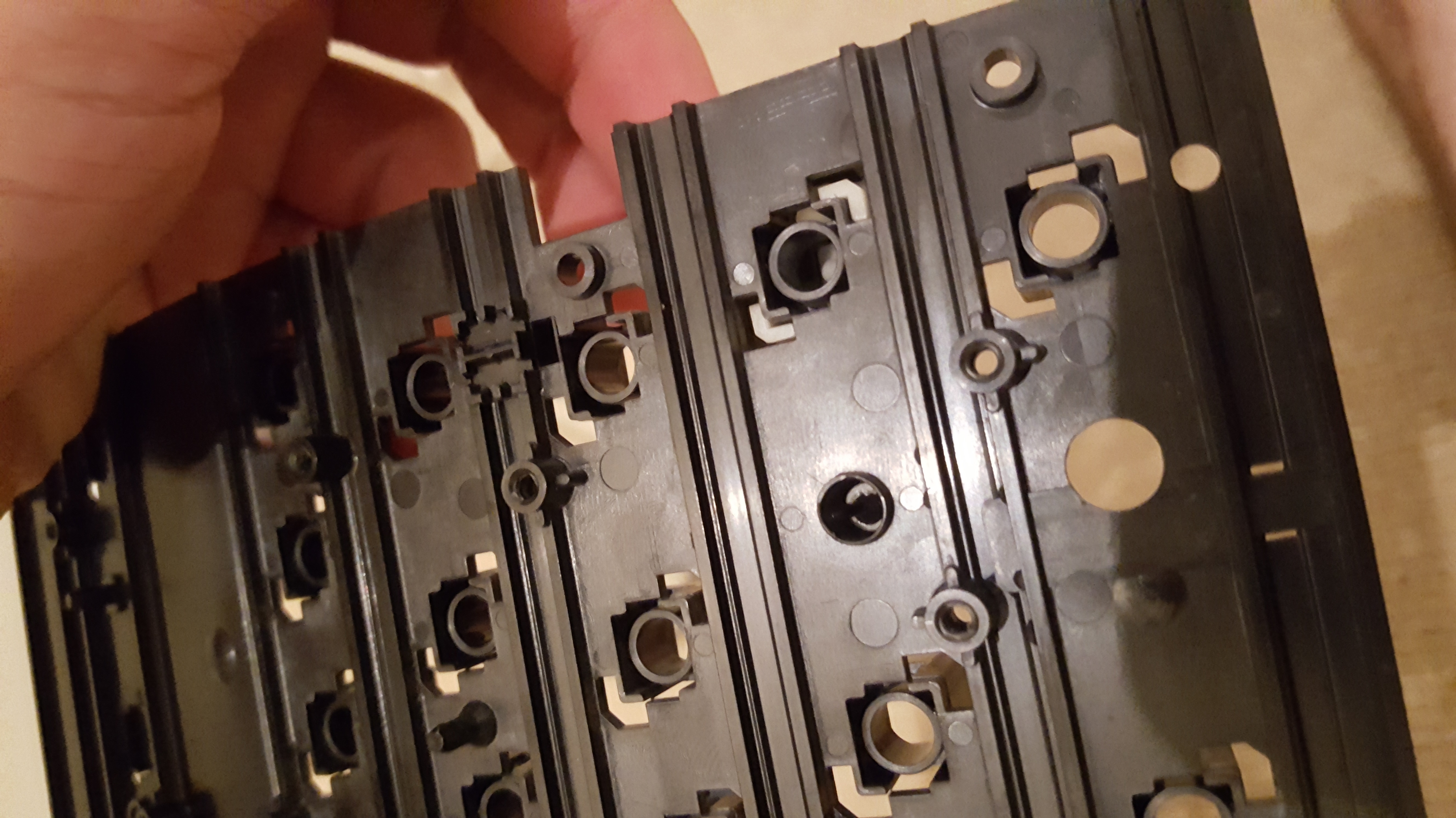

One of the main sticking points that I have found are the stabilizers and the horridly rough feel to them. Off centre, they bind so hard that they are basically unusable. The normal keys aren't worlds better. It is a really puzzling part of the whole thing. Great construction, with PBT dye-sublimated caps, a curved steel backplate (think the Model M, but pre-bolt-modded!). A really interesting way of using a rubber-dome for tactility, while still being not-awful. But then, so so so rough!
I know that the Peerless switches have some fans out there, so I was wondering if anyone had any experience in improving the stabs, or the roughness of the overall feel.

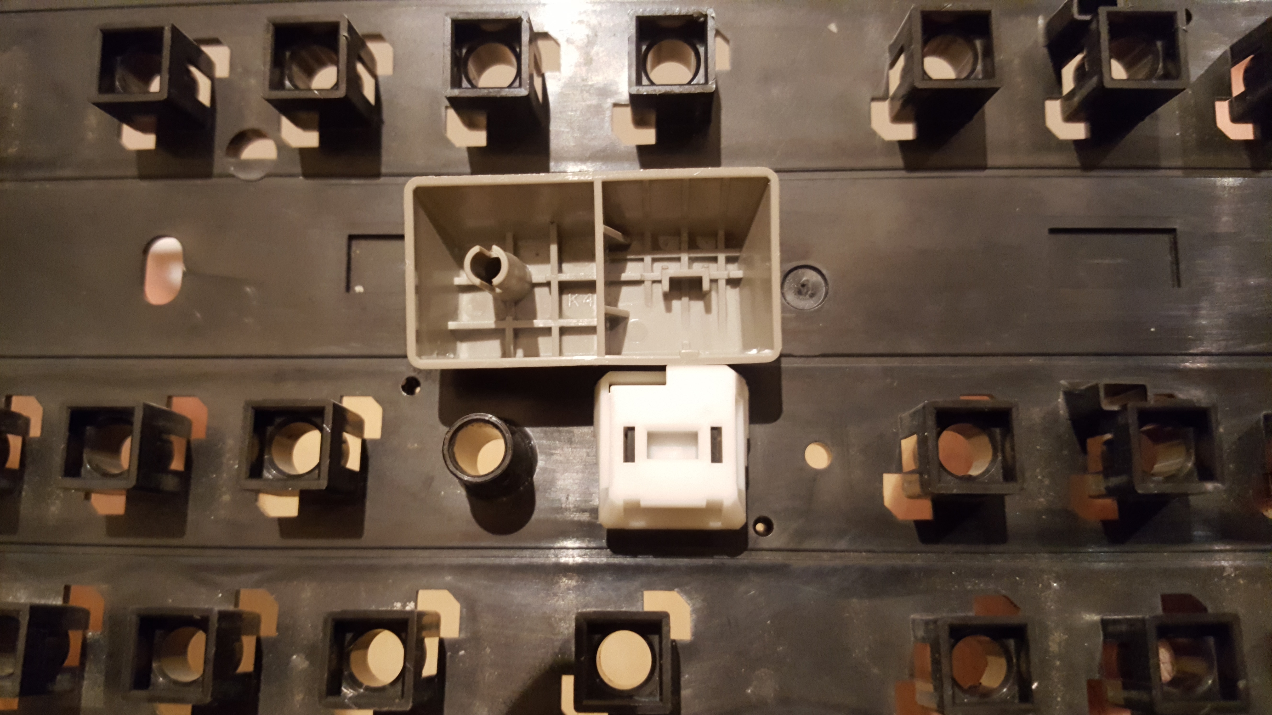

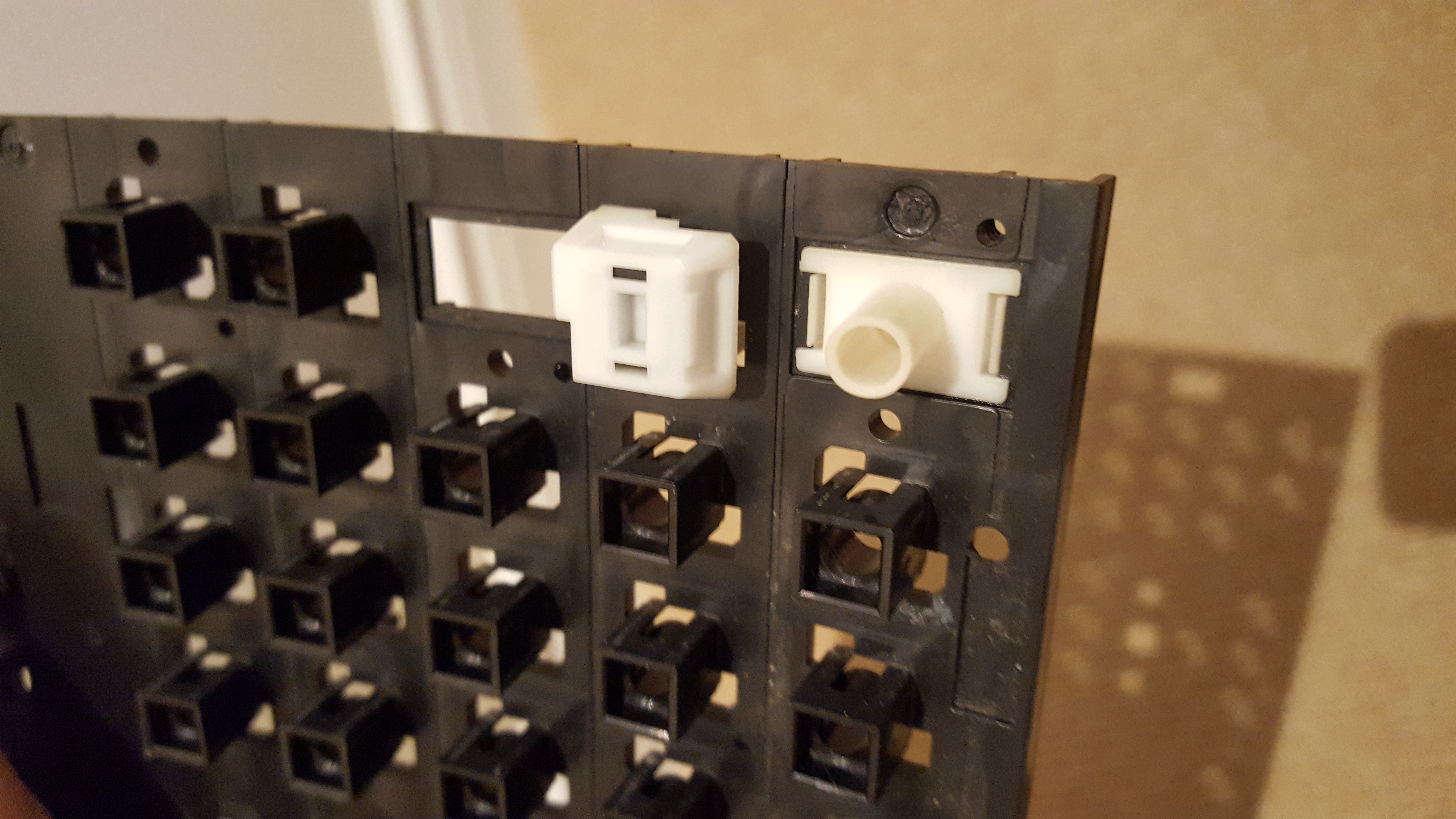

Slider, cleaned beside a stabilized key (shows the pin-stabilizer, and its barrel)
Slider and keycap
Slider and keycap
Barring that, my plan to get it smooth(er) is mostly by cleaning (mostly done) and lubing. A lot of the friction comes from the stabilizers on the switch, as well as the stabs for the extra-wide keys. If you can add in lube on these contact points, as well as all around the pin-stabs, then it should reduce the friction and rough feeling significantly. I've attached some photos of the contact inside the barrel assembly, which sort of shows the offending areas.

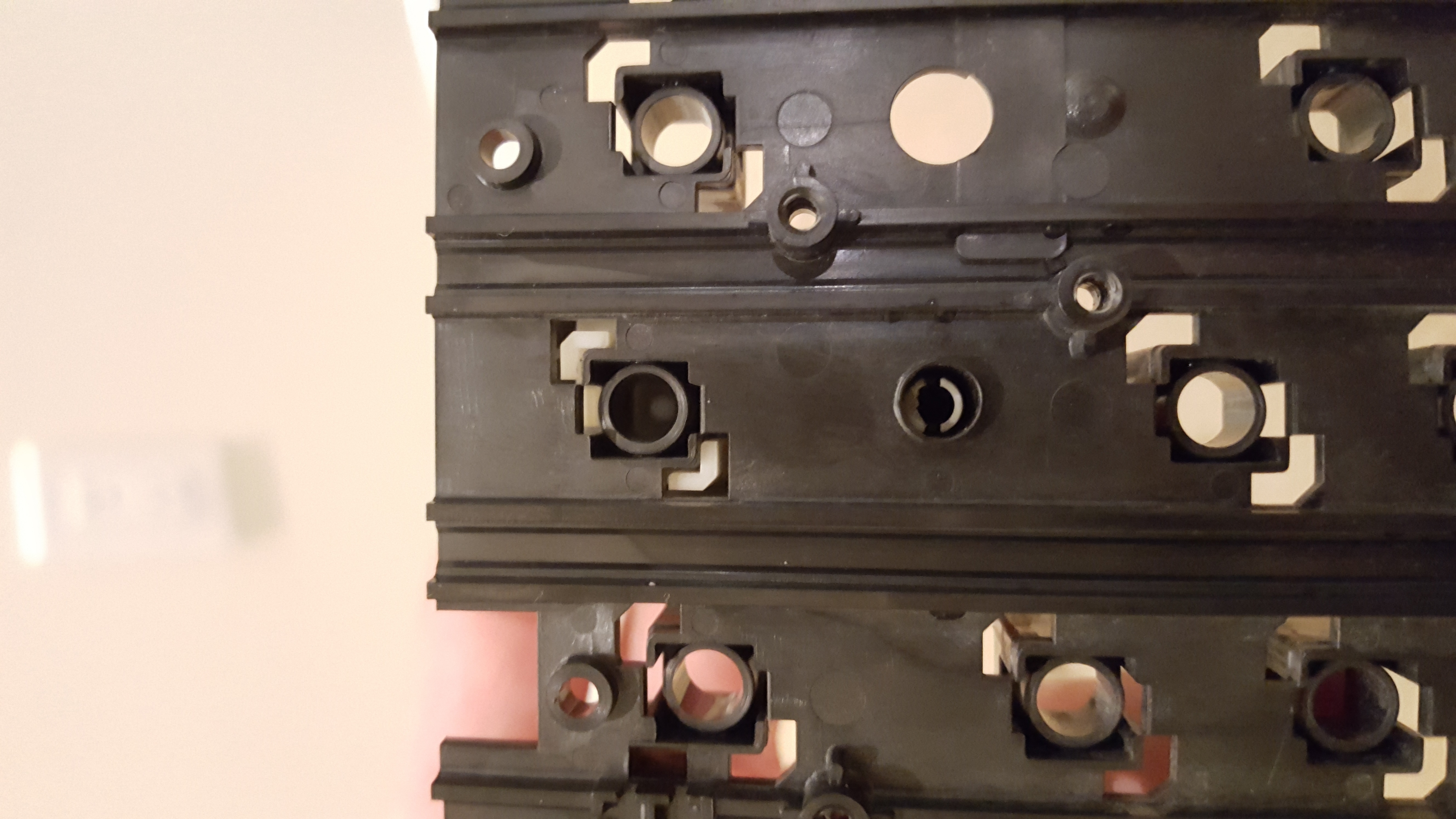

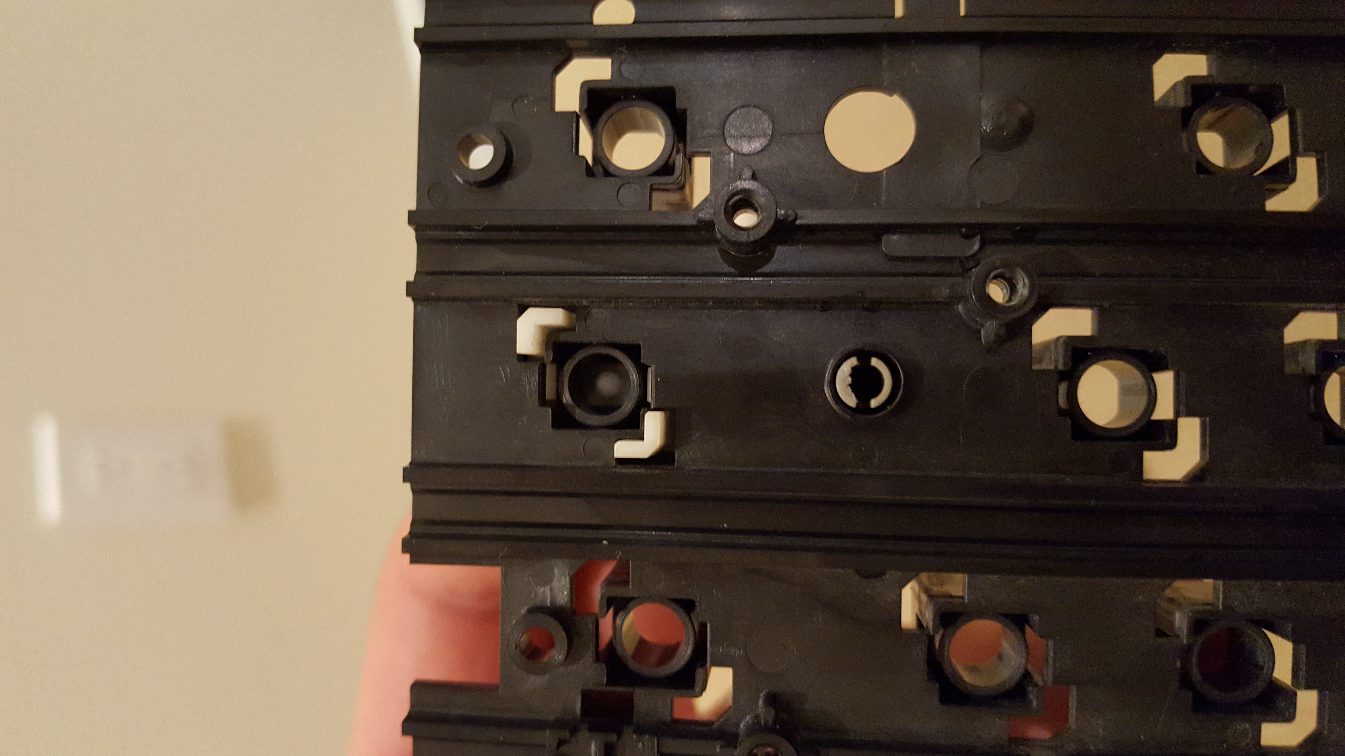

I have heard a lot of good about using a silicon grease, but I'm not sure of what type etc might work best. The plastic of the barrel isn't terribly good for the stabs (not unlike the barrel assembly of the Model M). IBM used separate inserts to make it smoother. Fujitsu said "fuck it", and just had the blank barrels. Where IBM used different inserts (or wires) on the numpad, Fujitsu added a separate stabilizer that clips into the assembly, which feels a lot like the Model M horizontal inserts. Works better than the other stabs, but doesn't fully fix the binding issue. This is why I think that adding lubing would make it work, at least better than it does.
Vertical stabs
Vertical Stab
Vertical Stab
