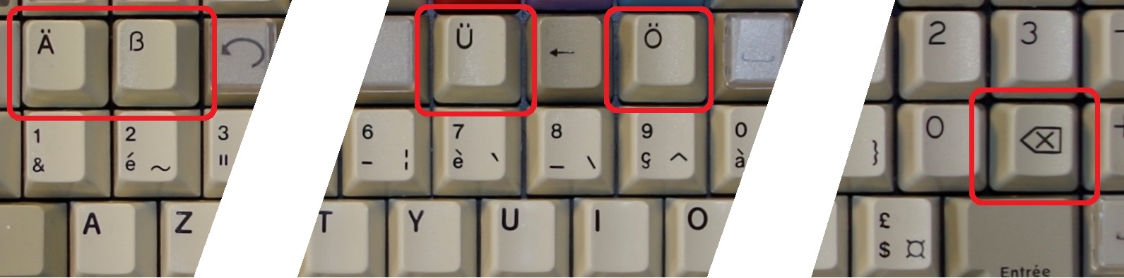

About 6 years ago I had 5 custom keycaps made for me by Qwerkeys.
They were engraved and infilled, and while I was not entirely satisfied with the reproduction of the legends themselves,
they were excellent craftsmanship with sharp outlines and are still in use:
engraved and infilled by Qwerkeys.jpg (189.64 KiB) Viewed 1569 times
However, as far as I am aware Qwerkeys do not provide this service anymore.

Those are some crisp corners in the engraving o_o I wonder what type of tool Qwerkeys used. (I can probably just razor knife it.)
