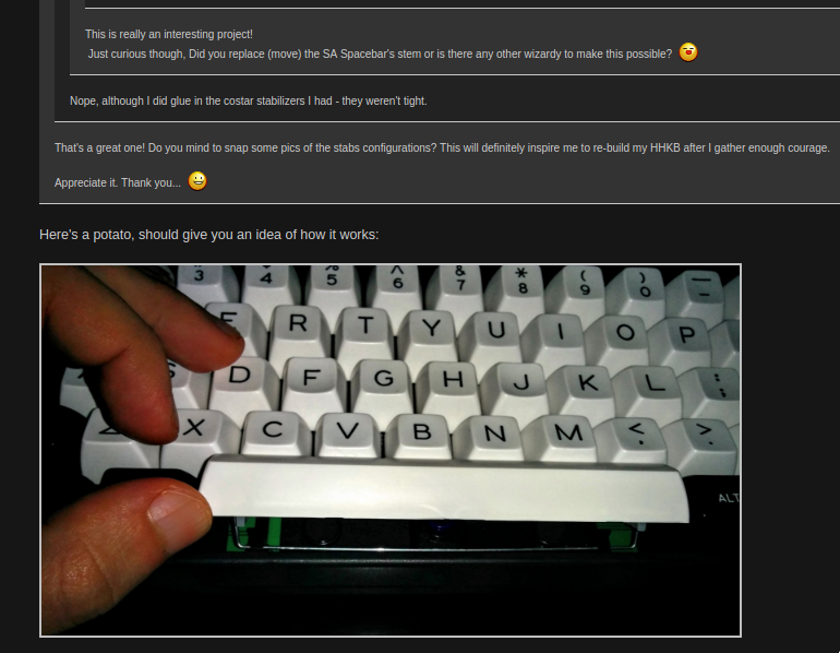

Not all is lost, IF you have 6u MX-compatible spacebars .. there was a thread on GeekHack about somebody replacing the spacebar from a HHKB I think, by placing (somehow! that's the trick) Costar stabilizers instead of the Topre spacebar stabilizer housings. Sure, you can always take the spacebar stabs from a Novatouch, but this means you just sacrificed it, or you moved the problem on the Novatouch ..
Ah yes! Here it is:
Relevant text:
Q: Did you replace (move) the SA Spacebar's stem or is there any other wizardy to make this possible?
A: Nope, although I did glue in the costar stabilizers I had - they weren't tight.
(This thread, called "Topre SA keycaps other than HiPro?", although it won't load for me right now, had to use google's cache)
Pics from that same thread (to drool over):
P.S. Sorry for somewhat hijacking the thread (temporarily)! All in the name of Topre-to-MX-conversion keyboard science!
