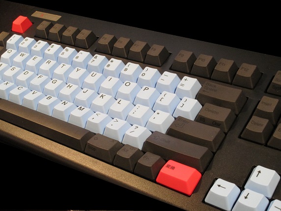

Here is a pic of my RF87UB55 fitted with some legible keycaps and accents. I use the red key in the RCtrl position as my Fn key in my HHKB-esque layout. This mutation gets rather expensive, but I wanted the dark case and I need alpha keys that I can read.
