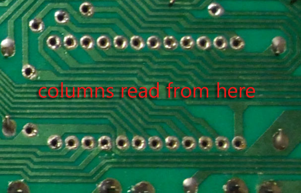

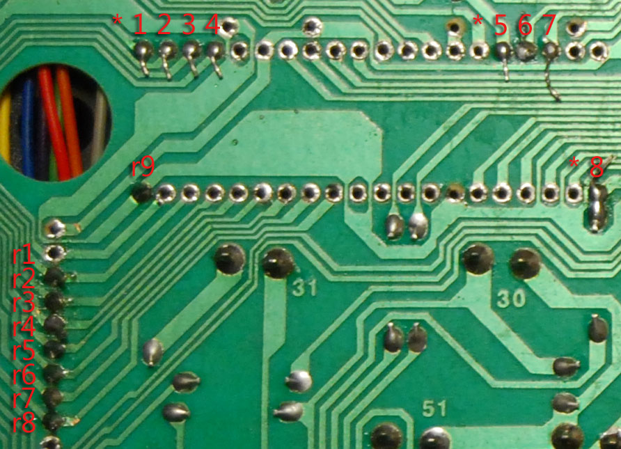

Figured this might be useful for some. Was pretty messy to map out, it had to be hooked up to read the columns from the decoder pins for some reason.
Serial number is AM0103JJM3501S. It's a 9x24 matrix, with dedicated pins for the modifiers+capslock (columns) on the controller. The rest of the columns are wired to a decoder and then the main controller. The ALT keys are joined together. I couldn't figure out a way to use the columns from the decoder pins (I'm not an EE), so I just took tapped in to them from the switch pads.
Try to ignore the heinous soldering and torn off pads, it's a testing board. :)
Just select all and copy/paste into notepad or something to get proper formatting.
        1       2       3       4       5       6       7       8       9       10      11      12      13      14      15      16

Cool idea! That lock key is great. Since the ALTs are joined, I decided to use them as the FN-key with the new controller (Teensy + dmw HH firmware). I put the lock key on the rightmost one, enabling arrow-key usage etc without having to hold down a key all the time (I cut the board MiniGuru-style). It's not finished though, gotta build a case for it.

The matrix is really 16 by 8, with additional direct pin assignments for the mods, rather than a 9th row. That’s how Apple got around their cheapskate lack of diodes! It’s actually quite convenient for me, as the isolated power switch could be most handy.
The AEK I and II’s internals are similar but a bit distinct. I’ve got an AEK II in ANSI as well and compared them side by side. The original gangster has the same ICs, but helpfully socketed to make them easy to remove! There’s a lot more room on the older PCB in general, yet the matrix is one and the same. Saved me a lot of time mapping it all out the hard way for myself, because I have something more modern than ADB in mind for this big boy.

both command keys are connected to the same pin, and I wanted my software to be able to distinguish between them, so I cut the trace for the left command (GUI) key, and wired it directly to the teensy

Something I don’t understand is where to actually hook up to the columns on the AEK I. I couldnt find a pin for any regular switch I tried. The way I checked the matrix was from the switches themselves, which I could patch to with my replacement controller if necessary. But it’s more elegant to use the IC sockets. I’m just failing to understand how that decoder works. Think I get the concept, I just can’t find the pins!
