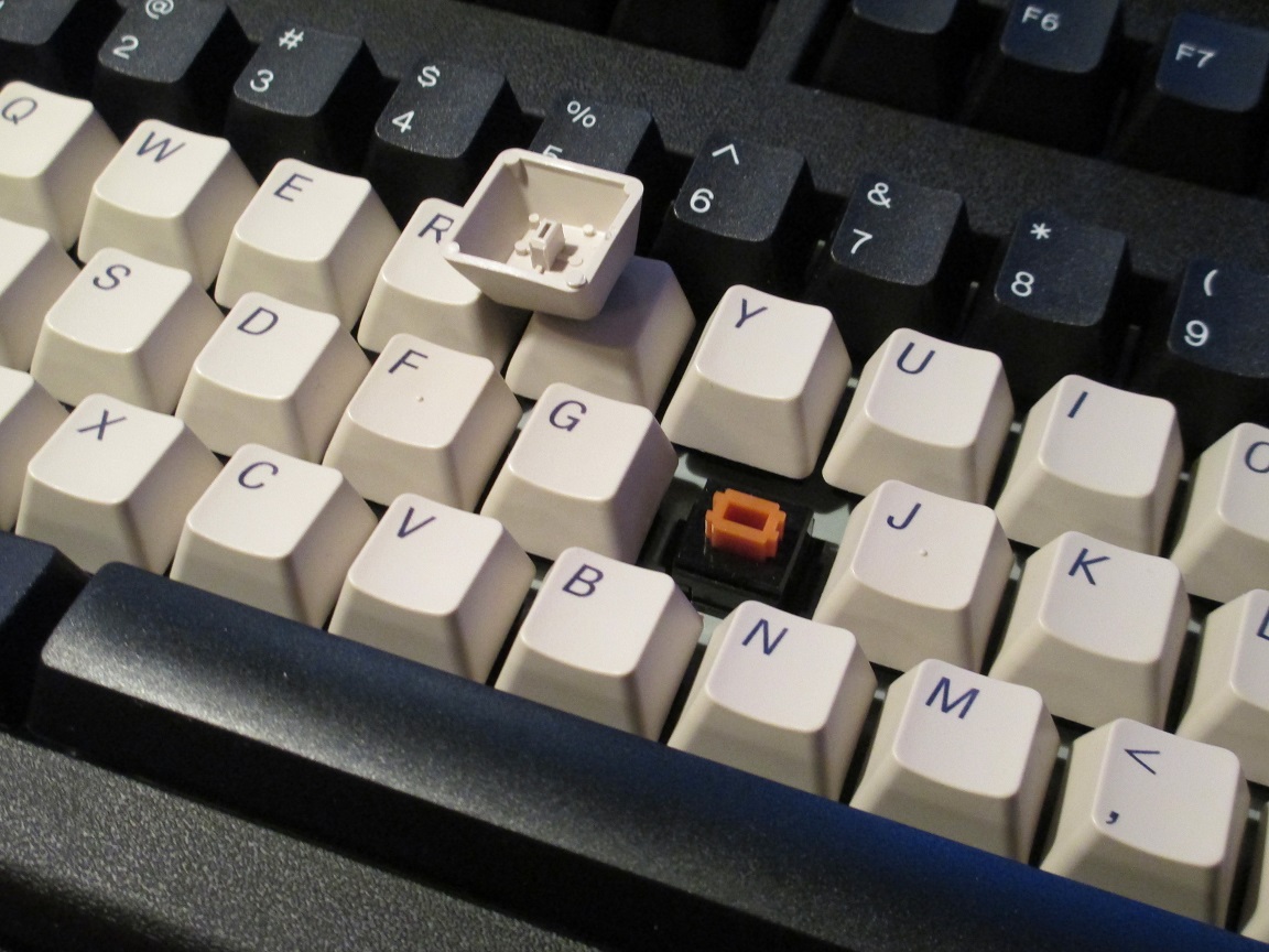

If you would be willing to go with Alps switches, the Northgate Omnikey 101 US ANSI is one of my favorite full-size vintage keyboards. It is also one of the most solid keyboards ever made. It comes with SKCM white Alps switches -- not much need to change these or do anything to them unless you prefer a different type of Alps of if you want to clean and lube them. The board has a detachable PS/2 cable. It is easy to convert to USB. I use an internal Orihalcon-Soarer converter and a flush-mount micro-USB connector that lines up perfectly with the existing PS/2 connector -- no need to drill any holes in the metal back of the case.

I'm typing this on a Northgate Omnikey 101 with hybrid SKCM white and orange Alps switches, keycaps from several different vintage and contemporary Alps sets, black-painted case, and internal Orihalcon-Soarer USB converter.
My Northgate Omni 101
