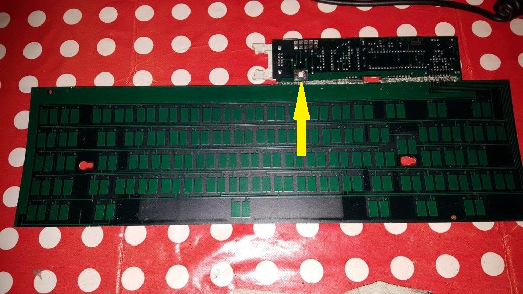

If I gently slacken the grounding screw on the PCB (location indicated in photo), the "c" and "m" keys work - but none of the other keys! I can't get the screw at the "sweet spot" where all keys work :evil:

Are you using the original cable and then using the teensy? Or do you have the teensy soldered with the pins going into the blue connector of the pcb?
Can you take a closer image of the front and back of the pcb around the area with the soldered pin connectors? That row running left from your yellow area. The one with the white stuff. What is this white stuff? Do you have a layer of the clear rubber under the pcb or that sort of clear sheet?
If I recall X and C are on the same column and N and M are on the same column. Different rows for each key. The space bar and lower keys are on that row as well.

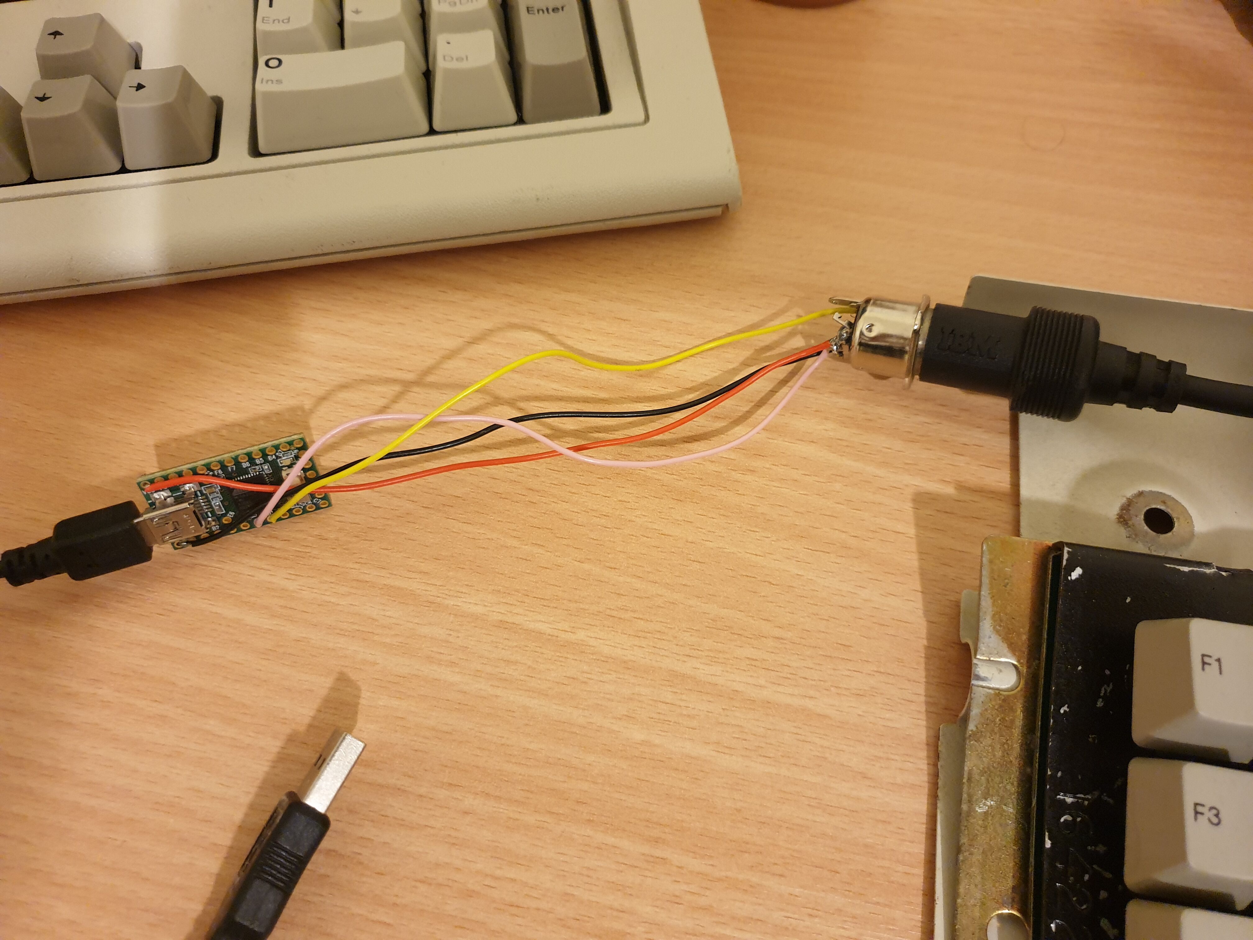

I have the original cable with the 5-pin din. Soldered to the Teensy is a 5-pin din plug, and I have simply plugged them together. I was a bit precious about cutting the cable to solder the wires from the block connector to the Teensy!

Correction - soldered to the Teensy is a 5-pin socket! The original 5-pin din plug is then plugged into the socket.

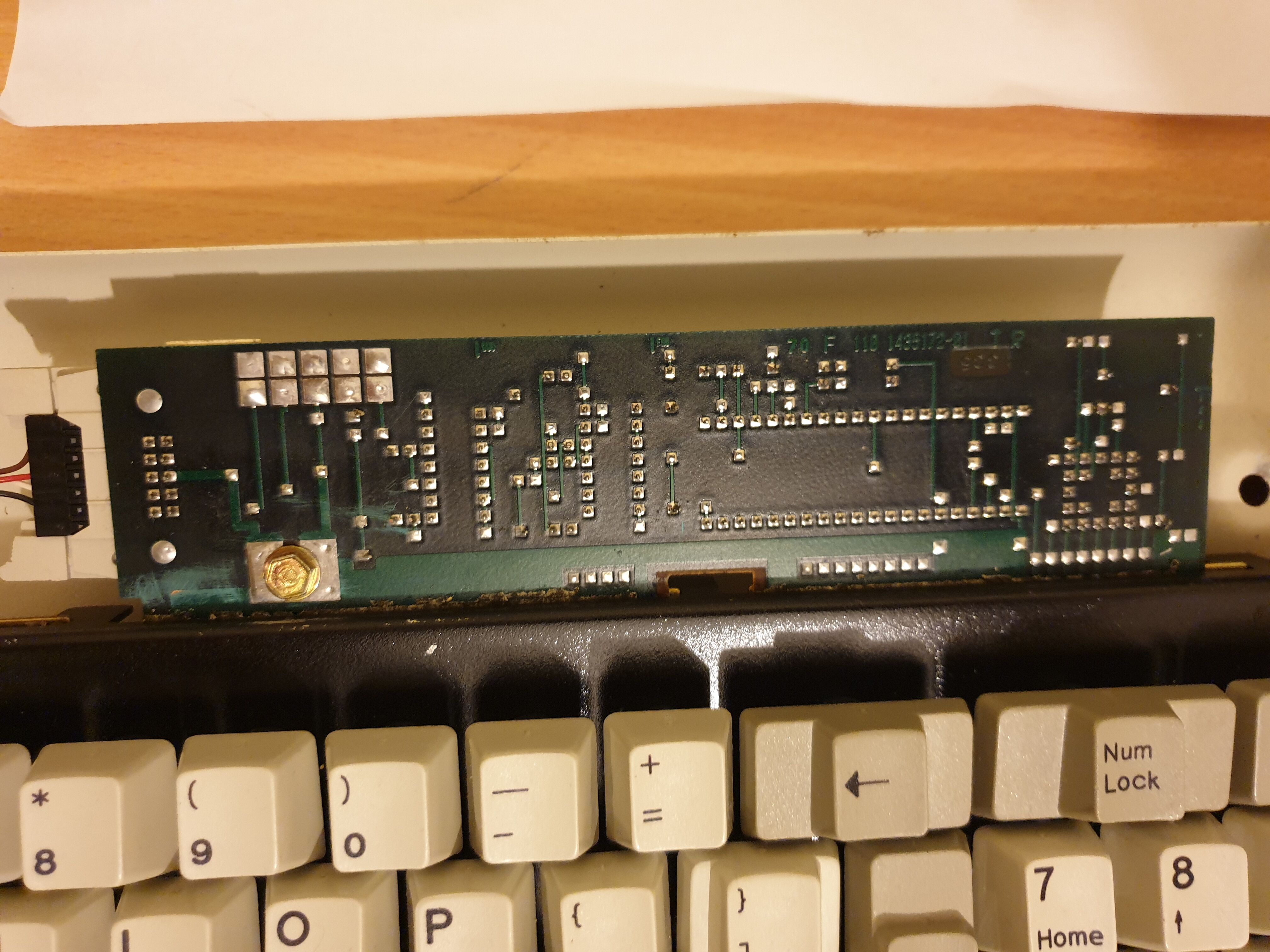

Here are a couple more photos. The white stuff on the pcb was some remnants of the old foam which I have now removed.
The other photo is of the Teensy running Soarer's converter and connected to the original cable using a 5-pin din socket.

I can barely see any solder on the Teensy, are the connections good?
Try grounding the plug too, the original cable's shielding is also grounded.
If you want to do an internal USB conversion eventually: solder pin headers to the Teensy then use female/female jumper wires. It's non-destructive as long as you don't lose the original cable :P

Darkshado wrote: 15 Mar 2019, 02:46 I can barely see any solder on the Teensy, are the connections good?
Yes the plug has a ground as well good point.

First photo without the metal, then the reverse of the same PCB area, please. From the post photo it really looks like all the PCB traces at the edge of the metal are cut :)
JBert
16 Mar 2019, 12:25
The PCB seems to contain some sticky residue of the original foam. I've seen it as well on one of my XTs that the bottom side of the foam layer was white.
