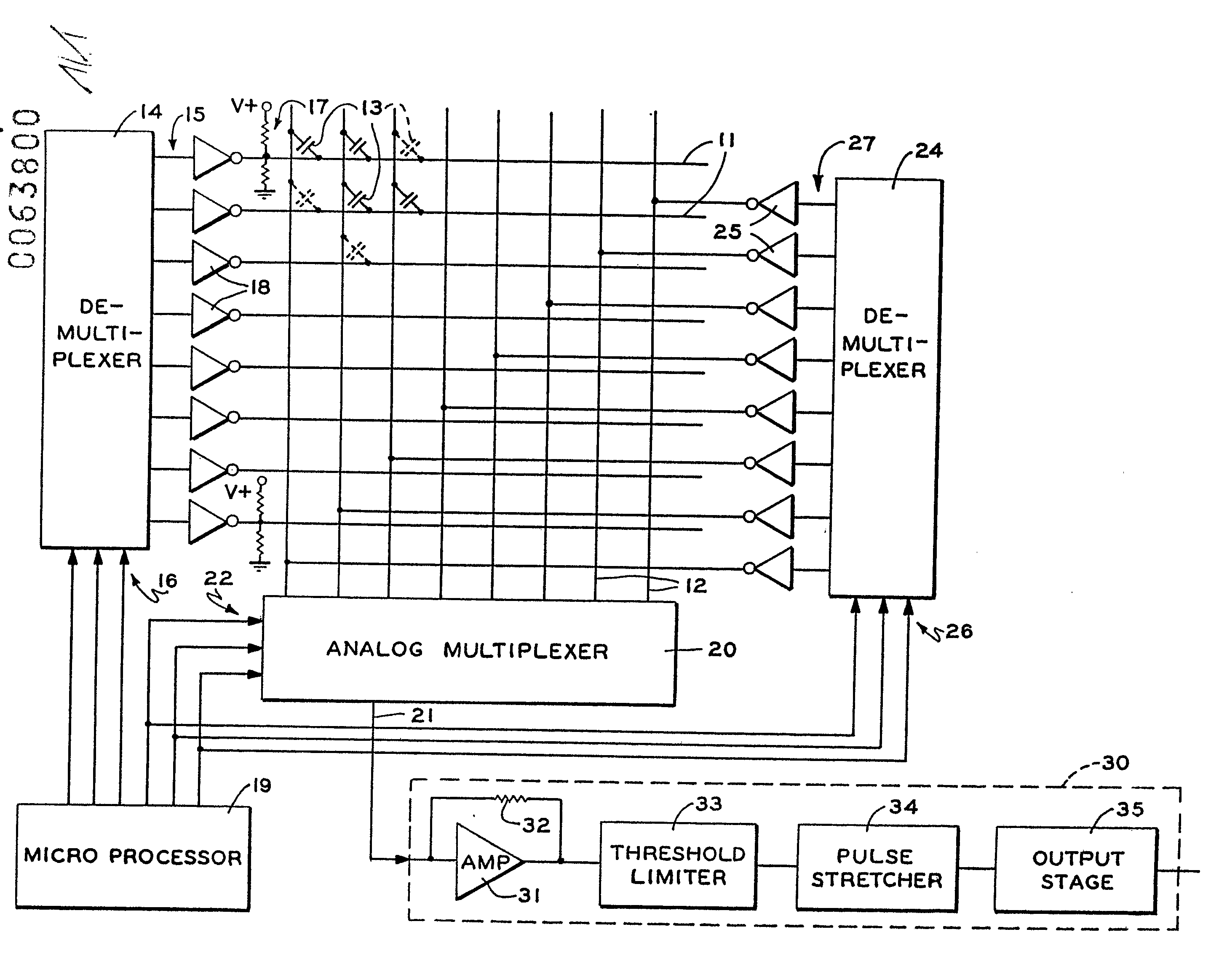

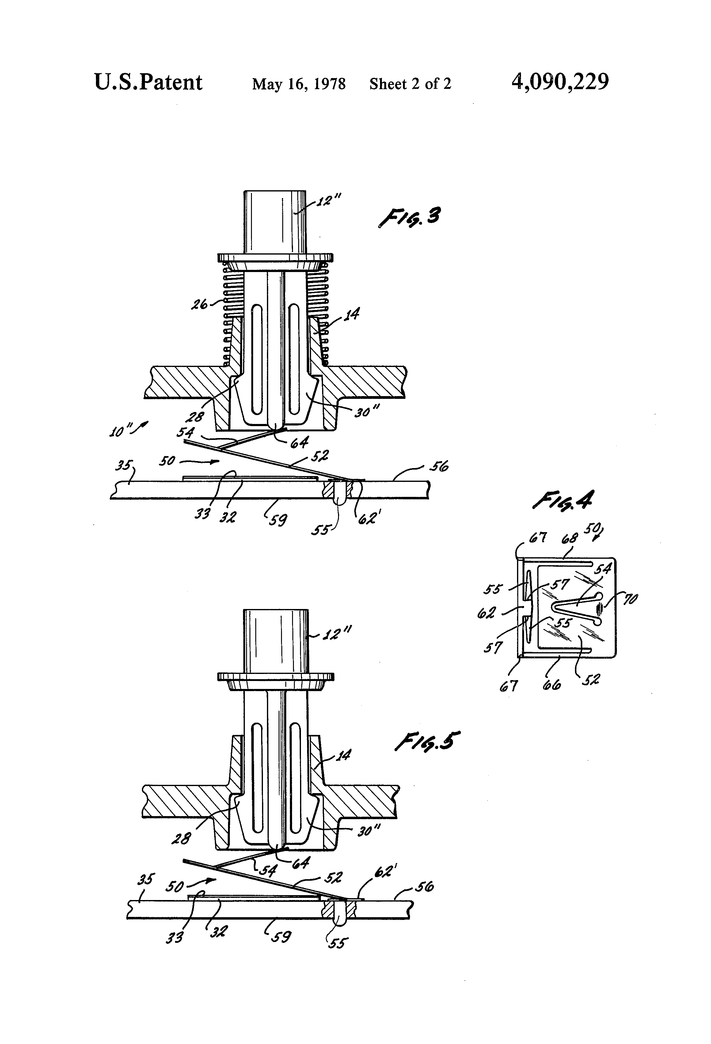

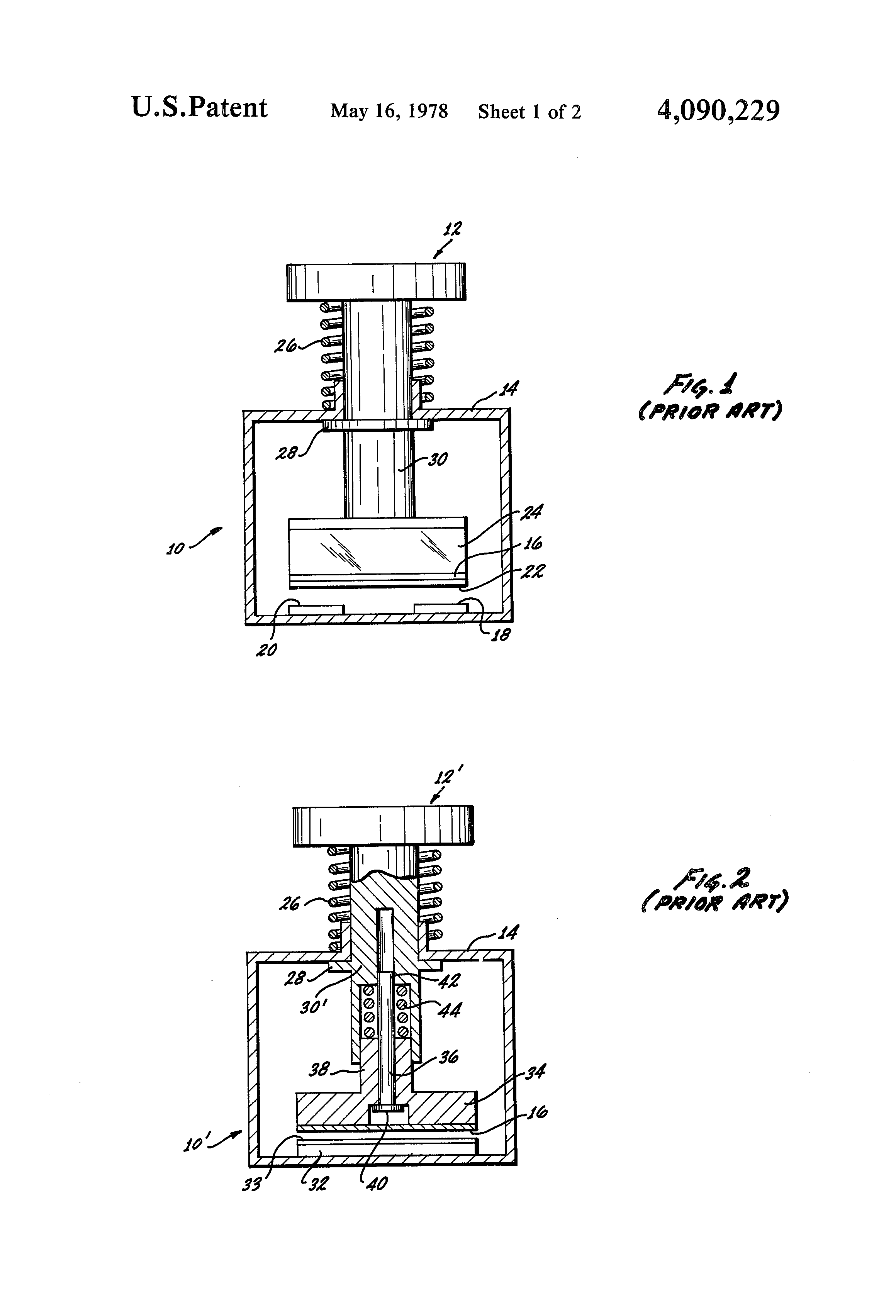

User101
19 May 2019, 04:52
I was going through the patent numbers on the keyboard and found some interesting images. Probably won't help with the effort but its fun to look at.
I will link it here:
https://patents.google.com/patent/EP0063800A2/en
https://patents.google.com/patent/US4090229A/en
It also described the travel distance of this particular switch is 3.81mm.
Interestingly one page of the patent file shows a different type of switch that looks very different from this one.

User101 wrote: 19 May 2019, 04:52 I was going through the patent numbers on the keyboard and found some interesting images. Probably won't help with the effort but its fun to look at.
I agree, it is fun to look at that stuff. I dove into the patents on another project and it turned out to be very helpful in figuring out the board.
It's funny you mention patents, a patent number is actually printed on a sticker attached to the plate. The sticker say 3,750,113 and 4,090,229.
Once I get to a steady state with the CommonSense conversion, I might have a look into these numbers to see if they turn up any material.

Dumping this here for now, to read later. These are the patents that are on the sticker stuck to the plate.
Capacitive keyboard
https://patents.google.com/patent/US375 ... oq=3750113
Capacitive key for keyboard
https://patents.google.com/patent/US409 ... oq=4090229
