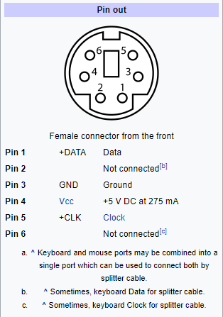

Orange matched up to pin 2 on the ps/2 pinout. Brown matched up to pin 6.

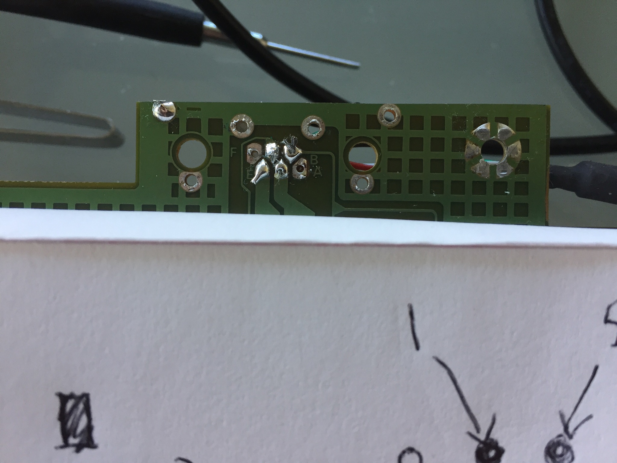

The first thing to check would be is it getting (enough) power?
Do you have a multimeter?
Open up the keyboard and look for all of the ICs (chips).
Use your multimeter to measure the voltage by touching the probes to the pins indicated in the picture.
Each one should measure close to 5v (probably like 4.6-4.8 in reality).
Note: these aren't always the Vcc and Gnd pins, just very frequently. If you google the number written on each chip, you can usually find the datasheet which will tell you the exact pinout of the chip.

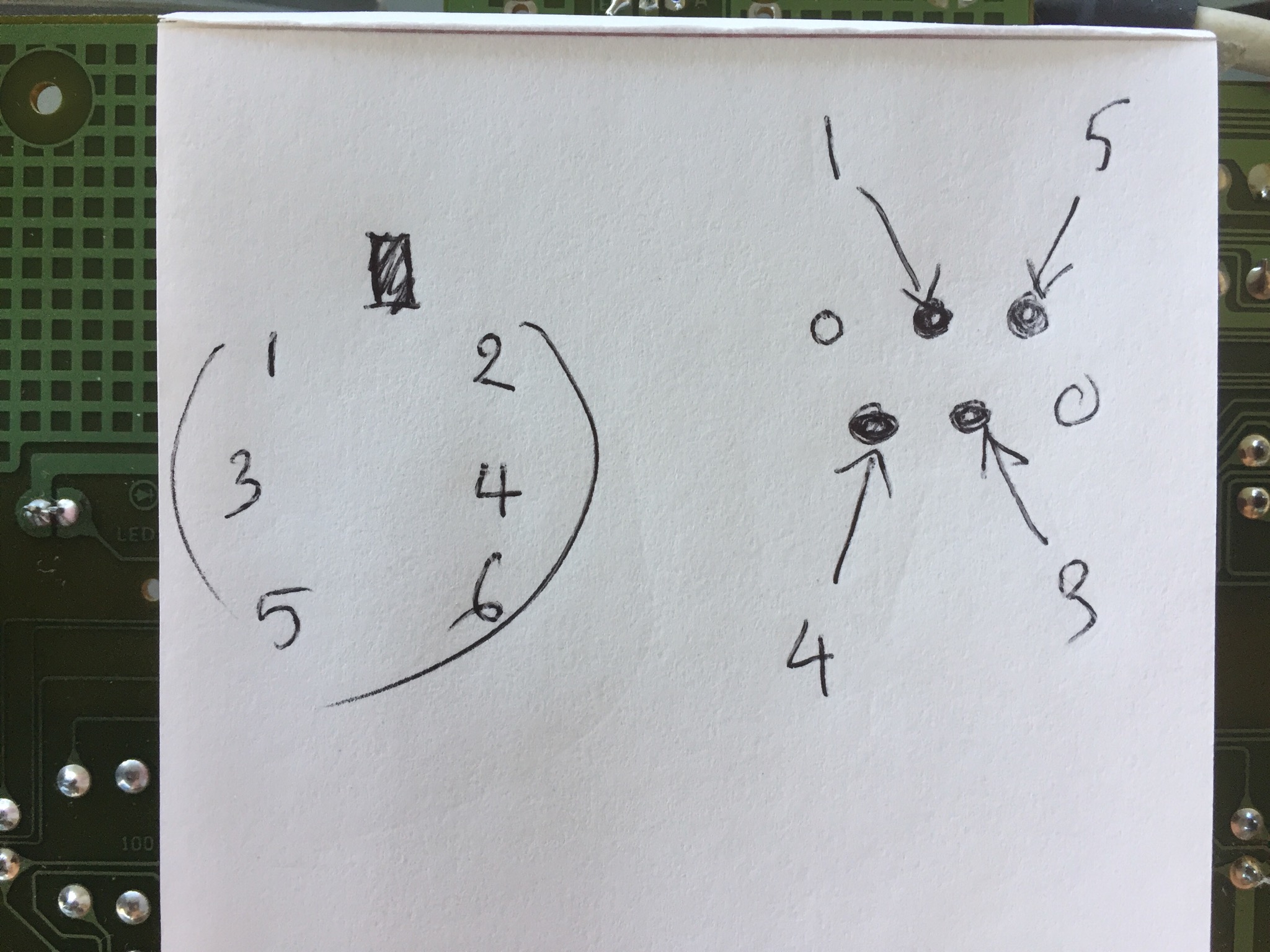

Can you post the ps2 pinout picture you referred to in the OP?
consideringquiet
18 May 2019, 22:23
snacksthecat wrote: 18 May 2019, 22:21 Can you post the ps2 pinout picture you referred to in the OP?
Sure:
snacksthecat
18 May 2019, 22:29
You confirmed with the continuity tester that each of the colors from the keypad cord correspond with those positions in your ps2 pinout image?

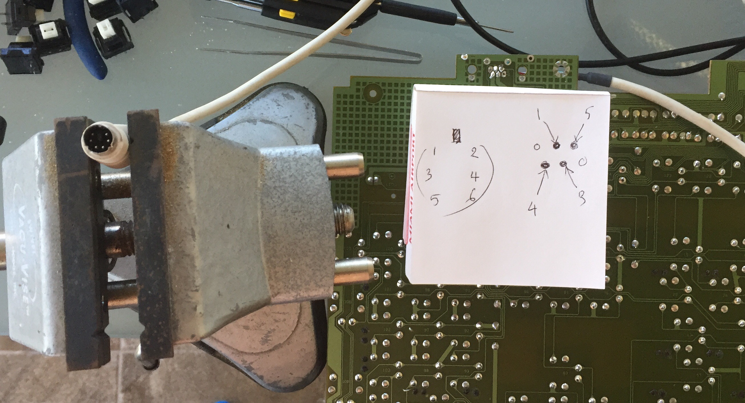

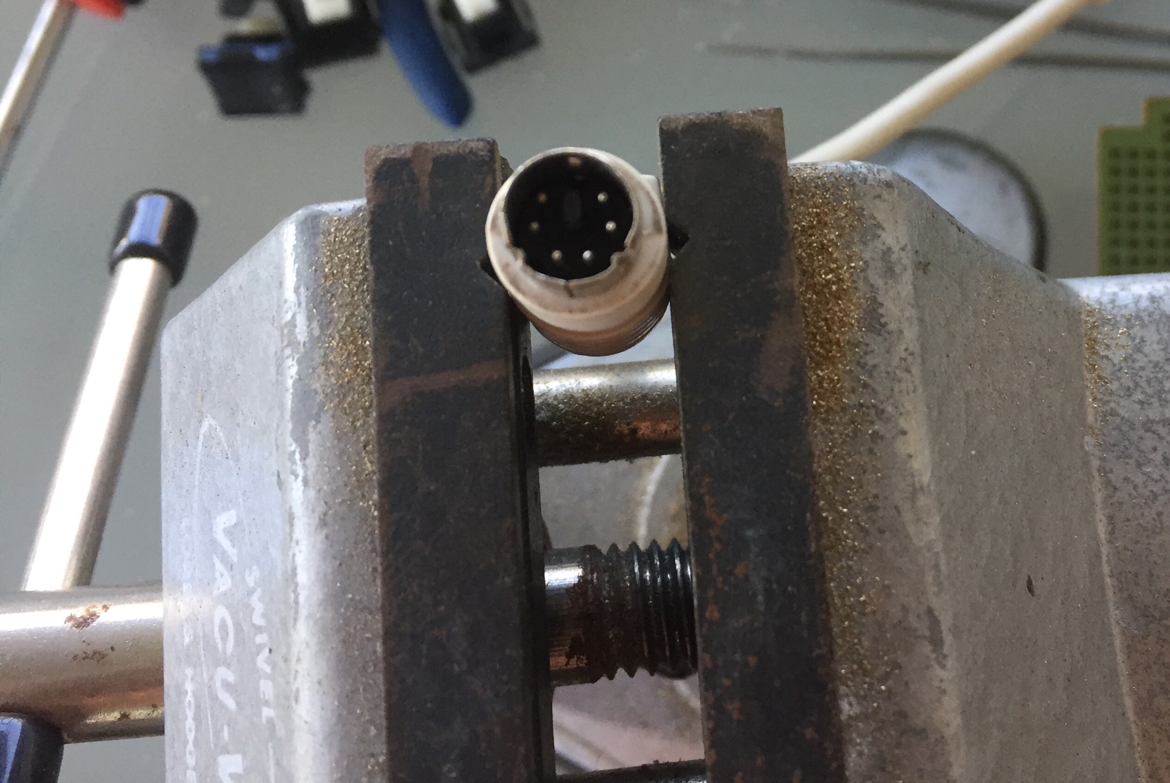

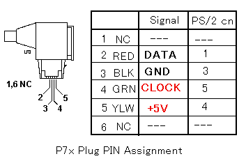

Delirious
19 May 2019, 00:35
consideringquiet
23 May 2019, 02:44
Delirious wrote: 19 May 2019, 00:35 3F6F53CB-5B09-4DE8-BC3D-03F53FF105D9.jpeg
I'm sorry, Is there any way of doing the conversion without opening the case?

27 May 2019, 09:07
I literally just connected the wires from the PS/2 cable to those from the P70's; twisted them together and then joined by soldering. I can't remember the details anymore unfortunately; it's been a while. If you want I can unscrew my converter box and look inside at what I did :) .
