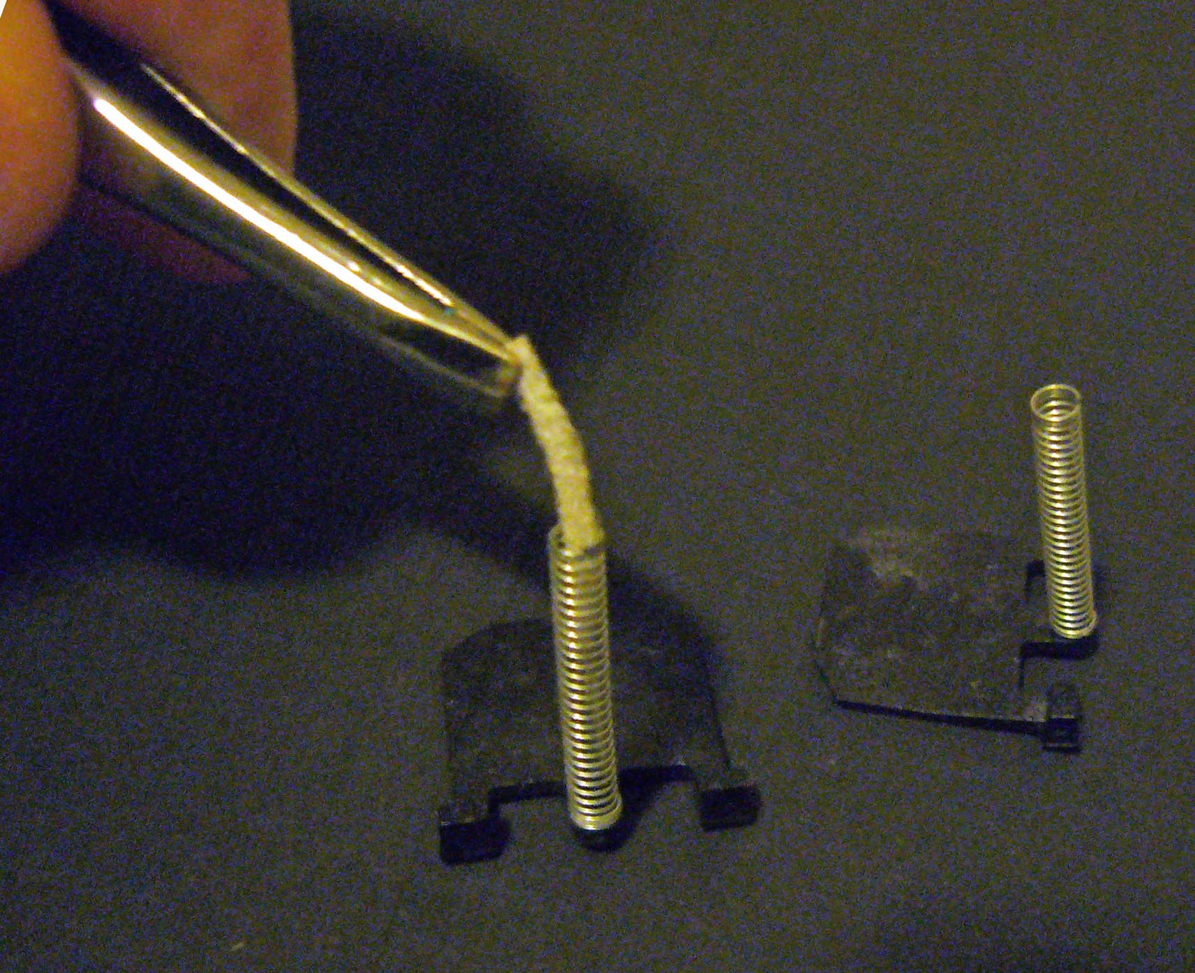

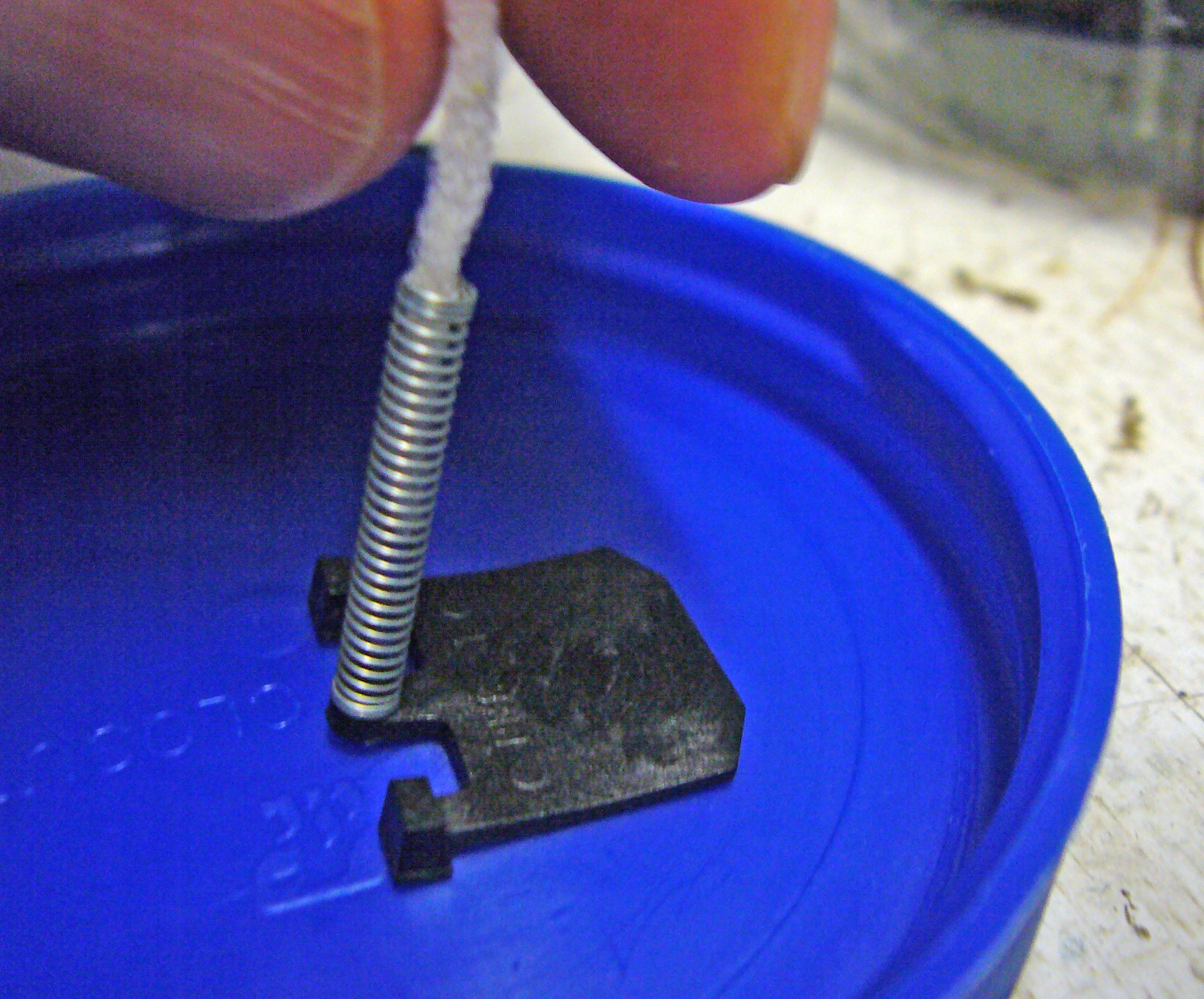

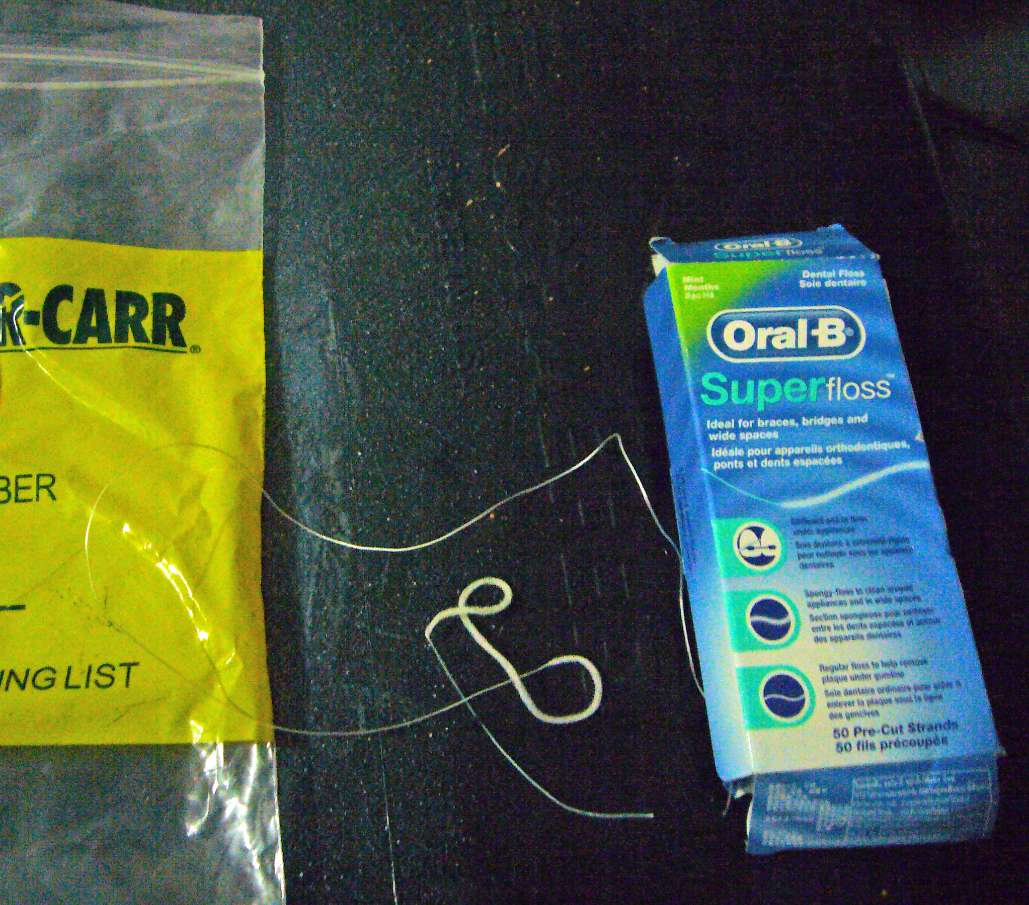

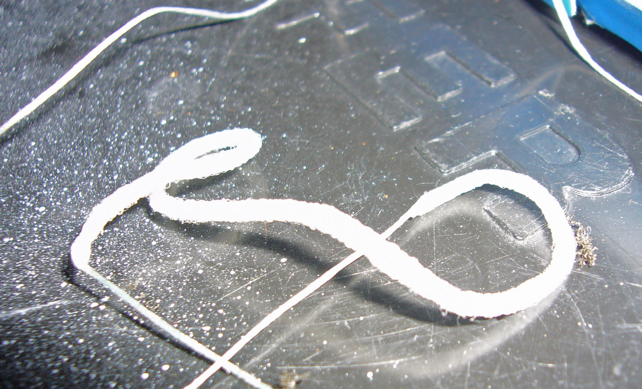

The "floss mod" is one way you can bring down the volume of your capacitive buckling spring keyboard. Inserting floss into the springs prevents them from reverberating, reducing the metallic ping sound significantly, if not totally removing it. I like my keyboards loud and singing, so this is not great for me, but I would definitely do a floss mod or grease the springs if I needed to quieten the keyboard.caiko wrote: 08 Jul 2019, 00:23 Hiya,

I'm sure you can get your Model F sounding quiet enough with a bit of work. Flossing the springs isn't a scary thing to do, it's well-documented and most people who hate the sound of the Model F do it.
Lining the bottom case with rubber will stop it pressing against the keyboard assembly and will probably dramatically reduce the sound. I wouldn't know because I haven't tried it, but it's something to consider.

The floss mod takes away the high-pitched overtones but the basic core clicks remain. The attenuation is different and the effect in every register is different but I would say that the overall reduction is at least half.caiko wrote: 08 Jul 2019, 01:00
