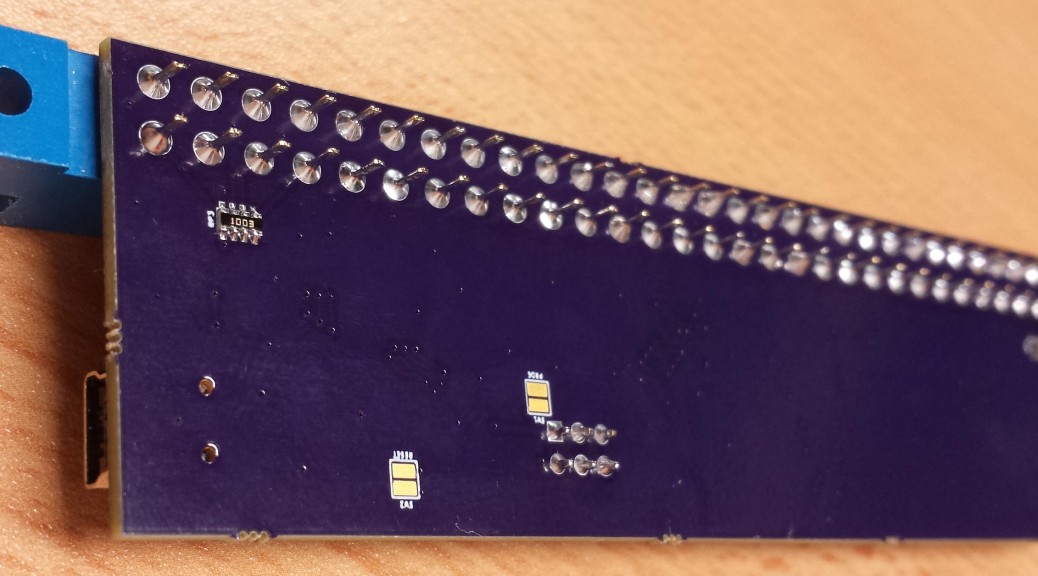

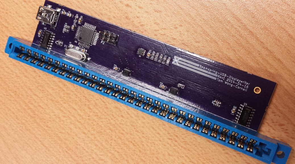

Sorry about that. He's testing them on my display writer beam spring. Phosphorglow sent me this about a week ago:
After testing the first two controllers with neither of them working
properly I took a closer look at the bill of materials and what is
labeled on the silkscreen. There are two discrepancies, a 4.7k resistor
that is supposed to be 47k, and a 1k resistor that is supposed to be
10k. After changing those two, I now have a working controller. I
haven't been able to get in touch with xwhatsit to verify/change the BOM
in the thread yet.
Once the extra components arrive (I had to use some through hole
resistors in place of the surface mounts since that's all I had on hand)
I'll finally get them mailed out.
Sorry again for the wait and thanks for your patience.

I got mine yesterday! After a decent amount of swearing (at the keyboard itself for being filthy and having some gummed switches, particularly the Space bar) everything is working and I am typing on it now. The controller went right in and almost worked the first time.
The edge connector socket on the xwhatsit board is a little wider than the edge connector on the pad card (PCB) itself. I needed to carefully align it in order to get it to work. But it seems to be working now.
I've mapped the left keys as F1-F10, shifted the arrow keys around to form an inverted T, and use the eight keys at the upper right as the Insert..PgDn cluster. It's very similar to a TKL conversion of an AT board.
At some point I'll need to throughly clean everything. The 'C' key in particular is sticky on this specific board. But it is just a delight to type on.
