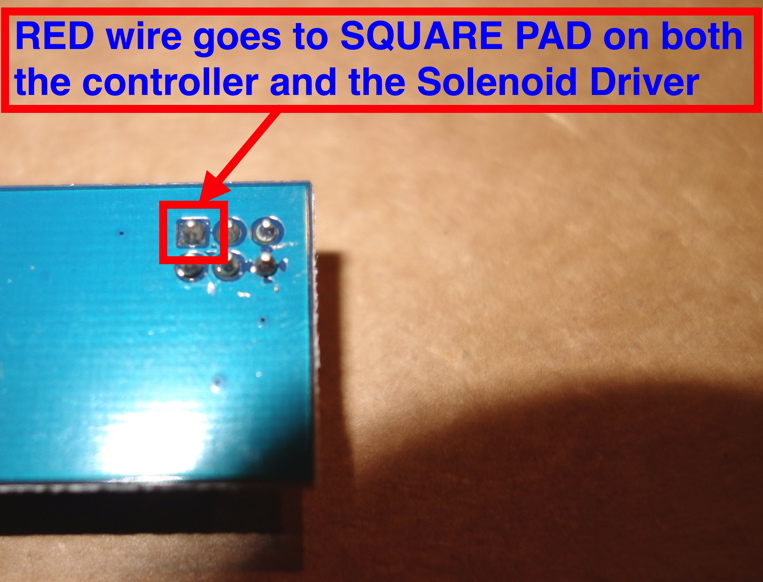

Here is the correct orientation for the solenoid driver. The Model F instructions got me thinking it was the other way and I ended up frying my solenoid driver :cry: So I'll need a new one of those. Anyone got an extra? Also, I had a spacebar and O key coming from a great guy who was giving me them for free. Well someone stole the package before he could drop it off today :(

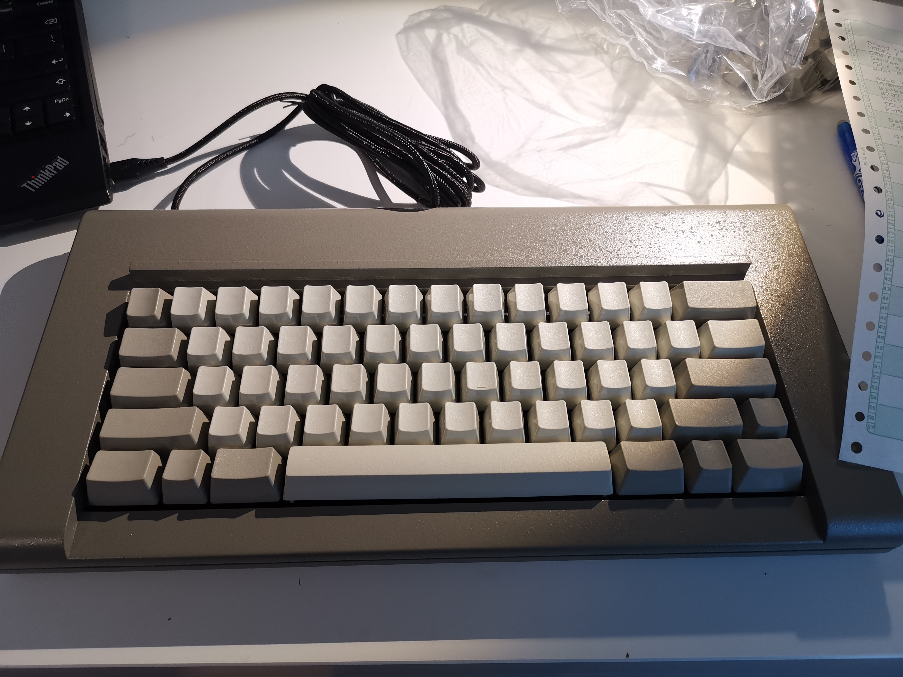

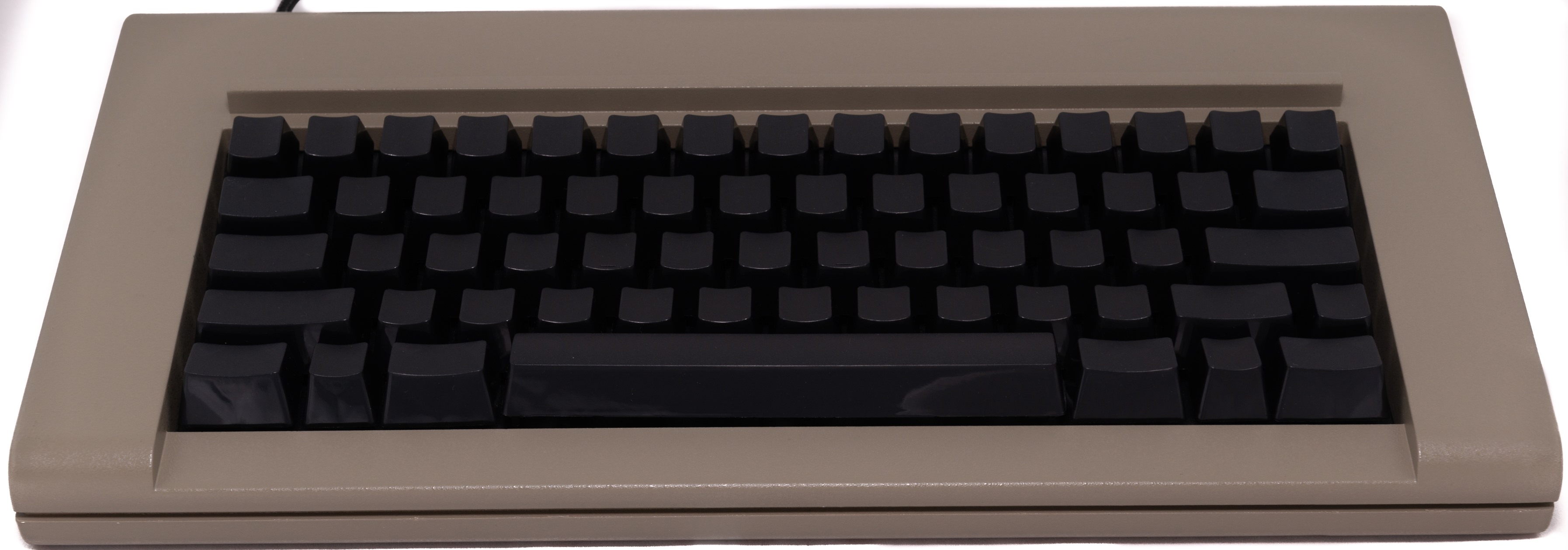

I received mine yesterday and have been typing on it since, and have some initial impressions I thought I might share.
First of all, I almost thought this day would never end. I jumped aboard on the very first day of this project and it's thus been almost four years since I purchased mine at the end of January 2016. I still remember the initial estimate; the early bird round would close "soon" and the first keyboards would be delivered before Christmas 2016. In hindsight that was a particularly optimistic estimate. :D
Onto the initial impressions. It started well, the box is nice and sturdy. While it had obviously been treated as well as any transatlantic parcel, I was in no way worried about my keyboard. Perhaps I should've been, however. Because when I opened the box and the styrofoam the keyboard sits in, I saw that the internal structure of the styrofoam was broken off, probably by the large force exerted on it by the heavy keyboard. The keyboard was fine, however, with the exception of a few keycaps that had come loose.
When I tried the keyboard out for the first time, I realised I haven't used a clicky switch in ages. Coming from having used Topre and MX Blacks exclusively for the better part of three years, the noise level was a bit of a chock. We all knew the F was a loud switch however, the important bit, for me anyway, is the keyfeel. That's the reason I fell in love with the switch shortly atfer obraining my one and only F (I hate almost every layout the F was ever produced in with a passion and the Kishsaver is unobtainium). And, I must say that Ellipse's done a very good job. While it's slightly different in feel to my Bigfoot - this being slightly crisper in feeling and slightly lighter - if someone handed me this and told me it was an OG IBM F, I would've believed them. Well done, Ellipse.
As for the keycaps, I went with black blanks and they are very black and very blank. Quality wise, I can't fault them. They've a nice texture to them, very reminiscent of IBM's. Having used Topre and Cherry/GMK for a bit, the IBM-profile takes a little getting used to, but that's hardly the keycaps' fault.
Now there are a couple of things I don't particularly fancy about the keyboard. The spacebar stabiliser is not pleasant. I reseated the spacebar and it made it slightly better, at least consistent across the bar, initially it would bind ever so slightly when pressed on the far right, that's fortunately gone now. Left is the horrible noise it makes. It squeeks and rattles. While I've heard stabilisers rattle in the past, the squeek is new to me. Quite audible and distracting. I think I should be able to take care of it, however, using some heatshrink and lube. The other stabilised keys aren't great either. They're slightly bindy when pressed on the switch-side of the keycap. I think they're just asking for some breaking in and a little dry lube.
The colour of my off-white unit wasn't quite what I was expecting either. I would've thought it would be the standard IBM off-white/beige, but it is quite a bit more beige than that. I love the texture, however, and the paintjob on my unit is difficult to fault. There is one visual imperfection, however, but that has nothing to do with the paint per se. On the right hand side of the pen rail on my F62 there is what looks like slight level change in the case, see below, seemingly caused by the tooling used for the cast. I don't know if this imperfection is visible on all Classic F62, or if many different moulds were in use during the production.
All in all, this turned out in some ways better than I had hoped, while it's flawed in some others. Fortunately, I think I can mitigate most of the issues I have with my keyboard with some TLC. To me, the keyfeel is the most important part of the equation and that's very nice indeed.
Not very many photos, Sweden is a dark place this time of year.

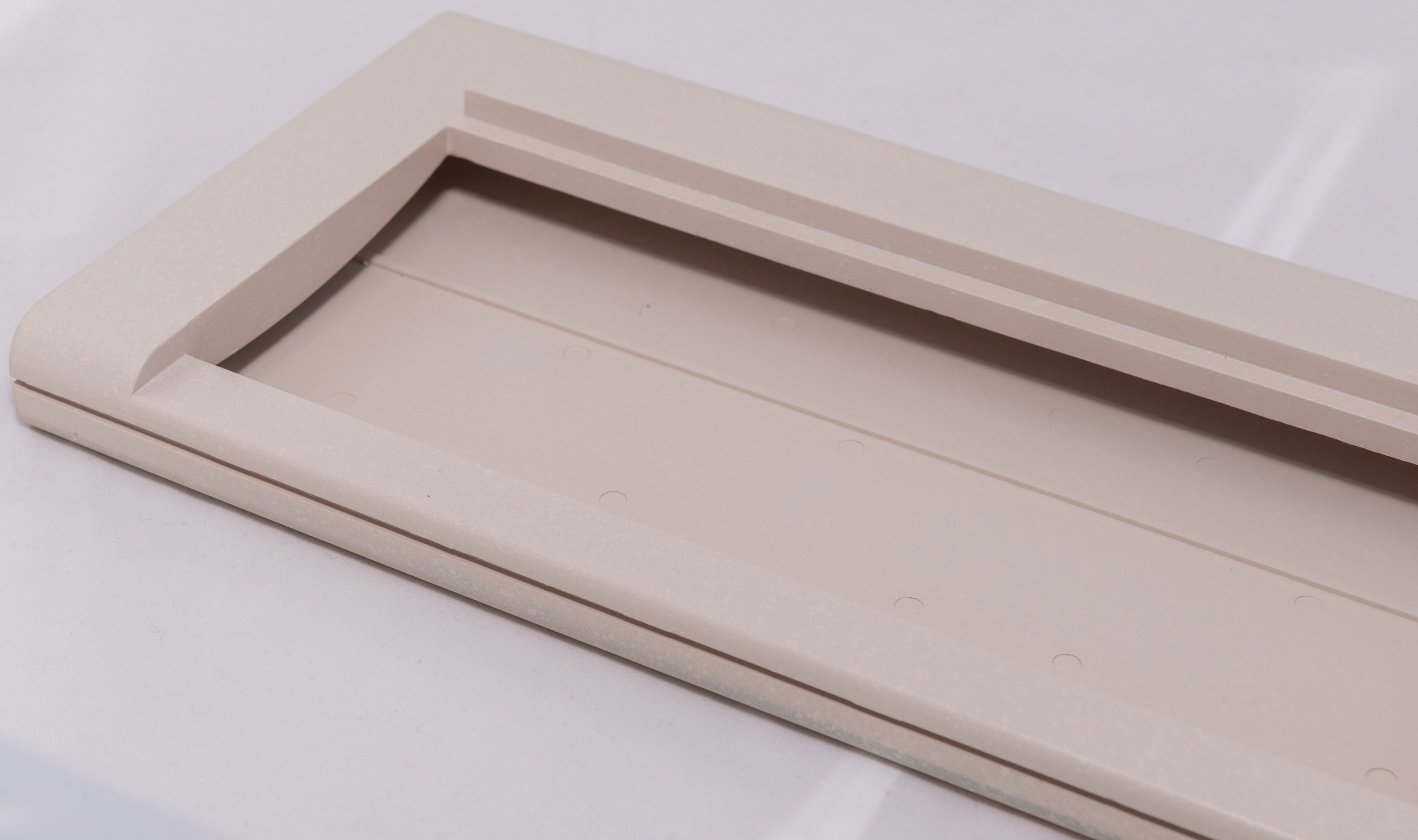

The powdercoating on the cases is not the same as modern-day powdercoating - it is 1980s style powdercoating, warts and all. It took months to get the powdercoating to resemble the 1980s blotchy style. The original cases will not have a perfect, blemish-free finish. The prototypes back in 2015 were finished in a tough, modern powdercoating but it did not look like the original finish, so I decided back then to reject it and aim for as close as possible to the original, less durable finish. Like the originals, the paint is a thin, textured, matte finish that does chip and flake.
If you prefer a tougher coat maybe some kind of clear coat or re-painting could be done. Please do post the results if anyone does this.

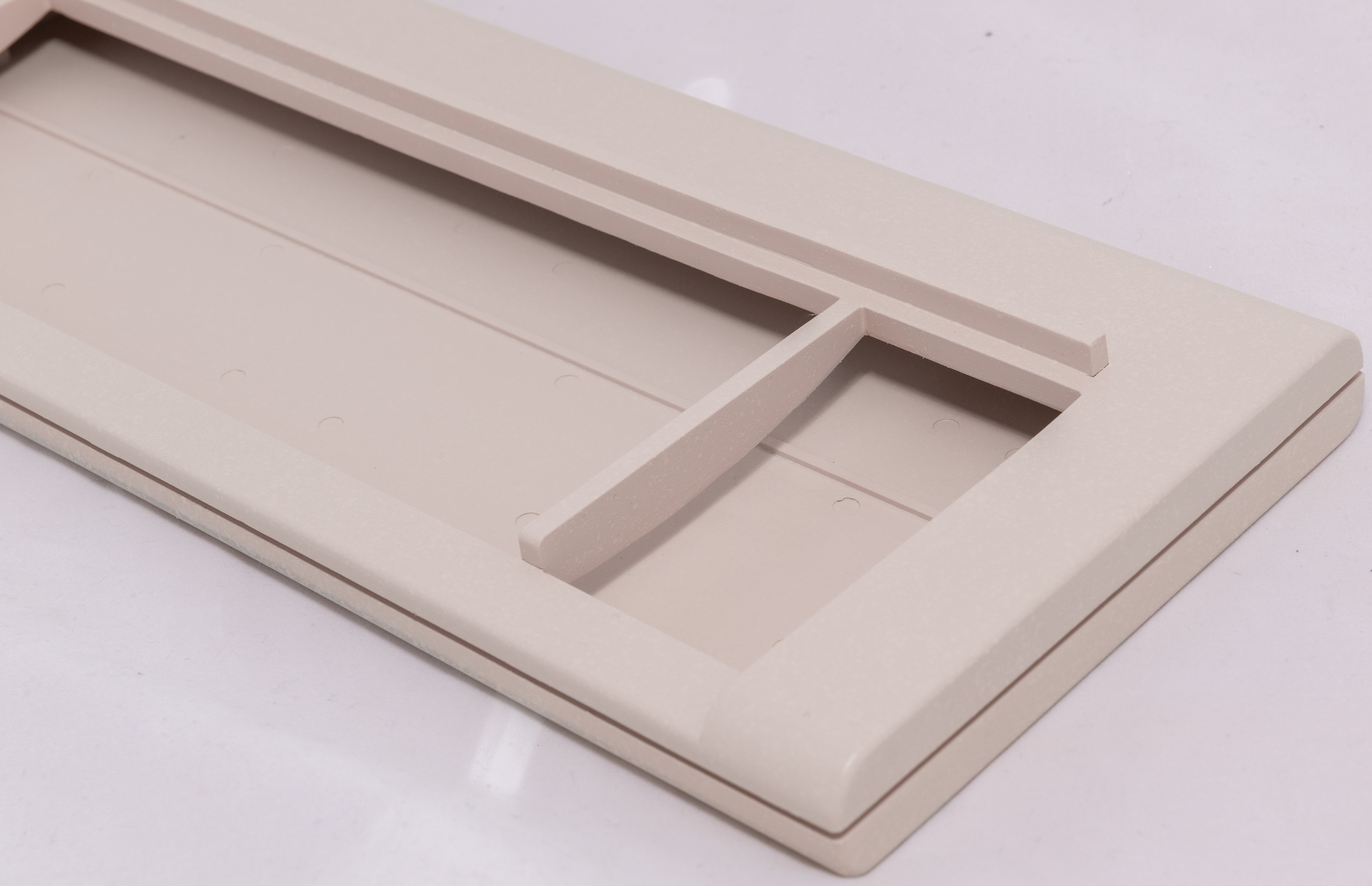

Khers-regarding the space bar - there is an art to getting it to sound good - I am slowly getting better as more keyboards are QC'd (yours was one of the earliest). Regarding squeaking and rattling, the solution is to remove and re-seat, or maybe replace the spring with another one and slightly adjust the bend of the space bar so that it is closer to the back of the metal space bar tabs. I hope to make a video on the specifics of space bar modding for those who are particular about the sound (as I am). Since your keyboard, I have gotten a little better at detecting and fixing space bar issues.
The circled line is present on all the cases; it has something to do with the mold. I pointed this out to them a few years ago. The factory was able to minimize it but not remove it entirely.
Confirmed that for those not ordering installed keys, the voltage threshold is set too high so as not to activate keys if you accidentally plug in the keyboard before installing all keys (the factory default layouts are pre-loaded for all keyboards). It's easy to adjust in the xwhatsit GUI.

If you had done that, I would not have destroyed my solenoid driver PCB, as how it's connected on regular xwhatsits for original Model F conversions leads you to believe it should be plugged in the opposite way it needs to be on our boards. Instead, I was a guinea pig for future owners who want to utilize the header and literally got burned as the driver PCB got so hot so quickly it would have burned me if I touched it.
It would be great if you have a solenoid driver pcb to replace my dead one as an act of goodwill. The keyboard's user manual does not talk about the header function at all or the correct orientation for it

Mattr, my apologies that your solenoid driver was improperly installed. Did the seller provide instructions as to the proper connection? If I recall correctly, the square pad indicates VCC and that wire should go to the VCC square pin on the solenoid driver itself.
Not sure if you bought it from orihalcon directly but when I bought two for my beamsprings, orihalcon gave me detailed instructions to ensure proper connection and warned me that not checking the VCC pin before plugging it in would destroy the driver.
Maybe you have some recourse from the seller of your solenoid driver if these instructions were not provided.
And if you still need a space bar please message me (I have extras!).
Also I am around on the forums a lot and if anyone has any questions feel free to post or ask me before risking anything. One buyer was unfamiliar with opening up the Model F and I recently made and posted a video on how to do so. Another had trouble with a non-clicking key and referred to another video I uploaded to help with proper key installation. I hope to post more videos going forward.
Below is a photo from 2015 that orihalcon sends to the solenoid driver buyers - I hope he does not mind me reposting it.
Solenoid Driver Wiring.jpg (160.33 KiB) Viewed 11101 times

I did buy it from orihalcon 2 years ago when I used it with an Alps project. I do not remember the square pad. Already PM'd him about buying another but he has not gotten back to me yet.
This is the image I used, had it correct on the driver PCB side but the controller side was the flipped side.
Since the 3 filled pins are shown on top with the controller on the top side, and because the controller in my F77 was folded over showing the bottom side, I thought this was the correct orientation. You can see where my thought process was.
You cant use that assumption since the F62/F77 ship with a redesigned controller and the pin-outs need to be properly determined before plugging anything in...
