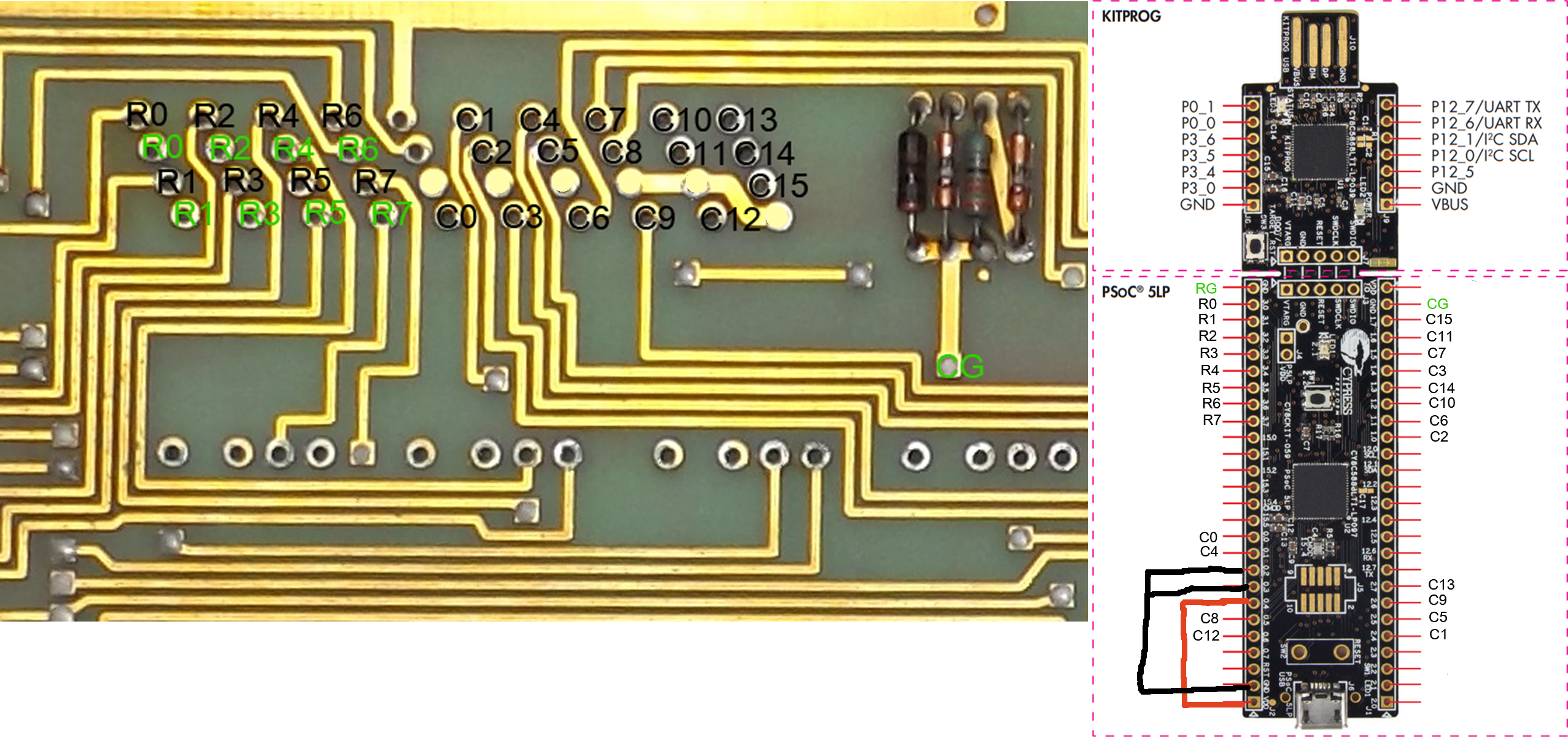

do the 3 capacitors need to be desoldered if having only 8 rows for mag valve? I am getting an error when connecting the dev board after soldering on the rows/columnns as well as the references so is that why the capacitors need to be removed?
DMA
16 Mar 2020, 00:02
If the pins are not used - you're free to leave the caps connected. The reason - I don't want them to be there, life is hard enough.
Seriously tho - they significantly alter the signal. I wasn't curious enough to look how - but the possibilities to fuck up are endless there, including inadvertently creating a resonant circuit which will fry the GPIO if not whole chip with a voltage spike.
Anakey
16 Mar 2020, 23:09
ok I am getting this error from the PSoC when trying to aquire ports
There was an error running port acquire: PSoC device is not acquired! Check connection of the chip to the programmer
This same error i get with 2 controllers when they are soldered with rows/colums. The 1st board after desoldered would program fine, as would the 2nd before soldering to the keyboard.
Below is the layout of connections on keyboard and also pins on the contrioller, please could someone tell me where i am going wrong, thanks.
RG = Row Ground each row is connected together CG = Column Ground

Anakey wrote: 16 Mar 2020, 23:09 ok I am getting this error from the PSoC when trying to aquire ports
Wiring looks good, I believe. Are you by any chance using a USB hub? I had trouble with USB hub (even a powered one) when trying to connect/write to the board. Only plugging it into a dedicated port on my PC did the trick.
Also did you try aquire port at all before you did your wiring? Just to make sure it wasn't faulty. If not, I know it doesn't help now but that's what I first started checking the second time I did a commonsense project.

I should have checked better. Didn't realize you had the full thing pinned out.
I know that 3.2 is skipped. Try disconnecting that maybe? I'm not sure what the pin is used for but it's skipped in the documentation. https://github.com/dmaone/CommonSense

It's hard to trace the PCB without colored pens - but it looks like you're driving by the long trace (the one that gets from entry point to the far end of the row.
I did it the other way - primarily because that long trace was shared by 2 (sometimes more) rows and they are shorted together at the driver. Might be important - but then again, might be not.
I guess you have access to a scope. Go here, look at *_clk_pulse_*.png and compare with your favorite row and column at PCB edge. I would recommend starting with one that doesn't go via the daughterboard.

Hi DMA, this was all hand desoldered using a ss02 engineer though i did get a desoldering gun for christmas so if i ever need to do something as complex in the future it would be a lot easier.
DMA wrote: 18 Mar 2020, 04:08 It's hard to trace the PCB without colored pens - but it looks like you're driving by the long trace (the one that gets from entry point to the far end of the row.
If you don't - well, good luck, I guess.
yes you are correct the rows are starting all the way to the far right of the pcb. not sure about what to drive, as i have not got to programming with flight controller yet, still trying to work this out given its frirst time i have used capsense, as i am more used to programming contact switch boards using a teensy and QMK.
DMA wrote: 18 Mar 2020, 04:08 PS: Oh, and another thing. Columns usually have diodes between column traces and common point. Are you sure the CG is directly connected to the far end of the column switch chain?
If you have a look at the back picture i posed above you can see the wide trace to the right of the daughterboard, this is where all the columns are joined to and if you follow it up you can just see if you look closely where the solder point is just above where the kitprog part of the controller is. If you then look at the front of the pcb, that solder point was a through hole connection between the back and front of the board, with the only thing after it being the 4 diodes/resistors as can be seen in my earlier pic a few posts up. I guess as this pcb is very old in terms of mag valve, that is why the layoout and setup with the logic being on a seperate controller board looks so different compared to the more recent versions of the switch.

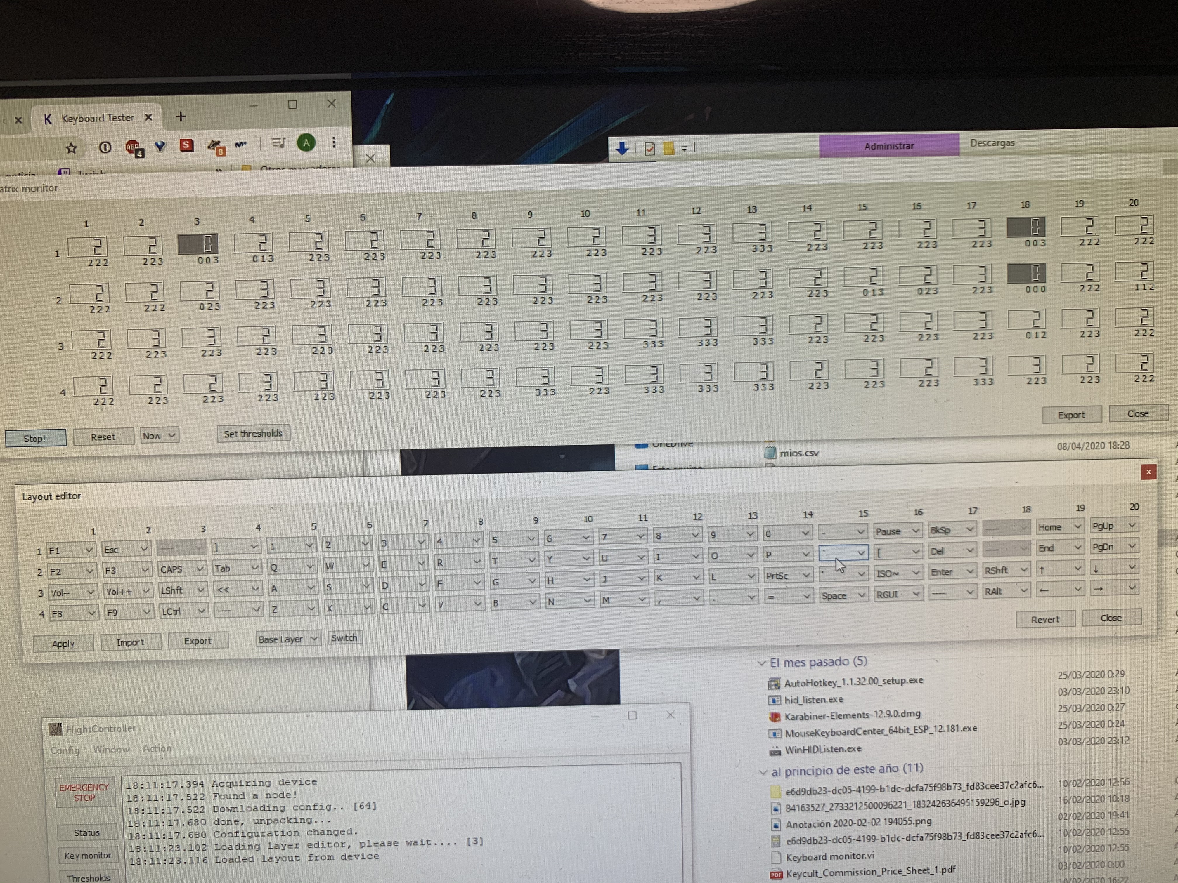

I am having a problem, flight controller does not see the controller board so can't connect to it connecting it from the micro usb side
DMA
20 Mar 2020, 03:57
Anakey wrote: 19 Mar 2020, 22:07 I am having a problem, flight controller does not see the controller board so can't connect to it connecting it from the micro usb side
Platform, screenshot of main window?
Anakey
20 Mar 2020, 11:45
Windows 64
DMA
20 Mar 2020, 14:50
OK. Looks like it's in bootloader for some reason. update fw - navigate to project dir/Compiled, find .cyacd there. It should program the device and after that it will likely boot up.
Do you by chance have the button on the kit pressed by something?
Anakey
20 Mar 2020, 23:06
Thank you for that, managed to flash the board and get it into safe mode :) now i have the seemingly impossible task to get the keys registering which is going to take a few hours to do. i may need to look at replacing the magnet wire i have used possibly with shielded wire to reduce interferance

try defaults from the doc. thresholds 10 to 15, increase discharge delay to 10-15 (shorter one)

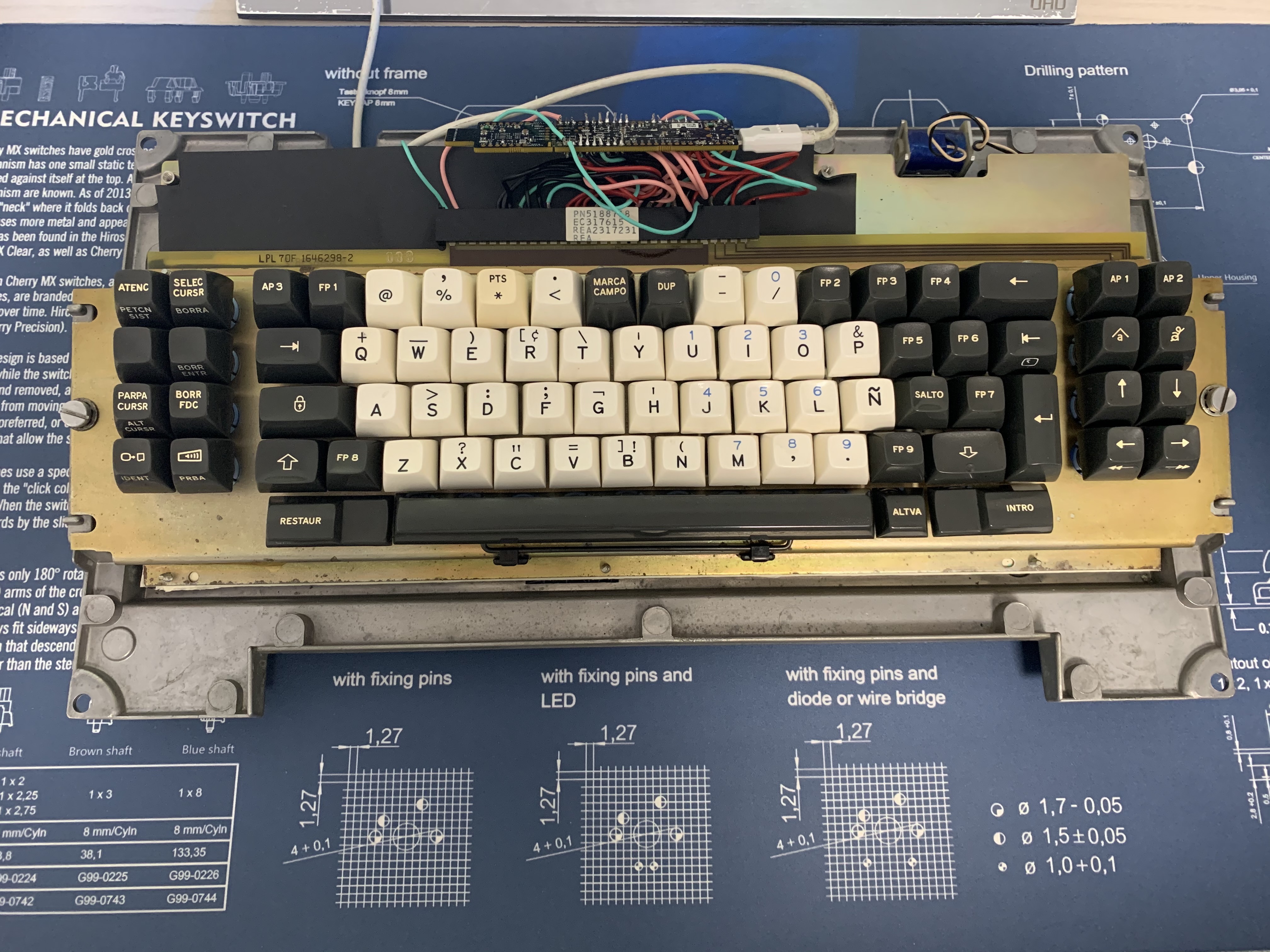

I succeeded! Did a messy soldering job but it worked just fine.
Currently typyng on my Beamspring, can't be happier about this. I ran over some issues with some keys actuating multiple times, in particular the "M" key. Without even full pressing the key it triggered 20 M's, atm everything works perfect.
My 3276 data entry has a 20x4 matrix, I want to share the thresholds because i think they are really low numbers. All of them between 1 and 3.
Thanks to everyone involved in this project!! :D

shine wrote: 09 Apr 2020, 20:11 I want to share the thresholds because i think they are really low numbers. All of them between 1 and 3.
Hardware -> ADC resolution, bit -> 12
That should pull you into 40-ish-at-rest territory, so you can set thresholds to like 15 and forget about key spam.
Wiring is fine but kek try to get xwhatsit working with that :D
