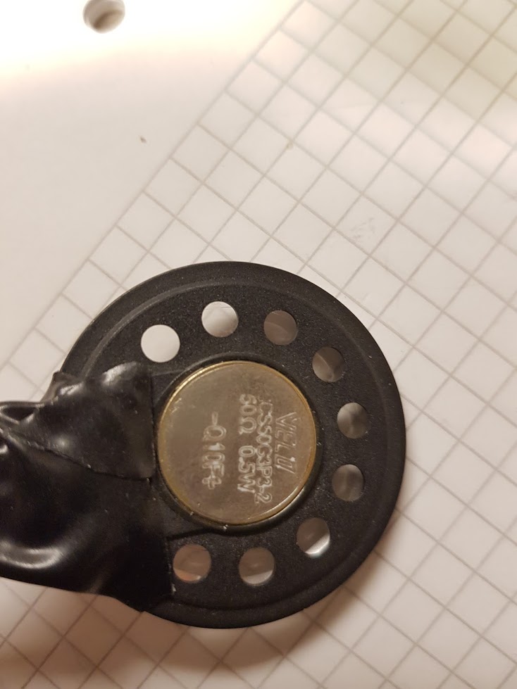

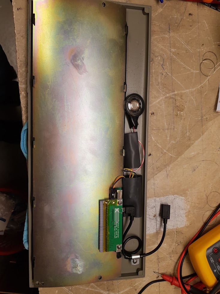

So I found a bigger speaker in my pile of electronics, think is intended usage was a parking sensor beeper.
It gives a better output and a more solid sound without the need of amplifying anything. Trying to fine tune the frequency to come out closer to the original IBM buzzer - so any help here is appreciated
Edit;
Here is the buzzer at 550Hz too:
Edit;

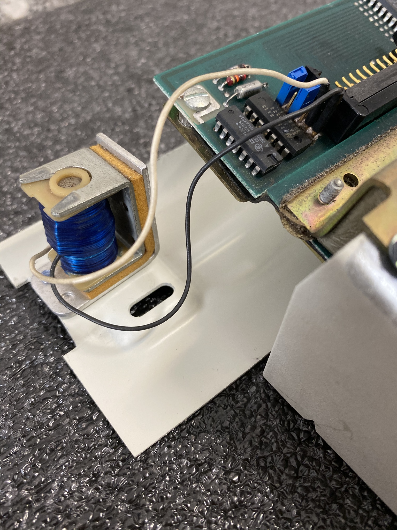

I plan on doing something like this when I put a solenoid in one of my builds.tentator wrote: 16 Apr 2020, 22:44 how is the solenoid supposed to be mounted inside? I remember somebody else here also posted he managed to put a solenoid in the case.. but still wondering how...
I think I'll also experiment with different sound dampening techniques so that I get a nice deep thock rather than high pitched ticks.

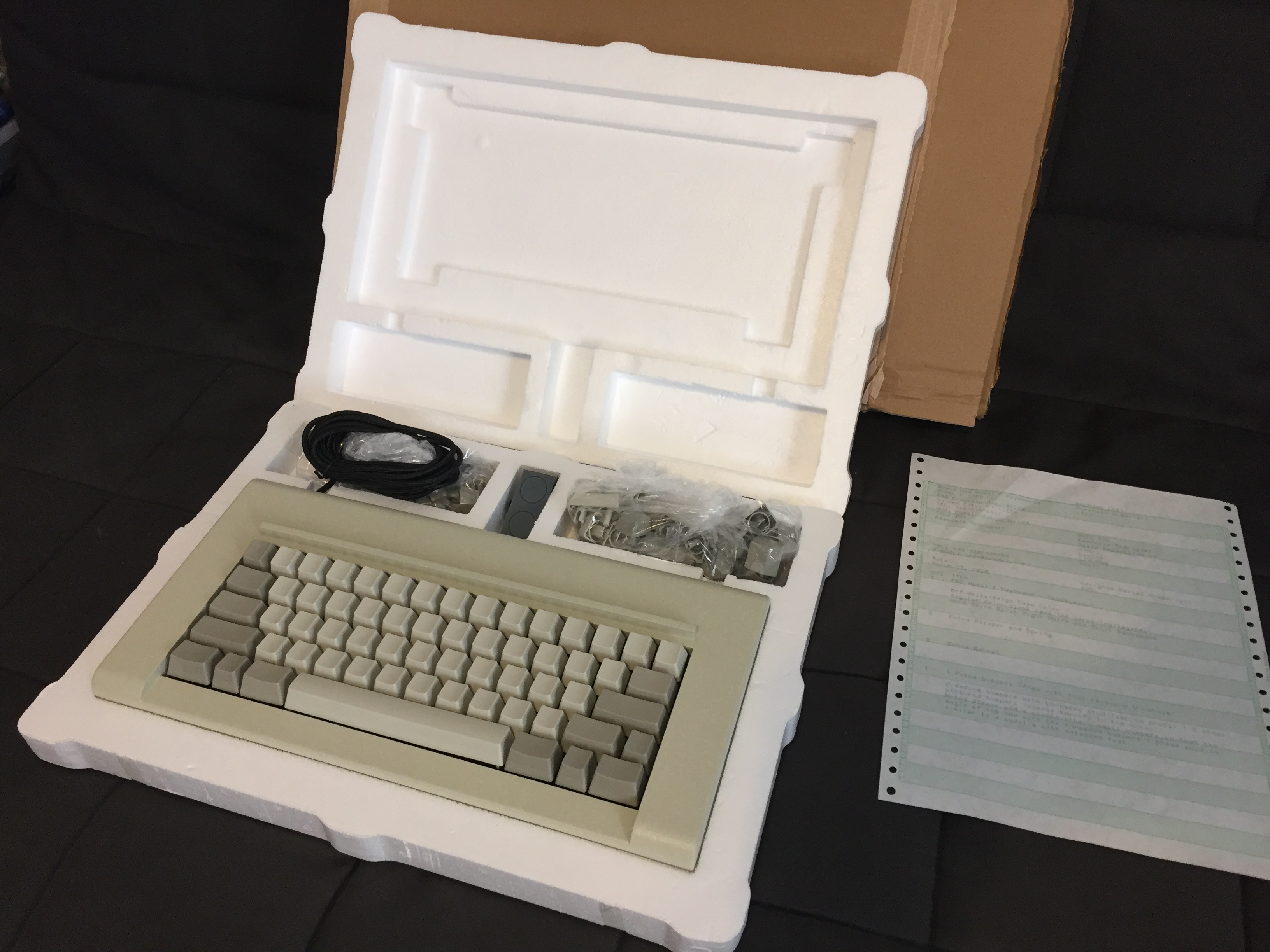

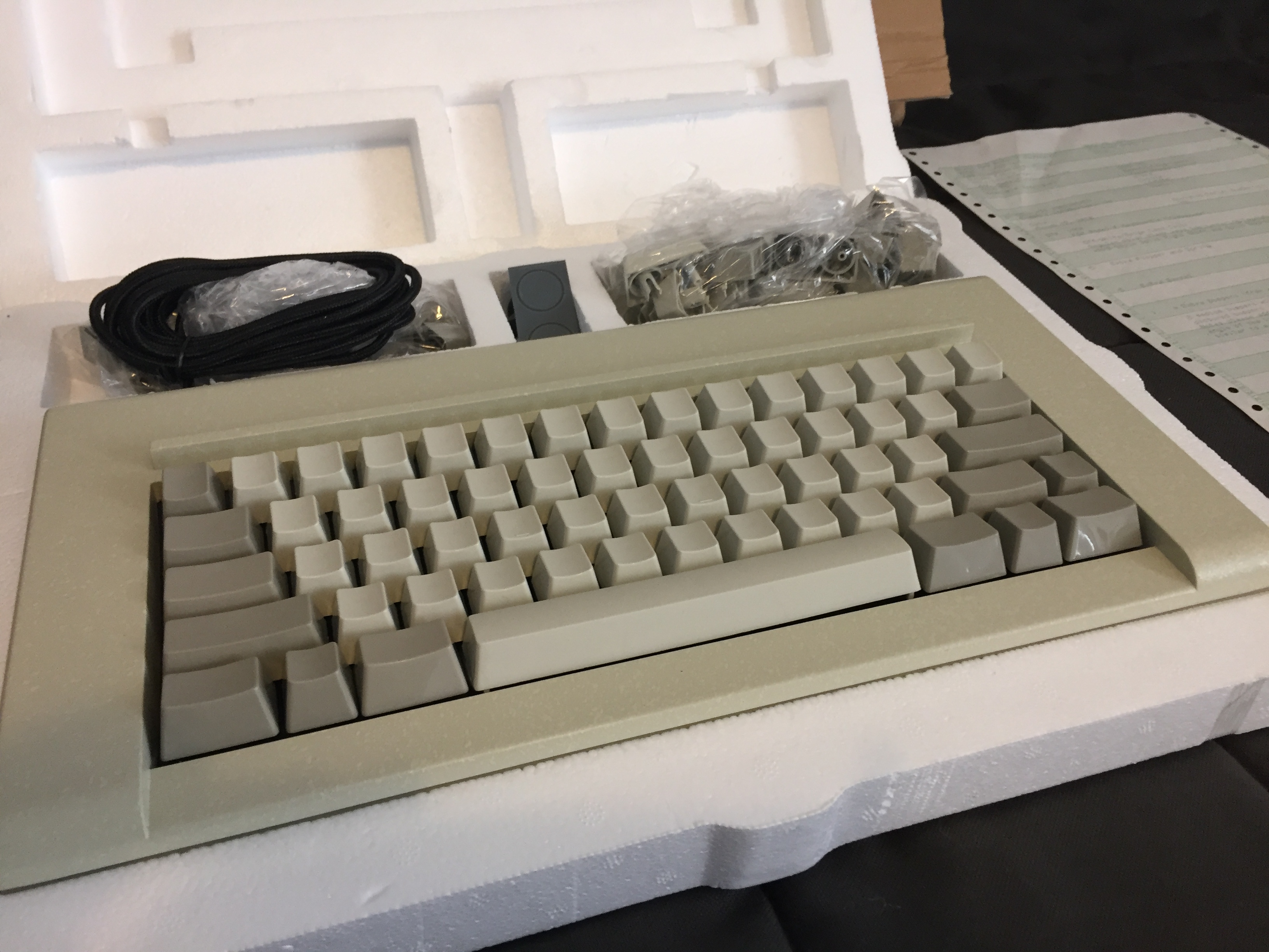

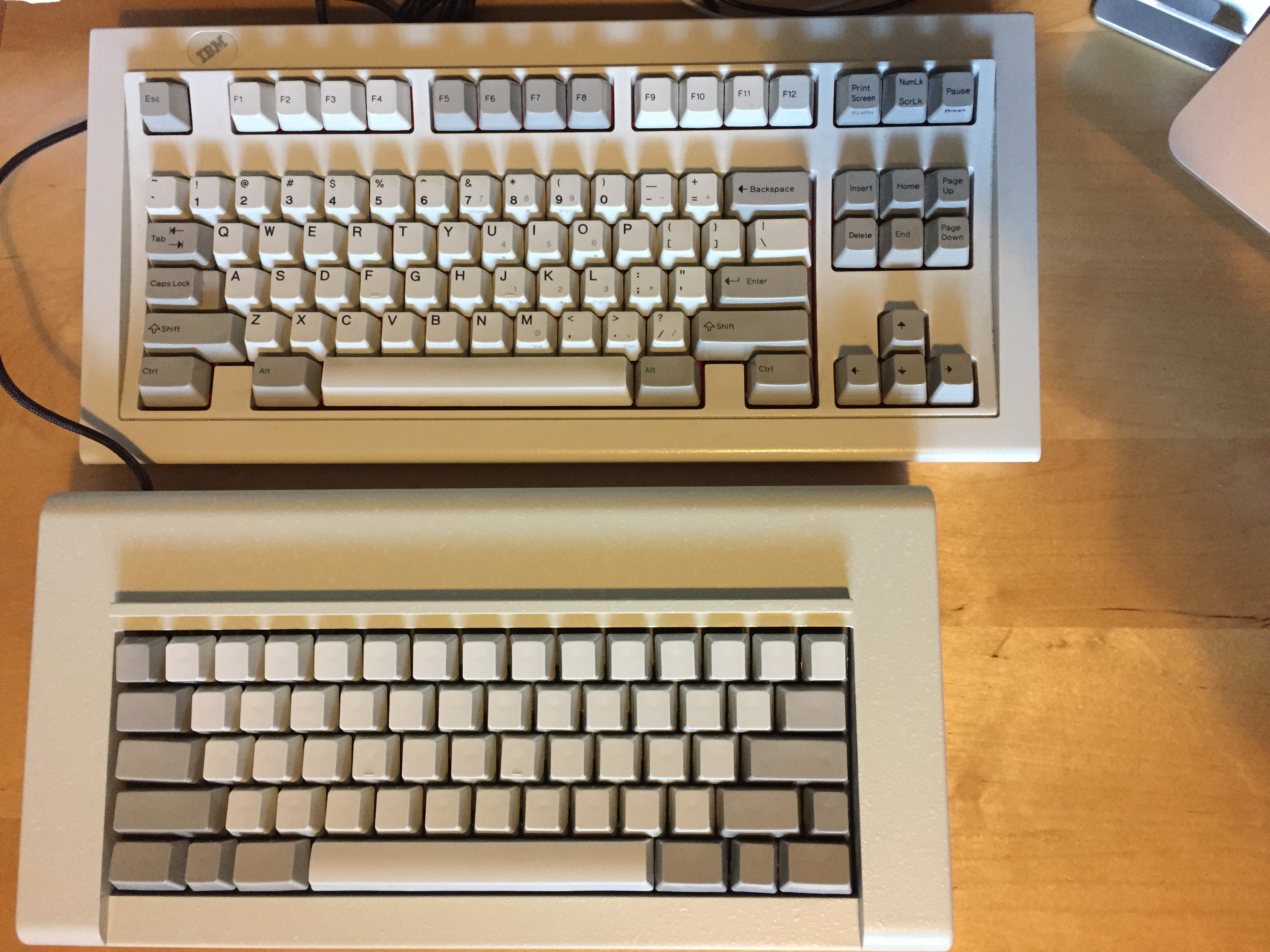

I've received today the F62 keyboard I ordered in early 2016... I can say it was totally worth the wait!
The package is superb! Even though the keyboard is not double boxed and the box was a bit beaten on the corners, inside everything was perfect. The keyboard survived the transoceanic trip perfectly - it took 2 weeks from the U.S. to Italy, including 1 week stuck in customs.
The keyboard itself weights A TON, really I couldn't believe how heavy it was when I picked it up for the first time. I was a bit worried about some of the reviews that mentioned springs out of place, keys not registering correctly, having to tweak the firmware values, etc... In my case, I did not have to touch anything: I just plugged the USB cable in my Macbook and everything worked perfectly.
I am also struggling to find the "cosmetic imperfections" I have seen in some photos, I swear I can't find a single defect in this unit. I also swear I've not been paid by Ellipse for these words, it's just I'm so excited and impressed by the top notch quality of this keyboard.
The key feel is superb. My daily keyboard is the Model M SSK and I didn't actually use a Model F so far. I couldn't understand how the F could be better as other people said, now I do: it's so much smoother and lighter it's a pleasure to use - I guess this is going to replace the SSK on my desk from now on.
At the moment I'm using the stock blank keycaps that were installed by Ellipse. This has the HHKB layout which I'm already used to - I also have (and love) an HHKB so it took just a few minutes to get back to work at full speed. I'll see in the next days how it performs with the Model M keycaps.
Here a couple of photos, please excuse the bad light and camera, but that's what I have. And again, thanks a lot Ellipse, can't believe you reached these astonishing results!

Cool video giving ideas to dampen the solenoid for tuning the sound!ddrfraser1 wrote: 24 Apr 2020, 16:11 Not sure about the voltage (honestly I have no idea how these things work) but I found this vid and bought the exact solenoid for a different project simply because I was looking for one with a good sound, not too high pitched.link to buy:Spoiler:
https://www.amazon.com/gp/product/B00LB ... UTF8&psc=1
Be aware that the solenoid in the video is a 24V one and the one you linked is rated for 12V. So depending on your application you should look over the specs.
It might fit inside a keyboard, but you should not try to run it off USB voltage. Reading the comments, its about 7 ohms and it will have a current draw of 1.7A at 12V. The USB standard is rated at 5V 500mA, so even you boost your voltage to 12v you will be running out of juice very quickly tripping the USB fuse or/and damage the port or xwhatsit controller.
However if you run a separate power supply with the appropriate specs you should be fine.
For a keyboard you should look at solenoids having a shorter throw. 10mm could result in a sluggish response considering the time spent for a full movement. The ones IBM use moves just a few mm.

Current wise, 150mA at 4.2V you should be fine on USB power. But I think that one is intended for controlling air flow, passing air through the valve. So it wont actually make any noise inside a keyboard.gravesdesk wrote: 24 Apr 2020, 22:32what about this one?Spoiler:
https://www.aliexpress.com/item/4000843 ... hweb201603_
The push/pull type is the one you want, as it have a pin that moves back an forth.
Just a heads up for anyone interested in testing out solenoids.
Before you hook up a solenoid to your new and shiny keyboard, regardless of the specs of the solenoid. You need to have some kind of a driver board to trigger the low current signal from the xwhatsit controller. Hooking it directly up to the controller will most likely fry the keyboard, leaving you with a nice looking brick.
