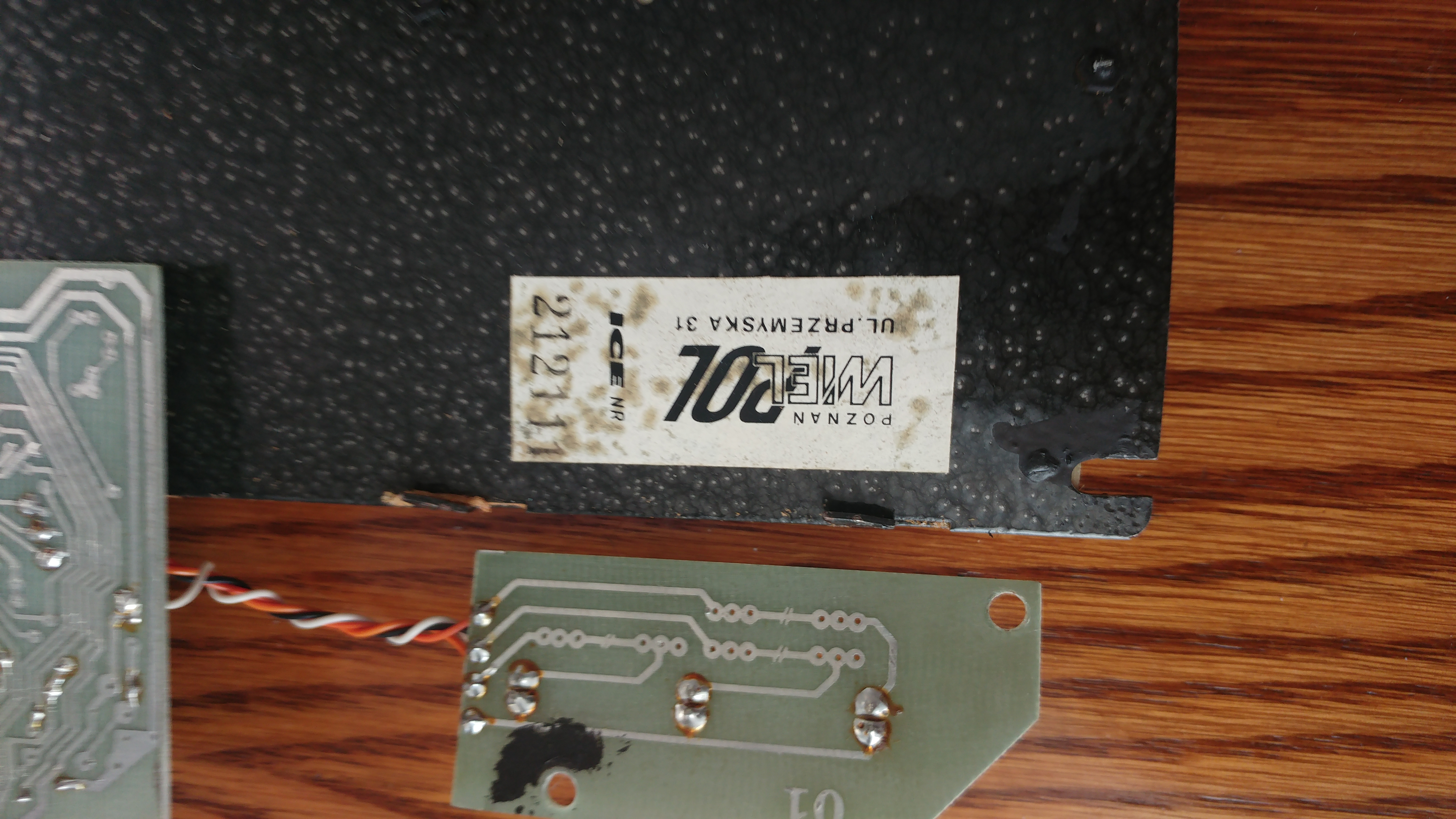

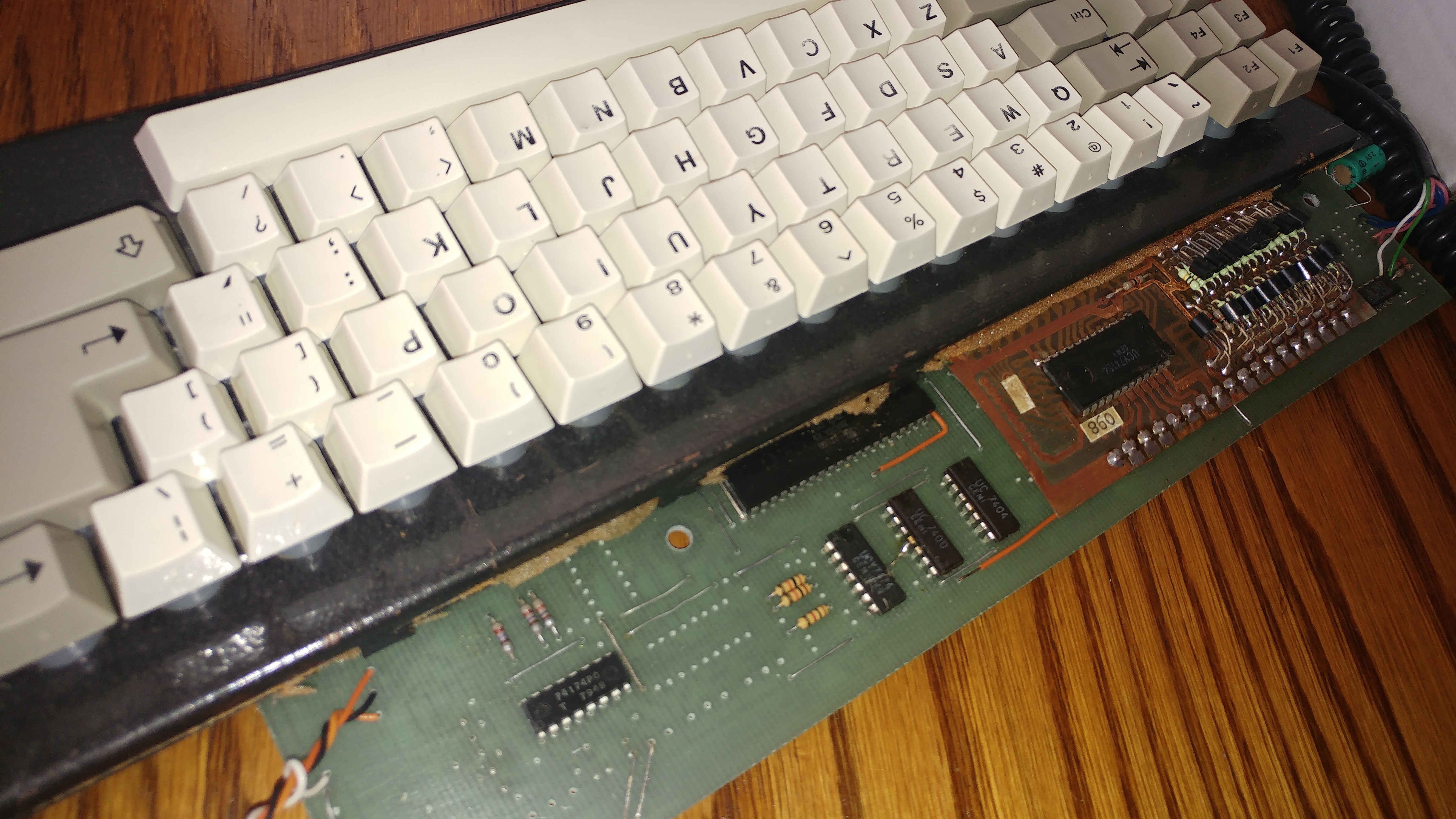

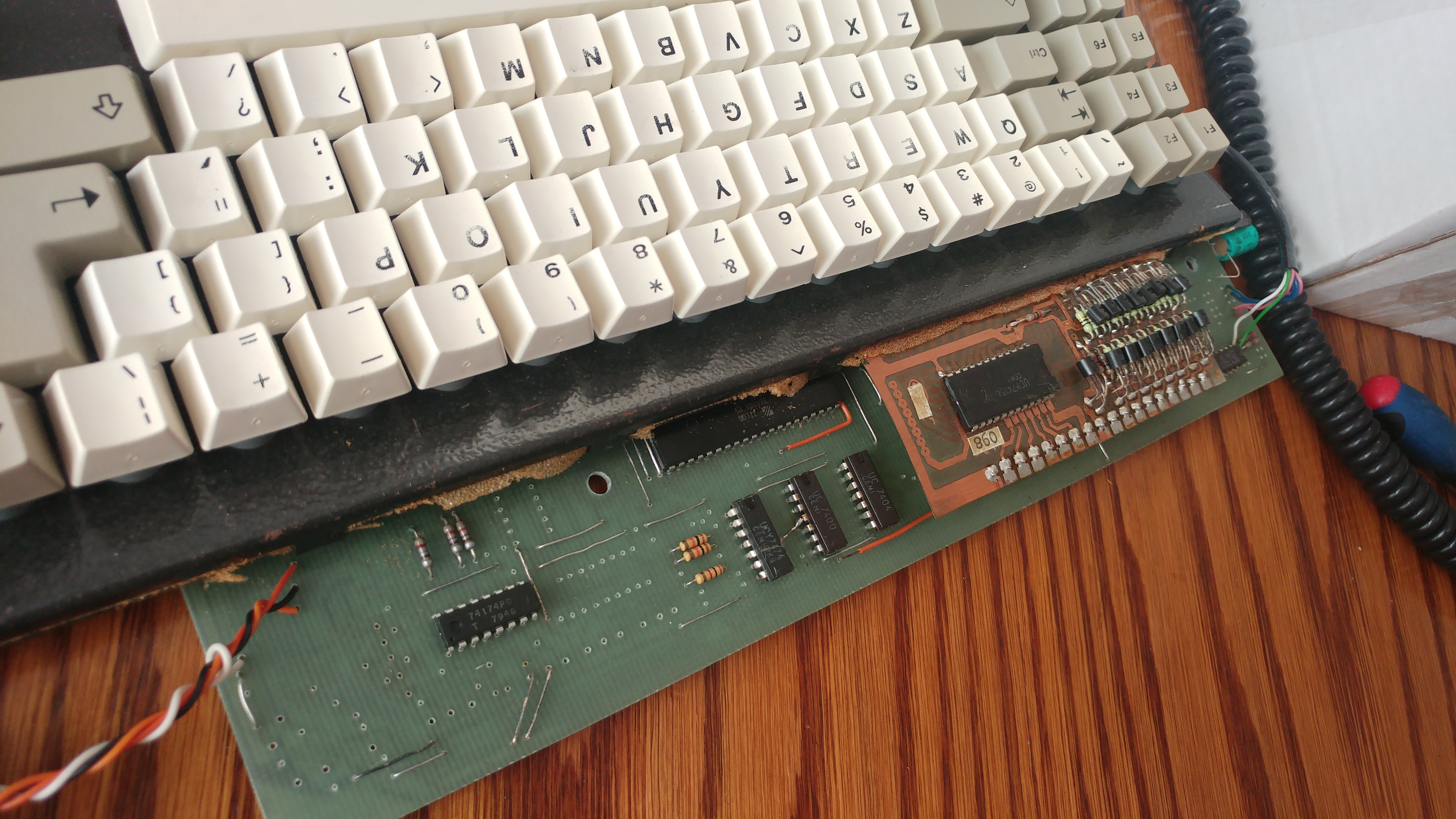

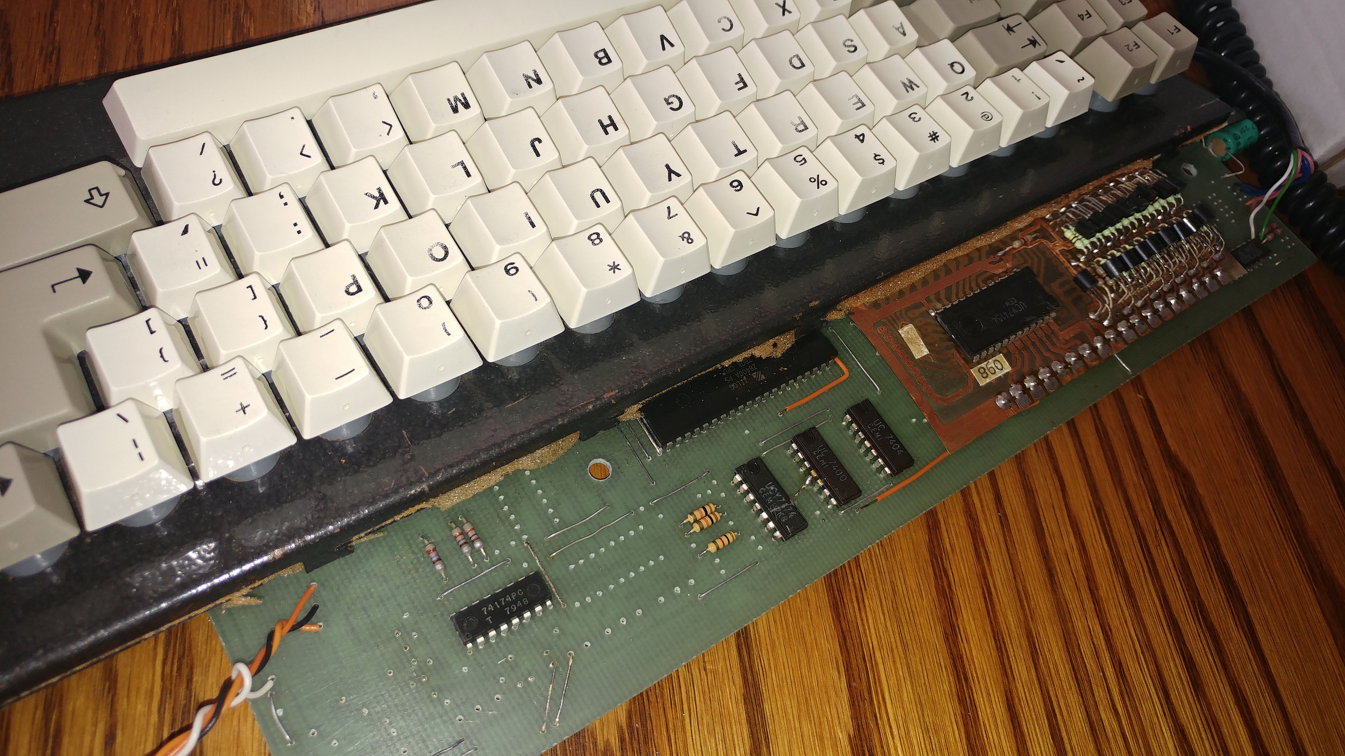

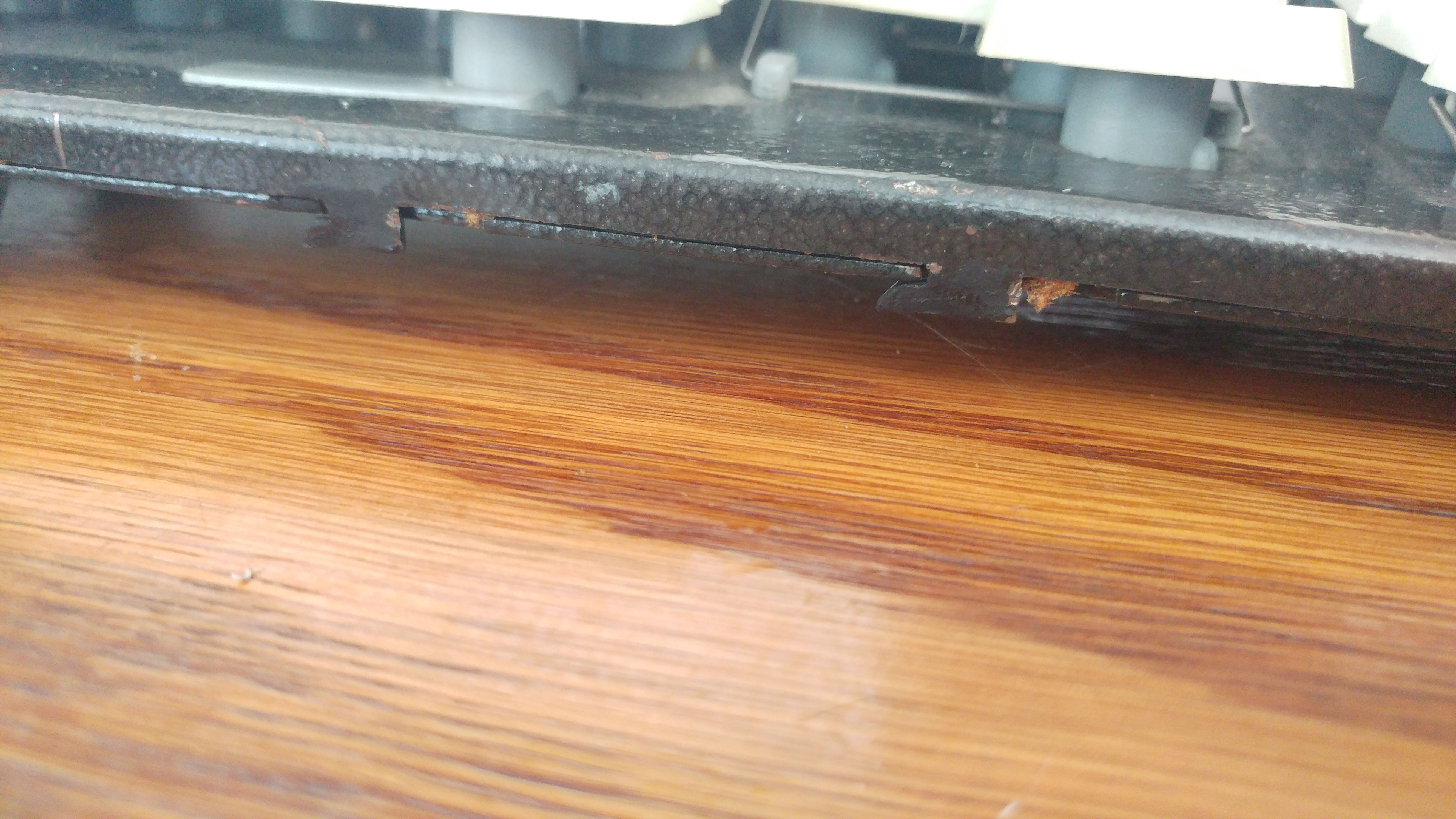

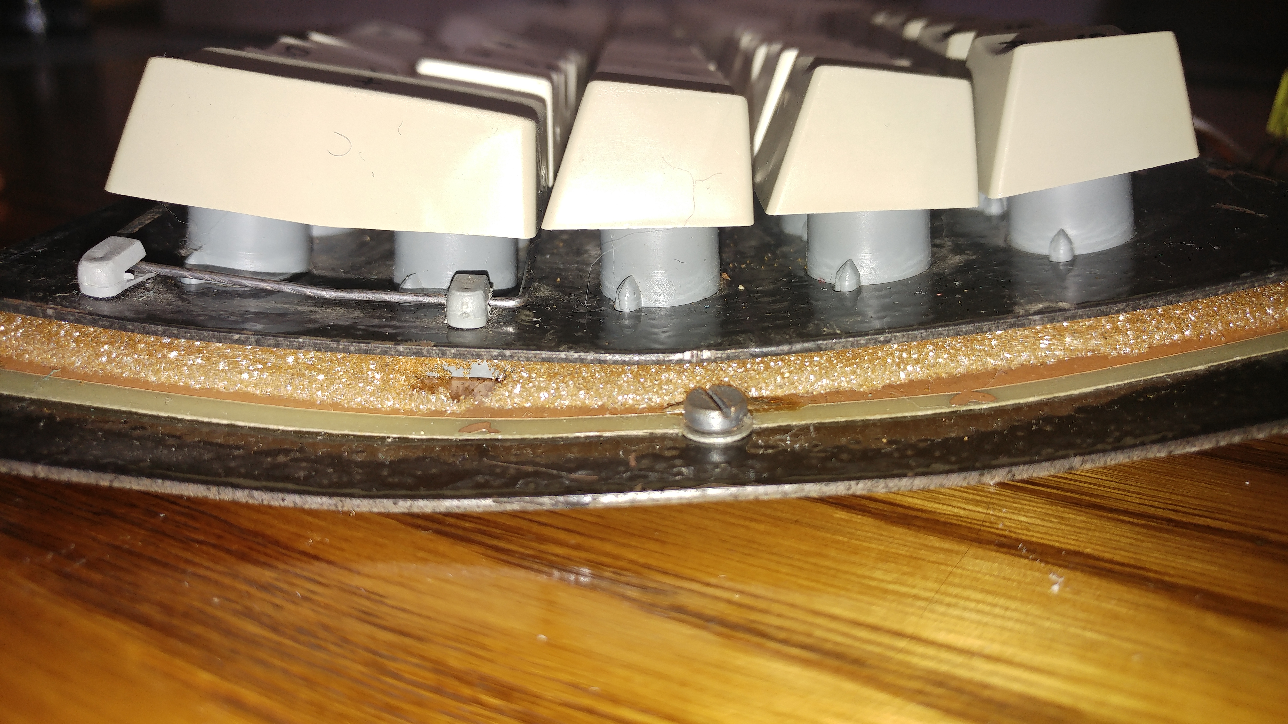

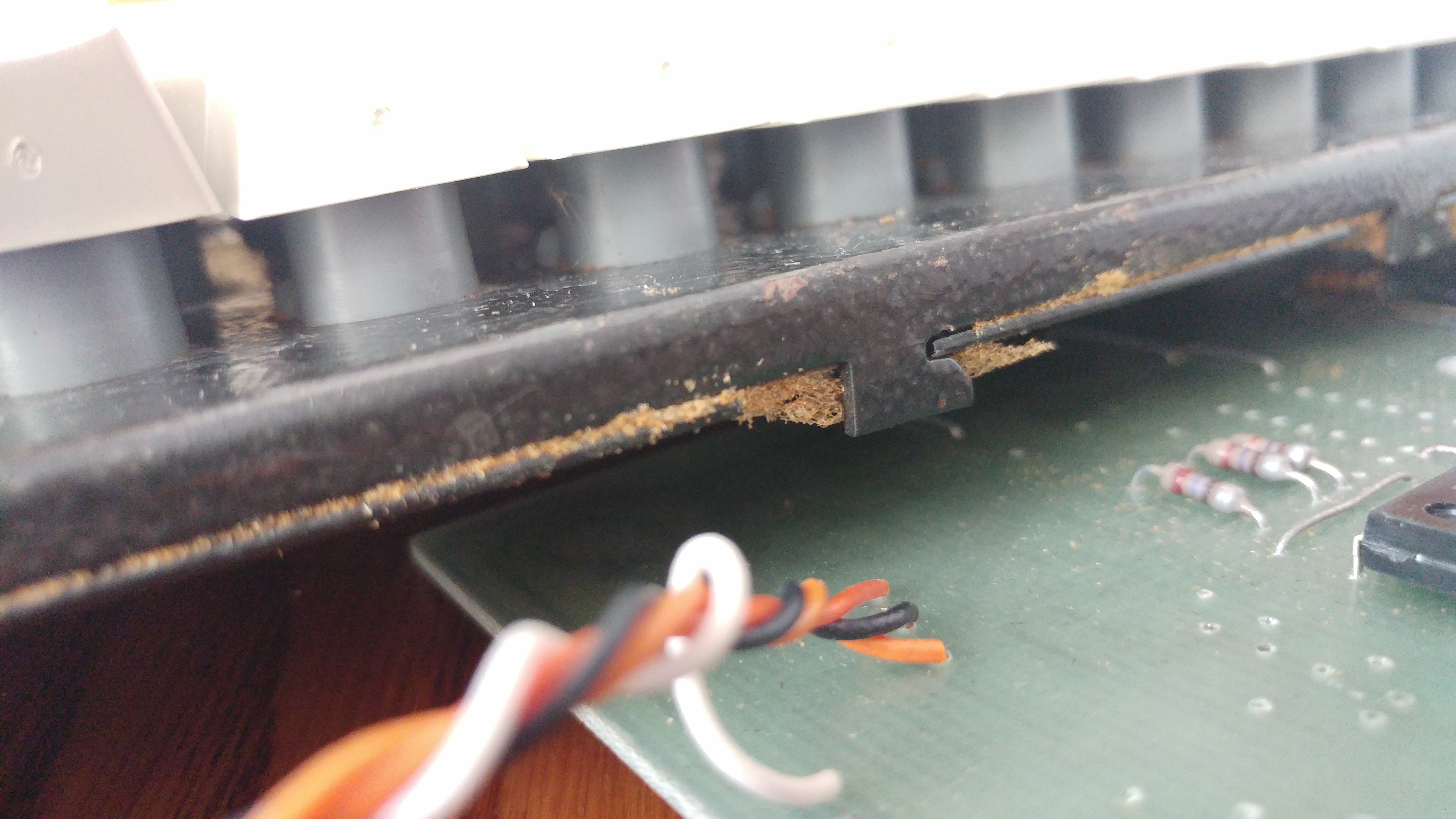

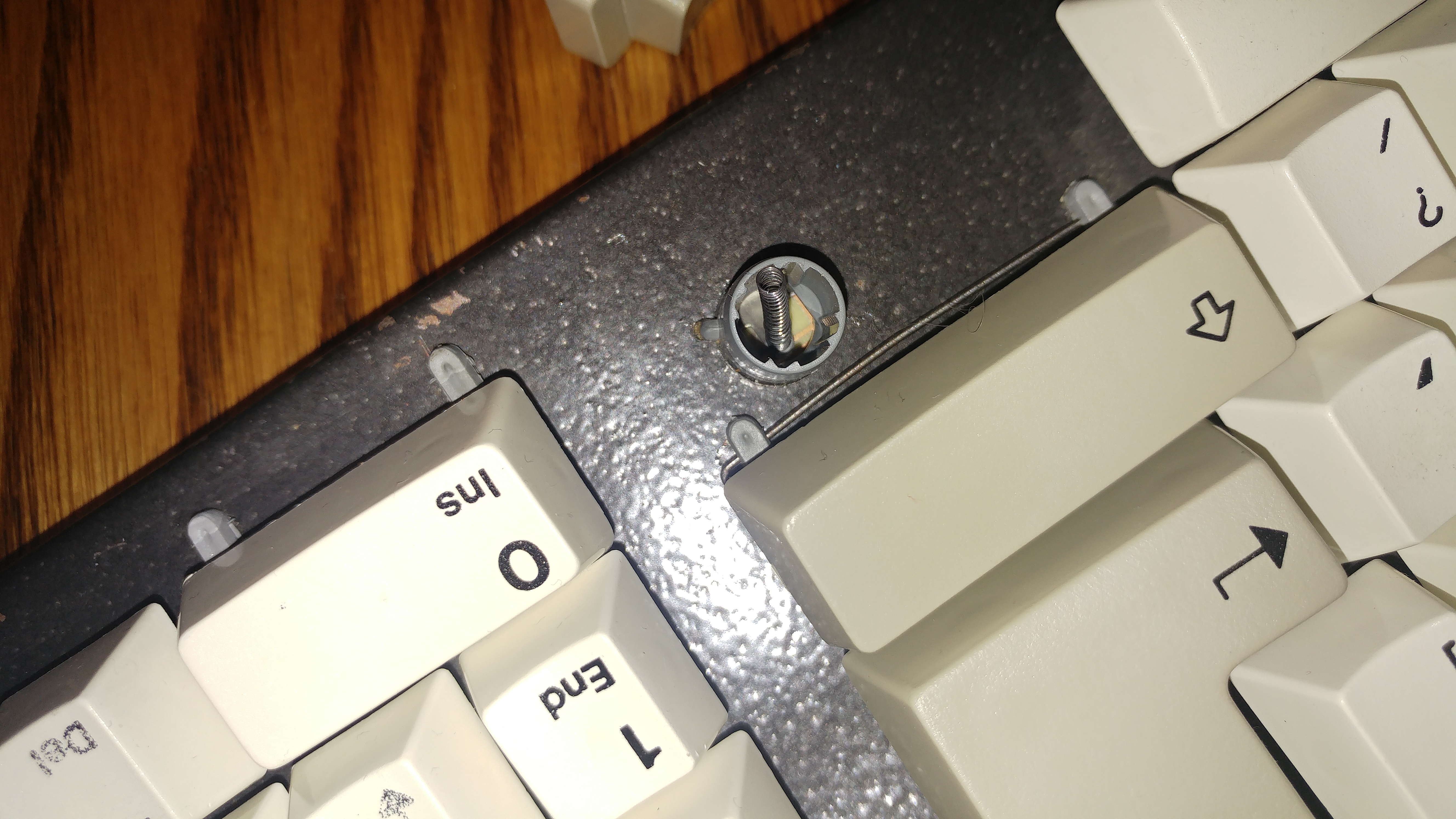

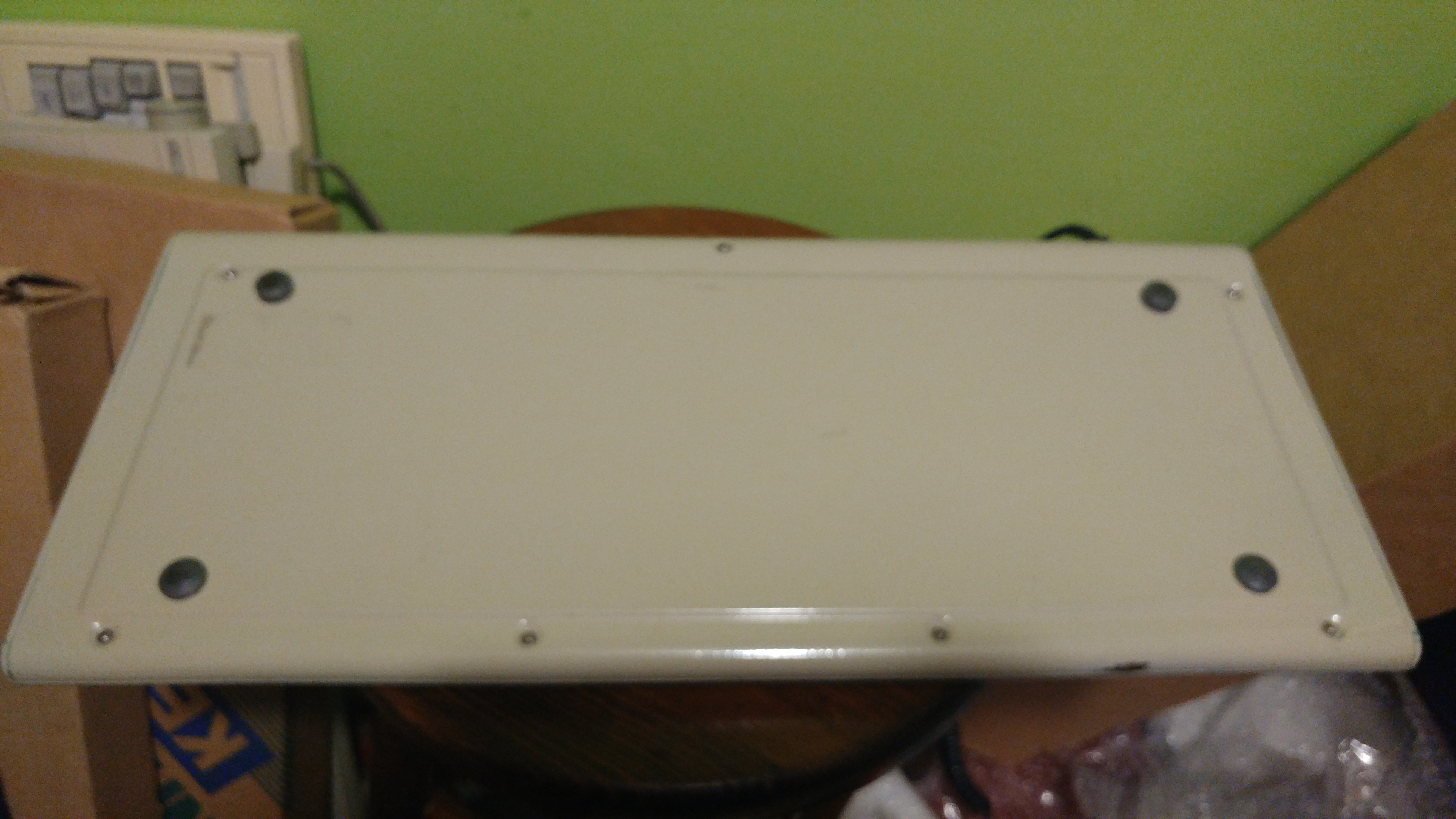

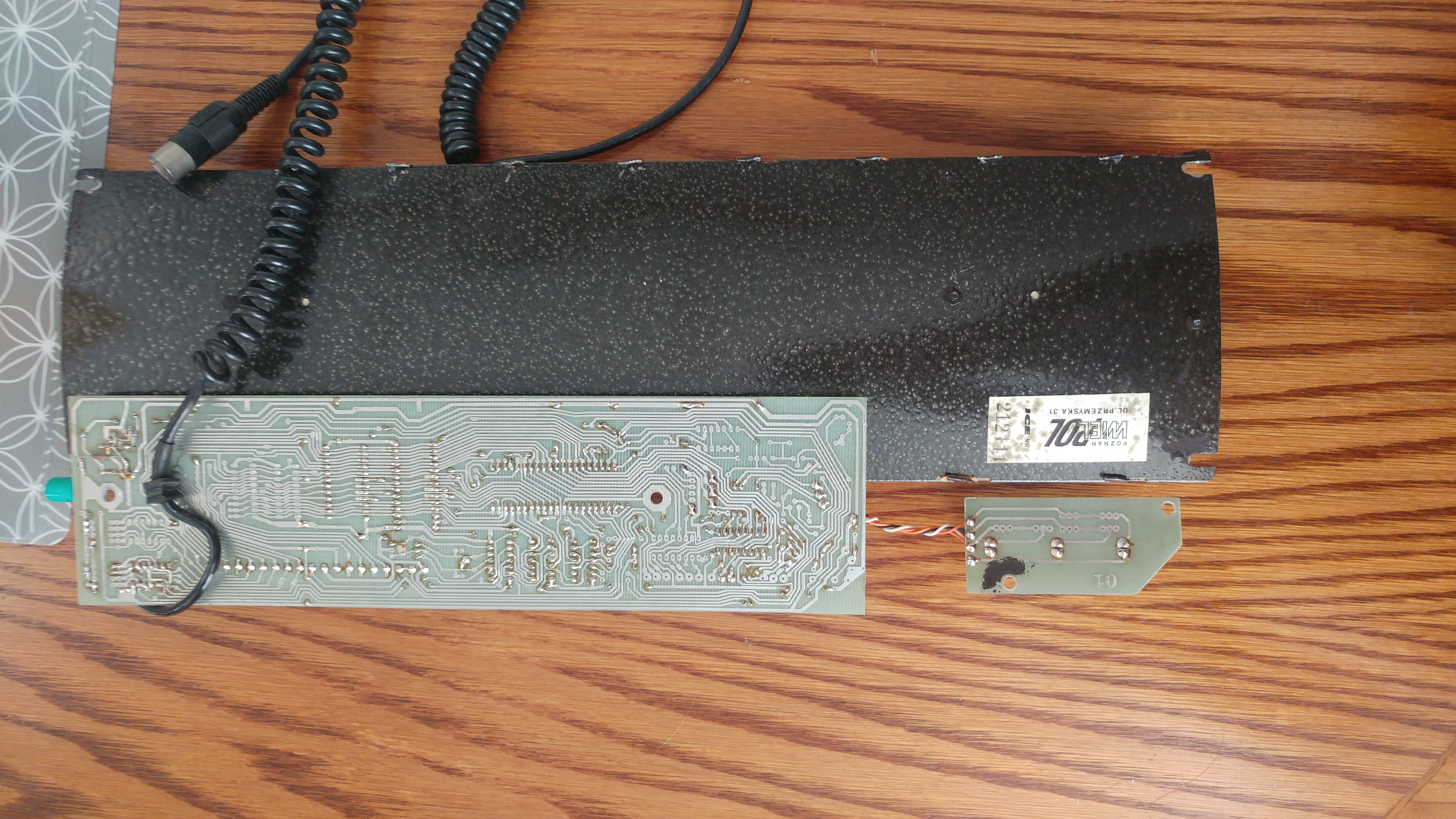

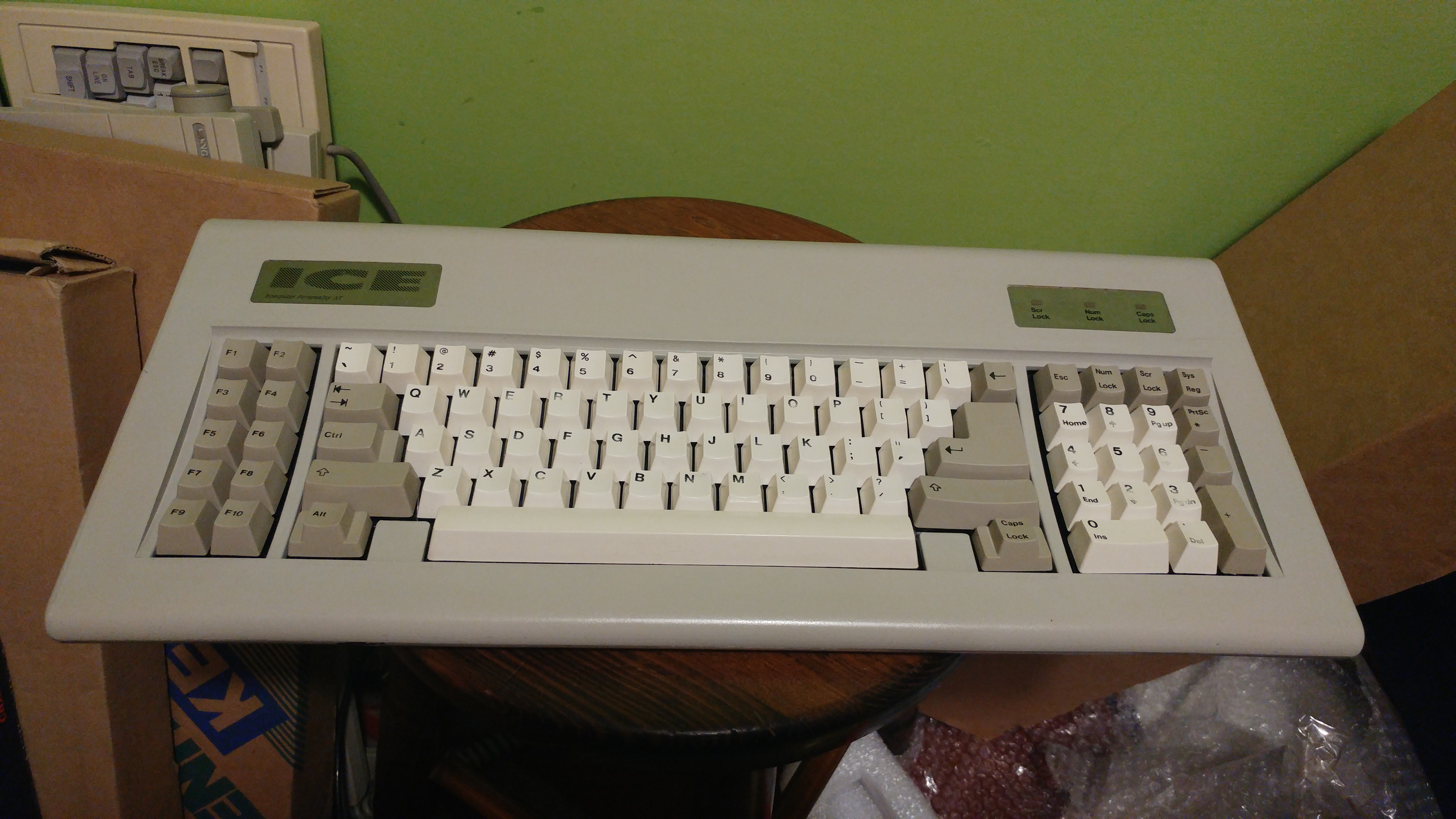

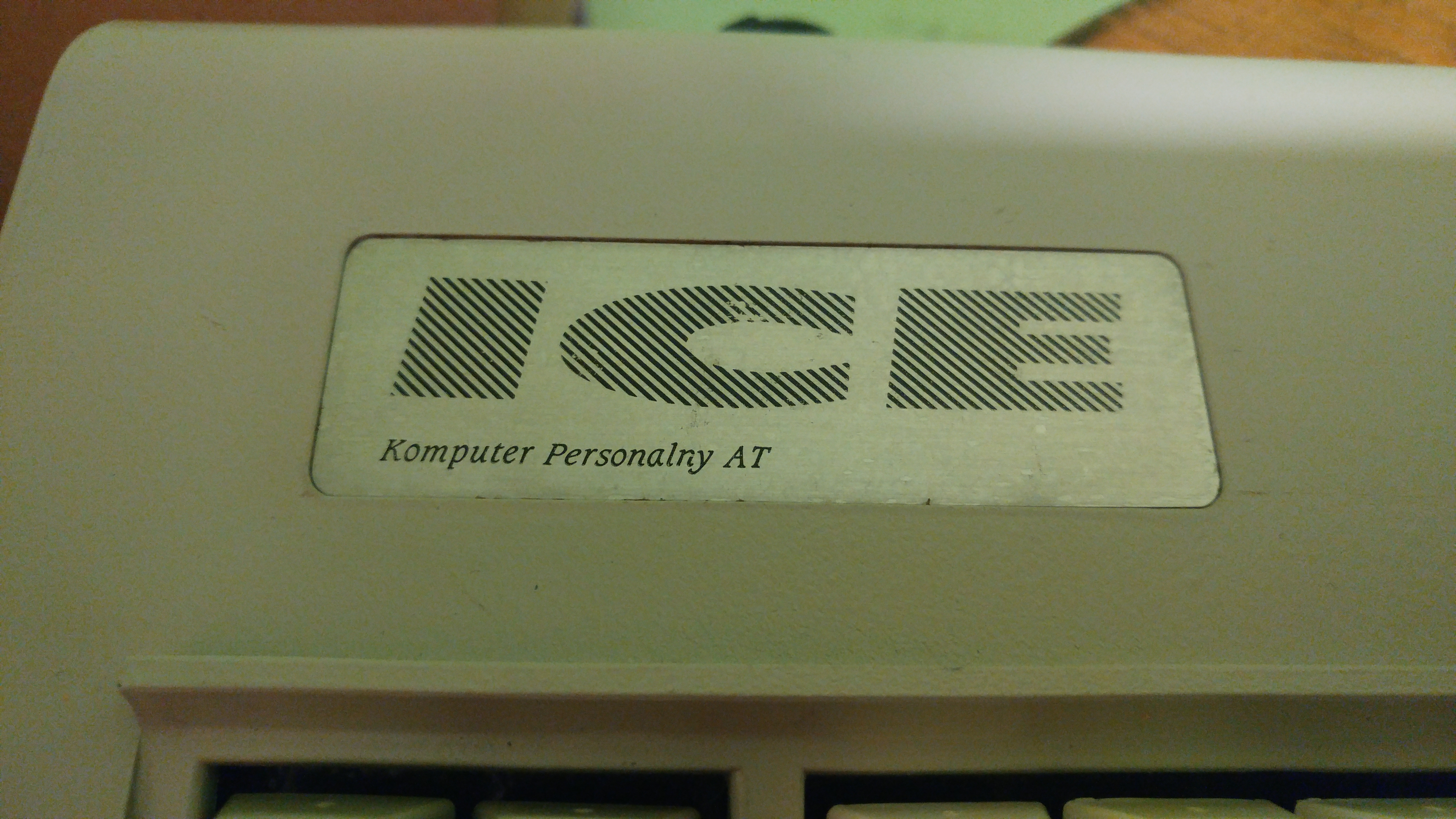

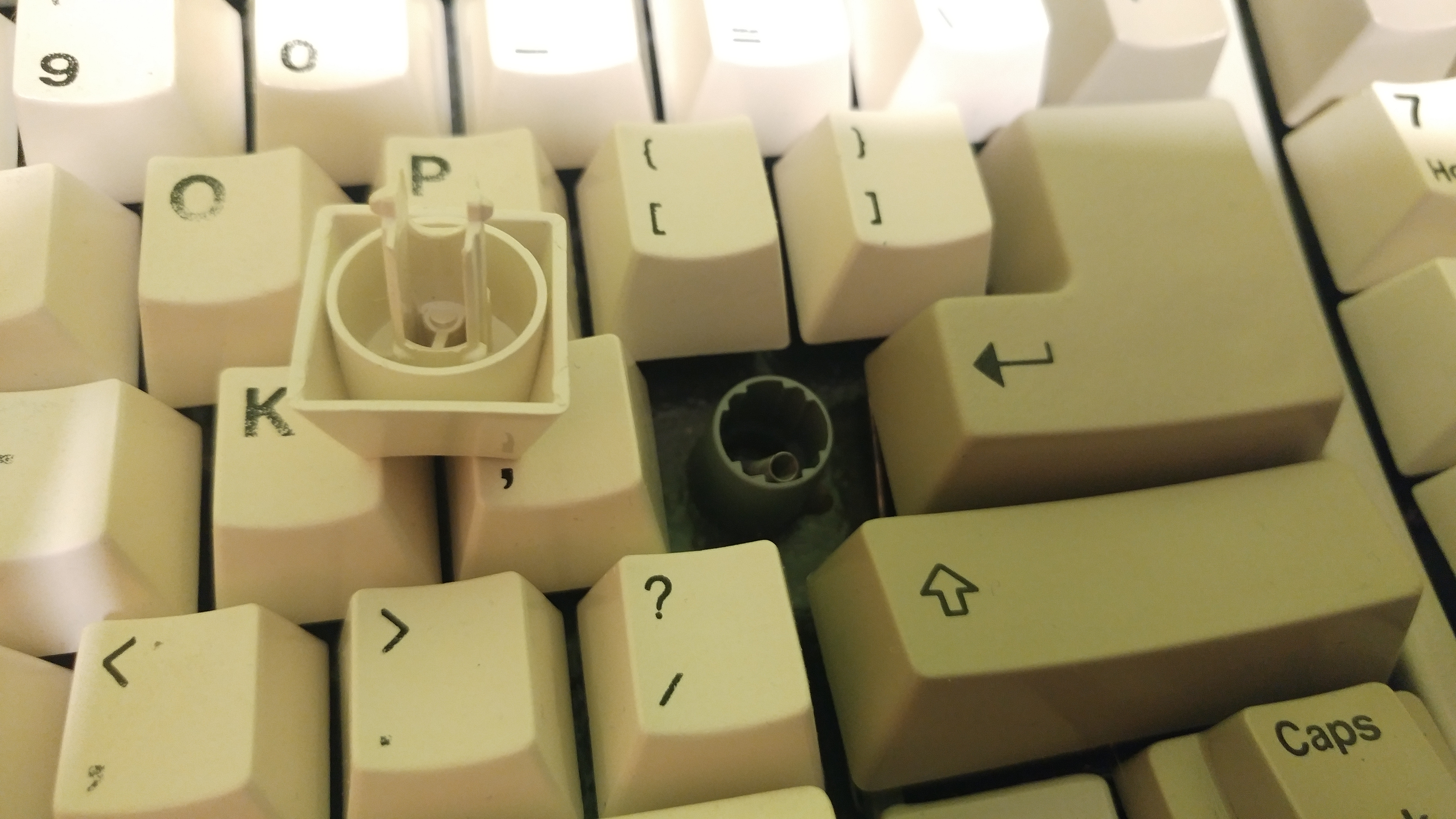

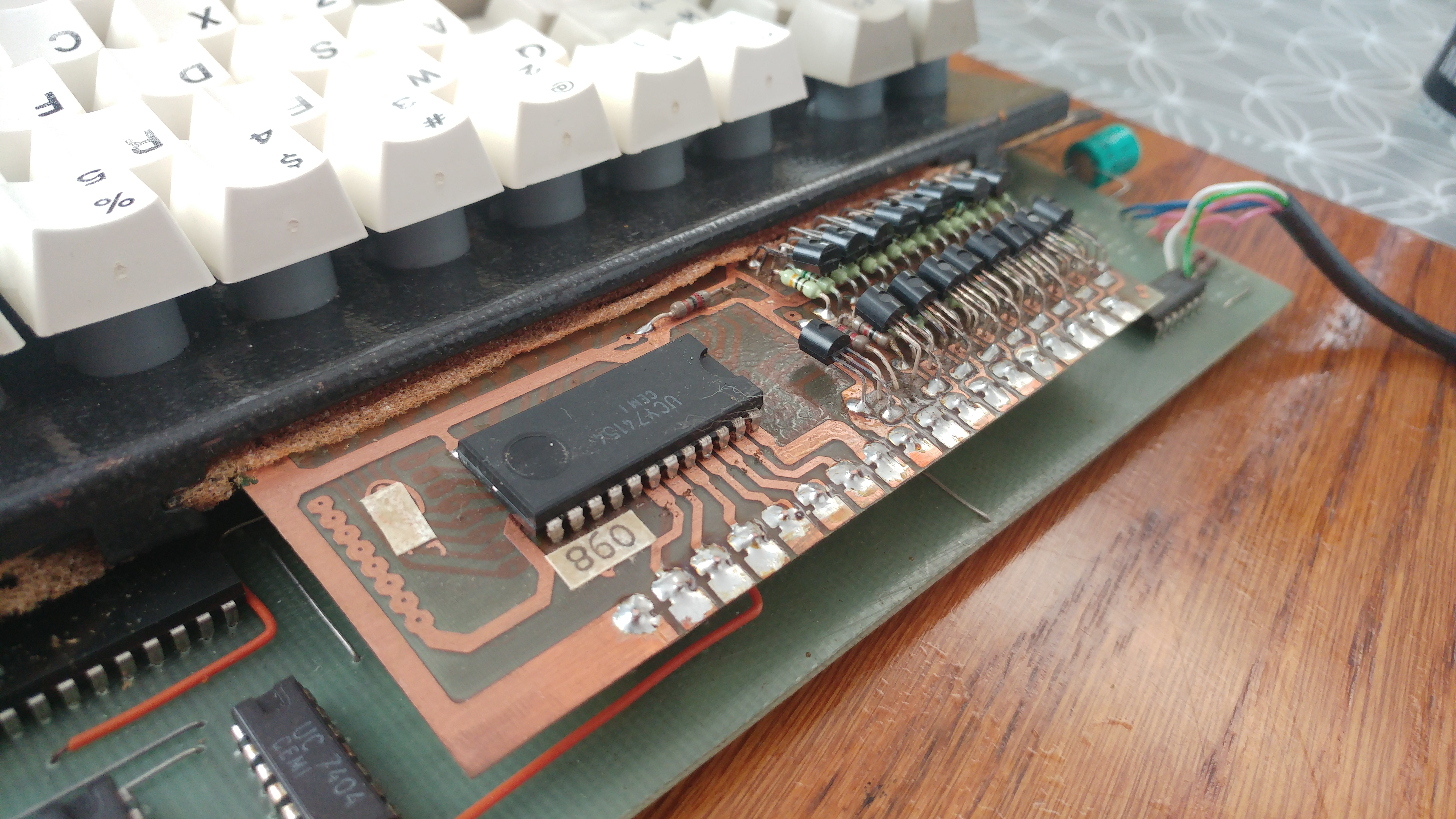

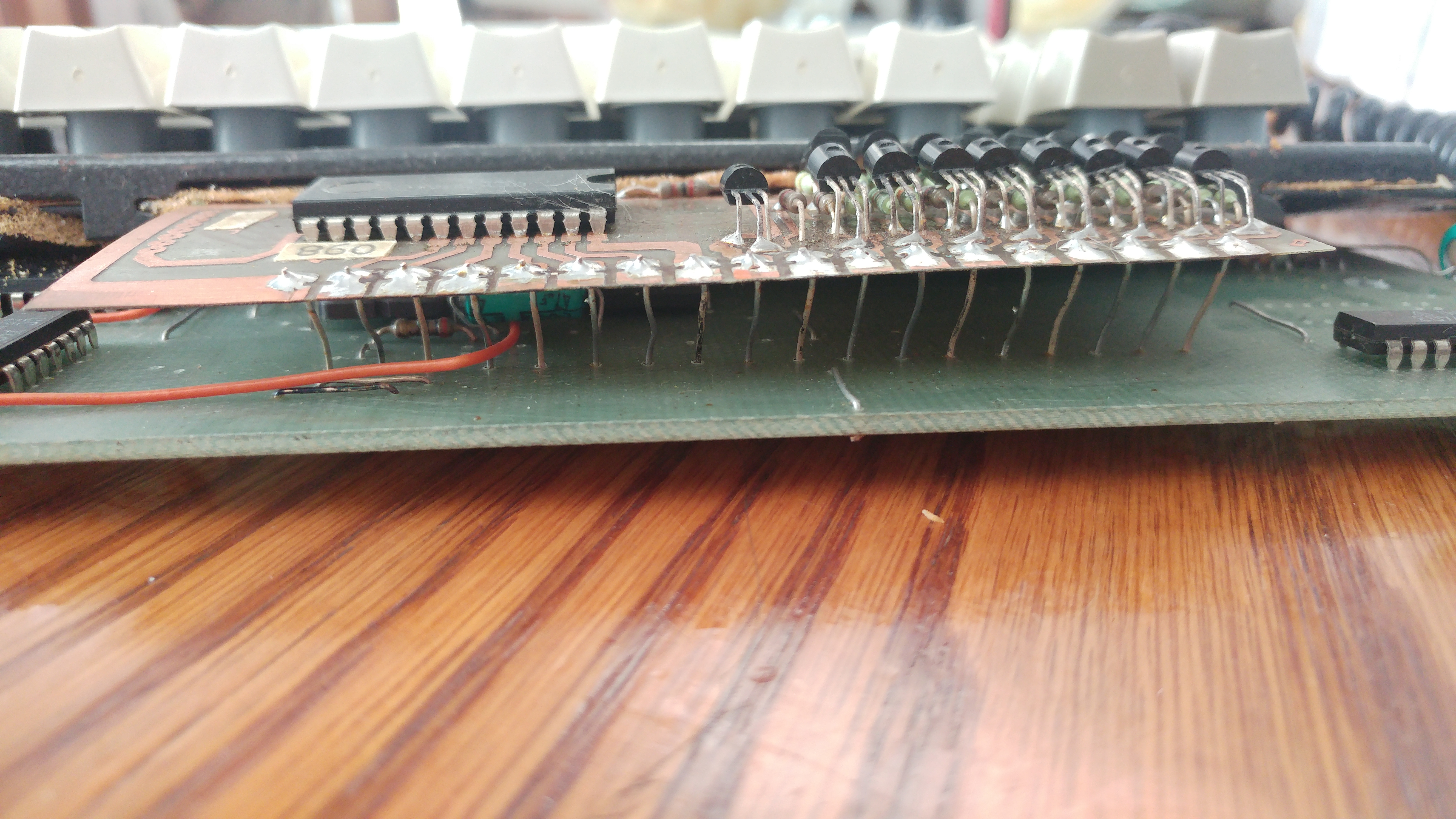

I am currently selling a few keyboard so I thought that I can share a few photos of one of less known CCCP clone devices: IBM Model F Polish Communist Working Party Edition.

It feels like living in under rule of CCCP.
Keycaps are very thin and springs are very light (less than 45g to bottom out) so sound is quite poor, it sound can be improved by using original IBM keycaps.
Springs are probably pen springs from company in Poznan - city in poland where the keyboard was made.

lots of transistors there its interesting comparing the electronics of similar boards and finding they are different. The feeling might be improved by having new foam if you have the tools to cut the foam and also enough clamps to enable the two plates to be shut again after the new foam is in place

You are exactly right, both plates are hold together by two screws (not ribbons) and clamps/latch that can be easily opened. I did not try to open it because whole PCB is rather flimsy attached to the board.Anakey wrote: lots of transistors there its interesting comparing the electronics of similar boards and finding they are different. The feeling might be improved by having new foam if you have the tools to cut the foam and also enough clamps to enable the two plates to be shut again after the new foam is in place
As for transistors from what I tested years ago their purpose is to implement anti-ghosting and blocking for the keyboard matrix layout which is a bit different than in current keyboards.

if you were ever to find a Model F at this price then you will be faced with much the same problem of bad feeling and sounding switches until replacing the foam. As the foam holds the barrels against the barrel plate if the foam is disintegrated then the barrels are not pressed as close to the plate so in turn there will be a greater distance before the spring is compressed, therefore effecting all of the atributes that you have mentioned in the post. I am sure that if the foam is replaced it will make the springs appear stiffer as there will be more compression with the shorter travel distance and the sound should also be improved. I have recently restaored a genuine Model F XT that was suffering from the exact same problem, took it appart gave everything a clean to gte the old disintegrated foam off then cut new foram and now it is working just like new.

foam cost litterally 4 euro and you can cut it with anything that is as sharp as a scissors, don't give up that easily !!
I bought this for my F122 and beamer, hope it can be useful to you too !!
http://www.ebay.fr/itm/EVA-Foam-Sheets- ... 2749.l2649
(2mm is the best apparently for Model Fs) (Yes, it's in french but I'm sure you know to replace .fr by whatever your country's letters are

The foam is quite easy to cut you would just need to buy a set of leather punches in the correct size and follow the guides that are available on here depending on what type of F you have you should be able to get the punches for €10-15 and the foam for a few more €. I used the foam underlay that is for laminate flooring as i had quite a lot left over but generally any foam 2-3mm should be fine.

That PCB set up tho Lol Jesus Christ, this would be cool to own just to look at it and show it to people.
