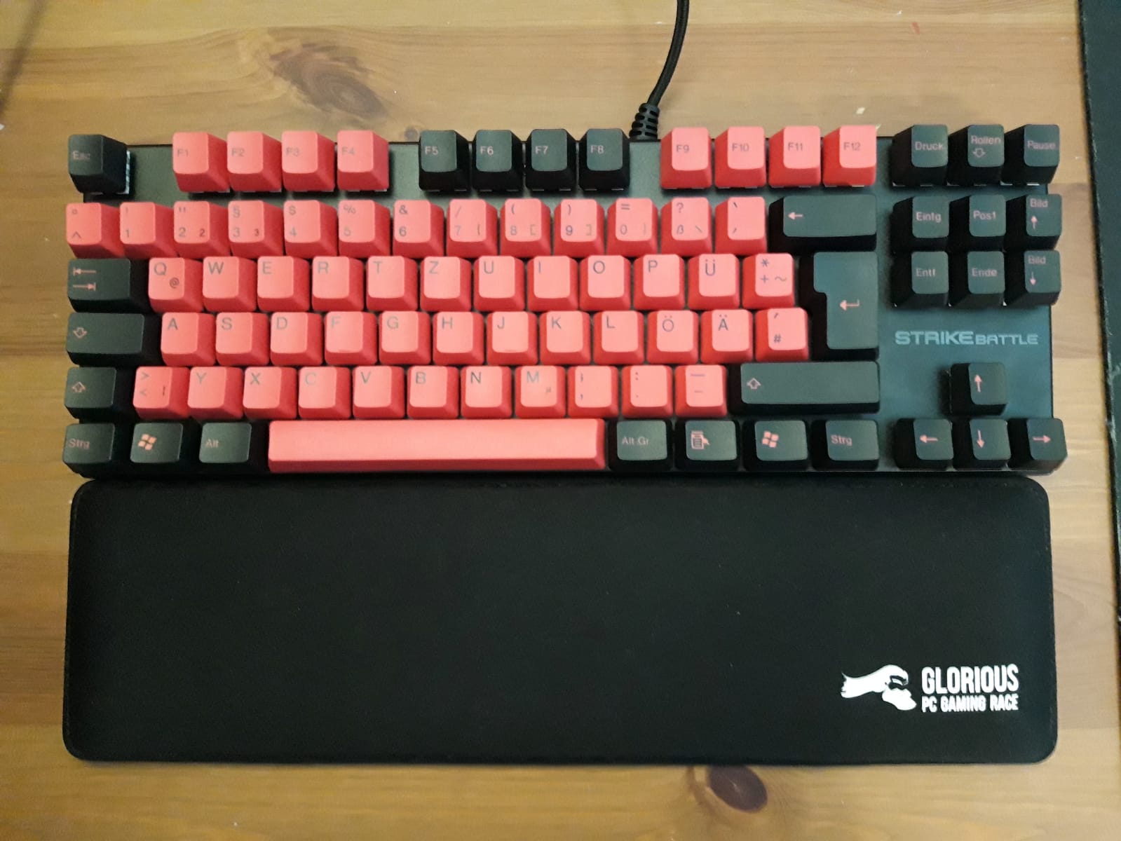

recently I have started a budget project.

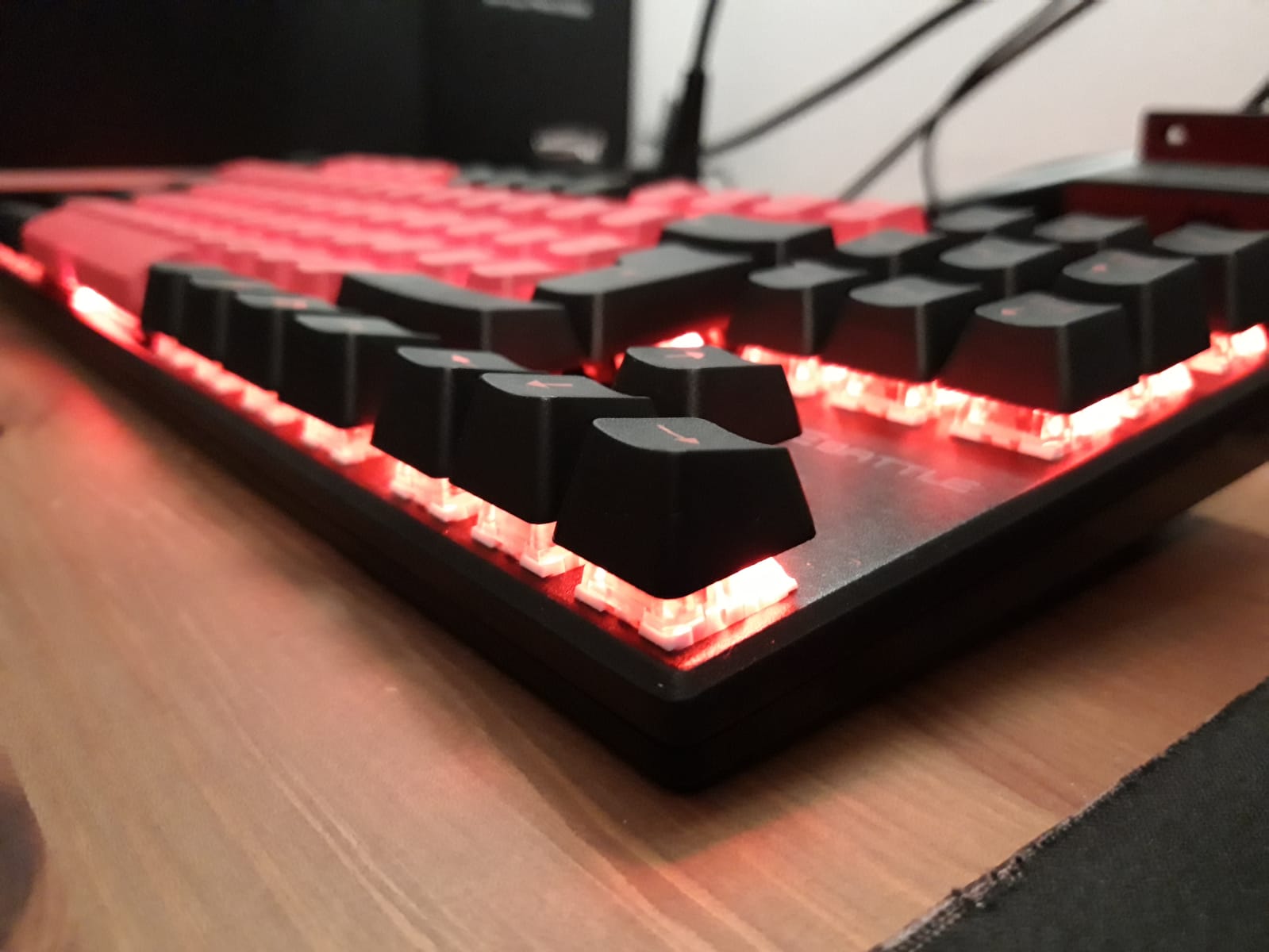

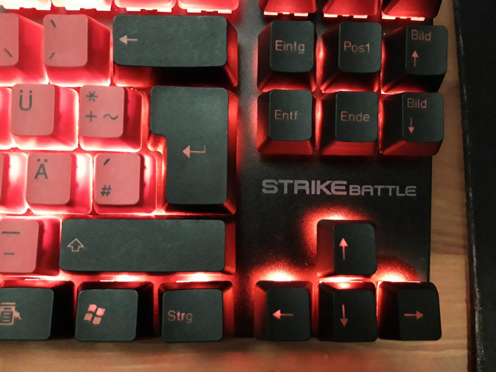

Instead of buying expensive Kits I decided to buy old gaming keyboards from eBay Classified and pimp them.
I started off my project with an Ozone Strikebattle. Cherry MX Browns were desoldered and shiny thin ABS keycaps were removed.
I soldered in some Kailh Speed Bronze switches and put some Tai Hao Red and Black Keycaps on. Stabilizers were lubed with Superlube.
This keyboard is now a joy to use in CS:GO.
Next up is a banged up Lioncast LK20.
EDIT: LEDs are soldered in as well. The light bleed because of the clear tops is much nicer than with the MX Browns that were initially built into the board (which had black tops).

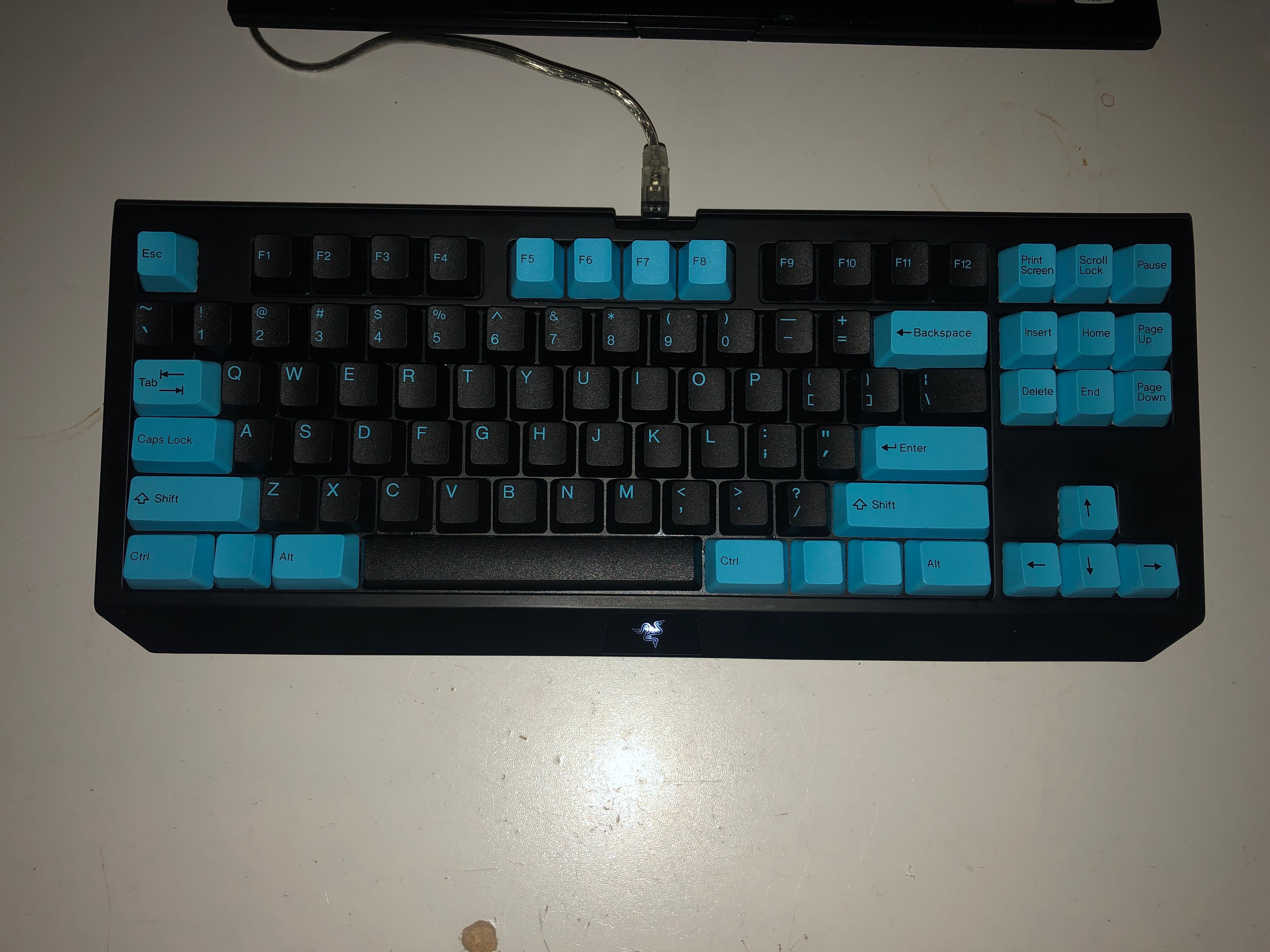

Nice, I did this with a Razer 10KL a while back

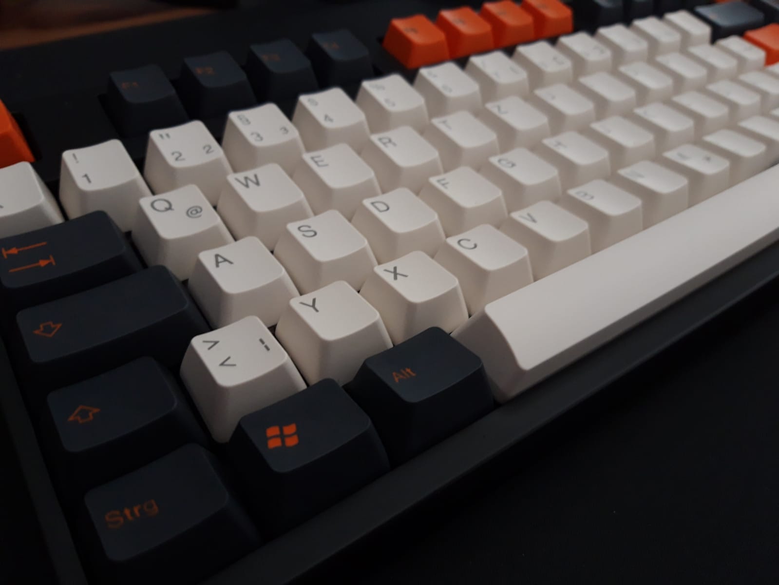

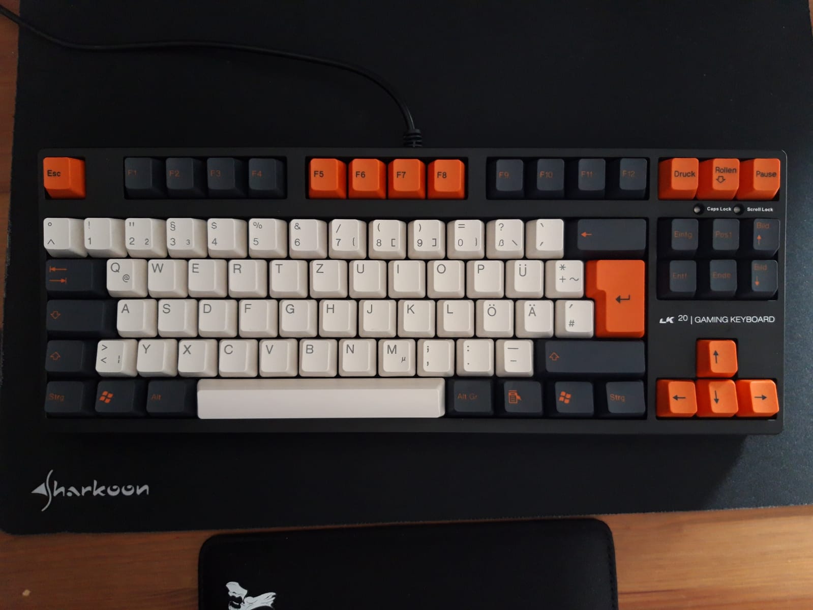

The LK20 was all banged up when I got it for a good price on ebay classifieds. MX Blues were desoldered. No RGB this time. Kailh Speed Copper Switches and Tai Hao Carbon ABS Double Shot installed.
Switches lubed with 3203. I hate to say it but they are so much better than MX Browns, it's not even funny.

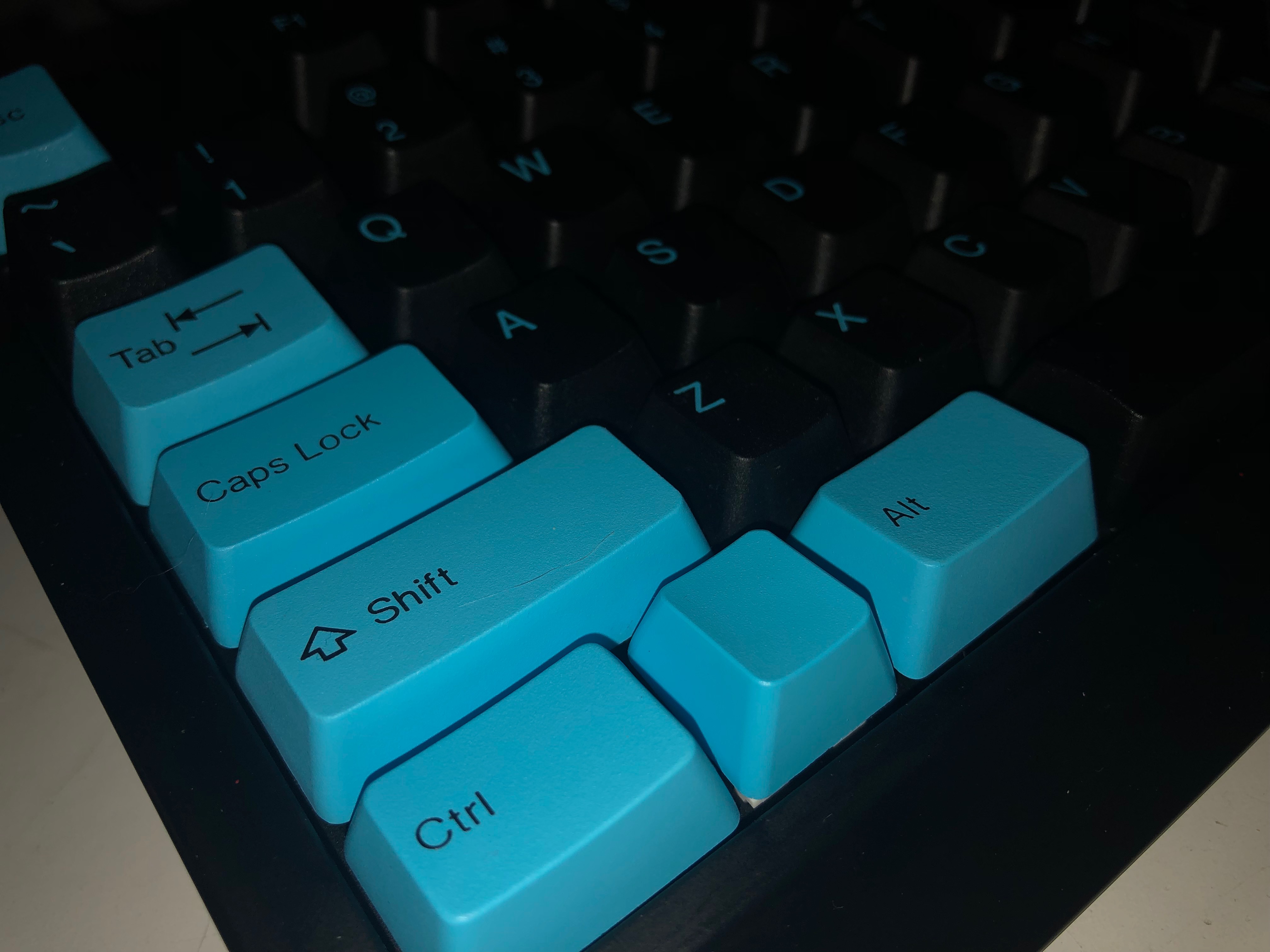

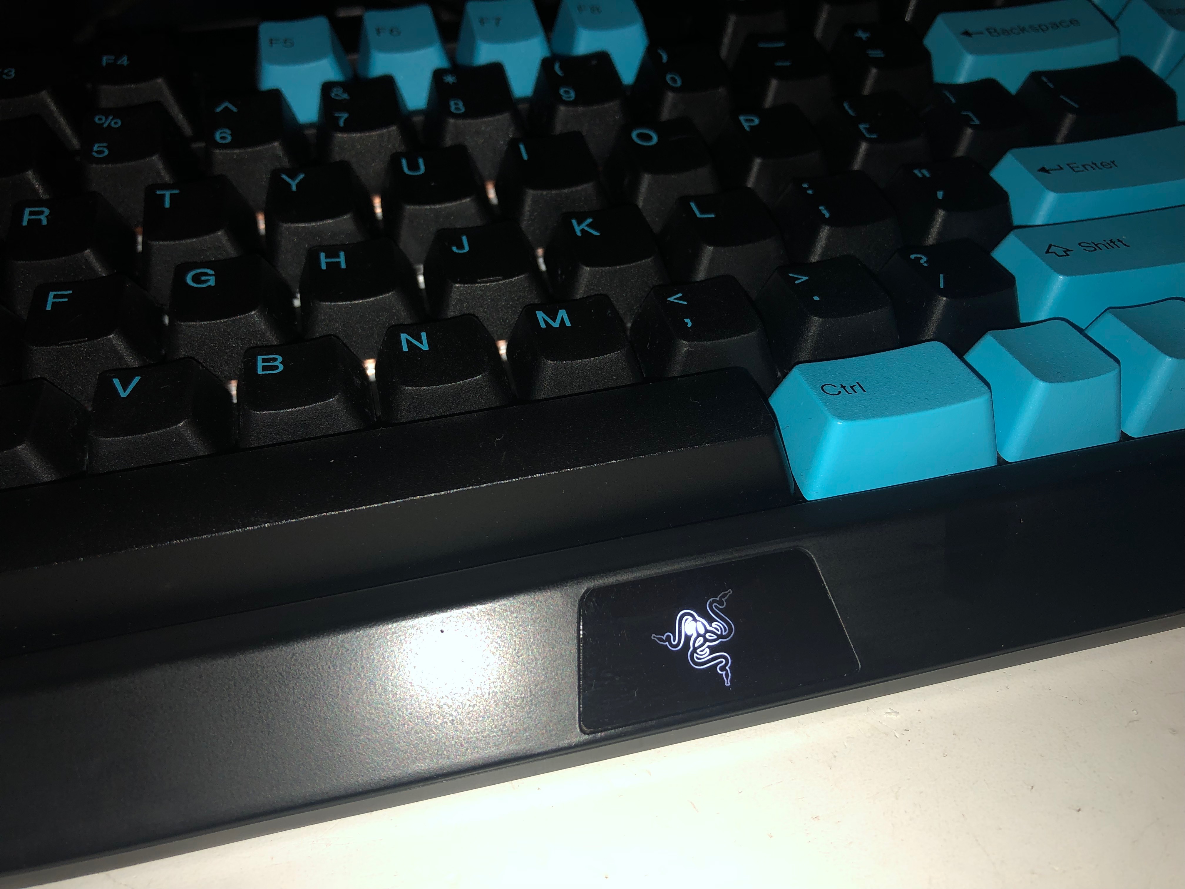

Sure, here are some pictures of the Razer.
- jani80k
- Location: Hamburg,Germany
- Main keyboard: IDB60, JER J80, KBD8x MK²
- Main mouse: Elecom Huge / MX Master 3
- Favorite switch: Smooth linears with slow force curve
Cool, thanks!

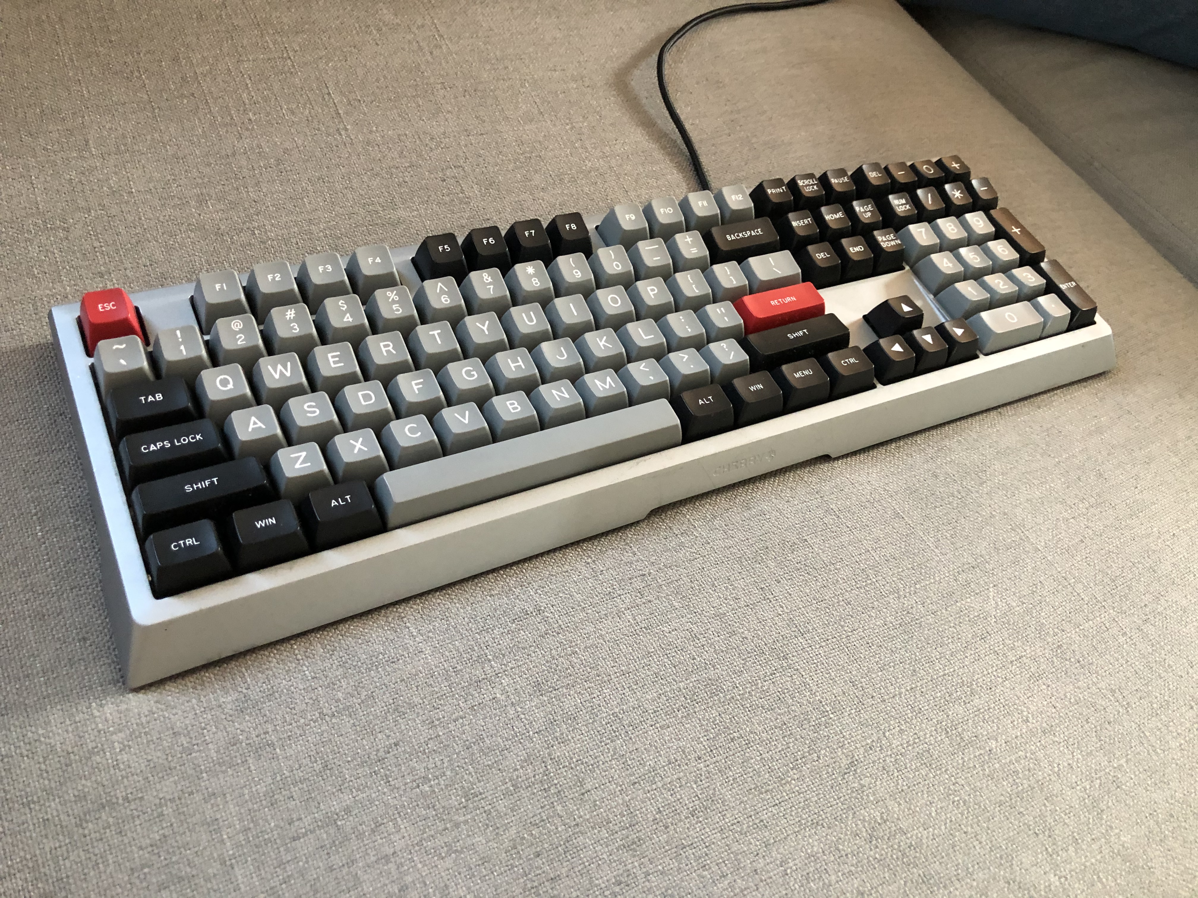

Nice. This is how I got my start as well. It’s cheaper and easier that building from scratch. Here’s one I did last year. Cherry MX Board 6.0 with jades and Maxkey Portland.
