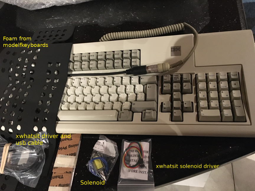

Hi Everyone:
I'm looking for some advice. I have a Model F122 keyboard that I am thinking of wanting to modify with an xwhatsit driver and the solenoid driver. Maybe replace the foam while I'm at it. What I currently have acquired so far are the following:
Now, to be honest, I have some reservations about how hard this might actually be and whether this is a good idea for me to try as a first project. My main concerns are around the space bar removal, any soldering that might be involved, and basically anything I might do that will destroy my keyboard! So, my questions for the group are:
  • What tools will I need?
  • Should I do the foam replacement at all?
  • How difficult is this kind of modification for someone new?
  • If too difficult, is it possible commission help from here?
Any feedback is greatly appreciated.

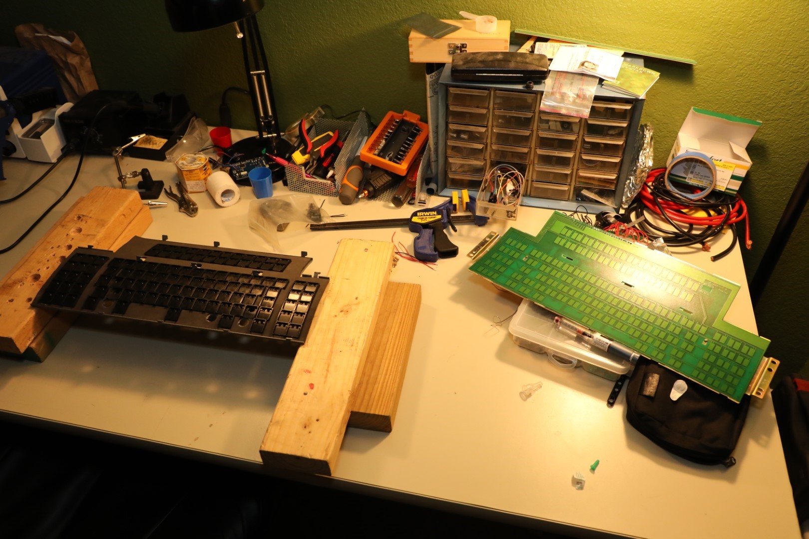

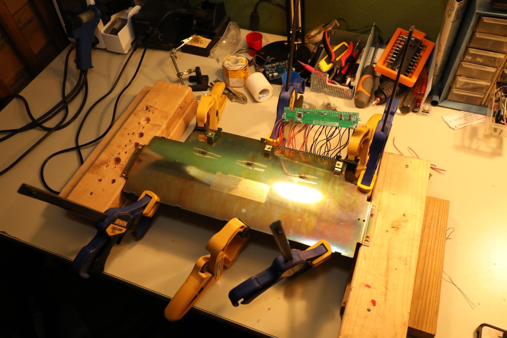

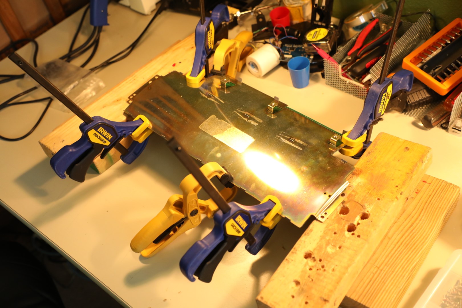

You will need clamps, the long kind. They are in the fourth picture to the left, something like this would be idea:
https://www.homedepot.com/p/DEWALT-36-i ... /204988148

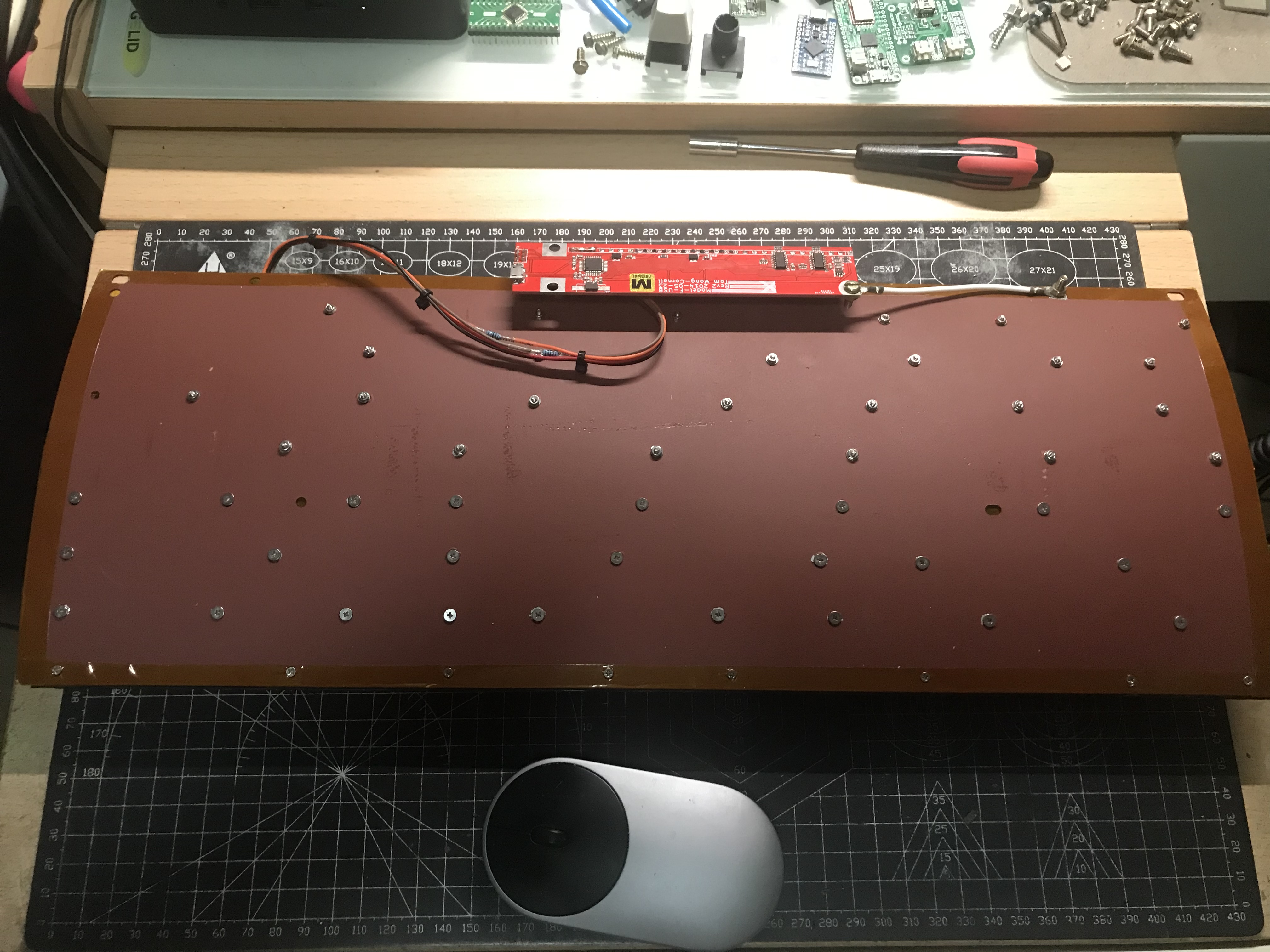

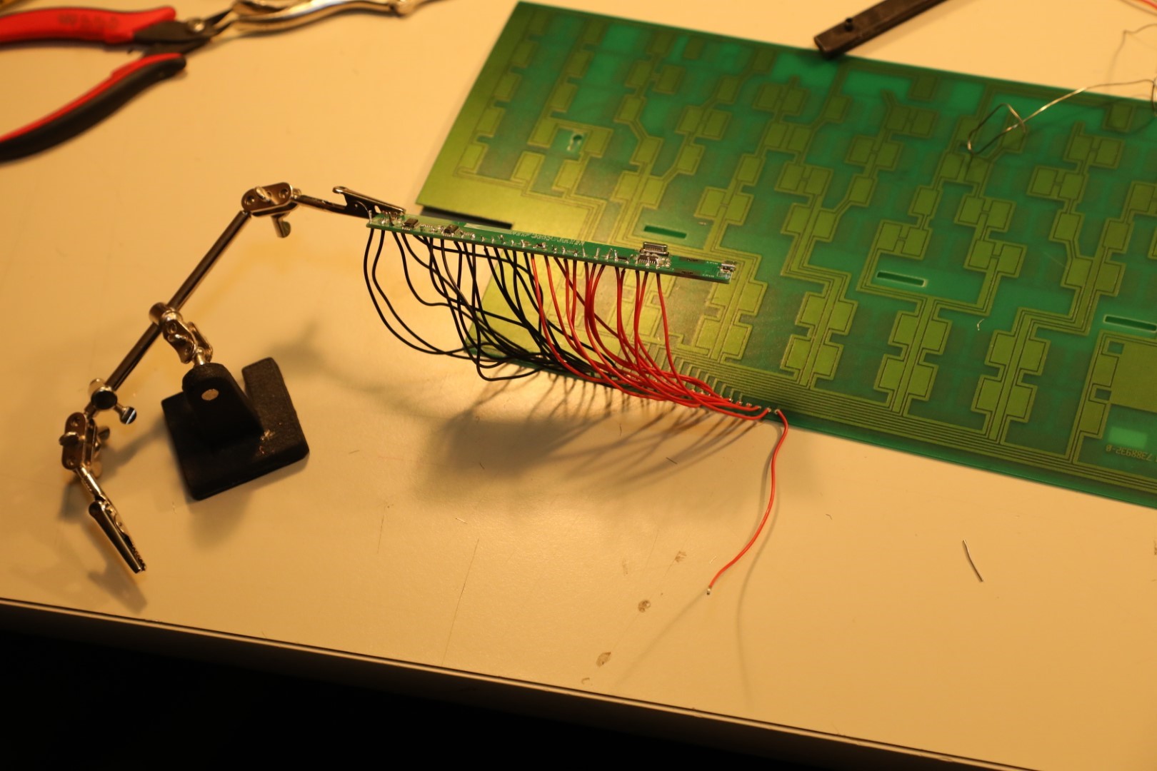

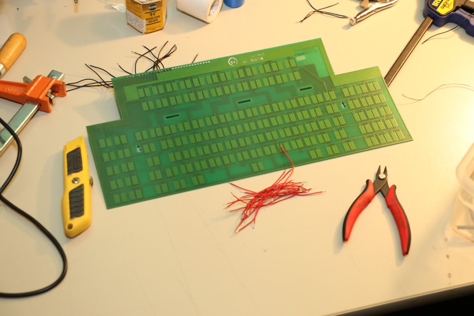

If you are using xwhatsit there will be a lot of soldering involved, probably the most important thing is to be careful with the pads on the PCB when doing this. Here are a few pictures from my Unsaver mod:
If the foam is in any way deteriorated,(which is likely in an F122) you should go ahead and replace the foam. The modification is somewhat difficult, it will take some time and effort but newbie should be able to do it with patience. I started my ANSI mod on an F122 without any former knowledge and it turned out great.
You could of course commission help from here, I and many others I assume would be willing to help for a price.

unless your f122 controller has malfunction, I prefer to use soarer converter instead of using xwhatsit. but if you use xwhatsit, better use 3.96mm pitch male and female header for the installation. will show photos on what I did to my model m with xwhatsit and headers.
anthonymak
20 May 2020, 20:03
xwhatsit installed with 3.96mm pitch headers. this is on a model M
