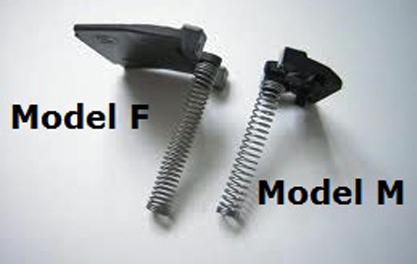

11 Jun 2020, 03:52
Weezer wrote: 09 Jun 2020, 01:18
wobbled wrote: 09 Jun 2020, 00:51 I don't notice any difference at all in feel or sound.
I think the springs were the same in both models
Um,
gianni
11 Jun 2020, 12:49
fohat wrote: 11 Jun 2020, 03:52
Um,
more "spires" (if that's the correct word) mean that the spring is more flexible (because for the same deformation each spire needs to deform less, if their number is higher)

Really, I wasn't going to say anything, but I do have two or three new Model M springs from Unicomp. The Model F springs look like fohat's pic: Model F slightly longer and "more coiled." Unicomp's pivot plates are white, tho.
I bought a couple Model F springs w/flippers from orihalcon on ebay, so we can increase that sample size. Mind you, the Model F I have is the first one I've had, so I also can't compare the feel. I had a new Unicomp Ultra Classic, I currently have an absolute mint early Lexmark M, and I've owned a couple IBM-made M 122s. The F did feel a little better than my Ms even before I did any repair to it. I still have to get a foam mat and punch, and do some rust removal sanding, so it'll be a while before my F is up and running.
