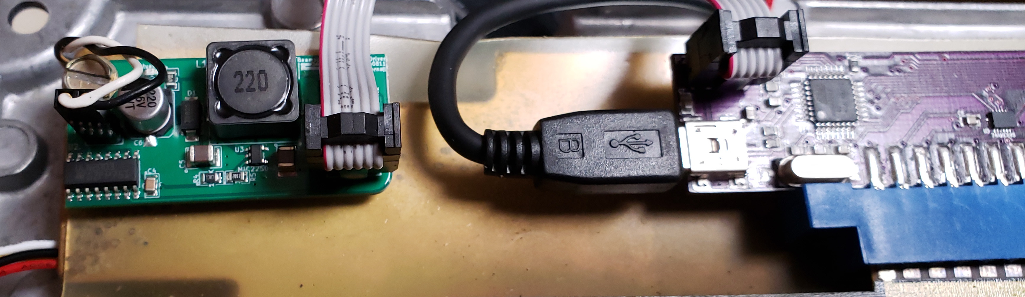

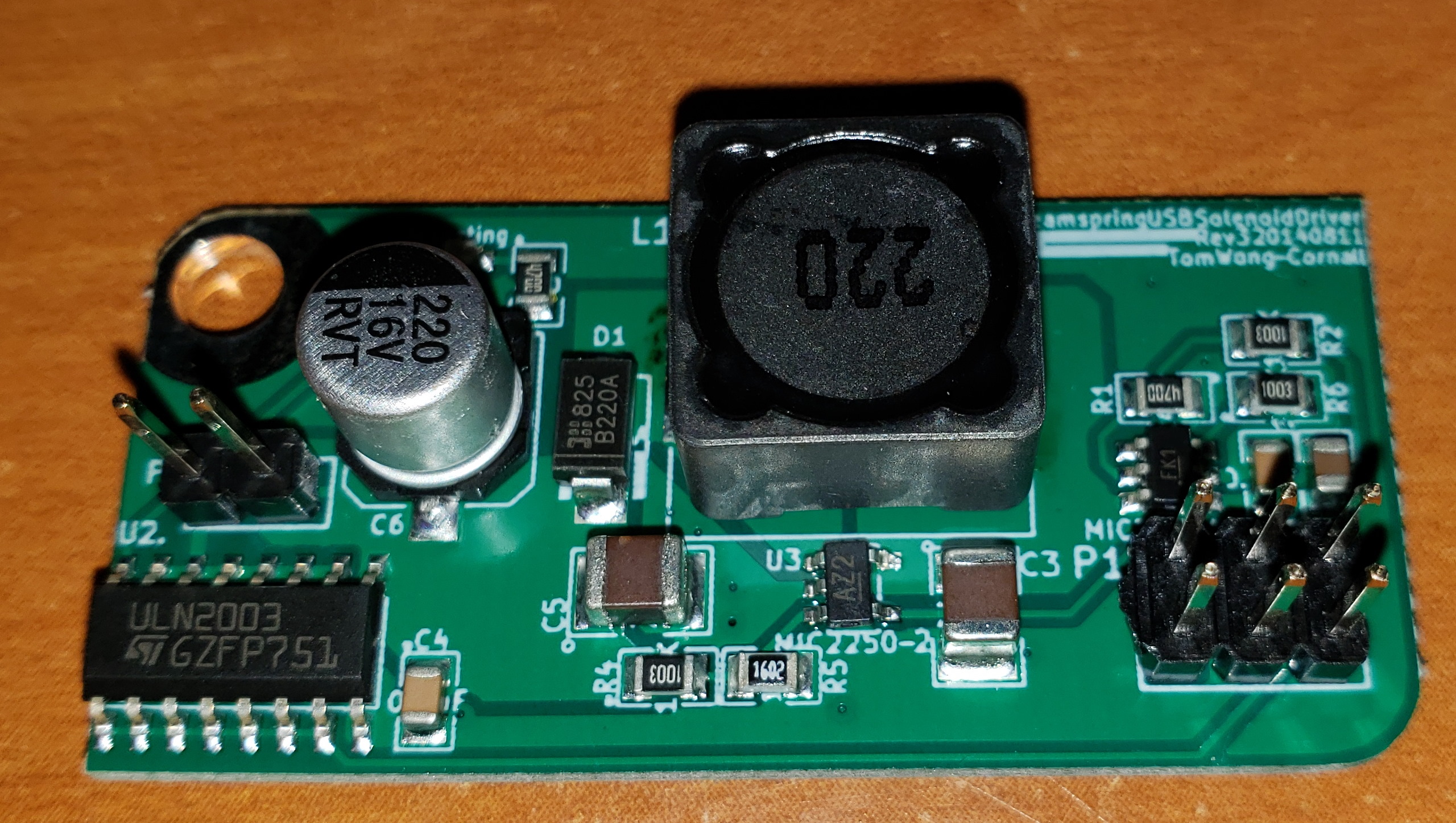

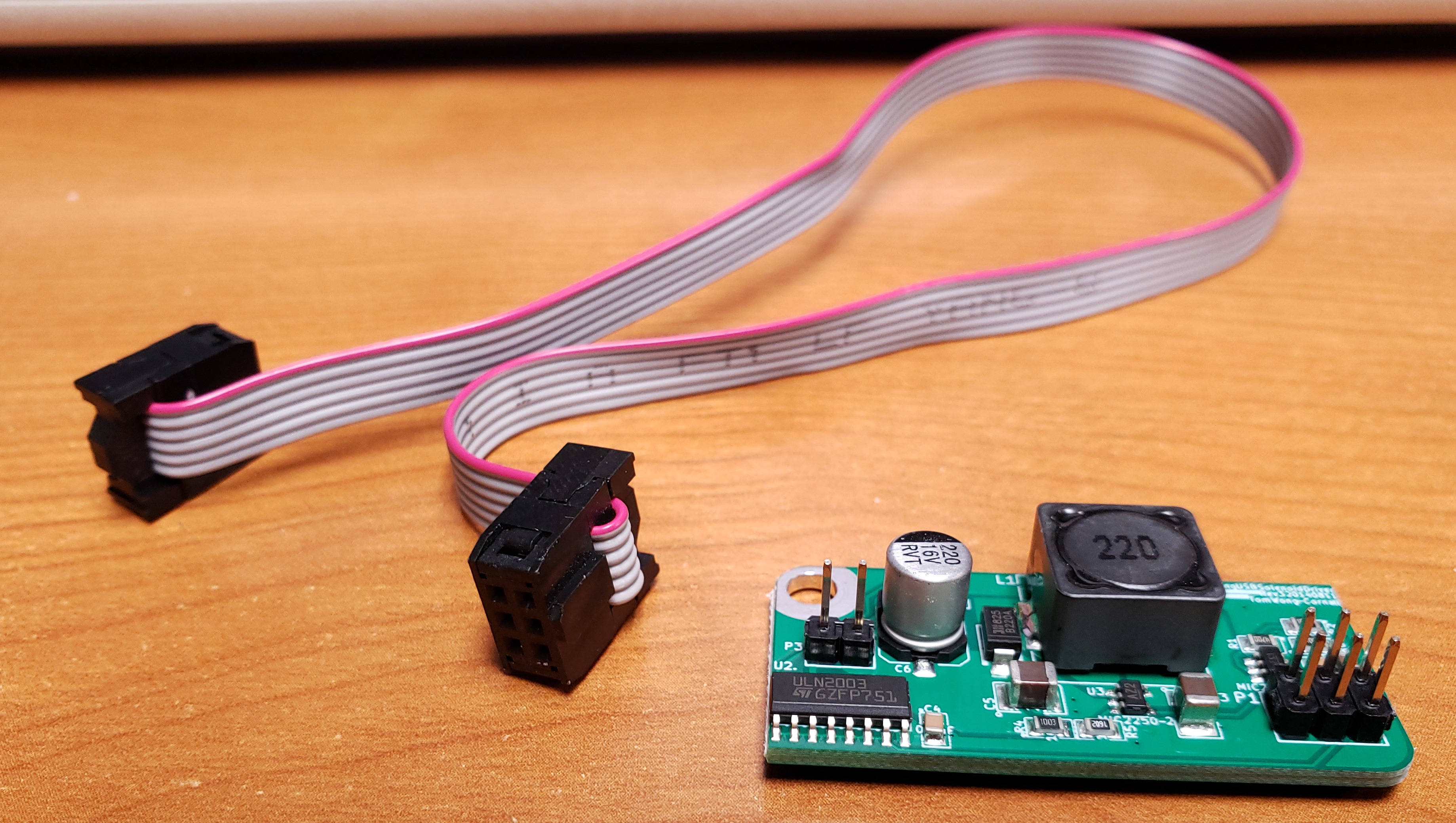

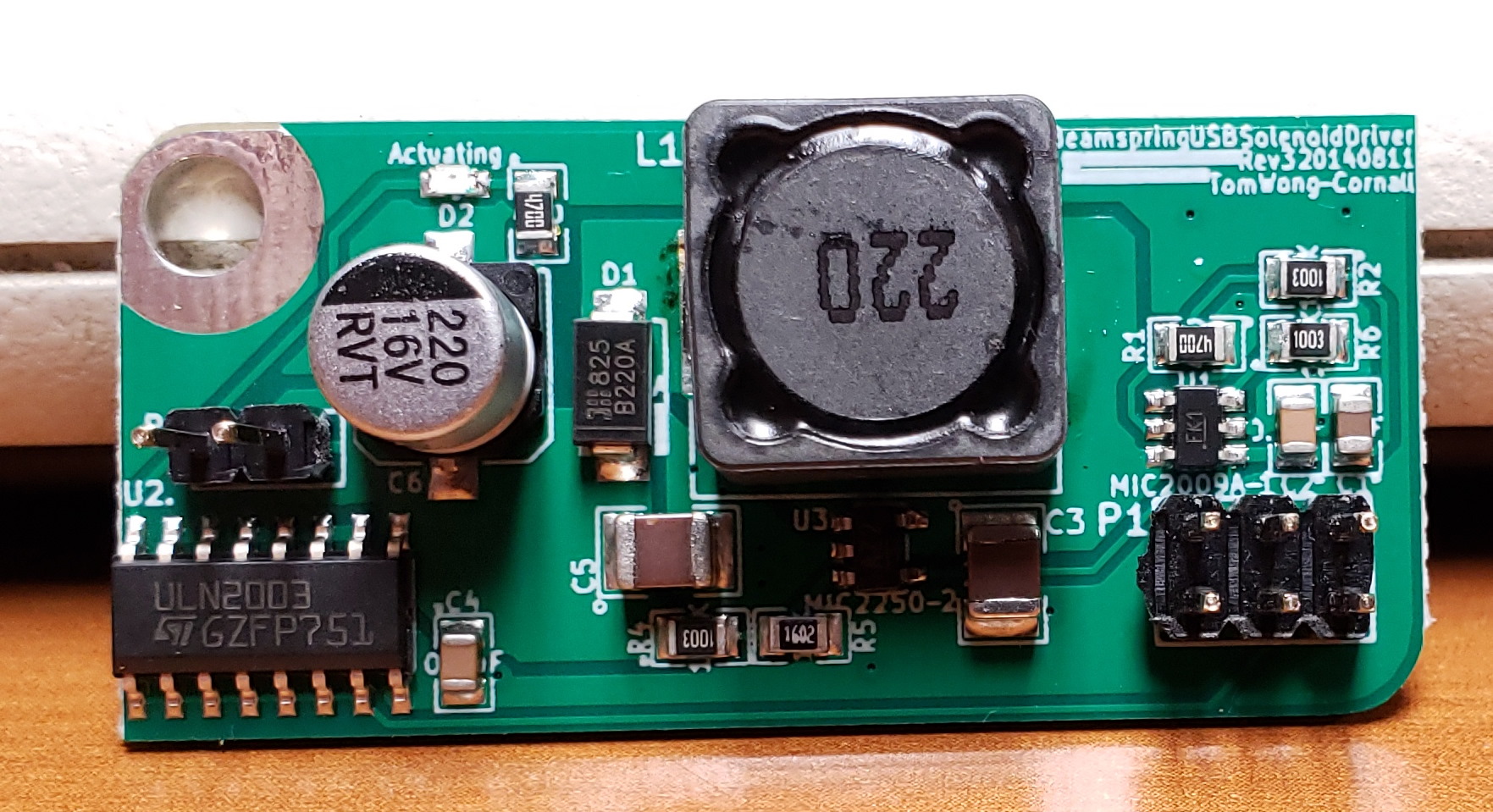

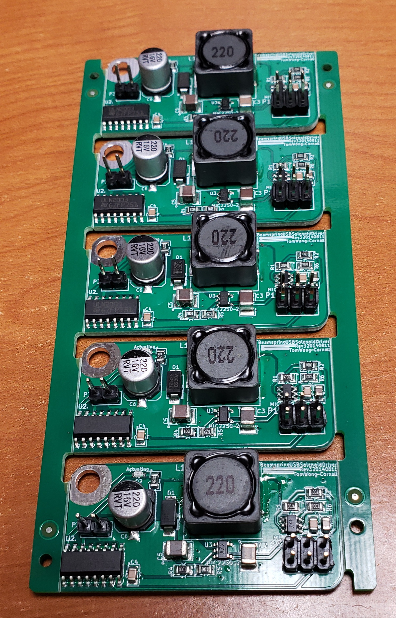

Solenoid driver update - solenoid driver samples are confirmed working and solenoid driver assembly should finish soon.
Note: the solenoid driver activity LED for diagnostic purposes does not work (the LED never worked even on my original solenoid driver made directly by xwhatsit). Not sure why.

that's interesting, the led was working for me but I only tested it so far with commonsense and the cypress based controller.. I'd start finally test it with xwhatsit indeed..

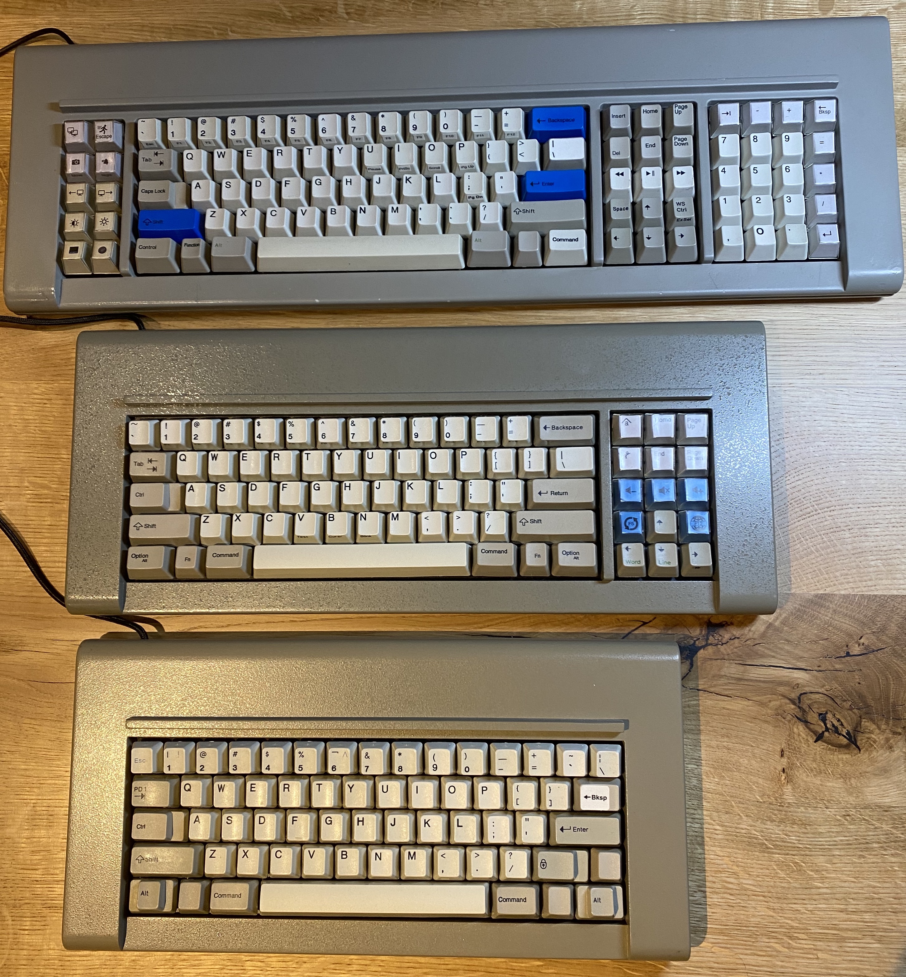

I wanted to share a picture of my Model-F family. The top one is an F107 (not a New Model-F obviously), middle is the F77 and at the bottom the F62. All in Industrial Grey.
