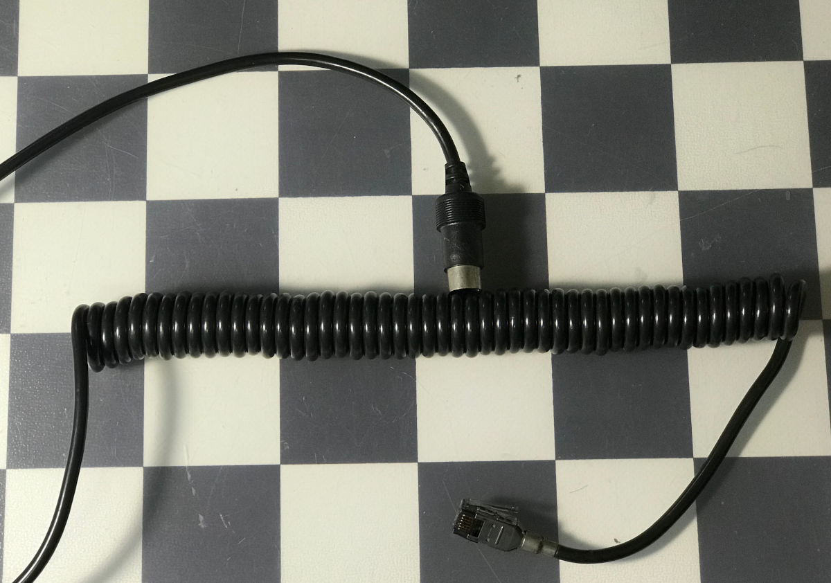

Had some of these terminal model m cables lying around but they are ugly so i decided to try to re-coil them by wrapping them around a rod and heating them with a heat gun and letting them air dry
gallery: https://imgur.com/gallery/gkUuZ50
original cable was about 1m long:
straightened it was about 2.4m:
painstakingly wrapped around curtain rod and held by electrical tape:
it kinda worked but it was kinda loose and my curtain rod was starting to melt
copper pipe this time:
i got it hot enough that the electrical tape started melting and here is the result:
Overall i consider this a failure; the coil is still pretty loose and it seems that it does not want to hold its shape very well (if i stretch it it doesnt quite return to its original shape). I think this is either because of the material itself or because its so old/degraded; it behaved the same way before i re-coiled it.
If you have any advice or experiences definitely share :D

Update: gave it 6 heat/cool cycles without taking it off the rod but the result is pretty much the same:

fricked
25 Aug 2020, 02:27
Darkshado wrote: 21 Aug 2020, 22:58 You need to reverse the coil to get a proper retractable effet according to this
Woah, golden tidbit right here!
Here it is reversed:
Nice and tight! Still pretty ugly though
