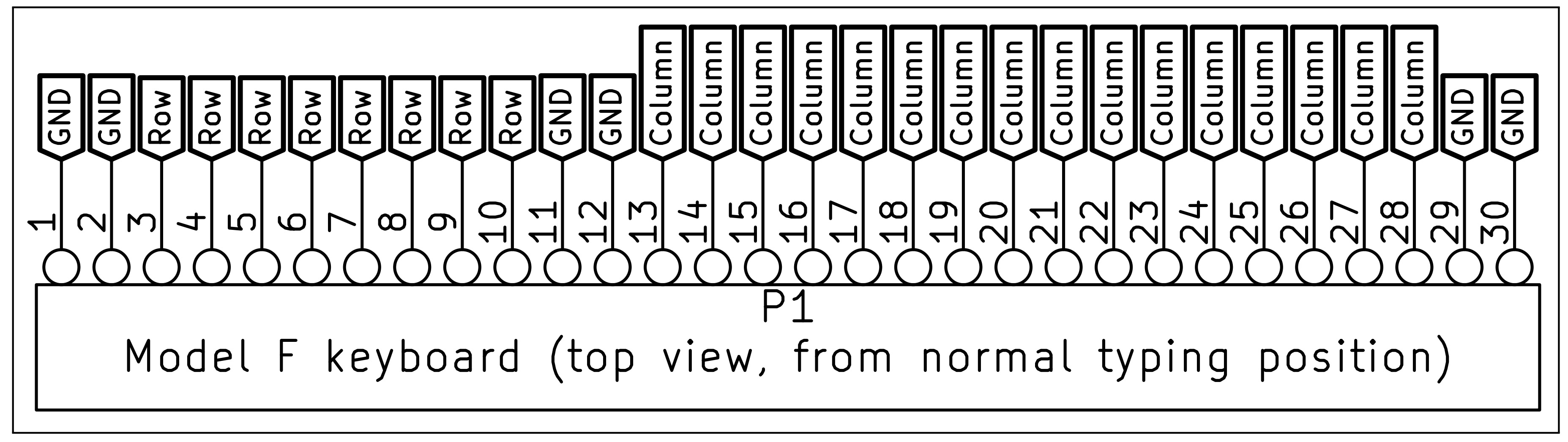

Here's a puzzler, I got my F62 today (woo!), it appears to have the QMK flashed, and right off the bat the column for 56tghb (and space) wasn't working.
The soldering was pretty rough; on the board side half the pins had no visible solder and on the controller side they had gobs of it, including a blob that was probably not bridging anything, but I cleared it anyway.
Reassemble, still nothing. Disassemble, all the keys work! Ok, so it probably wasn't the solder. Thinking it might be a short, I added some electrical tape to the lower case and there's obviously some clearance issues:
I trimmed the pins sticking out of the controller board, added another layer of electrical tape, and gave a gentle bend to the controller's mounting tabs to add a bit of clearance. If there ever was electrical contact before there definitely isn't any now yet still: tighten case, lose column. But if I loosen the case just enough, it works. At this point I'm out of ideas so I'm just running it loose.

@numist, can you post a picture of both ends of the soldering? Sometimes just a little bend / pressure can cause a column not to register if the soldering has a flaw. I had this with my self modified keyboards.

darkcruix wrote: 11 Sep 2020, 14:35 @numist, can you post a picture of both ends of the soldering? Sometimes just a little bend / pressure can cause a column not to register if the soldering has a flaw. I had this with my self modified keyboards.
I neglected to take any pictures of the solder job when it arrived, but here's how it looks now:

OK, your column 4 (when starting to count from 1) has an issue. Your Y - key should also have problems.
I don't see any obvious shorts or cuts. I don't think the pinout has changed compared to the original controller. Find below the column location (Pin 16 if I am not mistaken):

Also pin 12 from the left (GND) doesn’t look so hot.

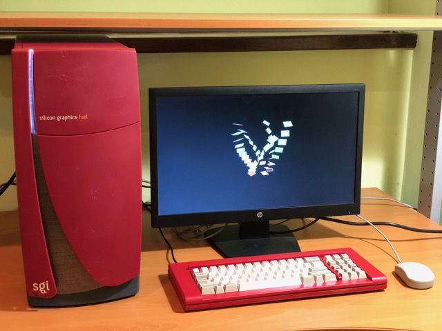

I wanted to share (with permission) a great photo from a customer matching a True Red F77 with an SGI (Silicon Graphics) Fuel computer. A great setup!
SGI Fuel.jpg (93.99 KiB) Viewed 11455 times
23 Sep 2020, 03:00
Jaw, meet the floor.
