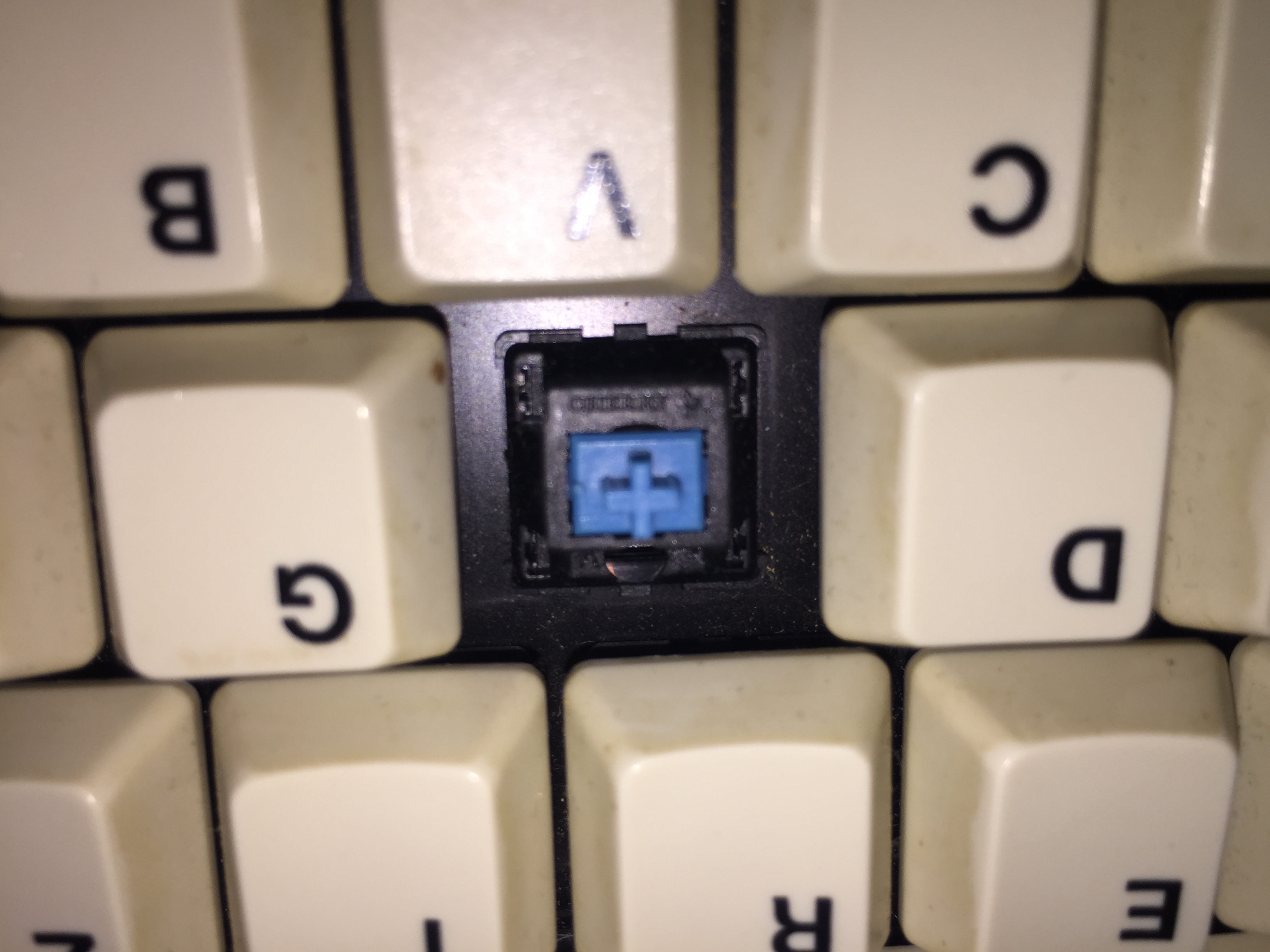

It is by far the best keyboard I have ever touched, at least to my taste, and compared to white complicated Alps and normal Cherry MX blues. The switches are Cherry MX dark blue, except for the return and space keys, which are amber Omron switches.

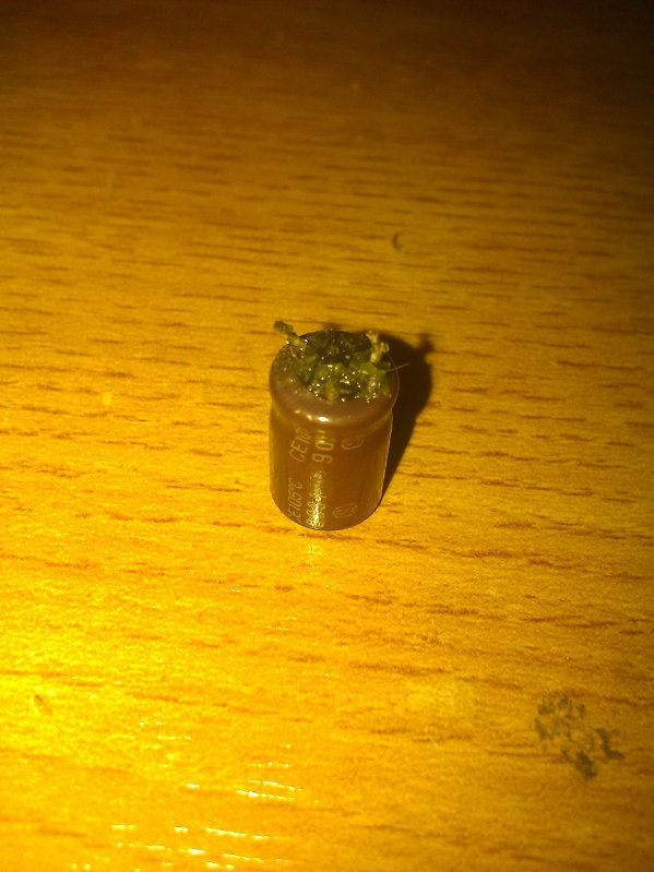

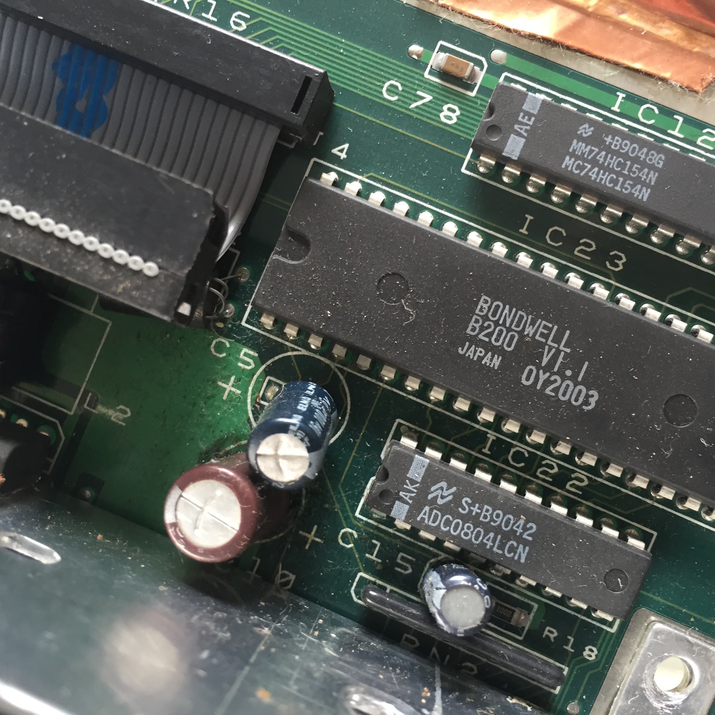

Today, I cleaned the case and disassembled the little sucker. Inside I found the usual capacitor mess, so the soldering began.
After a thorough capacitor change and the a hasty reassemly, it started up flawlessly and asked for a boot disk, which I created using an old 486 hooked up via shugart bus to a TEAC floppy from my good old Amiga 500. It took 3 hours and was horrible, but finally worked.

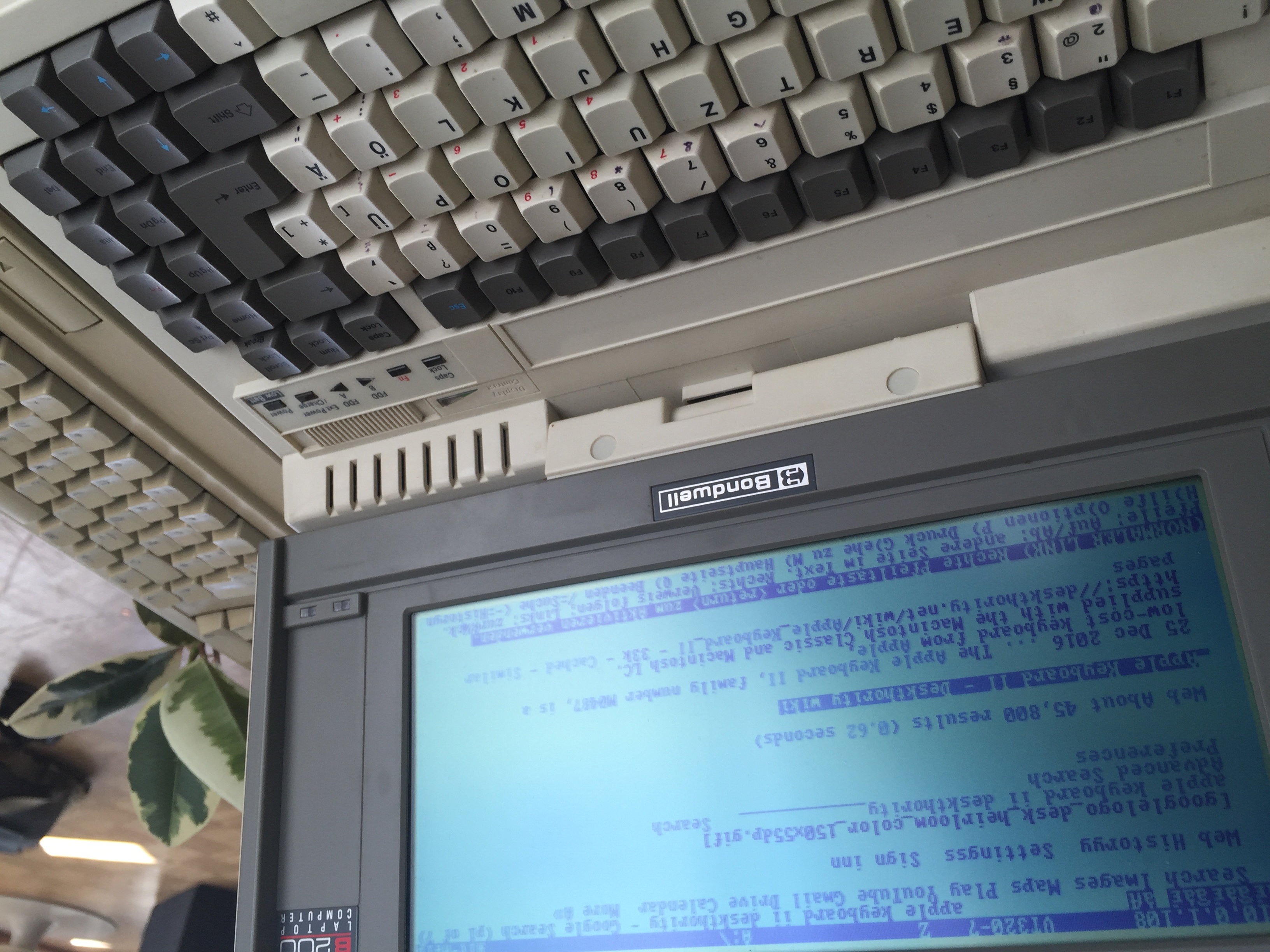

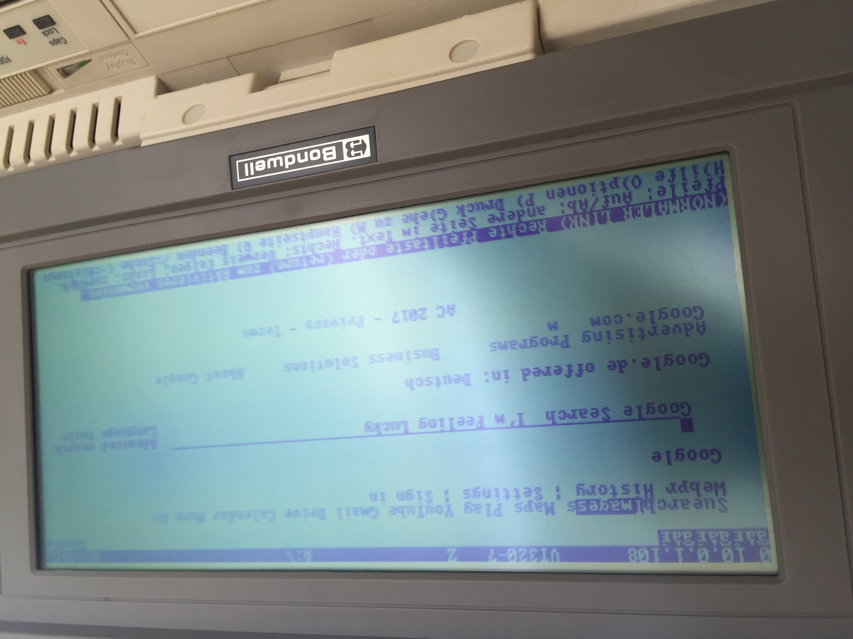

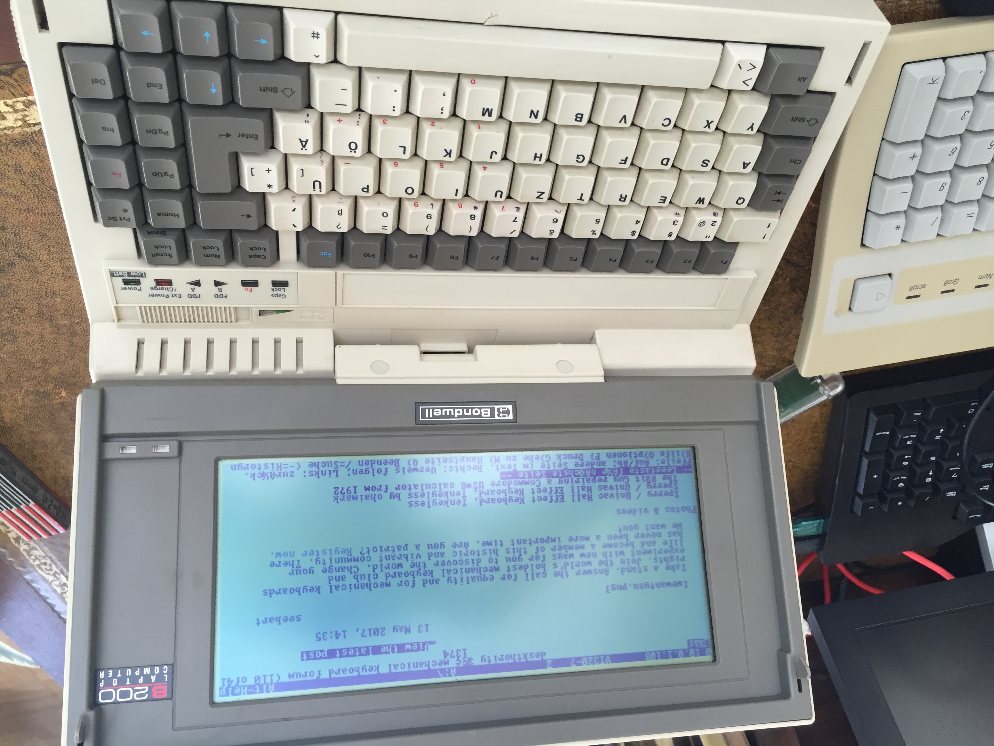

I set up a Raspberry Pi Zero W with Raspbian lite, installed TCPser and a few text based browsers (Lynx etc.) and a telnet daemon. Then I added an adapter from USB to RS232 and a nullmodem cable.
After rebuilding the Bondwell's battery pack, which consisted of six 'C' cells in a row, I was able to get the 5 volts for the Raspberry from it with little effort, and as one of the 2 720K floppy drives was not working anyway, I decided to put all this stuff inside the case instead of the right side FDD.
After adding a small footprint terminal program (CONEX) to the boot disk via Laplink (the old 486 was already back in the basement) and adding it to Autoexec.bat, the unit now directly boots into the terminal and logs on to the PI via Telnet. Interestingly, transmission works flawlessly up to 115200 baud, which is not common for a XT system .
The result is the best Linux terminal I ever had, fast enough for most command line stuff, including quick google searches and controlling my home automation if I was so inclined. Even mail, taking notes and reading news sites works quite well.
It runs for about 3 hours on 6 eneloop 'C' cells, with activated wLAN and bluetooth on the Pi side.
The only remaining thing to do is to route a flat ribbon cable with a soldered DB25-connector to the inside in order to get rid of the big ass serial cable on the back.

Capacitor incontinence
