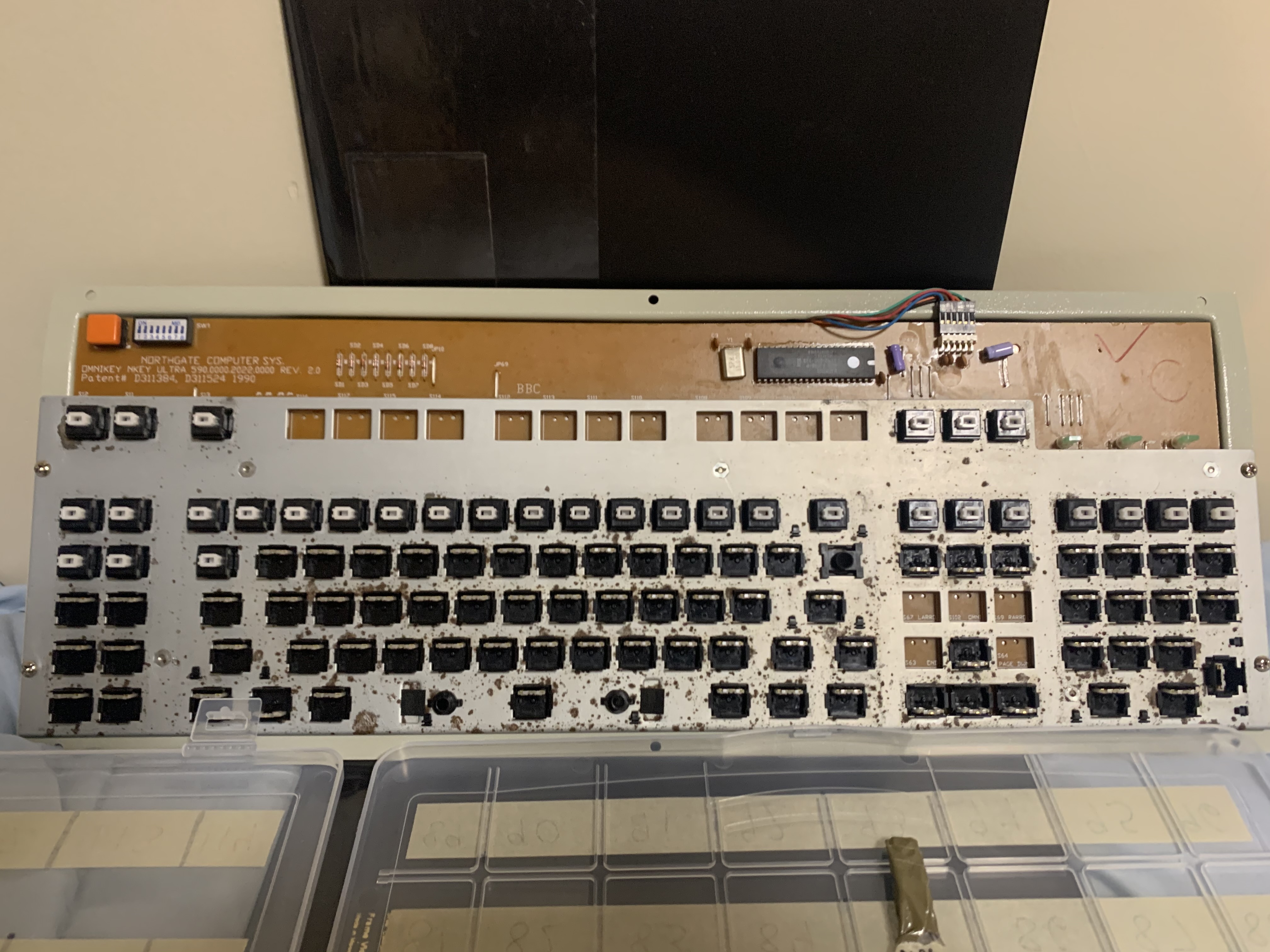

When the board arrived, I immediately took it apart and methodically cleaned everything. The mounting plate has a lot of rust spots on it, however they were merely cosmetic and had not compromised the the integrity of the plate or the the PCB underneath. I used a dental scraper, some WD-40 and q-tips to clean removed most of the rust. Then using Chyrosran22's video guides on how to restore and clean ALPs switches, I took apart every switch on the board, placed each ones components in their own compartment in my storage boxes. They're actually jewelry making storage boxes, but they worked perfectly keeping each switches components separate and organized by number. I then painstakingly cleaned each switch housing and components using rubbing alcohol, fine tipped paint brushes and my x-power computer duster. After uttering every curse word I could think of, springs flying off around my room and praying the board would work, I put the board back together and tested it. The board 100% worked, I felt like a kid on Christmas.

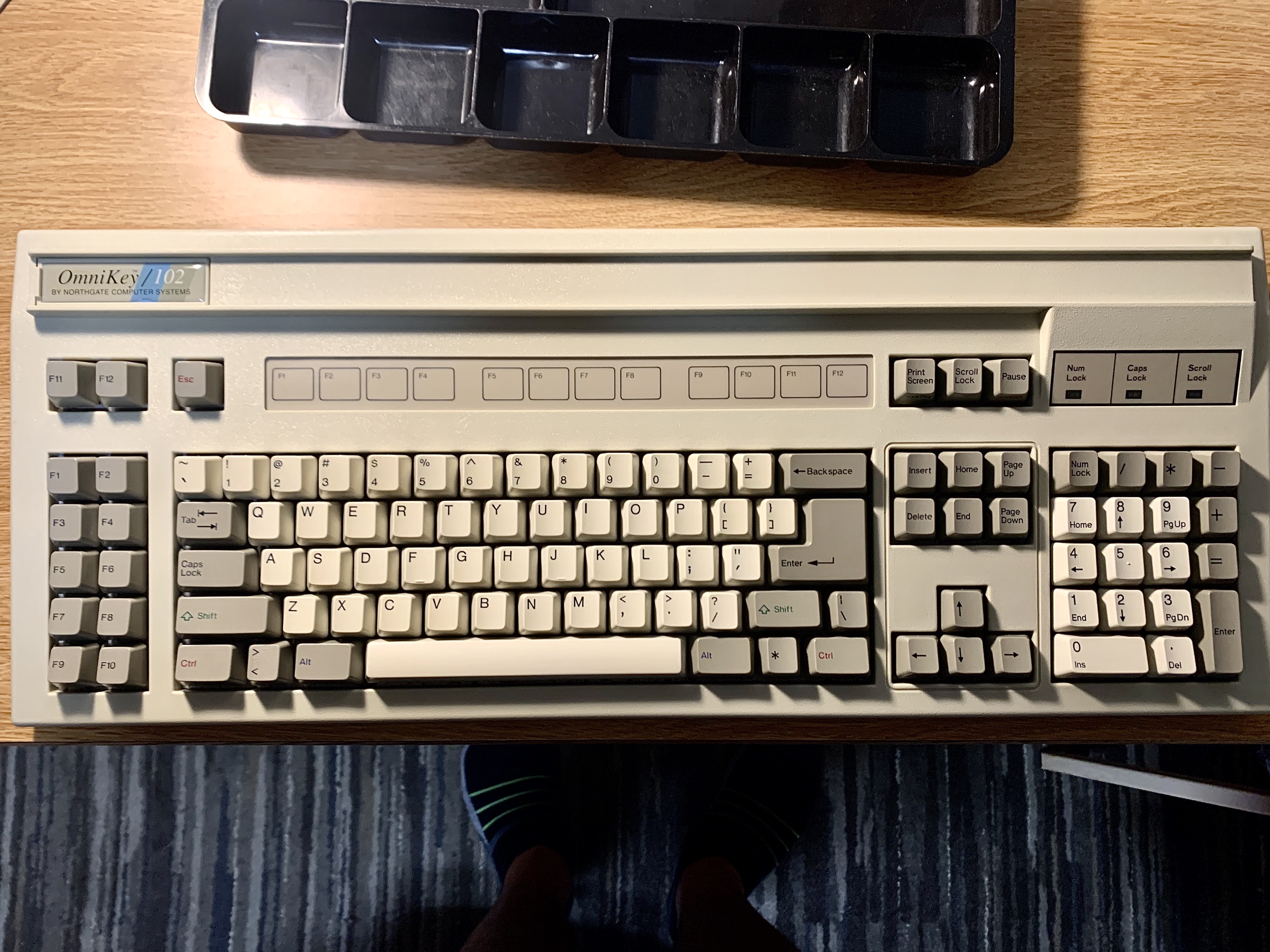

- Isn't she beautiful?
- The finished 102.jpg (3.67 MiB) Viewed 6869 times
- Post rust cleaning
- Partially disassembled.jpg (1.93 MiB) Viewed 6869 times

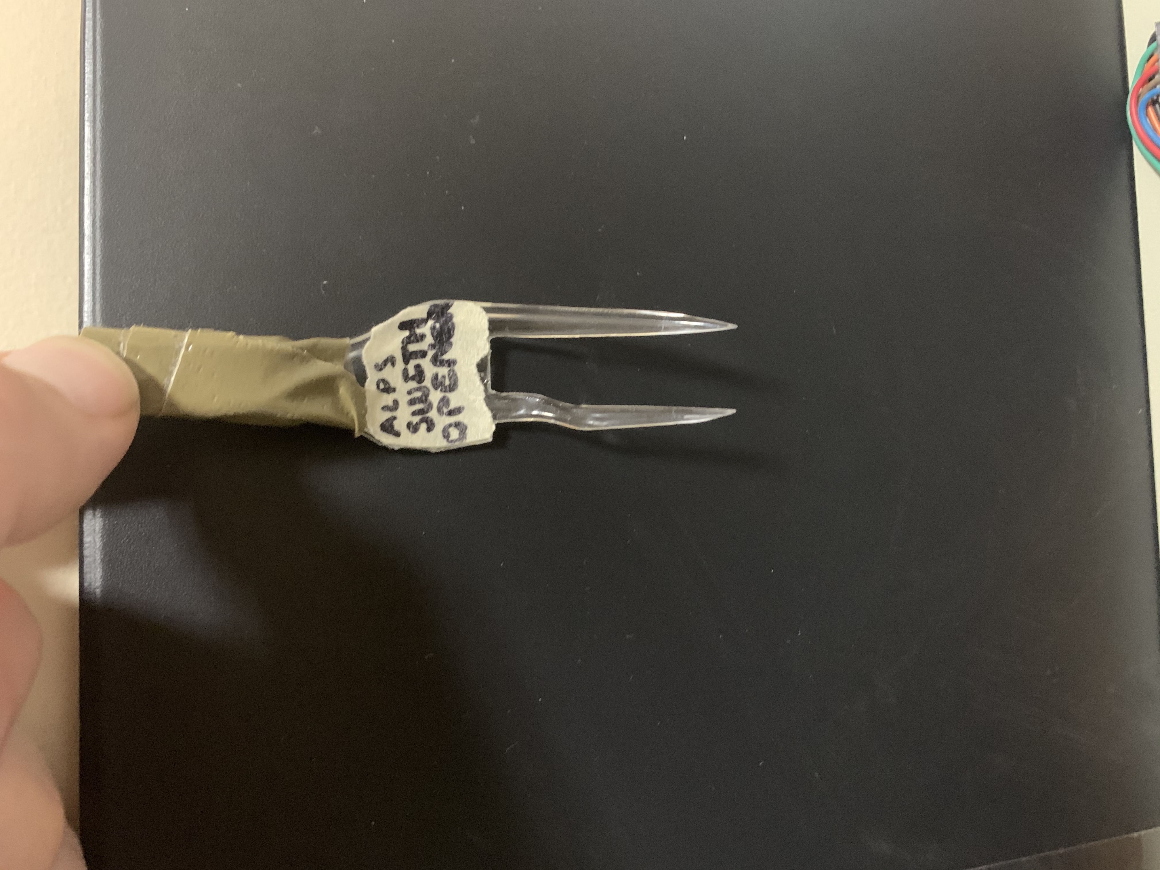

- Made this out of a cheap plastic fork
- My jerry rigged switch opener.jpg (2.42 MiB) Viewed 6869 times

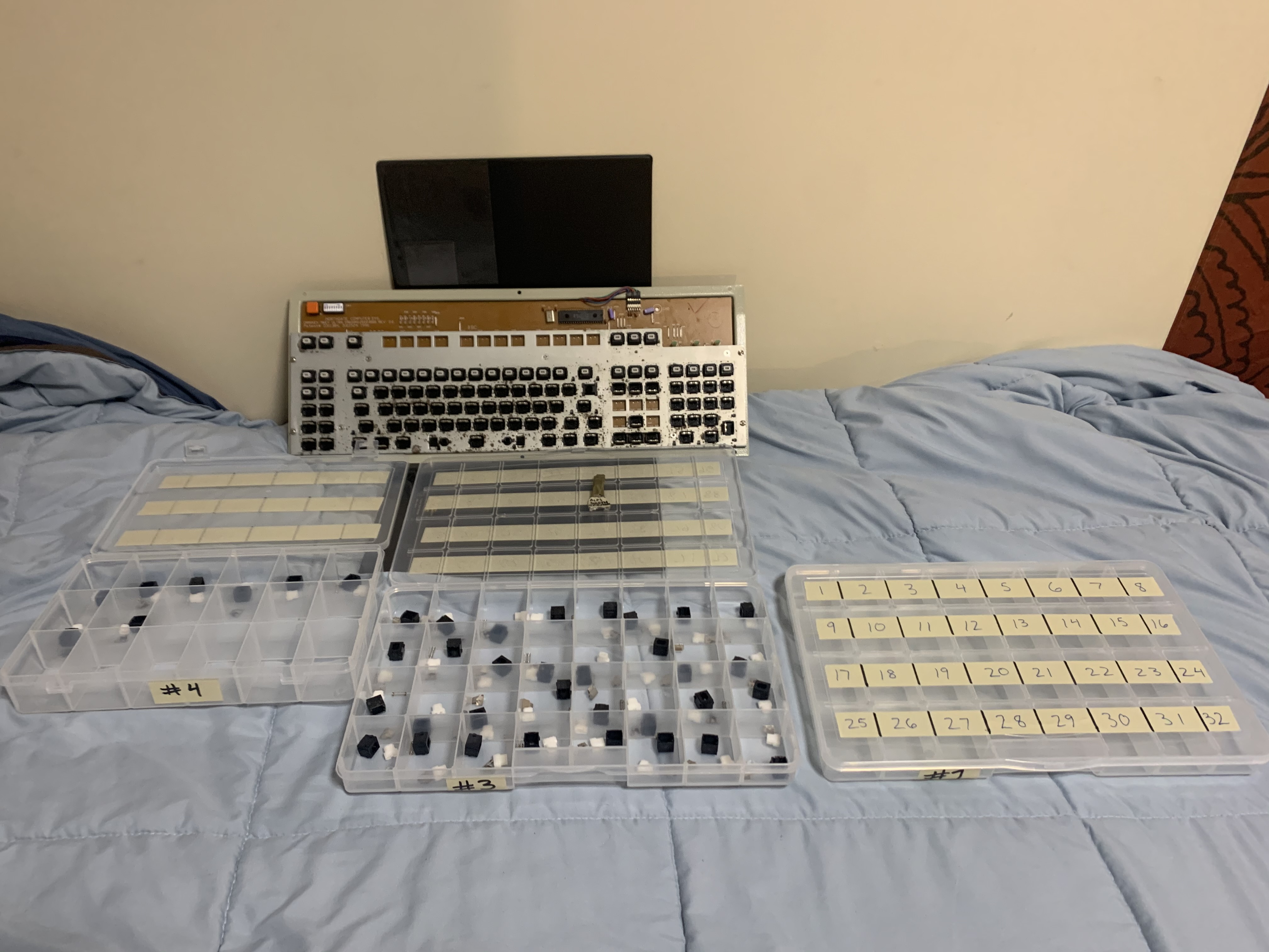

- The gangs all here
- Everything Together.jpg (1.33 MiB) Viewed 6869 times

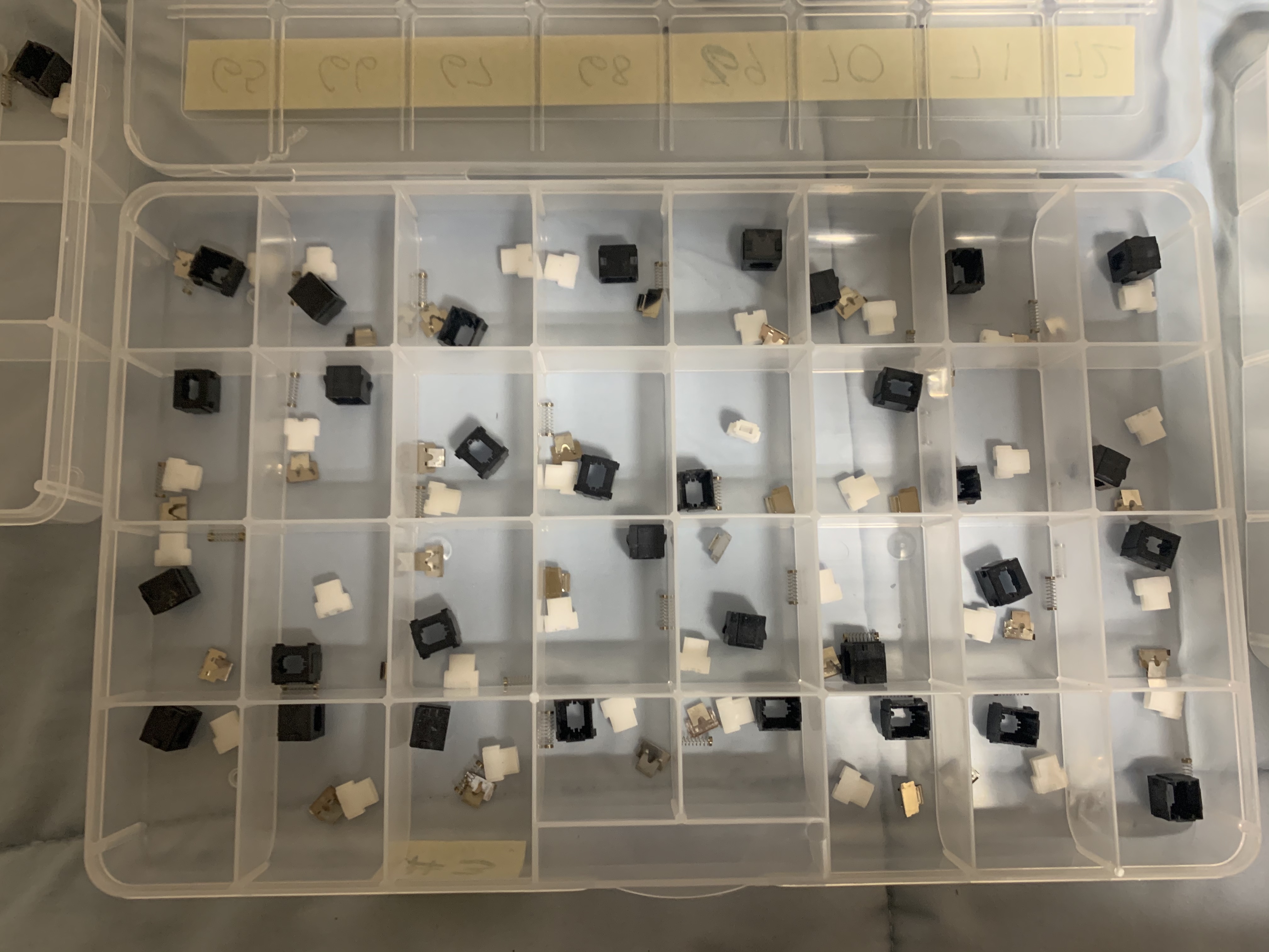

- Bought these at Wal-Mart
- Close up of storage box.jpg (1.9 MiB) Viewed 6869 times

I love your switch opener dude! Also sucks that the M key didn't work, but I do have a few contact leafs sitting around in one of my trays if you end up needing one.

Thank you! The issue with the switch is that the switch plate itself is corroded beyond repair, not the contact leaf, but thank you anyways! I ended up buying 7 new old stock switches from eBay. I got 7 just in case another switch dies and I can’t repair it. I plan on taking all of the switches out when I do the repair so I can sand and repaint the mounting plate. Do you know if there is a specific type of paint that I should use?

I'm a fan of Rust-Oleum products. Check out my thread and before/after pics. I have at least two more Alps and one NEC keyboard that need some mounting-plate work. Hey, it worked great on a Model F, so let's see how it does on Alps!
I seriously thought the tape on your fork said, "Alps meth opener." I had to re-read it a couple times
Anyhow, last week I got this thing. It worked perfectly for me. I disassembled about 200 clicky and linear Alps switches in about an hour and a half. Desoldering took a bit longer, but I do have a desoldering gun.
