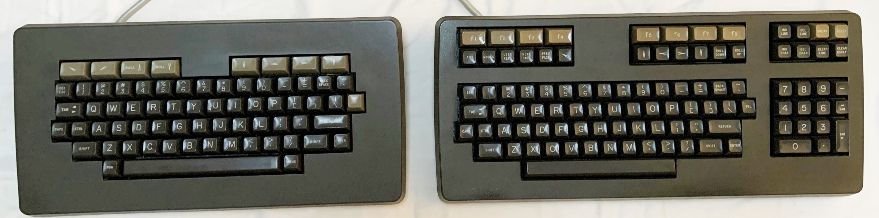

Here are a pair of keyboards from HP 262x series terminals from the late '70s / early '80s.
The standard keyboard is for the 2621A. The extended keyboard, with its rather infamous AIDS key (a prefix for the f keys navigating various terminal setup menus), is for the 2622A. A third member of the series, for the 2623A, is in the Wiki. It is the same extended keyboard, but replacing the number pad with a graphics navigation pad through different keycaps. I think that may be all; the 2624A used the standard keyboard.

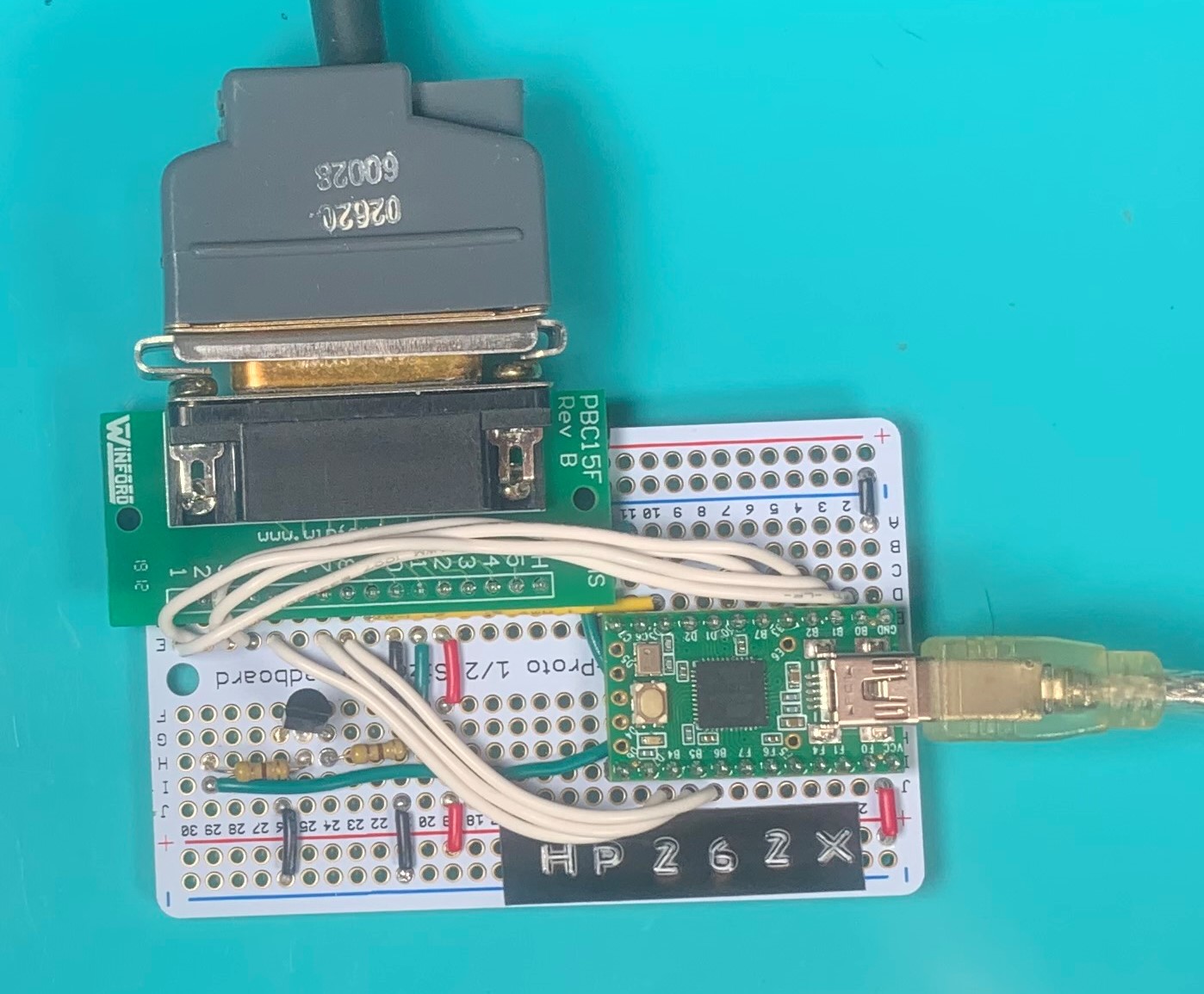

In fact, both chips have a supply voltage range of 3V to 18V. So, in theory, it might be possible to use a modern 3.3V MCU. I tried with a Teensy LC, but couldn't get it to work, so I guess it was just too close once the passives are accounted for. So Teensy 2.0 it is.

There is a speaker inside the keyboard. It is wired between a signal line and +5V. So, rather than driving it directly it is meant to be switched by an NPN transistor. On the original terminal, this was done by dividing one of the video trace signals. They used a current limiting resistor of 47Ω, allowing the 8Ω speaker to reach its full half-watt rating. That seemed like a lot of additional current, so I used 470Ω, for only around 10mA and it's still plenty loud.
Commendably, the J1 connector on the PCB uses the same numbering as the DA-15 connector on the other end. Too often working out a keyboard means keeping a pin mapping for the its cable.
Here is the converter with original cable:
HP terminals were so well documented back then, there's even a whole handbook for cables, where that one has its own page.

Beautiful boards. I have to agree, the smaller one is probably easier to type on by today's standards. I'm always impressed by older user manuals. The kind of things people have to reverse engineer now used to be well documented and distributed (or at least available in service manuals).
