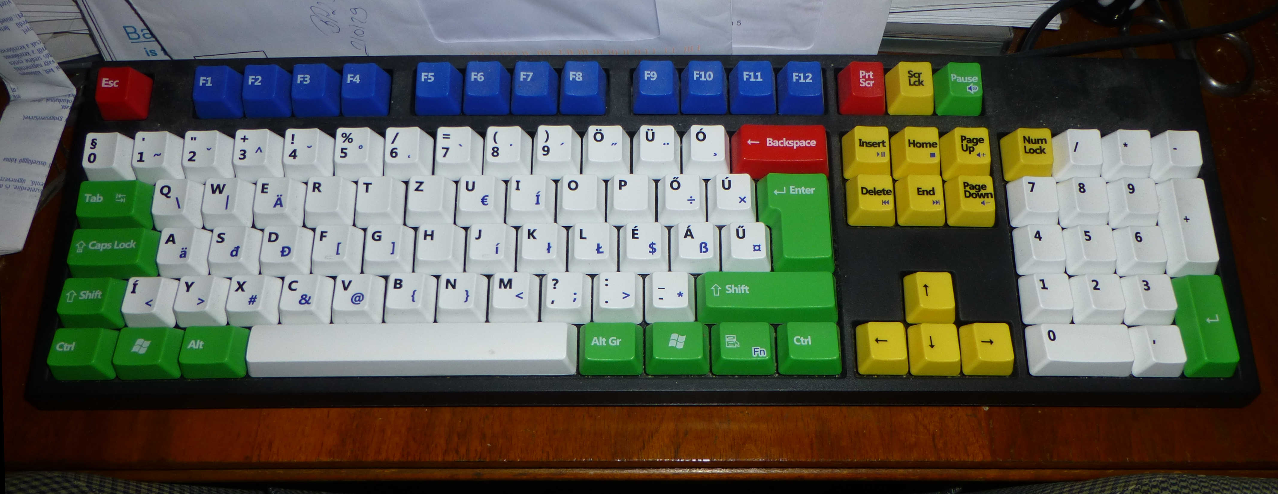

This is what I put together for my elderly father to improve contrast and navigation over his previous, run of the mill, light gray lettering on black keys keyboard, used in a dimly lit room:
Font is Segoe UI (to have unambiguous letter forms), in a heavy weight (to have better contrast). Blocks are coloured to provide visual anchors/cues for easier navigation.
He reports a much better usability, his computer usage improved a lot. Probably the biggest factor was the better contrast afforded by the white keys with black lettering. But I assume the colourful landscape also helps: with the previous one he had issues with modifiers and hotkey combinations and tried to do everything wastefully with a mouse, but with the new keyboard he gradually started adopting modifiers and hotkeys.
