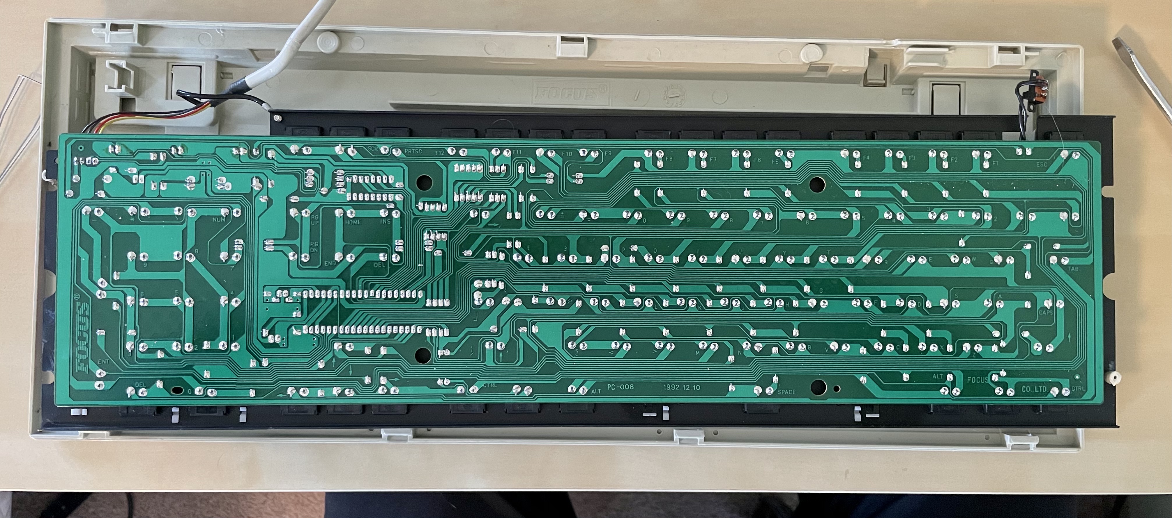

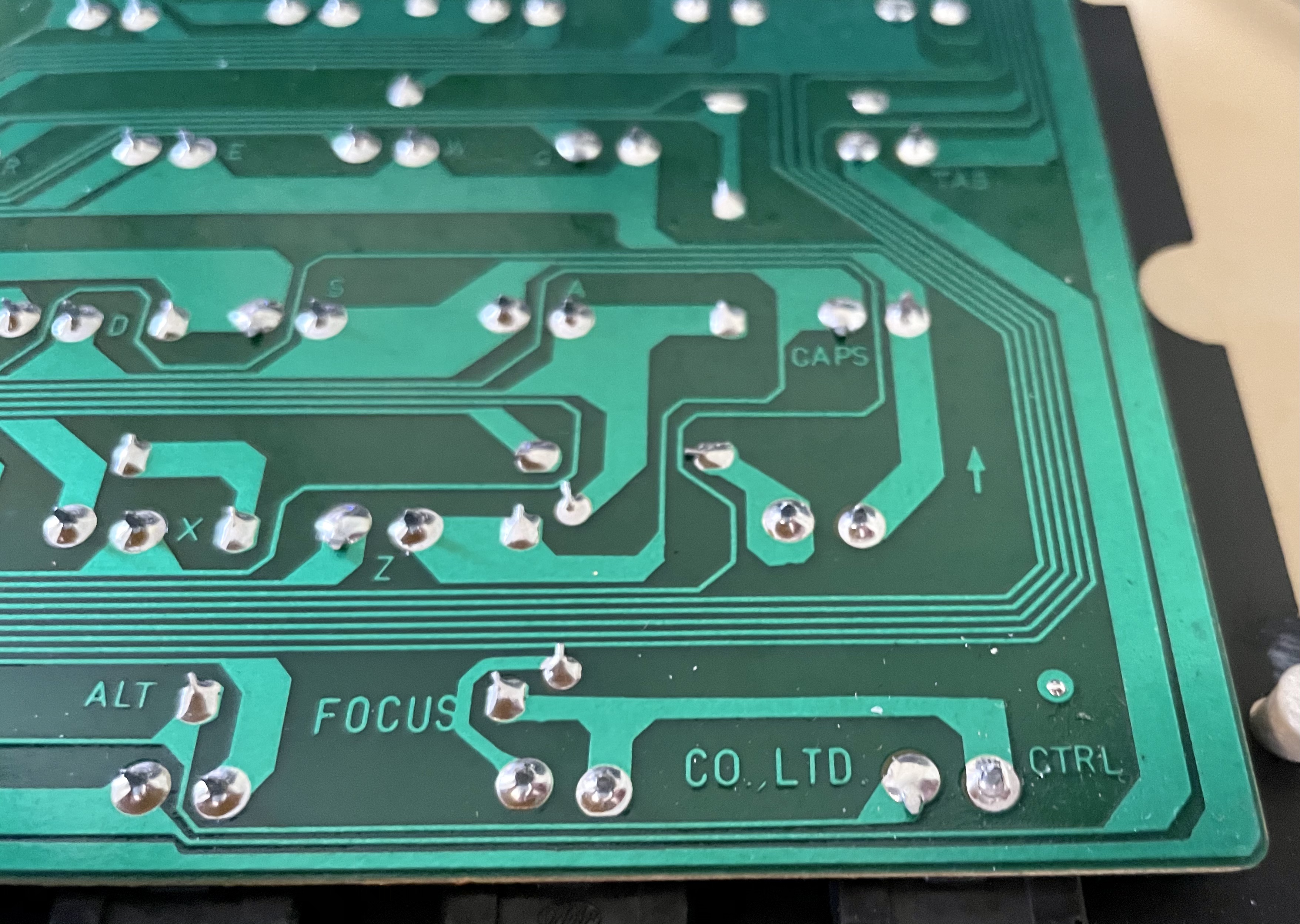

Thanks again for the advice! I followed both tips and first checked out the PCB. There were no obvious cracks on any of the traces. I included a picture of the left control key PCB area and the whole board.
- A3FC26E8-457D-40A6-93EC-255B5F11D44C.jpeg (2.23 MiB) Viewed 5102 times
- F7E7A628-E540-471C-936E-56A76FE63A5D.jpeg (2.21 MiB) Viewed 5102 times

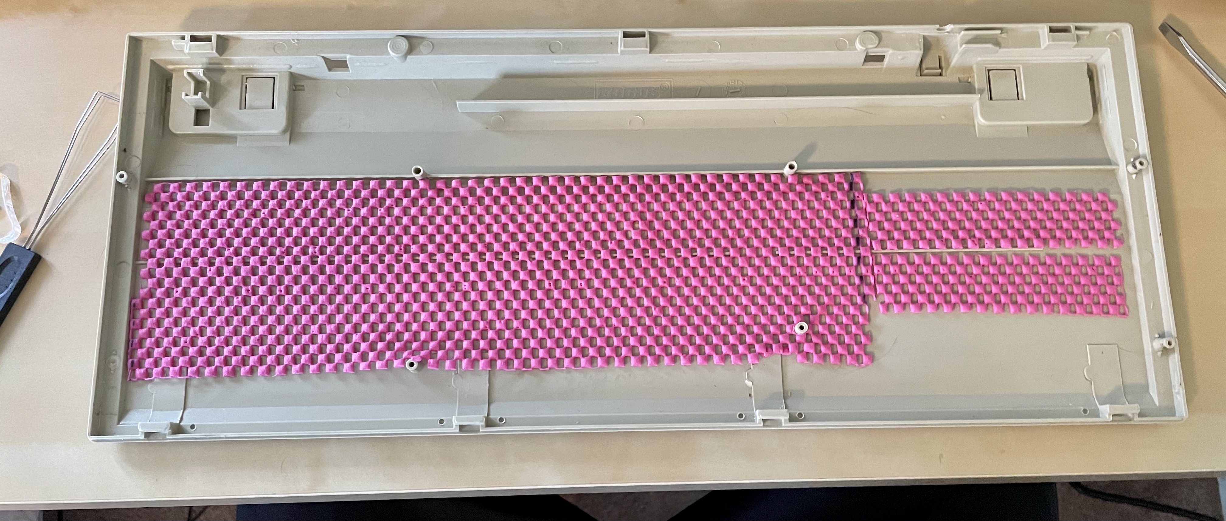

I also learned about a nice way to dampen ping/resonance on FK-2001 keyboards. I purchased this from eBay and the seller told me he cleaned the switches and keyboard, which look brand new and feel great. He also put some rubber grip padding under the PCB which explains why the sound is so nice compared to my other FK-2001 boards.
