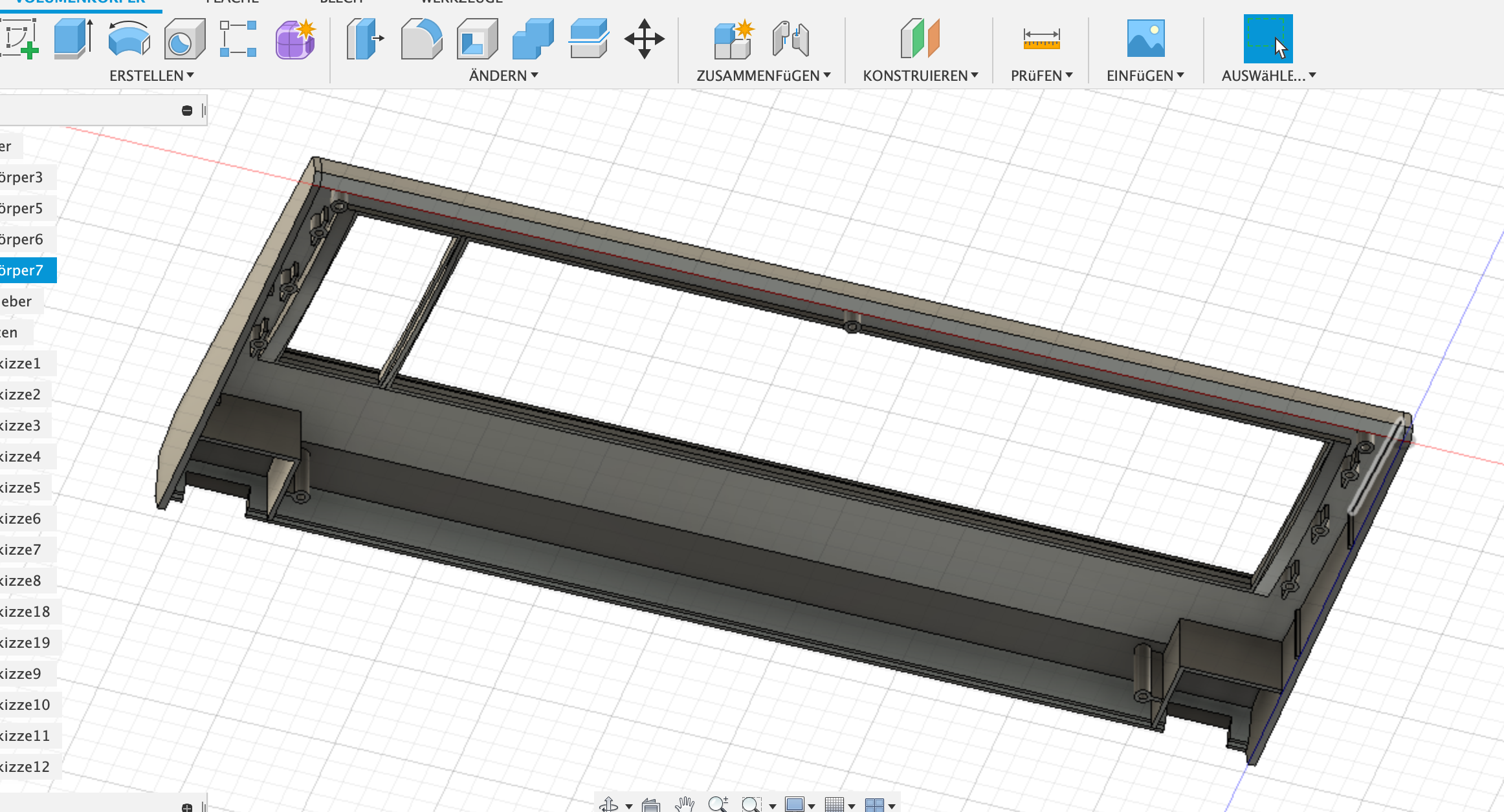

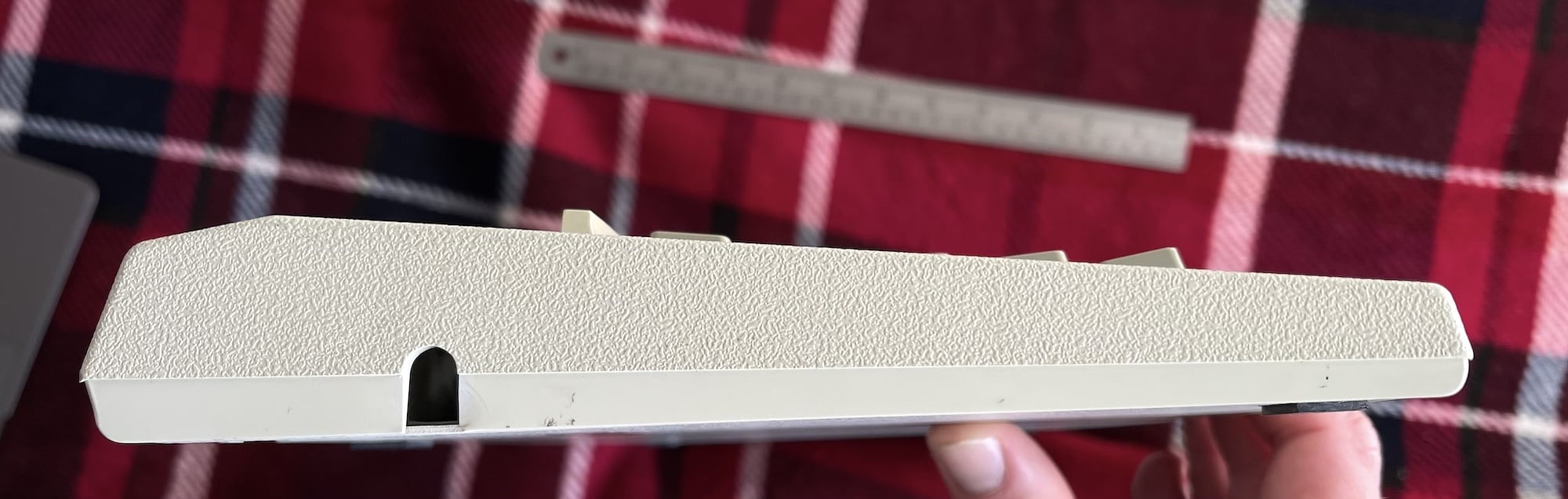

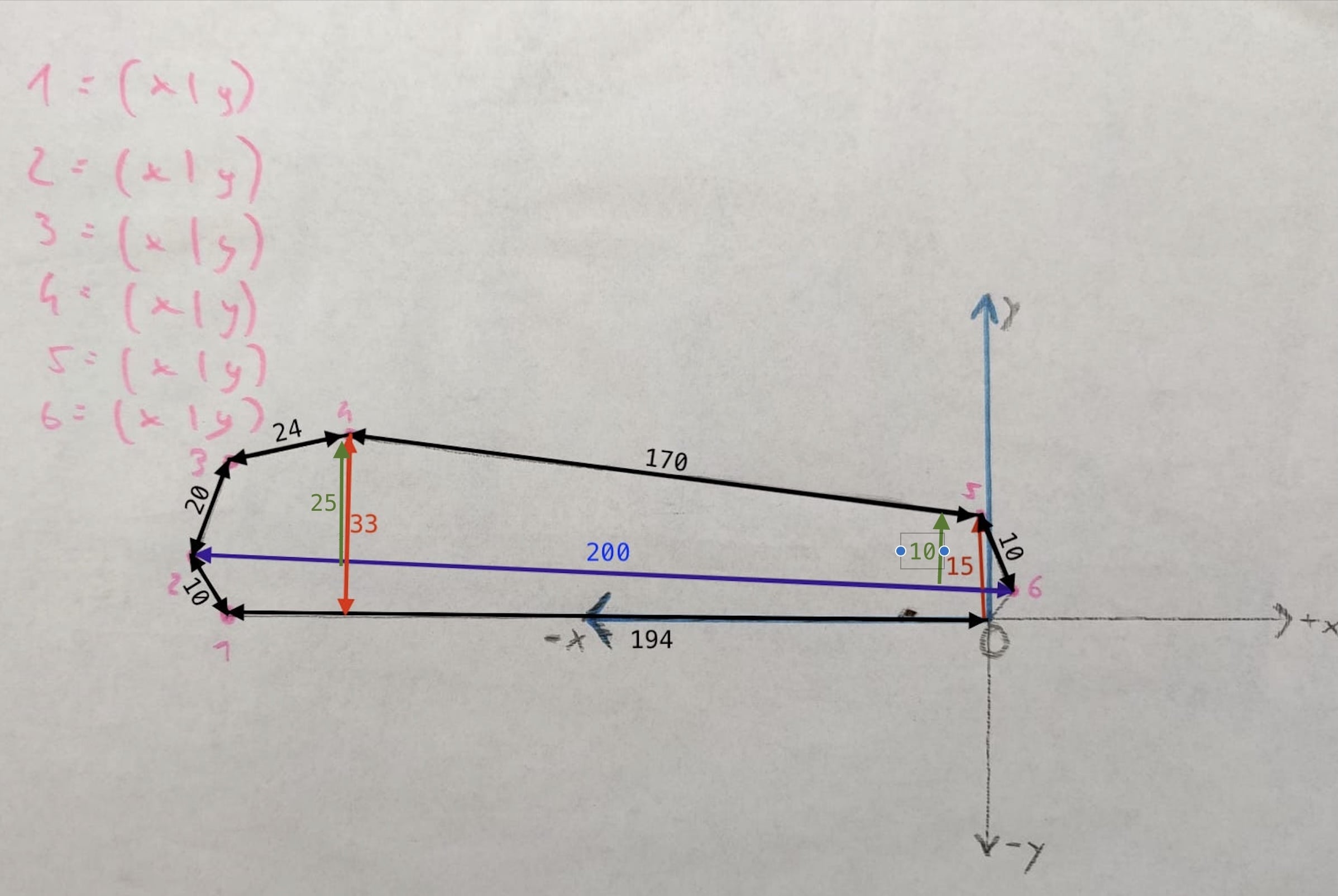

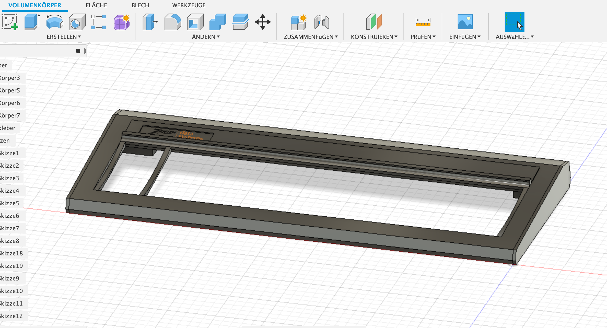

Update: I completely remodeled the old Zenith ZKB-7 Case in CAD. Before I start finishing off the design with the metal plates I will check if all measurements are correct. Big thanks to TNT and Muirium for helping me out with these!
Right now all 3D-Services I saw online charged a minimum of 200€ for the case, so I will have to figure out how I can bring that price down..
Anyways I will post the more detailed renders here in a few days until then thanks for all the support. Looking forward to bringing Vader and Skywalker to life :D

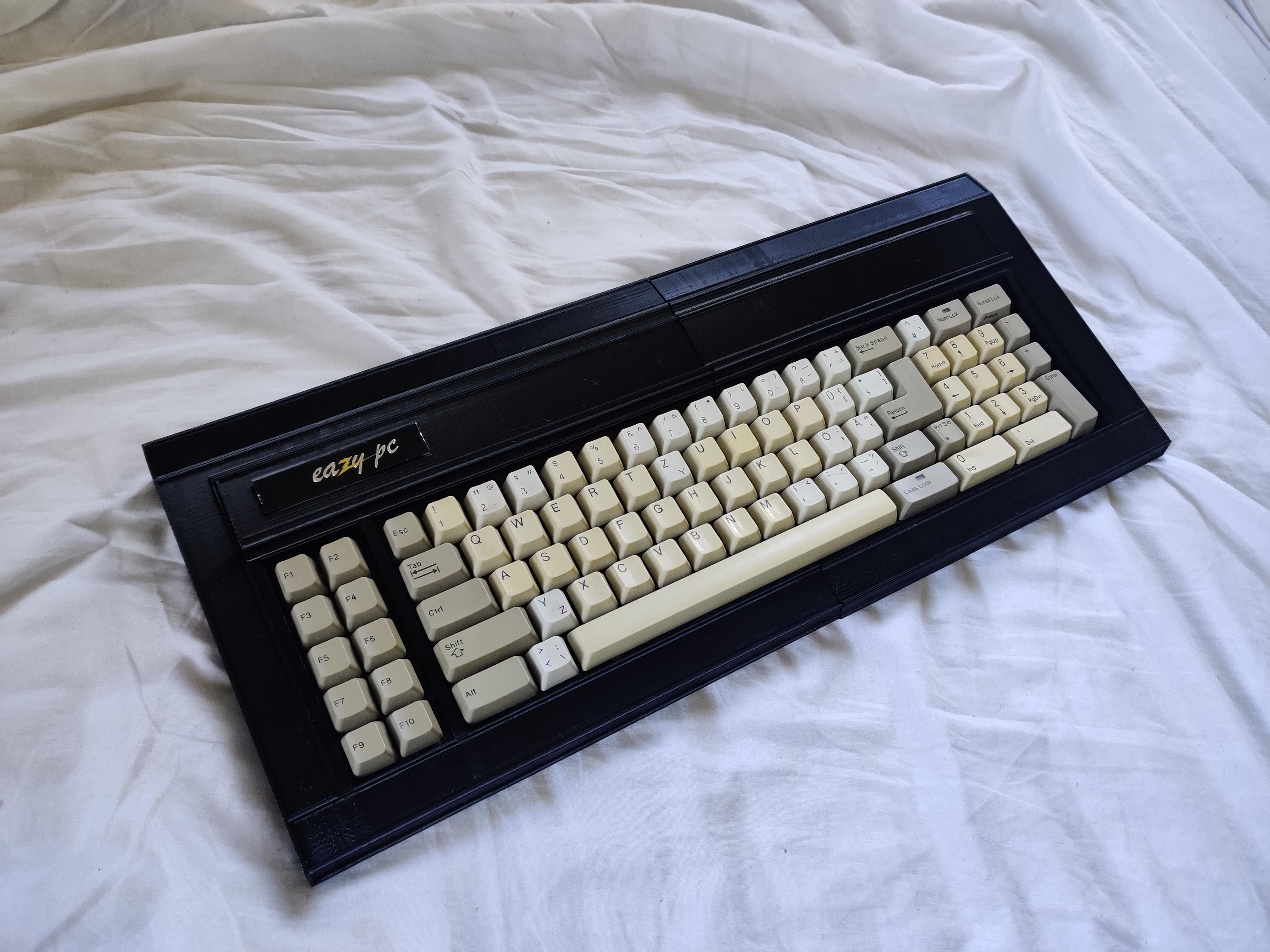

I have one of these beautiful Zenith Eazy PC keyboards too, also with the case broken by the postal service around the cable cutout (in a very similar fashion to yours).
I did not have the heart to break it down for the switches, so I glued the case back (all the case pieces were in the package). I have not managed to get it to work with a modern PC yet (need to look closer into converters, as it seems it has the XT protocol)

Update: DHL refuses to refund the package which really sucks given that I got the whole thing for 190€ broken...
Anyways, I may have found a way to print the case very cheap by splitting it in half (the metal sheets would cover the line and would hold the two pieces together)

I'd love to see a prototype, good idea with the split case. Maybe you could try to not split it into perfect halves, but still leave some kind of structure to give additional stability to the case. Some kind of form-fit connection.

That's the plan :) If everything turns out as I want it to, then it would be really easy for anyone with a 3D printer to make the case.
