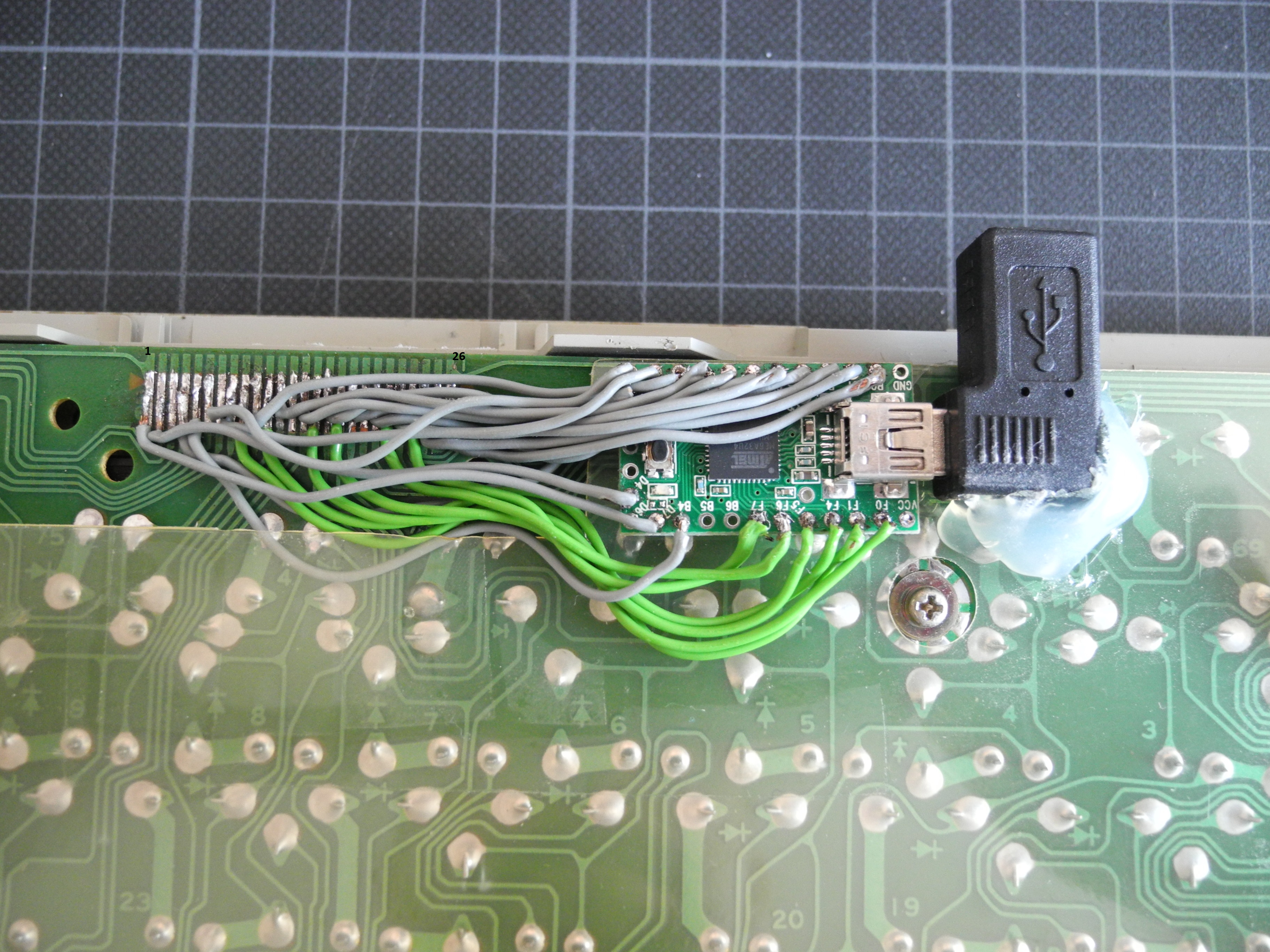

How did you attach teensy to the PCB?
alh84001
v.001
04 Jan 2017, 19:26
Here's my setup
Nothing too fancy, but it get's the job done. It's almost as if teensy was designed to be put in that place on the PCB, the fit is perfect.
@copter thanks for posting the config file. I just had to shuffle the pins around and I was good to go.

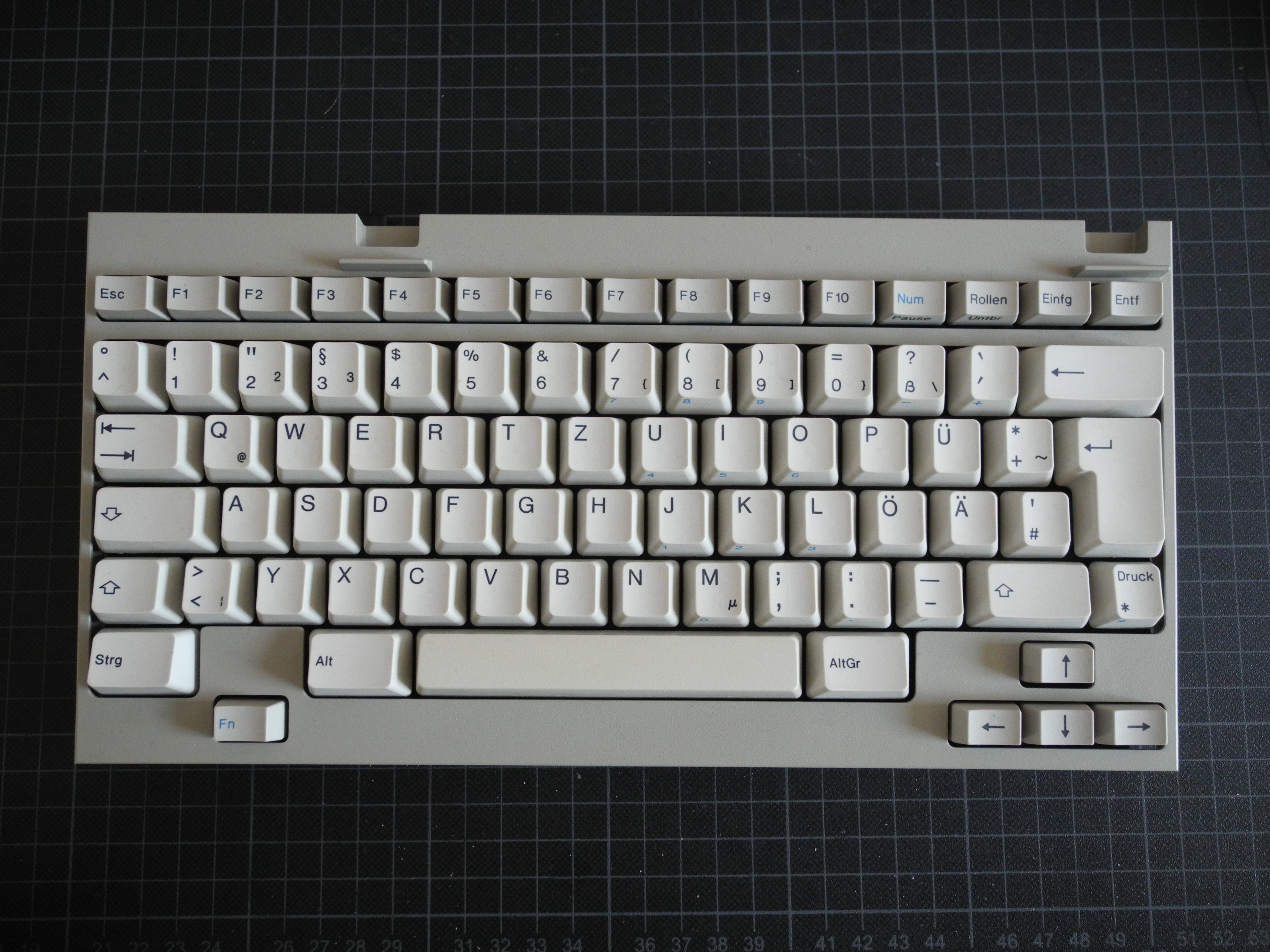

Sorry for reviving this old thread, but since more than one person asked now how I converted my ISO IBM 5140 to USB I just wanted to document my wiring as well as the pinout and matrix of the ISO version. I've converted the keyboard somewhere in 2017, so I'm not entirely sure if I wrote down everything correctly back then. I checked the wiring a while ago and it seems to be as documented in the spreadsheet.
This is the original layout:
The wiring is as follows (note the very small pin numbers on the photo!), it's also shown in the attached .xlsx/.ods spreadsheet:
My Soarer's controller config looks like this, I shuffled around a few keys compared to the layout in the first photo/spreadsheet:

For some reason I had to transpose the matrix by 90° in the config and if I remember correctly it didn't work correctly with it turned right side up, but I'm sure that is just due to my lackluster programming skills.

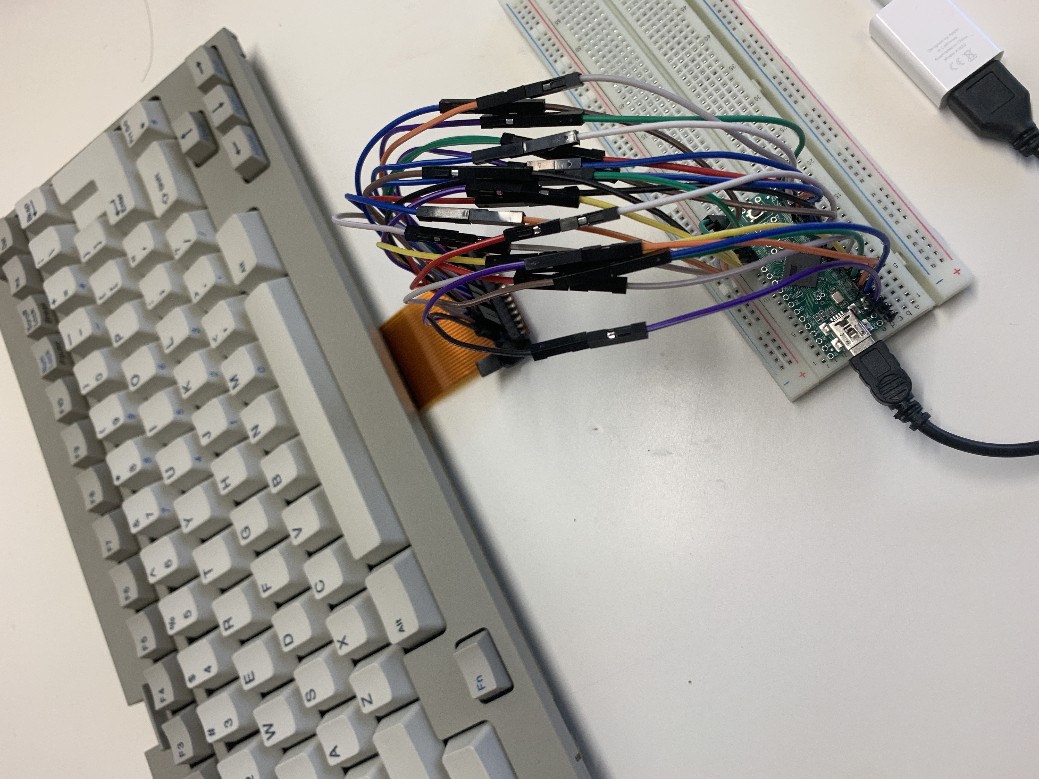

With the help of @Nuum @anakey I managed to convert a IBM 5140 board to USB.
1. Using the connector: Most people who have done this conversion removed removed the ribbon connector and connected the teensy straight to the pads on the pcb. I didn't want to go this far for testing purposes, so I simply connected a bunch of jumpers to a Teensy++. This works fine as well.
2. Firmware: I ended up using soarer's controller and config shared by @copter in this thread, instead of kbfirmware. This was my first time using soarer's controller, and it took a few hours to figure out. I found this step-by-step https://github.com/BASLQC/ibm-wheelwrit ... oller/wiki for an IBM keyboard very useful.
If you're using a 64-bit CPU/OS, you have to use the rebuilt 64-bit version of soarer's controller by @Muirium (viewtopic.php?f=7&t=25309). Additionally, if you use an M1 Mac, you have to make sure to run from a Rosetta Terminal.
My steps were as follows:
1. Flash the AT90USB1286 hex file to the Teensy++ with Teensy loader (original files by soarer viewtopic.php?t=6767)
2. Edit/save copter's config to change a few keys back to US layout, and add a few different layer 1 keys (code below).
3. Open a Rosetta Terminal (since I'm using an M1 Mac)
4. Compile the config file using scascontroller and write to the teensy with scwr.
The keyboard works like a charm. Next up is making a bottom tray to put this all into, after I've soldered the connections to the Teensy.
